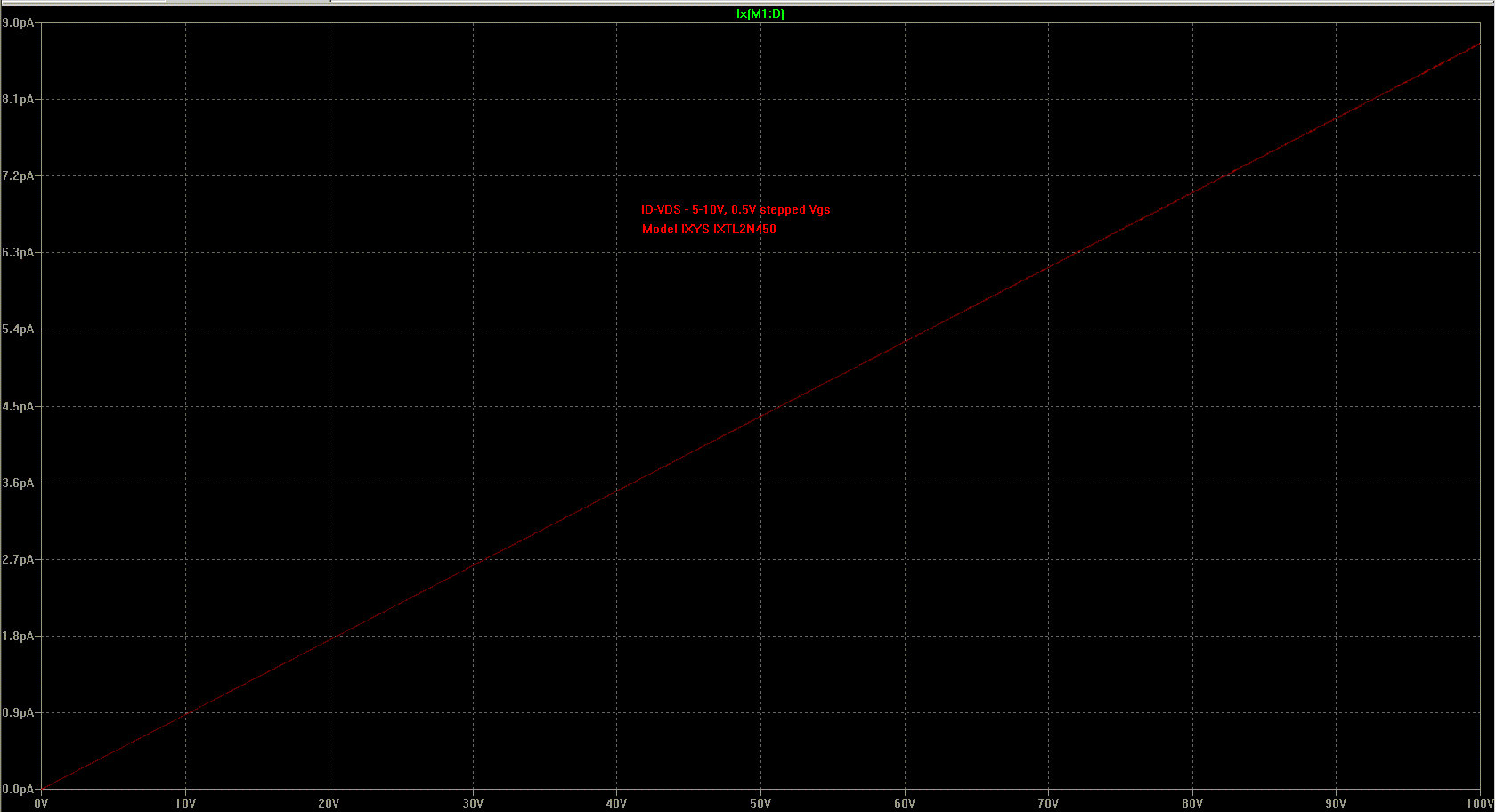

IXYS is always a good for a surprise.
HV-MOSFETs:
IXTK/IXTX 5N250, 2500V, 5A
IXTA/IXTH/IXTV 02N250, 2500V, 200mA
IXTL 2N450, 4500V, 2A
HV-Depletion-MOSFET:
IXTH/IXTT2N170D2 1700V, 2A
For most of these IXYS supplies models (see attached files).
Hacked the attached test circuit into LTSpice IV, but couldn´t get them running properly.
I used the .lib files from the zip.files and just put them into a more convenient, readable style.
Anybody got a solution to get them working properly??
jauu
Calvin

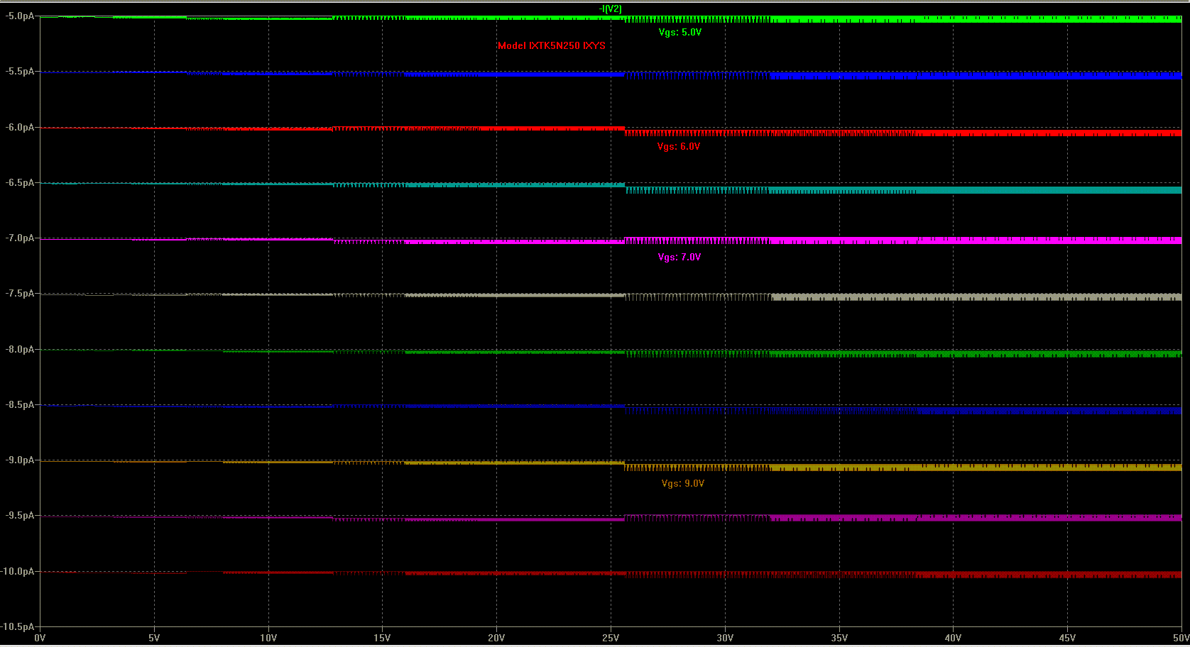

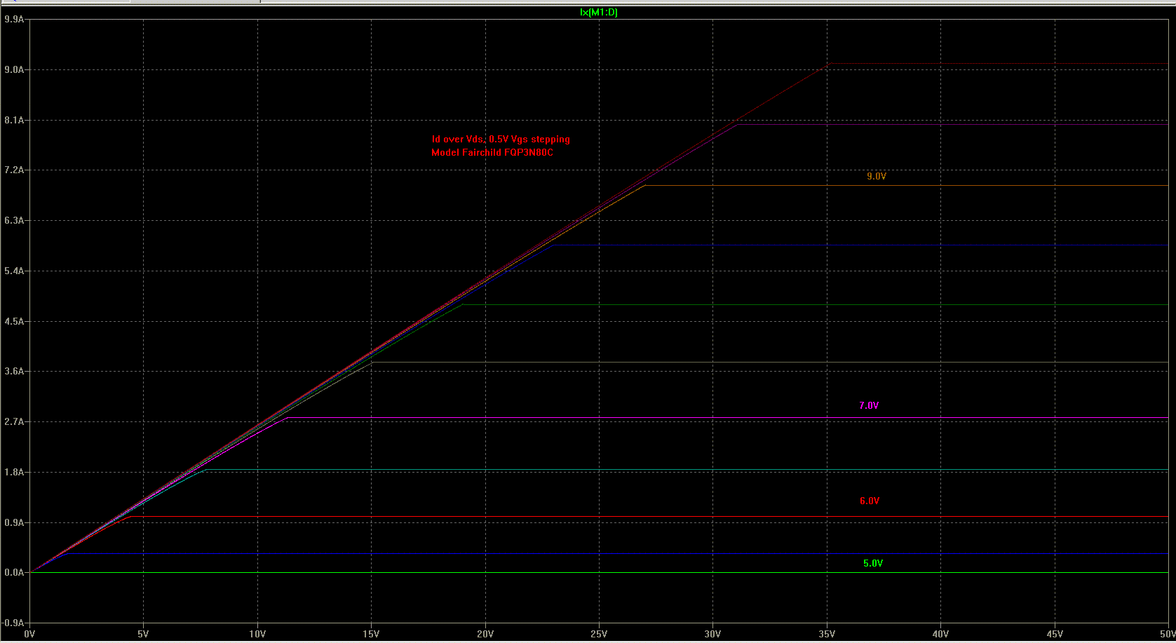

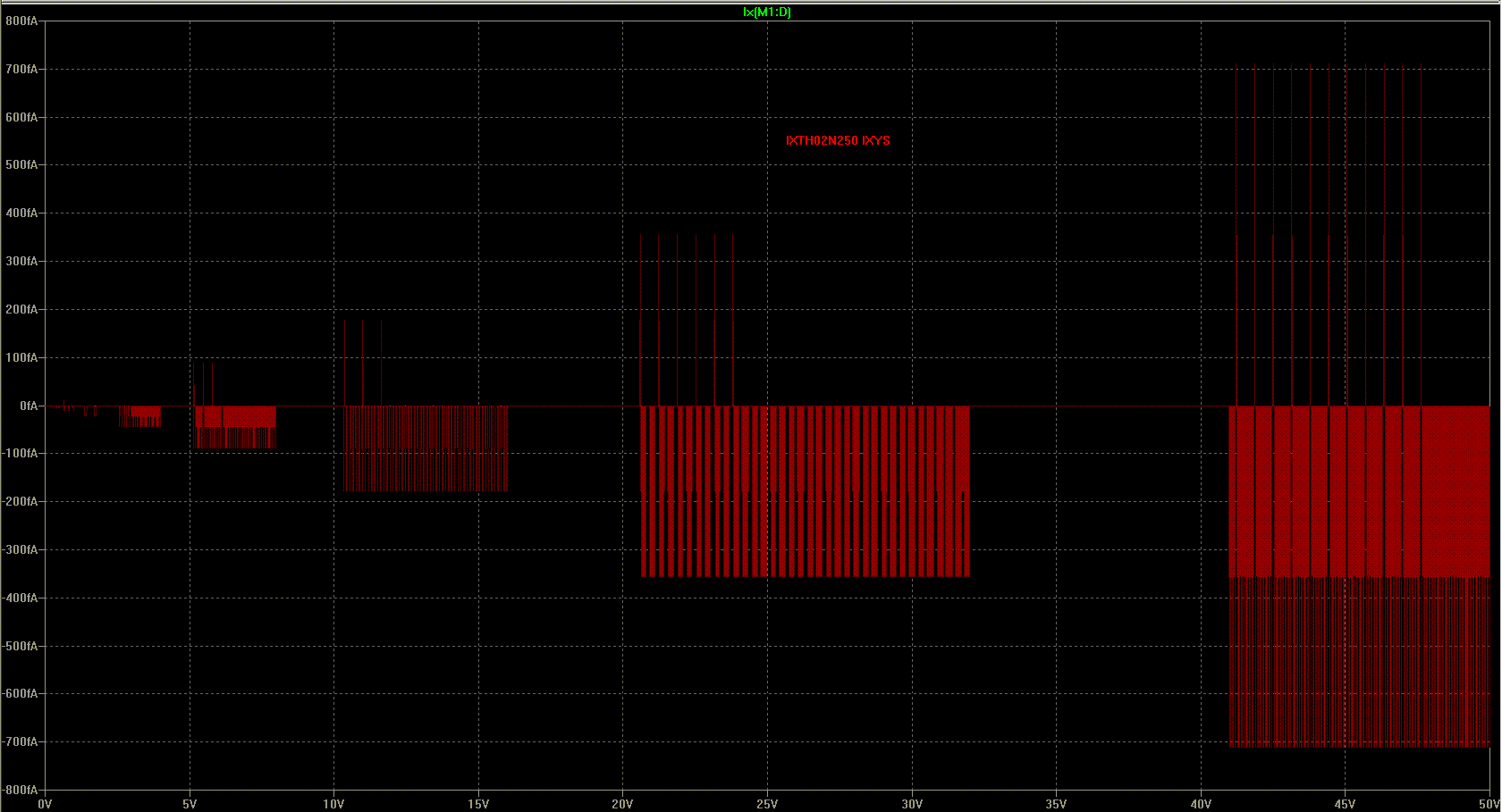

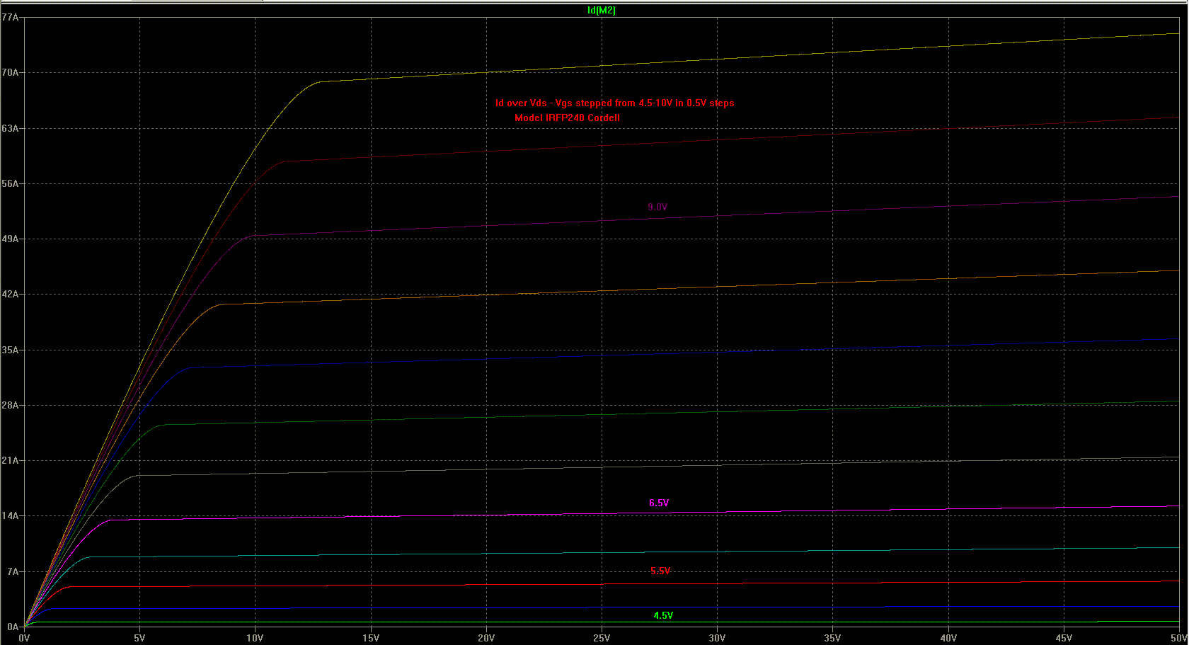

@Alex
The DC sweep is a method to plot the Id over Vds curves with stepped Vgs.
It´s simply to evaluate if the model is working basically right and how the plots compare to Datasheet values.
Attached are the sims of IRFP240(Cordell Model), FQP3N80C, IXTK5N250, IXTH02N250, IXTL2N450.
The IRFP240 model is obviously the most sensible.
The Fairchild model is already flawed. It shows sharp bends in the curvature.
The IXYS models as are, are useless. Theyare not even consistent amongst each other. Each presents a different failure. 😕😡
As the veryhigh voltage devices aren´t exactly cheap, models which are at least halfways reliable would be very helpful.
jauu
Calvin
That depends on what you want to extract. But I do agree they are not good models.
On the other hand I can understand manufacturers also do not want to give too much details away to competitors.
You can, e.g., only get models from Toshiba by written request, from a company (commercial customer).
If you plot Id vs Vgs, which is what we are primarily interested in, then both Fairchild & IXYS models work to an extent.
There are other embedded faults, like gate current too high, etc.
For industrial (switching) users, those faults may not be important.
And let's face it, who (as manufacturer) cares about audio analogue ?
