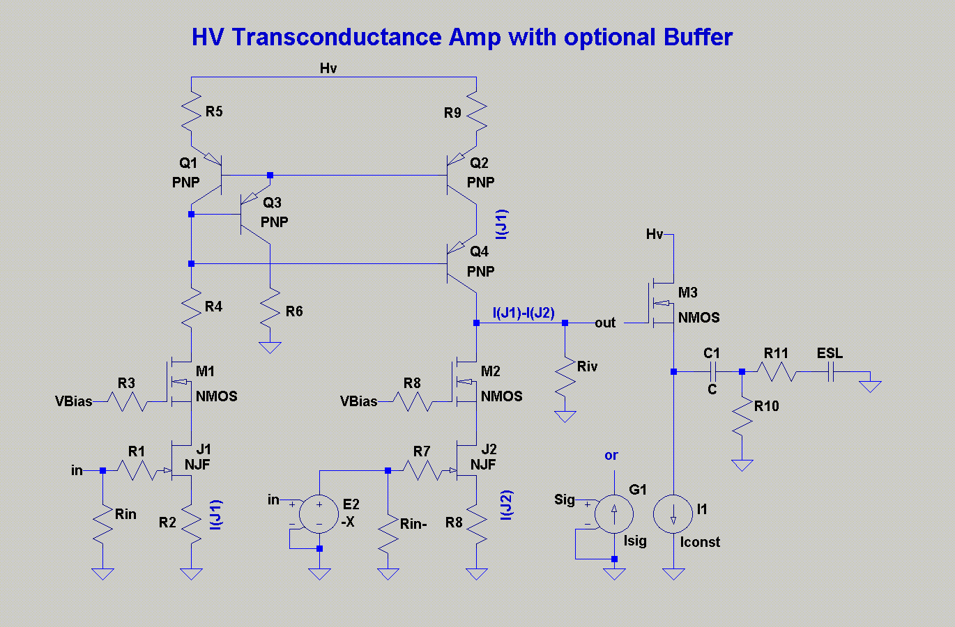

2Kv peak= 4Kv peak-peak.
An amp that has a 2kv supply will produce a 2kv peak-peak signal (0V to 2 kv) or 1Kv peak.
The same amp, but only two of them, when operated in differential or BTL (Bridge Tied Load) will produce 4Kv Peak-peak or 2Kv peak.
jer 🙂

Hi
That's a very large capacitance (is that reflected after the stepup)? My ML CLS panels (around 0.7m^2) measure around 1-2nF each. So a bass ESL of 4m^2 shouldn't need to me more than about 10nF (it would have a bigger stator spacing than the CLS too)? Am I missing something?
Once drove them briefly with a 4212E SET into a 1🙁0.75+0.75)... sounded tremendously promising but more power required!
But for a few kV into 10nF shouldn't require more than 50mA, which is probably within the means of say a bridged SRPP of 6HV5A or similar tubes.
Still, I can imagine the U shaped setup producing some super precise lower mids... will be following your progress with interest!
Hi There!!
200nf has an Xc=4K ohms at 200Hz.
At 150hz it is 5.305K.
With a 2Kv peak voltage you would need .500ma of current.
But at this setting the Xc would equal the amps output impedance and you would only get half of the supply voltage swing on one stator at 1Kv peak for the swing.
Typically in my simulations I have found that I had to design for a target frequency (3x ? maybe) of at least 4 to 5 times higher than my highest operating frequency in order to have the output drop no less than in the range of 1db to 2db for a roll off compared to the rest of the bandwidth that is ruler flat.
My target was of course 20Khz but it has the same effect at the lower end of the scale.
Common for any SE Class A amplifier design.
Also if you are using a DC blocking cap on the output this also forms a voltage divider and the output cap will have to be 10x the panels capacitance in order to keep the output voltage swing 90% of the total that is available and 100x the stator capacitance for only a loss of 1% of the total swing.
200nf or .2uf would be quite a very large array at that!!!!
Especially if you are providing enough D/S to even be able to produce frequency's below 200Hz with any kind of volume and quality.
I have thought of such a system myself with something like 32 or 64 square feet of area and at least .1" to .125" of D/S and even with the possibility of using a compounded Isobaric diaphragms for better control of their movement.
According to my calculations such a system just may be able to produce close to 115-120db at 20hz!!
I forget what my projected capacitance would be at this time without re-calculating it all.
I believe there was another thread on this very subject (ESL Bass) a while back and I had described the very same thing then.
I am so itching to get my DD amp running this summer now that I have the FET's to work with and a few more new panels made.
Cheers and Good Luck!!!
