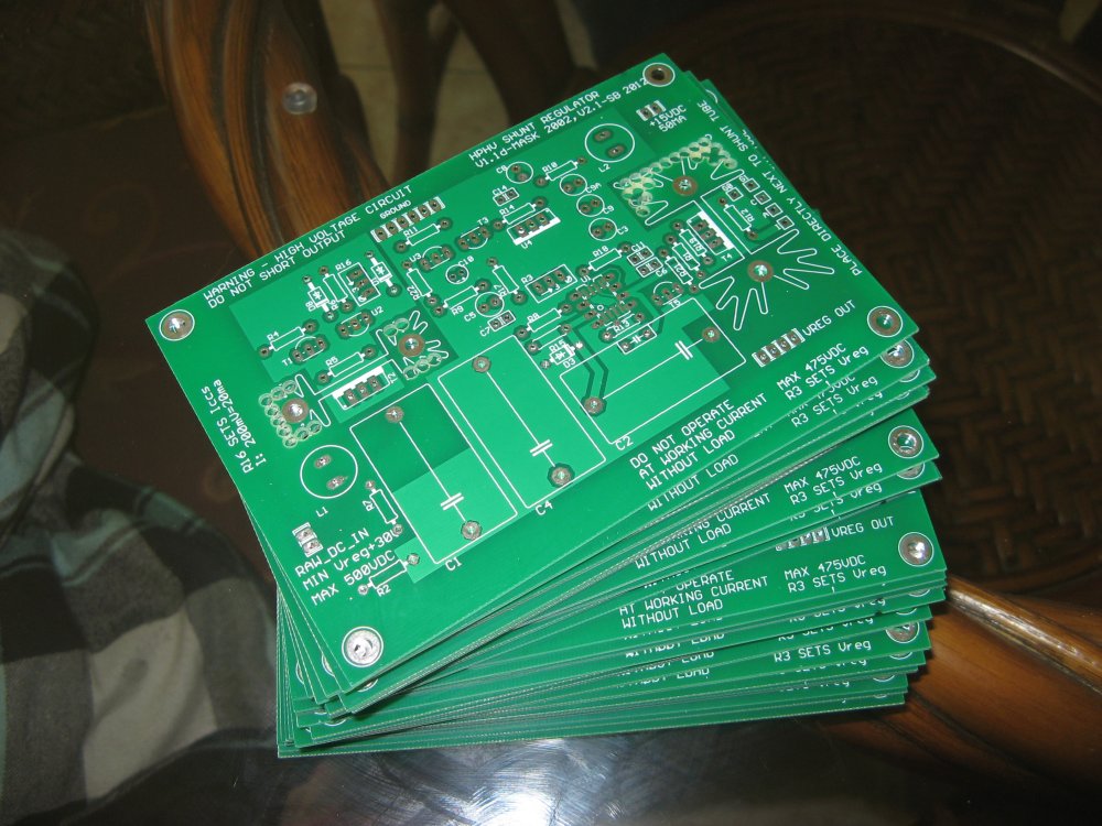

I got a few requests lately for this PCB. I'll make a small run of 10, at 25$ each + shipping and 3%PayPal fee. I already have 4 sold. Let me know at bergeron.syl@videotron.qc.ca.

All kits where shipped today. At the current rate of sale, I'm planning I'll have PCB available for only 2-3 more guys...
