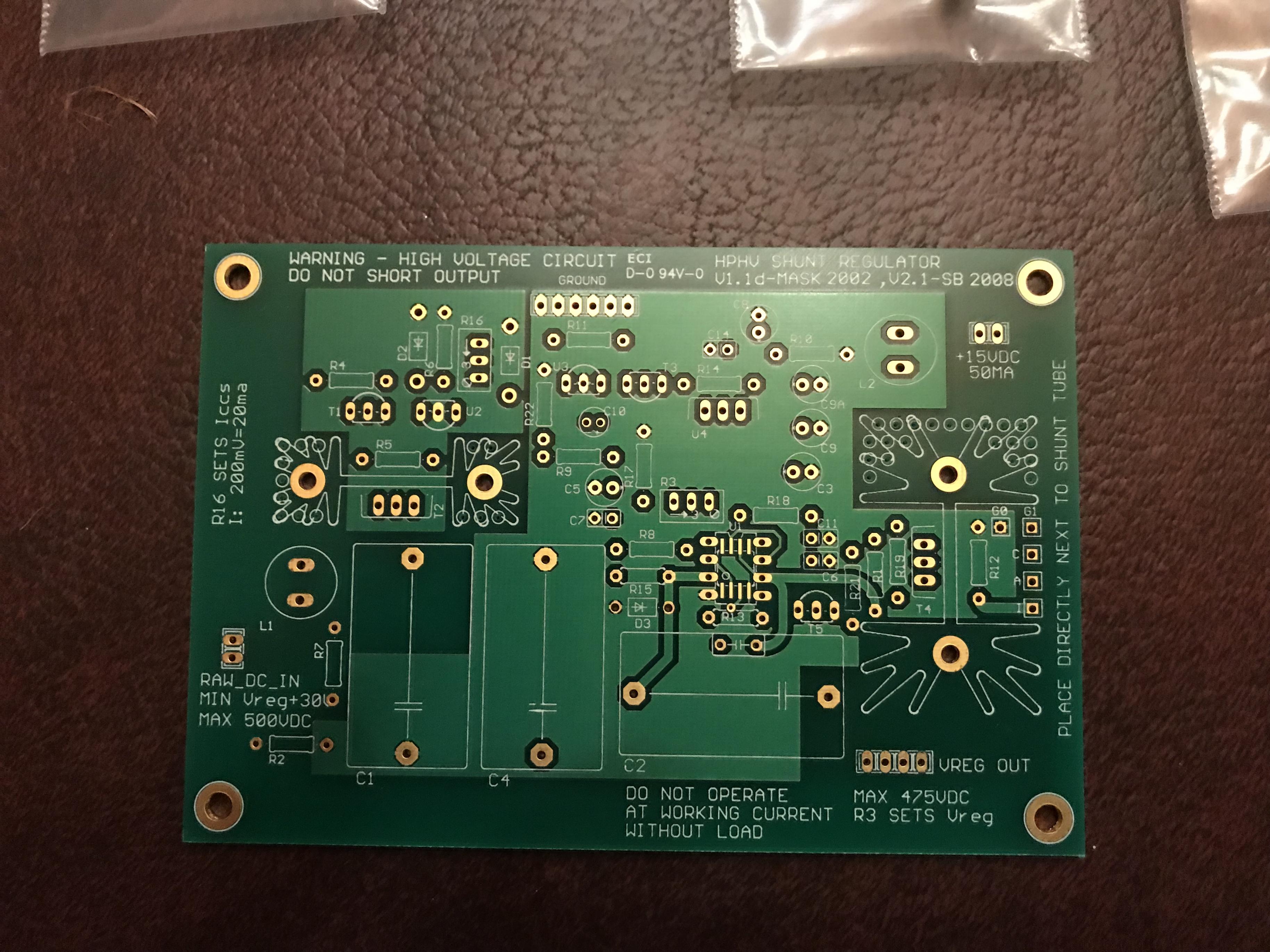

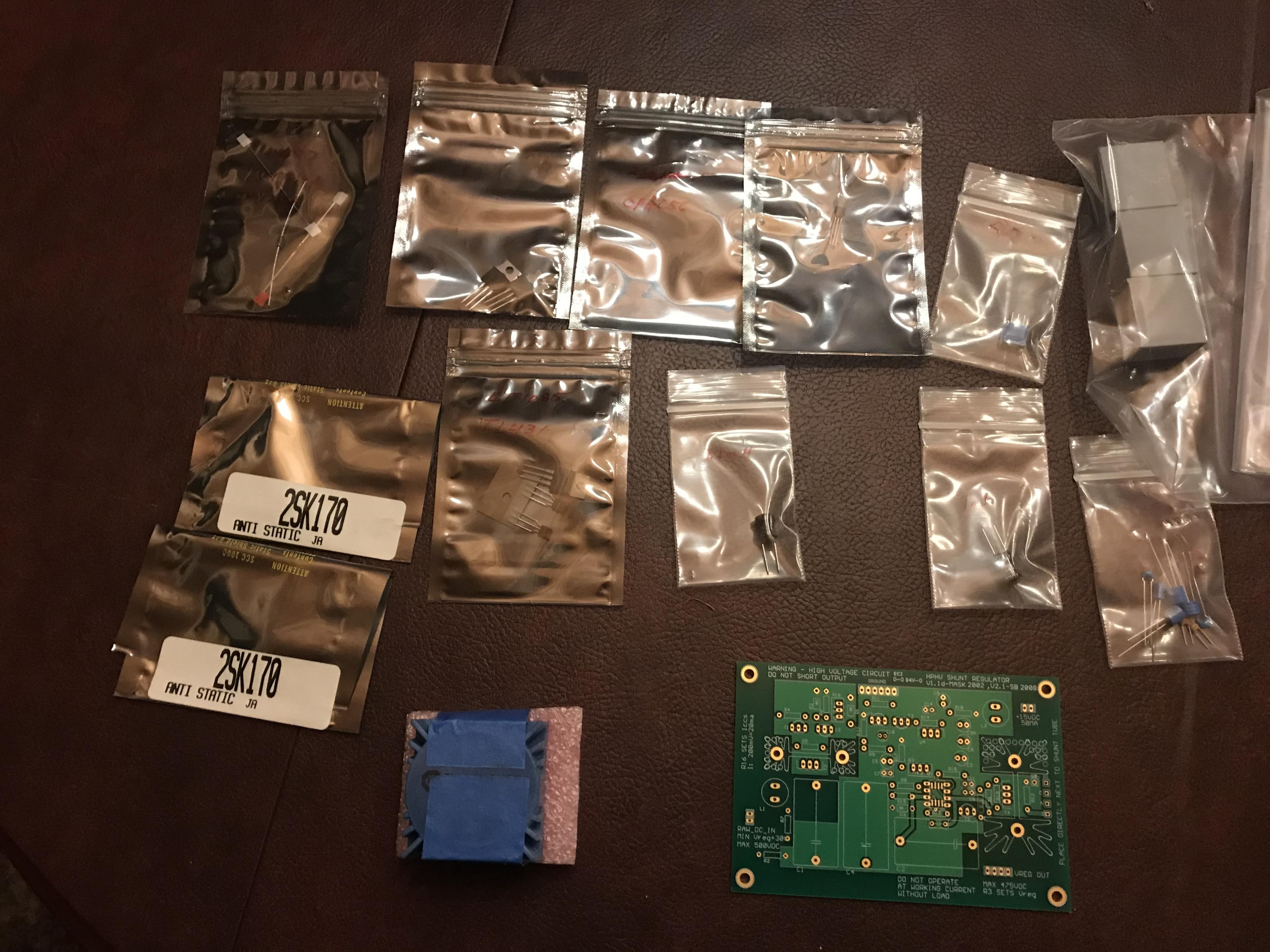

HPHV PCB & Parts
If anyone is still following this thread I have four HPHV pcb boards and almost all the components needed to stuff the boards. A close friend of mine passed away last summer (Nick_F) and I’m sorting through his huge collection of tubes and parts. Nick acquired parts to build 4 shunt regs and I’m offering them for sale on behalf of his estate. Everything to build a HPHV Reg is included except for Heatsink 2, R16, R12, C13 & C9,9A. Included is a 15V flat pack transformer, two 2SK170 jfets, the OPA656 op-amp and everything else on the parts list.
Price is $60 per kit plus shipping.
Cheers
Cheers
