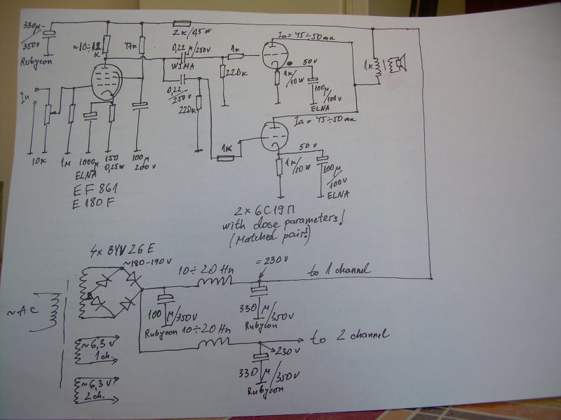

Sorry to my fool question about this supply,
Does it suitable use in SE 8W power AMP (serve to single channel) ? Or only apply to Preamp ?
Read the documentation, you can use an external tube control shunt element for higher power load. I never tried it myself, but it can be done. Can you select a suitable tube for your application, I don't know either.Maybe someone else can help you on that. Anyway the regulator documentation is a good start.
