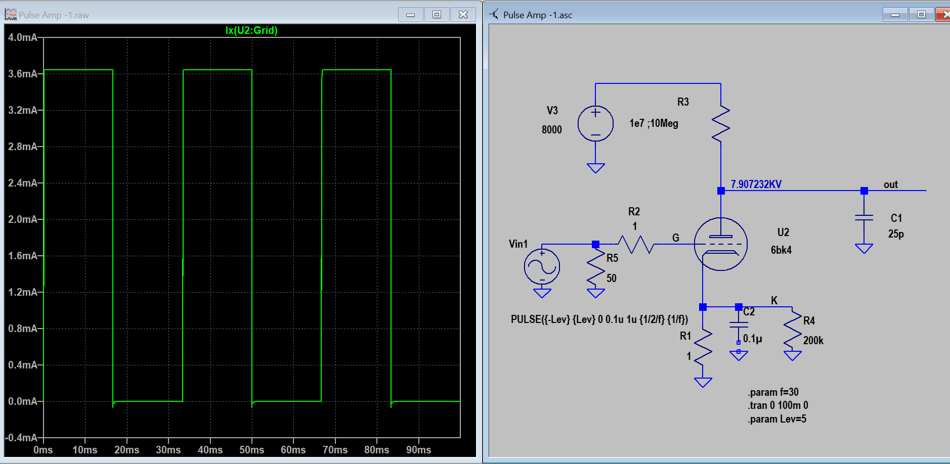

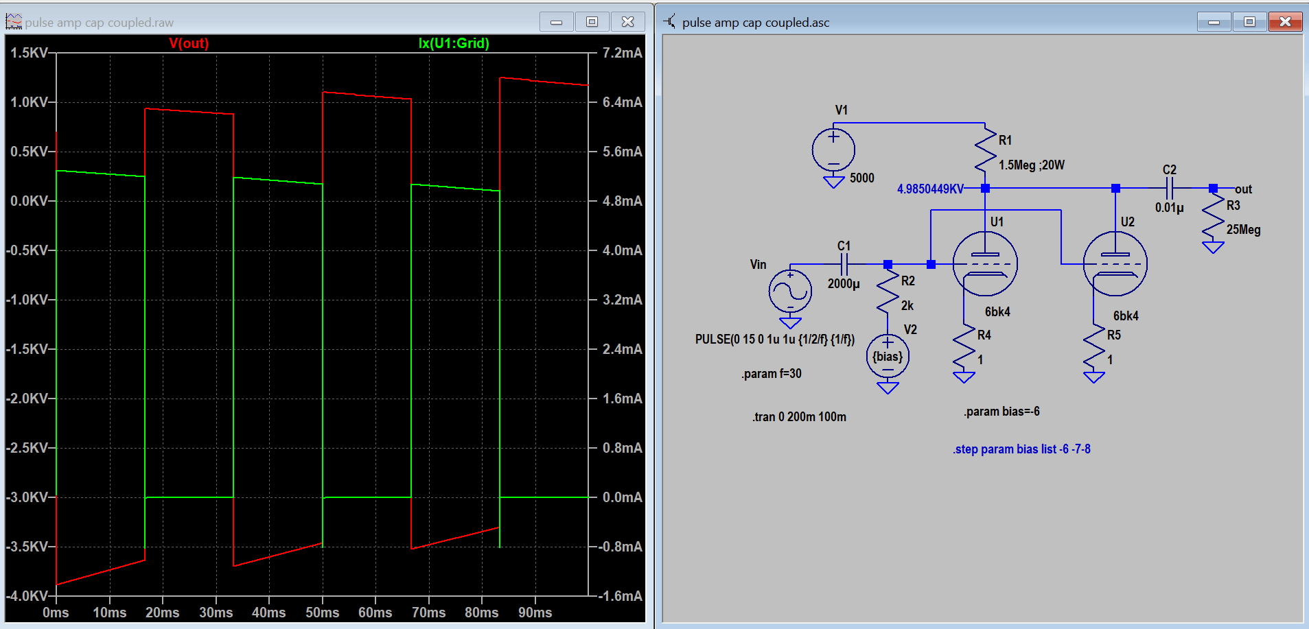

Attached grid drive current sim comparision with another project.
I notice an 700mA inrush of grid current, 0.1u in cathode has removed it.

That's good to see another using the 6BK4 in a pulse circuit.
Is the addition of the 0.1uf cap on the cathode what lowered the voltage of the pulldown voltage?
Previously I saw 700V, the latest graph shows about 200V.
Is the red line showing grid Current?
Is most of that thru the 50Ω or can that much current flow into the Grid? (measured thru the 1Ω resistor).
Thanks, Mikek

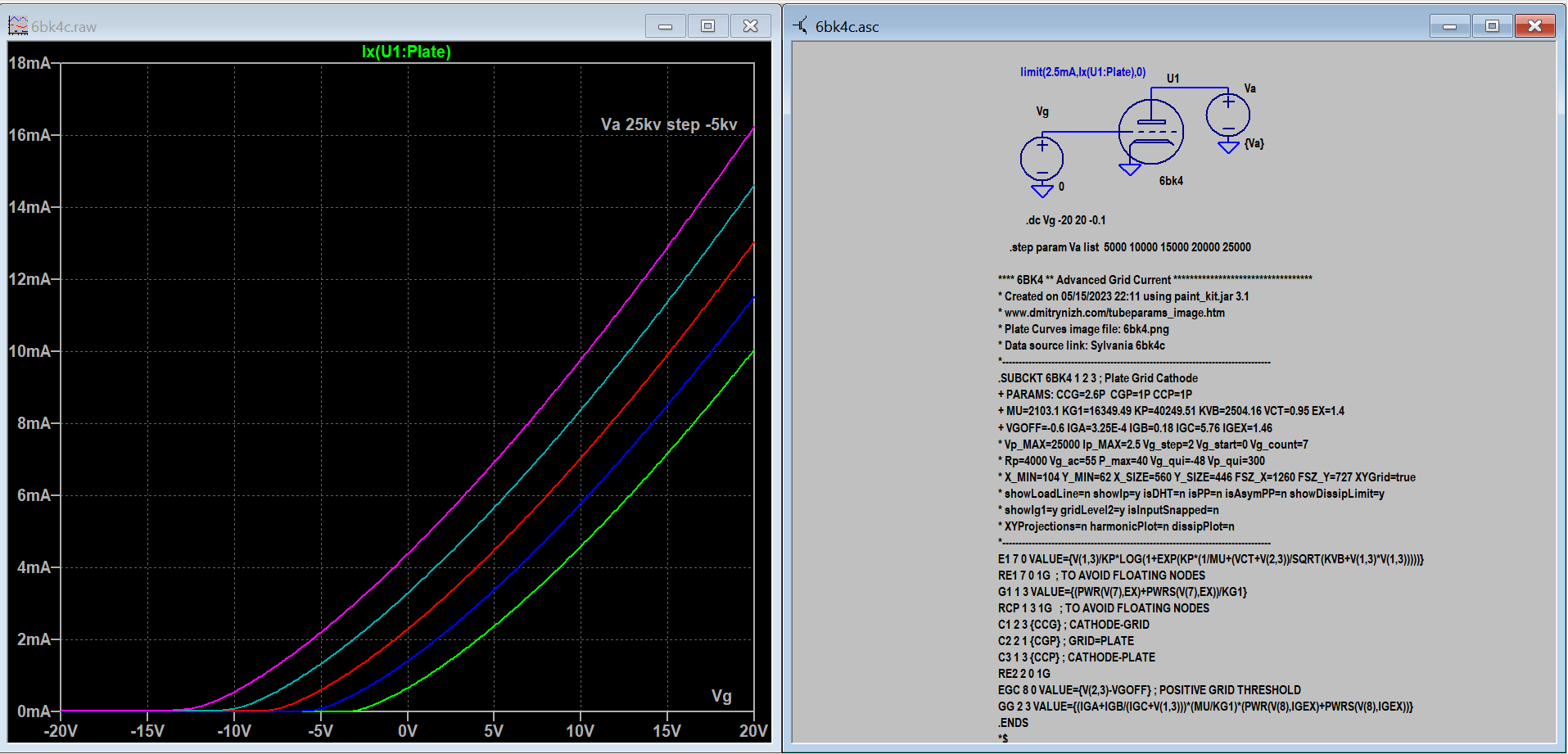

The first thing I saw was the 6BK4 spec sheet, it only shows negative voltages that pinch the tube into no conduction. But even in conduction the
grid voltage never goes positive, I'm assuming this positive voltage gives higher conduction?

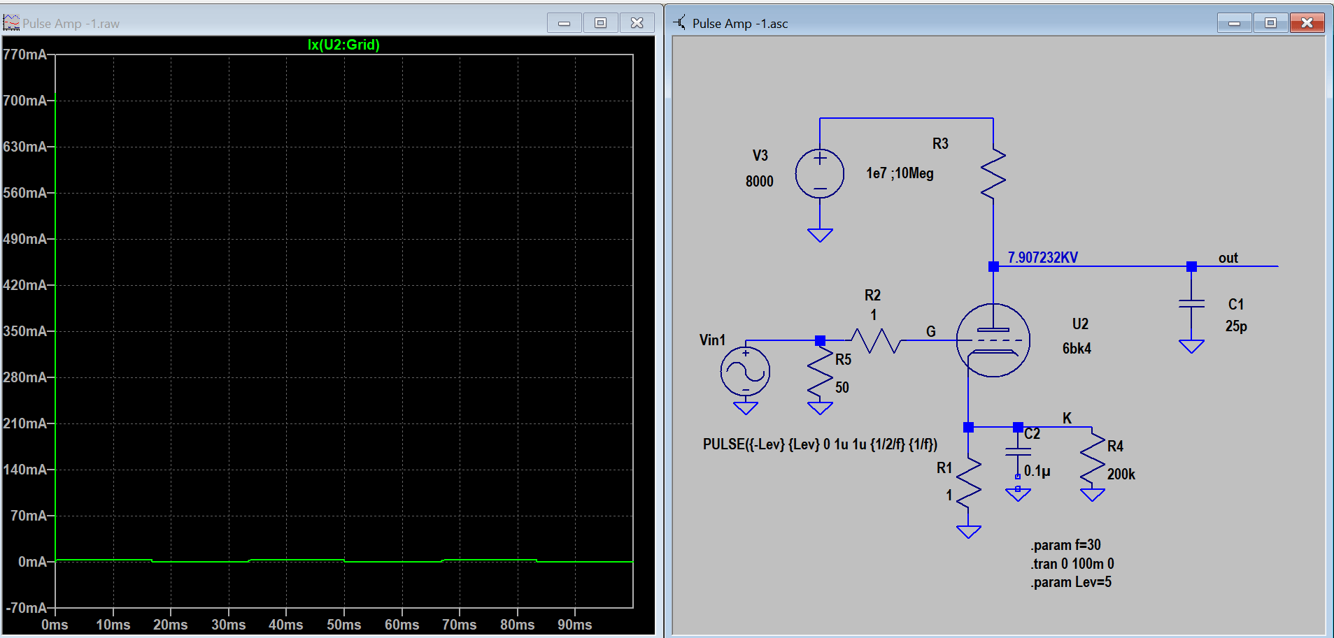

I changed Trise from 1us to 0.1us, the 700mA pulse has dissappeared, so look like it's the rise time is too large (slow) that causes the pulse to show up.
The grid current drawn is mostly when it's positive going, that is normal. In Hi-Fi amp this is called A2 Class amp.
Is only 4-30Hz, 0.1u is negligible, if you do see spike you can try to filter it.

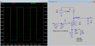

I'd like someone to expound on my question below.
I don't doubt it works as other have suggested the same, it just doesn't jive the with tube curves.
grid voltage never goes positive on the tune curves, I'm assuming this positive voltage gives higher tube conduction?
Thanks for clarifying, Mikek
It takes me a few days to answer the same question you ask 2 days ago. Here is expanded curve so you can see better. The original stop at zero, let everyone speculates beyond that, but with the help of model we hope we can predict it, and confirm in practical work. There are many amps such as 300B does not have curve beyond zero, yet they work ok in A2 mode. Because we deal with pulse then there is even less burden with tube in A2 mode. Others can jump in to expand further.

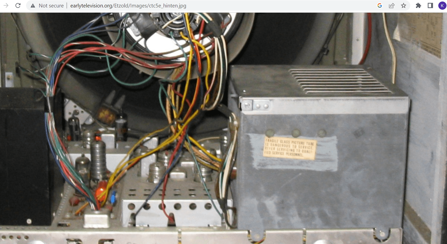

I'm using a 6BK4C, it is a leaded glass tube, should I still put it in a cage to prevent radiation exposure?
I'm running high voltages 8kv, maybe higher later.
If so, what material, space between cage and tube, i.e. how do I build it?
Thanks, Mikek
You'll need a shield for shock hazard prevention anyhow so you can use the same shield to add to to X ray radiation reduction. Many just recommend a simple shield, a steel cage as early colour TV. This article may help to decide on what material to use. You'll need a X radiation meter or GM (Geiger-Mueller) instruments, to verify against tube in use the level in tube specs and after added the shield.
