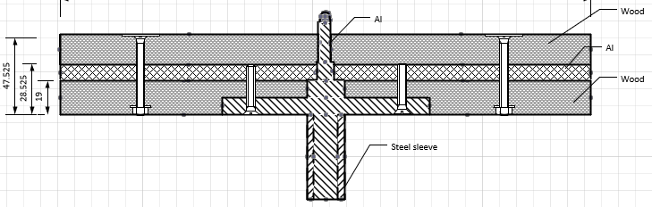

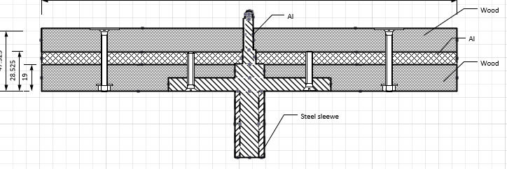

@Trzalica For a more complete view of your situation, consider adding a description of your WOW measurement method. Graph/screenshot of the measurements can be helpful as well.wow is between 1% and 3%
@Trzalica you could insert a hard metal disc at the bottom of the spindle, so that it sits on the steel ball. The aluminium might have an indent that increases friction.
The fact that the wow 1-3% problem makes me believe that something is sort of friction sticking at some interval. Reminds me of something that might be out of round too. The spindle is the assumed center of the bearing, but upon viewing the stylus in play, is there a back-and-forth slow motion as the record is being played? I could see where a hard spot in the aluminum bearing could cause something to happen as well. Keen mechanical observation is needed.
Steel ball is at the bottom of the bearing and the spindle has a flat (aluminum) bottom. I already asked my friend mechanic to reduce a diameter of bearing and spindle by adding a steel insert in bearing. He will polish both steel bearing and sintered brass spindle, as best as possible as well. I will also add a teflon insert at the bottom of a spindle so that there is no direct contact between steel ball and aluminum spindle.@Trzalica you could insert a hard metal disc at the bottom of the spindle, so that it sits on the steel ball. The aluminium might have an indent that increases friction.
... Diameter of the bearing shaft usually, for a platter about 5 Kg is 13 to 15mm, 30 mm is by far too big in my opinion. ....
I was just about making yet another BIG mistake by reducing a spindle to 9mm. After Adelmo recommendation i increase it to 14mm. Hopefully it is going to be good enough B)

My experiences to date of learning about a cause of Wow, is that a eccentric rotation of the Platter Spindle can be a cause of a measured speed fluctuation.
A Standalone Strobe such as Keystrobe will easily show Speed Fluctuation, especially where the Kookiness of the Spindles rotation might be the cause.
I would check that before remachining the bearing. Is the circle where the o-ring is running on concentric with the bearing? Ask your friend that does machining to come round with a dial gauge and put it on the surface the o-ring is running. Turn the table by hand and see if the dial moves.My experiences to date of learning about a cause of Wow, is that a eccentric rotation of the Platter Spindle can be a cause of a measured speed fluctuation.

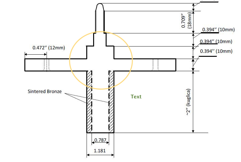

Probably too late to the party to be any help but I'm curious, What's the spindle detail inside the circle , and where does the platter sit?
It is never too late B) This is a whole platter, with oversized spindle, that is going to be reduced from 30mm to 15mm.
Trzi
Thanks SP,Hi, I wouldn't use aluminium for a bearing surface, you will get a slip-stick effect and that will react with the spring of the belt.
That was one of my mistakes, and it is going to be addressed shortly. Housing will be of sintered bronze and the spindle will have an SS sleeve.
