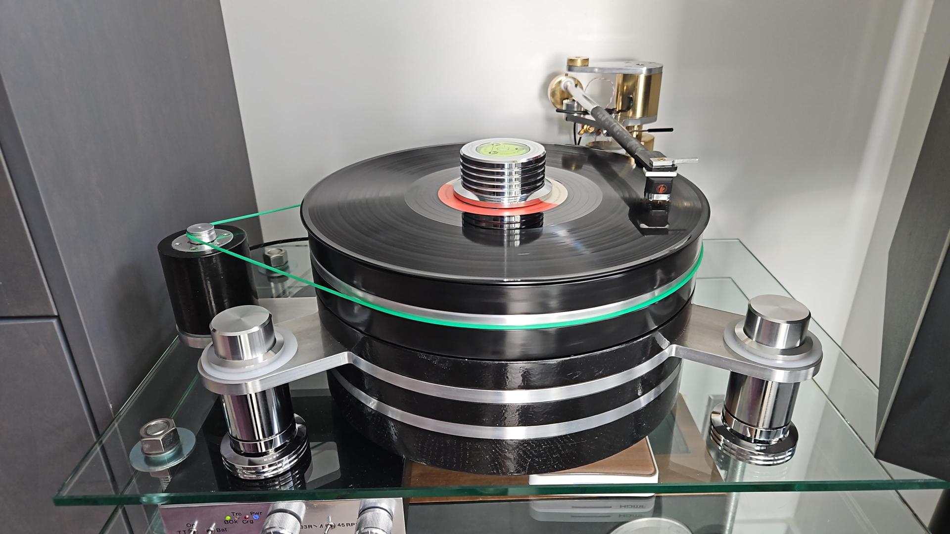

Thanks SP,
That was one of my mistakes, and it is going to be addressed shortly. Housing will be of sintered bronze and the spindle will have an SS sleeve.

THANK YOU ALL for valuable opinion and suggestions. It is fixed now by:
1. Changing shaft and housing
- Shaft is made of polished stainless steel
- Housing is made of sintered (oiled) bronze
- Diameter is reduced to 10mm
2. Pulley is redone with very tight clearance
Wow is reduced to 0.1% (or less).
Also, a round belt stays in place without a grove. Two wooden plates above and below AL one, where belt sits, are very slightly wider than the AL one so there is no chance of slippage.
Attached is a picture of entire turntable, including Schroeder tone arm clone, me, happy 🙂
