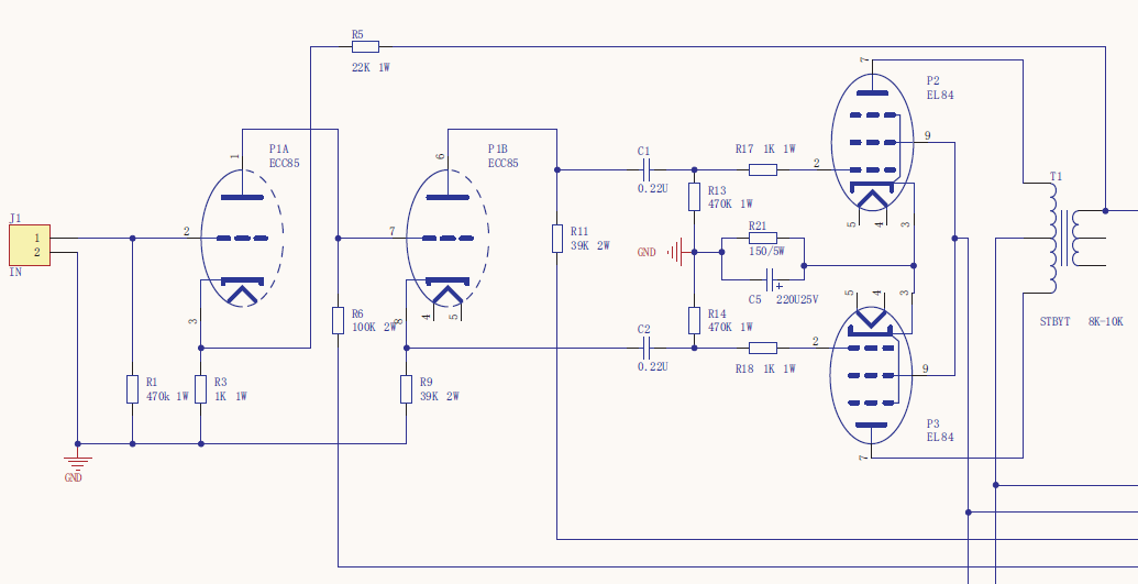

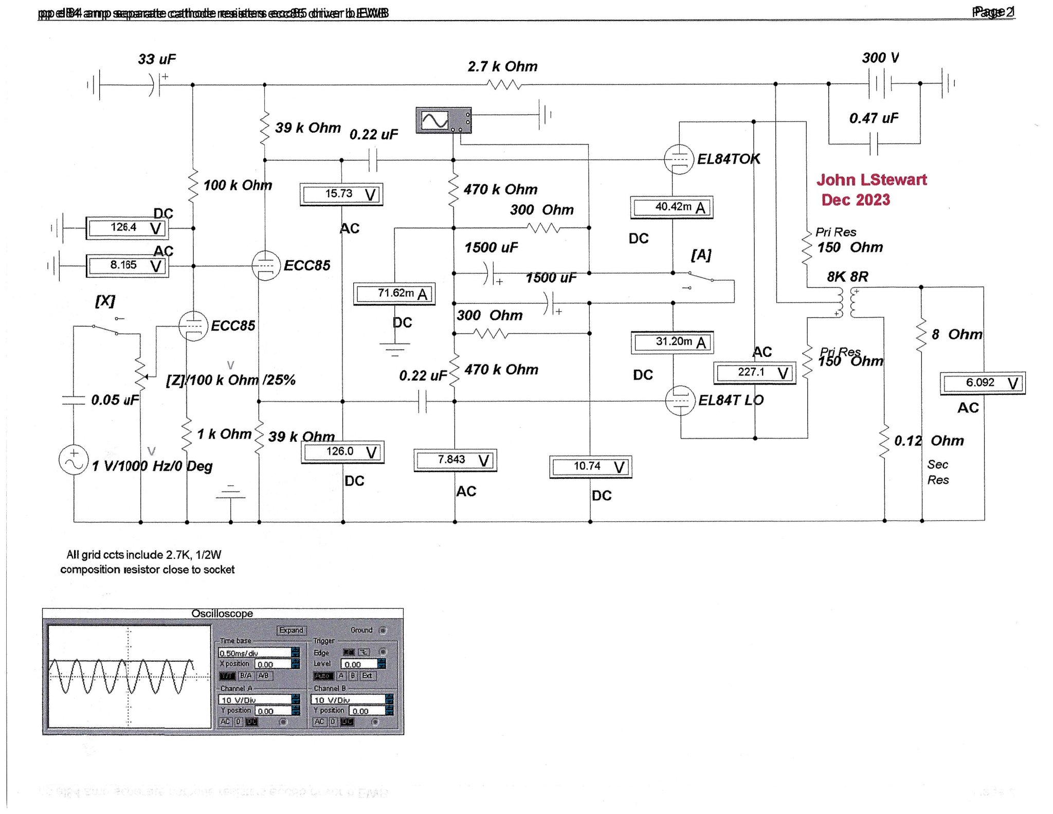

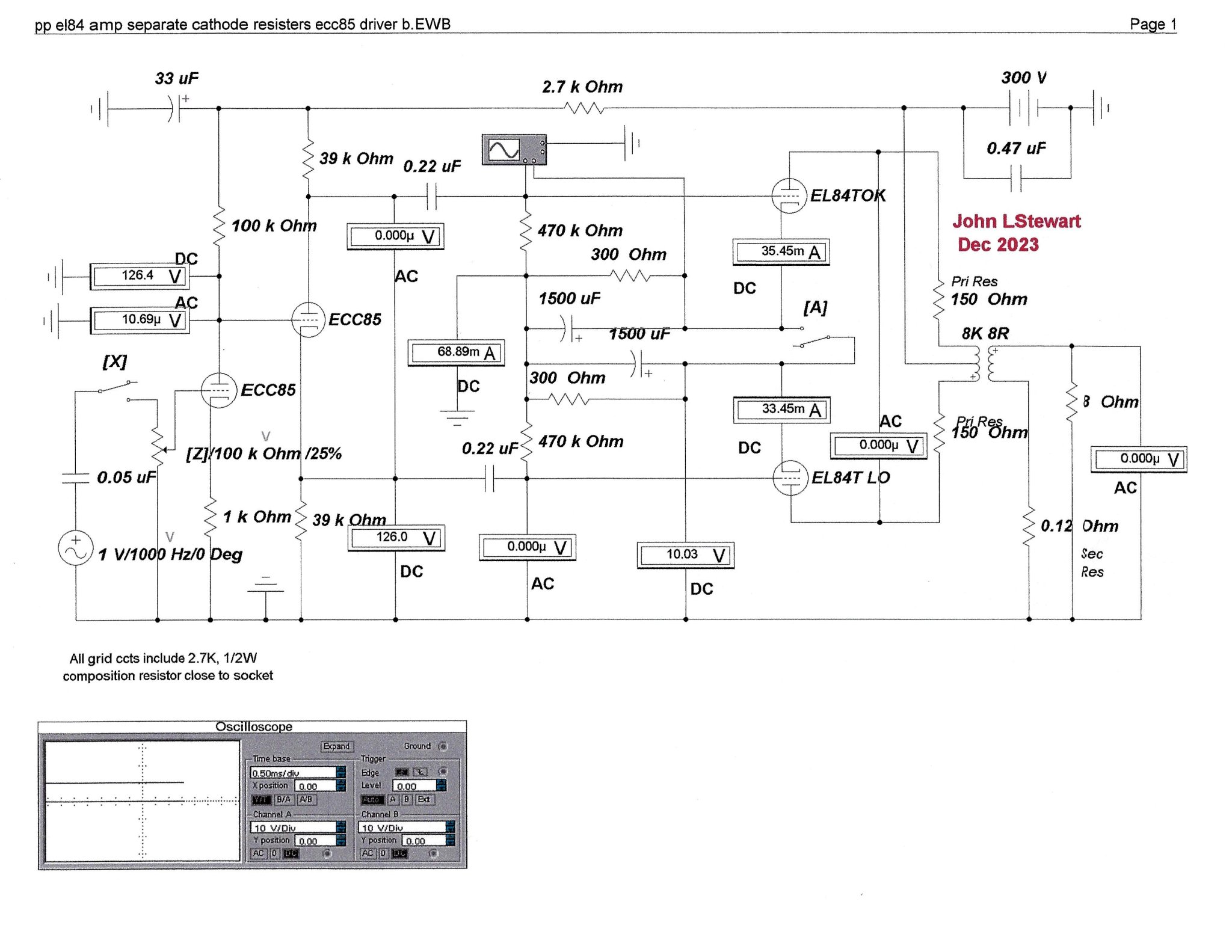

For the Faithful, the Curious & the Lurkers, how well do separate cathode resisters work to equalize cathode currents, all revealed here.

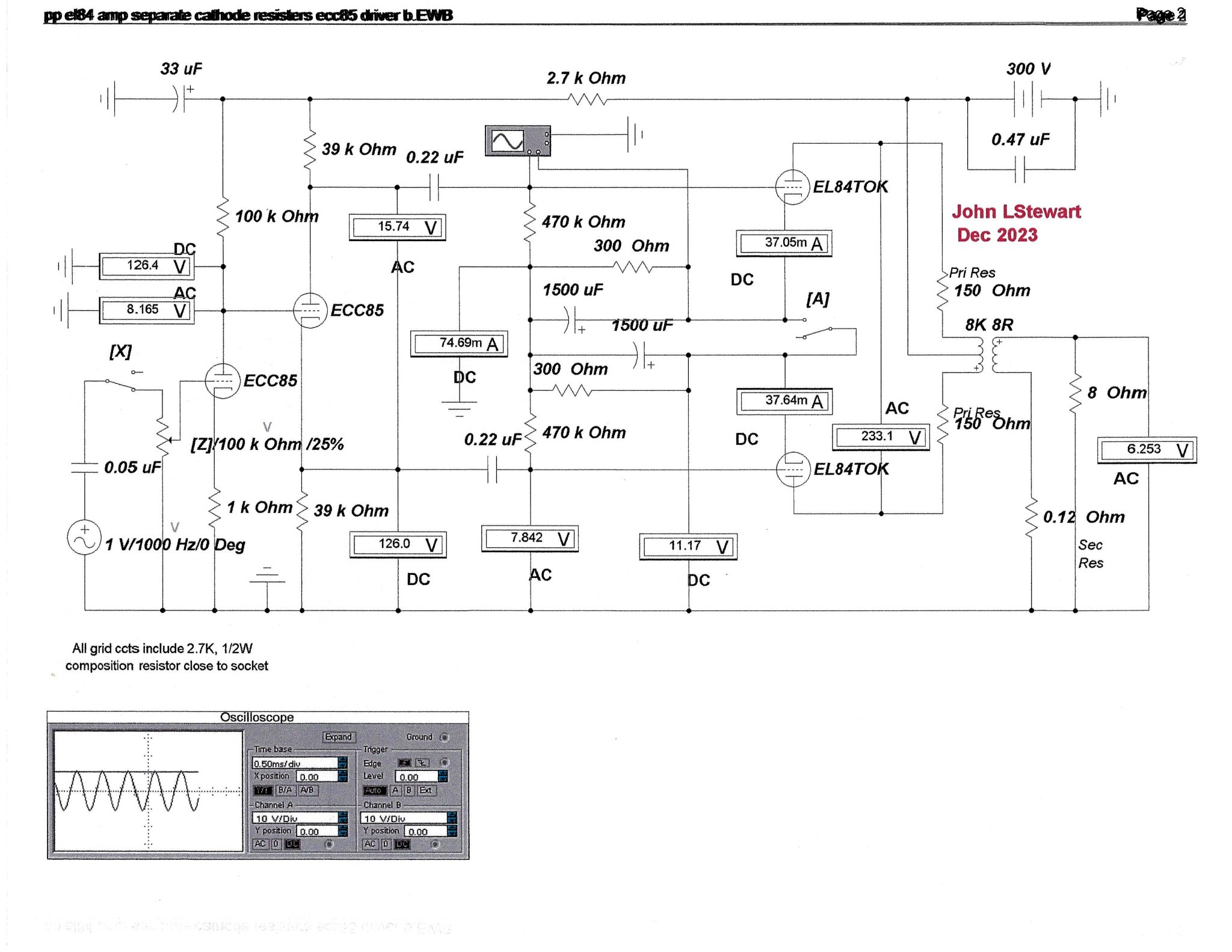

For this simulation I've used a circuit from NGO's previous thread, a PP EL84 driven by a common ECC85 driver circuit.
For the purpose of calculating standing currents, all reactive components may be ignored, they magically disappear at DC.
And pentodes are treated as triodes, at DC the OPT contributes only resistance. Plate current increases only slowly as plate voltage
is increased. But care must be taken for plate dissipation.
For the simulation I've used tube spec's found on the published data sheets. I've purposely set the emission of one of the EL34s 25% low.
When switch 'A' is closed the cathode resisters become a resistor of 150R common to both cathodes & the cathode currents are far apart.
Opening switch 'A' each EL84 has its own independent DC degeneration & the difference in cathode current drops to ~6%.
How Kool is that? Watch this space for the next exciting episode!👍

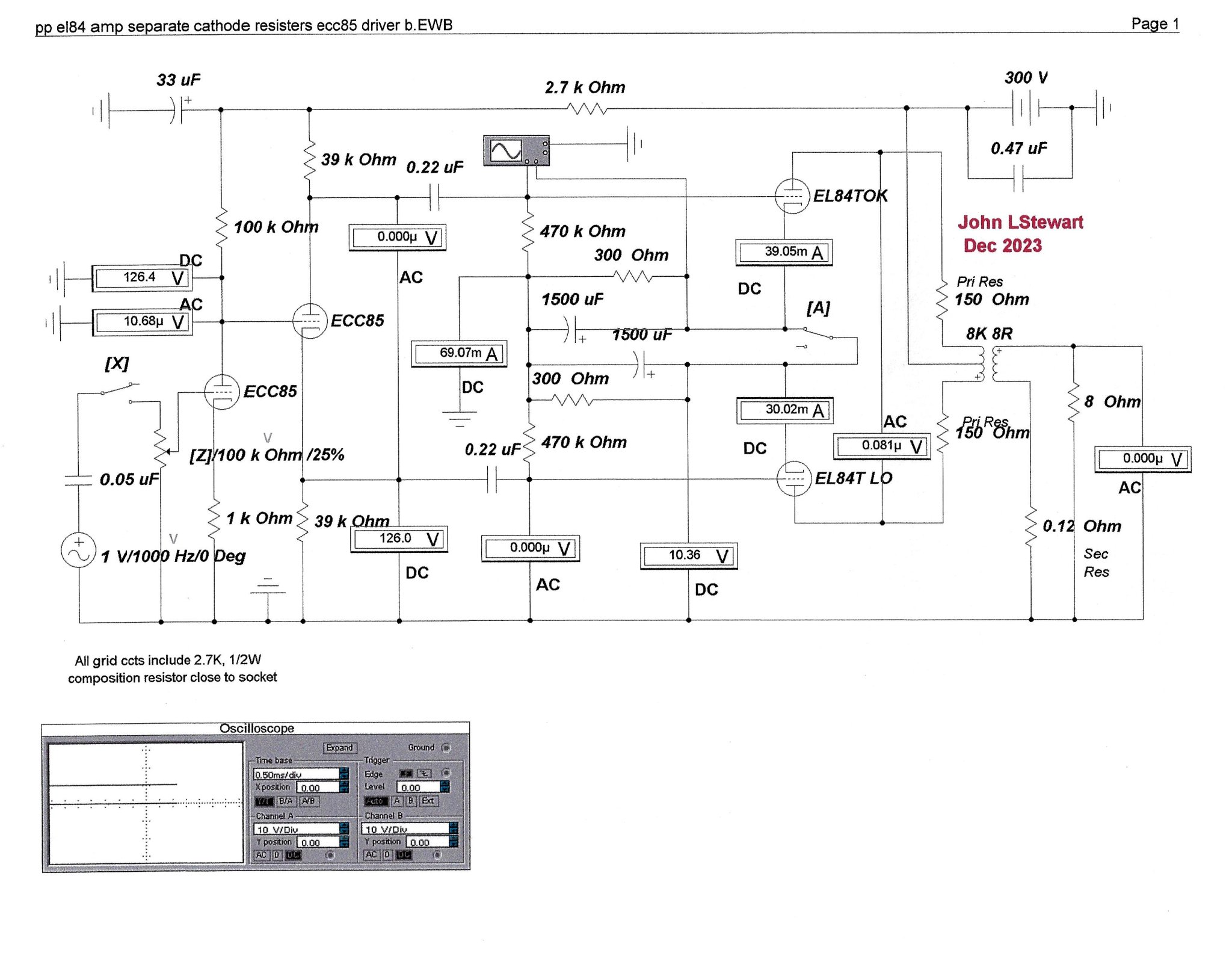

More for those brave enough to be still here.😀
Sim one shews the condition when 1/4 volt is applied to the input grid with a weak tube in the output.
Sim two demonstrates what happens when just one cathode resistor is used.
Sim three is what everyone would have, a perfect amp, all toobz in spec.
And of course it 'Sounds Great' , whatever that is.👍

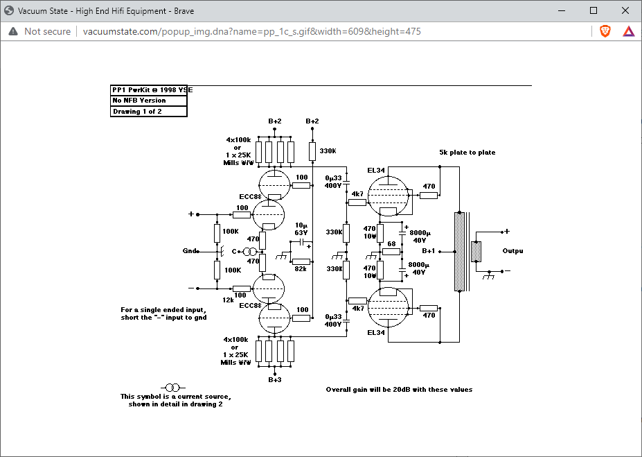

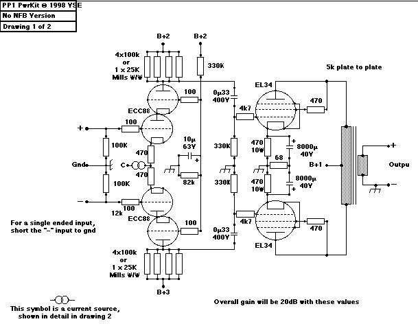

Has anyone ever tried this trick? I forget where I found it:
Instead of a single cathode resistor to ground, use individual cathode resistors to ground. Connect the cathode bypass capacitors together and then ground them through a single resistor of around 14% of the value of the single cathode resistor. This will reduce IMD and 3rd harmonic.
It was attributed to Allen Wright from Vaccuum State using this schematic as an example: http://www.vacuumstate.com/
One problem I see in the schematic above vs. the description of the values to use is that I calculate a 32.9 Ohm resistor instead of 68 Ohm? If that amp used a single resistor, it would be 470/2 = 235 Ohm, correct? Then, 235*0.14 = 32.9 Ohm not 68 Ohm. Something doesn't add up. 🤔
Also, there must be a downside, or is the only downside the cost and complexity, which is not very much? Has anybody tried this trick?
In this case, the downside is you are trying to graft this & perhaps other mods to an existing pcb for questionable improvements.There must be a downside

In the example above, 14% of 470 is 65.8, which explains the value of 68 Ohms. The question is, why 14%, and does this actually work? I can't find where it was posted. I copied it into my notes a while back.

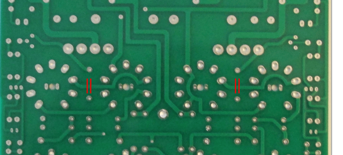

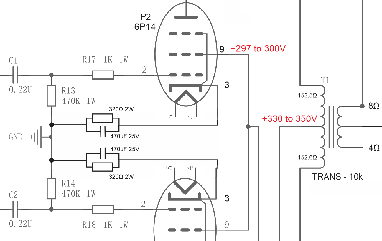

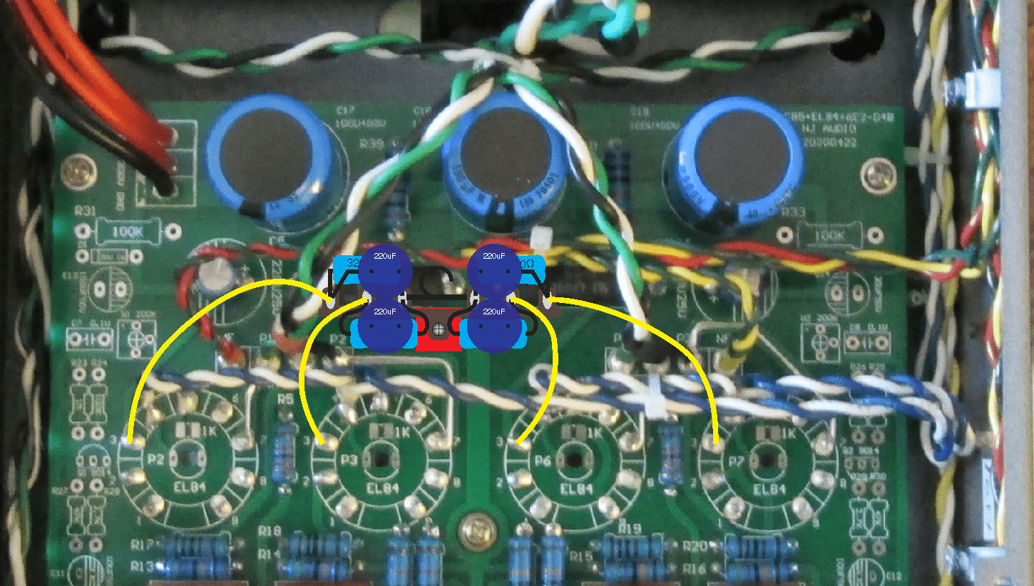

For bias, instead of two 160 Ohm 5 Watt resistors I should use four 320 Ohm 2 Watt resistors, correct? Each one is bypassed with a 220 or 470uF cap, correct?
If that is correct, I did a scale drawing, and I identified an area on the board (in red) where there are no traces on either side, so I can drill a mounting hole there with no harm. I can assemble what I will call a "bias module" off the board, using a 6-lug strip that I found at Mouser, and then mount it to the circuit board with a bolt and nut. There is plenty of room. Four short jumper wires would connect each tube to its resistor and capacitor. A short jumper connects all of the negatives to the ground point, which just happens to be right in the center.
Carefully cutting the PCB traces on the other side of the board (the top of the PCB where the tube sockets are) as shown below will sever the connection between pins #3 on each channel, leaving me able to connect each one independently using the jumpers shown above on the other side (the bottom) of the PCB.
It would end up looking something like this inside. The red, black, yellow, and green wires are the negative feedback connections to the PCB. They can be rerouted if needed. I would have to consider this a permanent installation as you can see how difficult it is to work inside this chassis. I was hoping that I could easily change the resistors and capacitors to experiment with different values, but having drawn it to scale, I now see that I should plan on getting it right the first time.

I finally found it!
I usually prefer fixed bias, but when I do cathode bias, I use Allen Wright Vacuumstate's trick with the cathodes:
Use individual cathode resistors to ground, then connect the cathode bypass capacitors together and then ground through a single resistor of around 14% of the value of the single cathode resistor. This will reduce IMD and 3rd harmonic as well (there are some tests performed on this forum).
Good to see the schematic is still out there in the multiverse.
