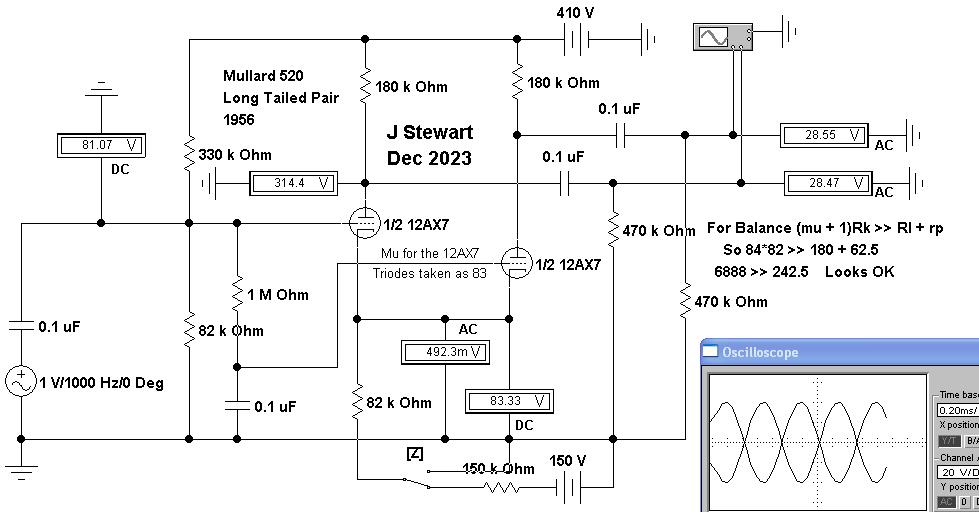

Moving this here for further discussion as it's a little over my head right now. Attachments from the post are included here as well.
Step 1, remember how math works and all of these notations. 🤔
I haven't used LHS, RHS, >> in a long time. Left side of equation much greater than right hand side.
formula: (mu + 1)*Rk >> rp + Rl
Is there an article or thread, 1) Explaining the formula with examples, and, 2) How the change makes this improvement? The device looks simple enough to implement physically.
That's me.
I am surprised that 1.45% is not sufficient. Is it that the two halves of the split signal come out "lopsided" in relation to one another due to this difference?
What does this mean?
I didn't know what OD3 and OA2 were so I looked it up. Gas-filled voltage regulator tubes. Interesting. No room for them though.
Perhaps you can help me figure out how to implement this on this build. I'd like to understand this modification, and then I would need help implementing it on my schematic with my tubes - specific values, connection points, etc.
This is very interesting. 🤓
During the long development of NGO’s amplifier, I vaguely recall some discussion of the Mullard Long Tailed phase splitter. Here is an item I don’t recall ever getting properly analyzed.
For good balance of the output signals to the following stage, it is required that the circuit satisfy the relation (mu + 1)*Rk >> rp + Rl. Taking Mu to be 83 as a worst case, the LHS of the relation calcs out to 6888. The RHS is 242. And the simulation tells us tells us the signals differ by 1.45 %. That would be sufficient for most applications.
But that difference can be reduced quite a bit by installing a longer tail. For those who don’t want a SS device in the audio path, a simple resistance to -150V is an alternative. And the difference reduces to 0.28 %. 150V sets a safe limit to avoid H-K insulation damage.
The negative voltage can be easily derived from the same HV winding on the PT as the B+. And can be used to provide biasing for a fixed bias stage as well. An 0D3 or 0A2 will set the -150V. Or Zeners if desired. Some people like to see the gas tubes glow. I’ve found they are more stable than Zeners. Zeners are very much affected by temperature.
I’ve done this on some builds. Both positive & negative voltages are rectified from the same HV CT winding of the PT. No odd taps are required. And the rectified result is full wave for both polarities. The rectifier modules are constructed on simple terminal strips. All screwed to a supporting scrap of wood during assembly & soldering. When finished the entire module is installed in the chassis as a single unit with connecting wires already in place.
There is more to this equation, maybe later. 😀

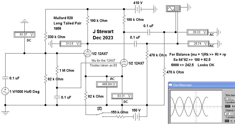

That's me.

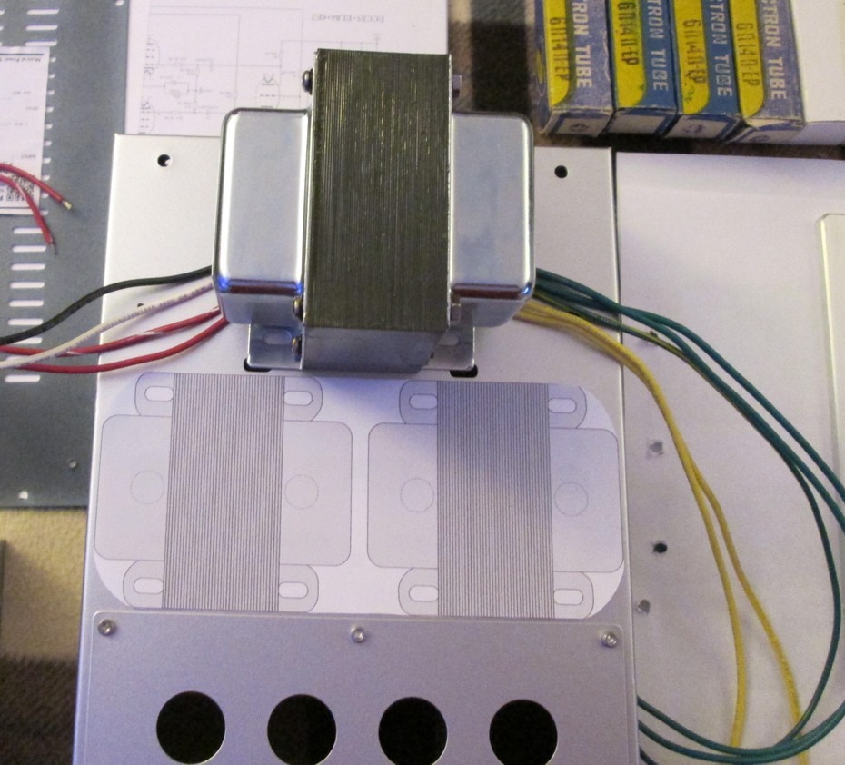

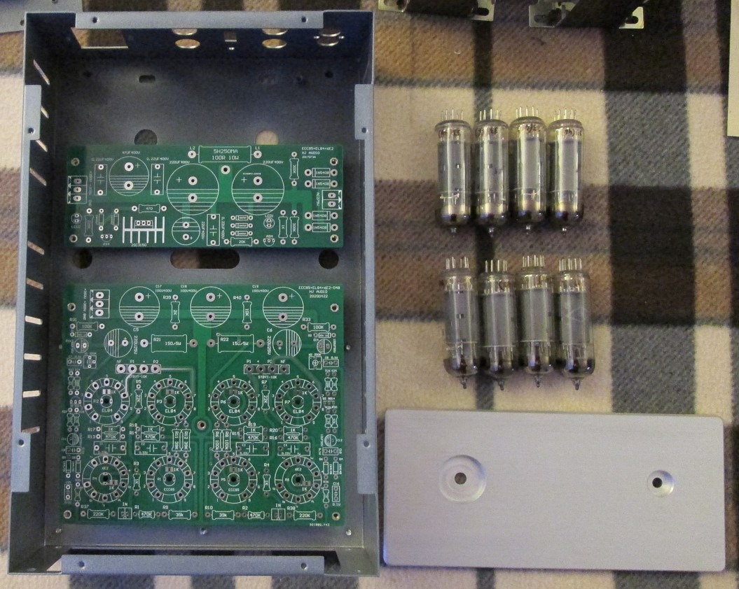

The chassis goes together like this:
The chassis is heavy steel, not thin sheet metal. It has two top plates.
The front top plate covers the amplifier PCB with holes for the tube sockets. The PCB is mounted underneath and the tops of the tube sockets are flush with the plate, for a clean appearance. The holes with the red Xs are for the magic eye tubes that I just leave out. I plugged the empty holes with 1" black plastic plugs from the hardware store last time, but a clean top plate without the holes would be nice. Aluminum would have to be significantly thicker than the steel to have any strength at all. It has to withstand the force of tube insertion and removal as the PCB standoffs are mounted to it underneath.
The rear top plate serves to reinforce the chassis, and it holds the boxy transformer cover in place. That plate and the transformer cover will not be used this time in order to get the extra space required for much larger OPTs. I think a steel reinforcing bar inside, across the bolts of the power transformer, will be fine. The power supply PCB underneath has standoffs that should leave enough clearance for the reinforcing bar.

I drew a new top plate in my graphics program and uploaded it to https://sendcutsend.com/ and I can order one anytime I want. They have a $29 minimum and it's only an $11 item though. I'll wait to see if I need anything else. If not, I'll just plug the two unused tube holes for the magic eye tubes.
I also bought a bunch of new empty tube boxes because most of the old Russian tubes don't have boxes. The exception is the quad below, which came in original boxes and with original Russian spec sheets. I need to run OCR and translation on the spec sheets.
The power transformer arrived, and it looks like the Primary Windings OPTs will just fit with it. It would be a tight fit, but no tighter than the stock transformers from China. I'm not sure why the new power transformer (made in USA) uses fewer laminations than the one from China. The laminations are the same dimensions but there are fewer of them. Maybe it's better quality iron.
It concerns me that Primary Windings isn't answering email, but I'll give them a few more days. Their OPTs would be about the same size as the power transformer.

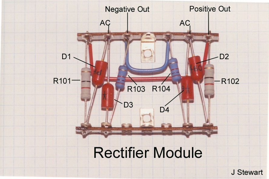

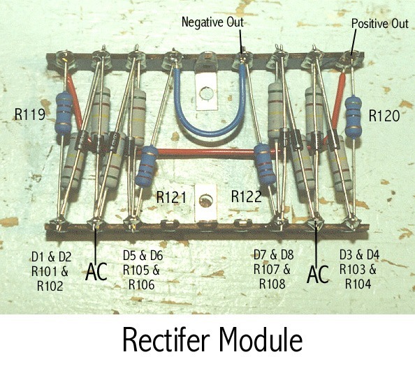

That segment of a circuit was used in the very successful Mullard PP amplifiers of the 1950s,I am surprised that 1.45% is not sufficient. Is it that the two halves of the split signal come out "lopsided" in relation to one another due to this difference
I had thought I'd seen reference to it by someone early on in one of your threads, So that piece I did is just a filler.
Read on for some quick history,
David Hafler’s company was primarily in the transformer winding business. He & Walter Keroes came up with the unique idea of the tapped OPTs, something that had come out of the 1930s. But had seen no serious use. The damping factor of such an amplifier, even without full loop NFB would be about One. Some folks labeled this Unity Damping. That worked well with various but not all loudspeakers. And higher damping could be easily got with some full loop NFB. All this was possible with the new high G power tubes. And they called it Ultralinear.
Out of this the Dynakit was developed & sold very well. But some thought the very simple pentode-triode front end phase splitter was a little lacking in performance. As time went on many circuits were devised for an improved front end, the Mullard solution was one of these. And circuit boards were built to be sold, in many cases grafting right onto the Dynakit chassis.
Some of the folks here on DIY are probably familiar with these boards & who produced them.
Something for people to keep in mind for future builds.👍
