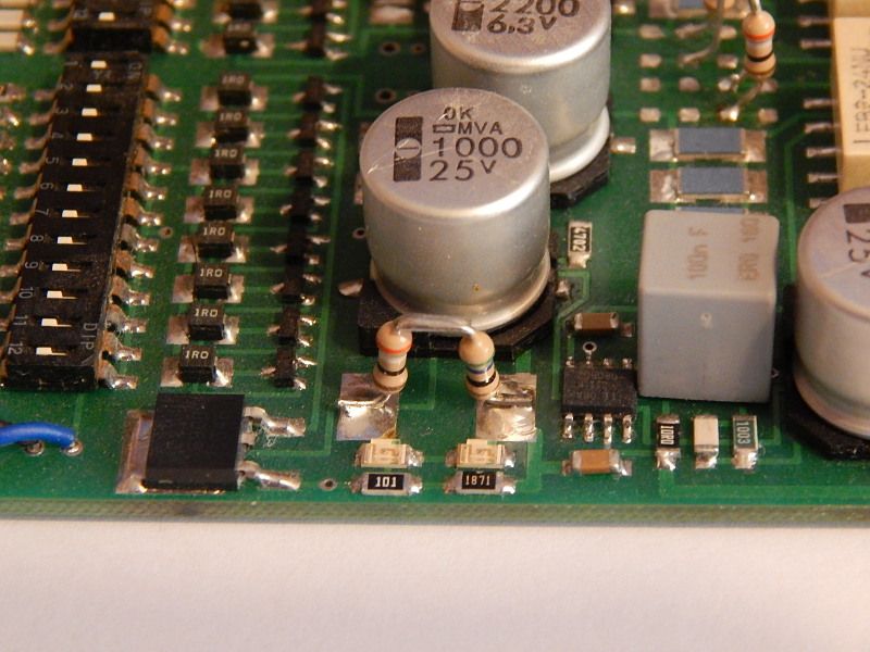

I bought in a local store 1008 SMT package 1 micro inductors declared as ceramic core. But they are attracted to magnet so I think that core are ferrite.
Soldering pads on PCB are for 1210 package but at Mouser I was not able to find any similar to original HPS 5.1 picture. What would happen with magnetic core inductors in circuit?

They are ferrite core inductors. Ceramic core have much higher DC resistance (longer wire).
