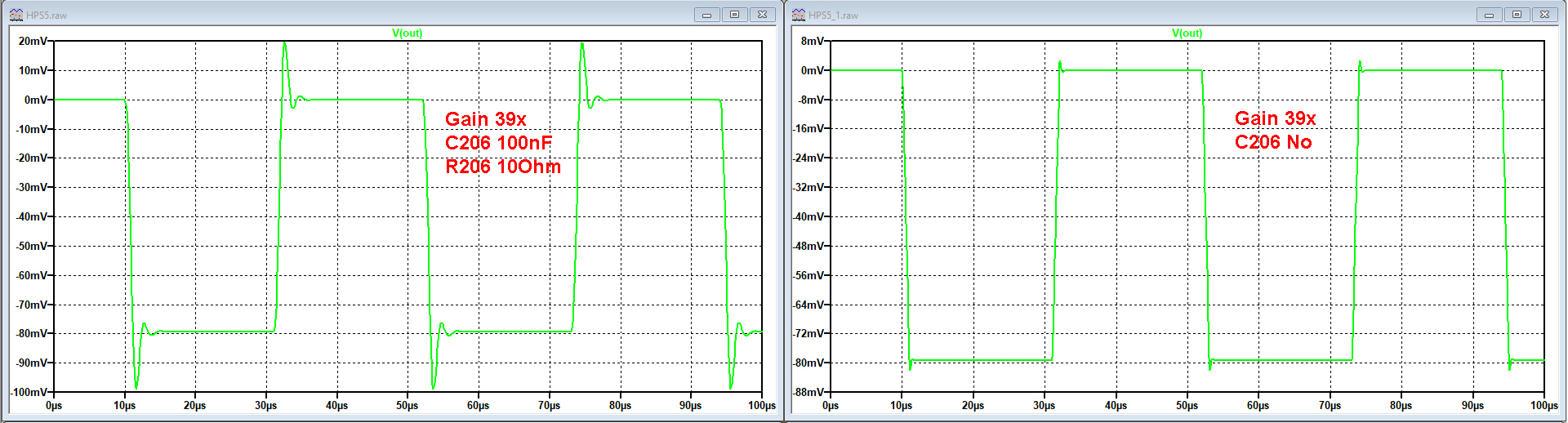

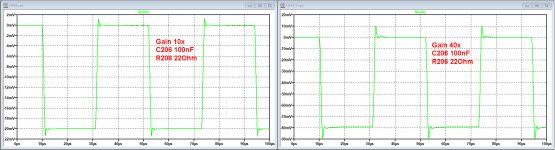

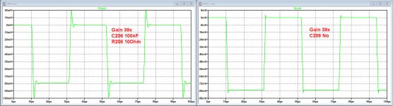

Yesterday I looked at the Head-amp with a Gain of 40, as needed for a MC Cart.
In that case, the 100nF can be discarded and has a negative impact on the step response, see first image below. Left with 100nF, right without.
In the 10x setting, as needed for an MM cart, the 100nF +10 Ohm are required for stability.
So when you are not going to use this preamp for MM Carts, you can discard the 100nF. In that case you also won't need the relay and the 47 Ohm resistors.
In case you want to leave the option open for using both types of Carts, I found an improvement when increasing R206 from 10 Ohm to 22 Ohm.
See second image below.
However be aware that there can always be a discrepancy between a Sim and the real thing, so you will have to test the change to 22 Ohm.
Hans
Hans

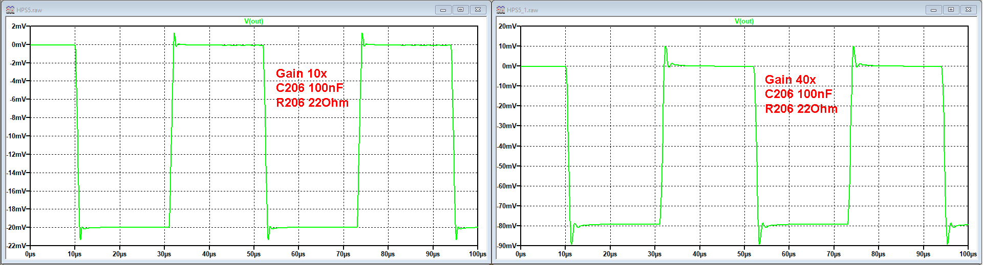

Connecting a simulated MM Cart (580mH + 460 Ohm) in the 10x gain setting gave no problem with 1uH Coils.
But a low impedance source (high output MC) in the 10x position gave immediate trouble resulting in oscillations in this gain setting.
When having trouble with oscillations, first try to lower the 8 coils to 10 nH.
When this does not sort any effect, try to lower R206 to 5 Ohm.
Avalue of 100nF /5 Ohm seemed to be working in all cases with several different Op-Amps, but in most cases this will not be needed.
In case of using the OPA 211, I measured 41nV noise from 20Hz to 20 Khz, equalling 0.29nV/Hz^½ input noise.
Using a 4.5nV/Hz^½ Op-Amp resulted in a slightly increased 0.35nV/ Hz^½ input noise.
So to conclude, in the 40x Gain setting C206 seems not to be needed in most cases, but is mandatory when using the 10x Gain.
C201 can be better set to 47pF, just as specified in the original documentation.
When using an MC cart, simulations suggest not using more than 10nH for the 8 input coils.
An MM Cart can very well use up to 1uH input coils.
Hans
