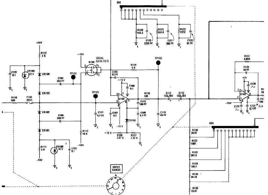

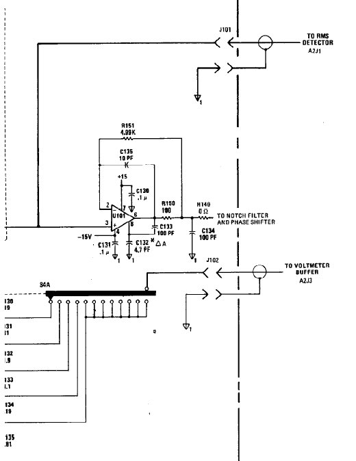

So, if I understand y'all correctly I'd do the following:
1. Remove & replace U101 w LT1468 pin 8 bend up.
a. thus c132,c133,c135 have no effect.
davada's recommend to remove compensation from U101:
2. Remove c130, c131, c134? replace with bus wire?
Why wouldn't I also replace U100 while I'm in there?
3. Then the AGC to JFet, trim pot, TP103 w/
the 3K 10-22 turn pot.
4. Bipolars to c111 c112
5. Looking around for the 2H level trim pot...
5K 20 - 28 turn...
Looking for the other bipolar locations
and the other pot to change.
Have to find the other output level too,
but I'll get there as time permits.

If you're going to replace op amps in the analyzer you will need to adjust the FB cap value.
If you look at the data sheet for the LT1468 or design notes for the same, There is a formula for calculating the FB cap value. However it typically about 7pF to 10pF depending on the value of FB resistor and circuit gain. Remove the 100 ohm decoupling resistor it reduces the current in the FB path. You may need to adjust the FB cap value to flatten the band width.

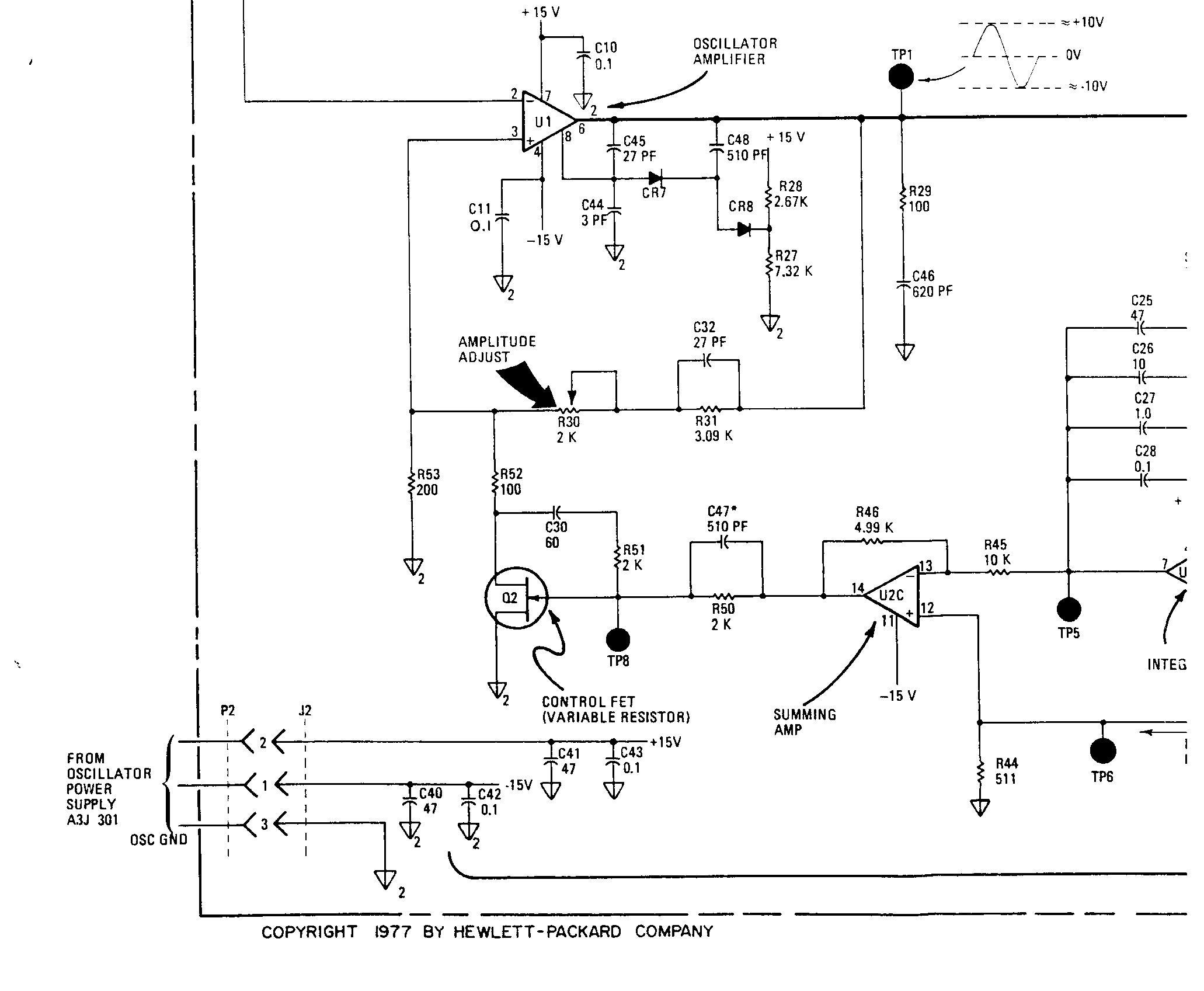

No reason not to change the buffer amp in the oscillator but RM found the stock to better job.
The is no second H trim pot you have to add that.

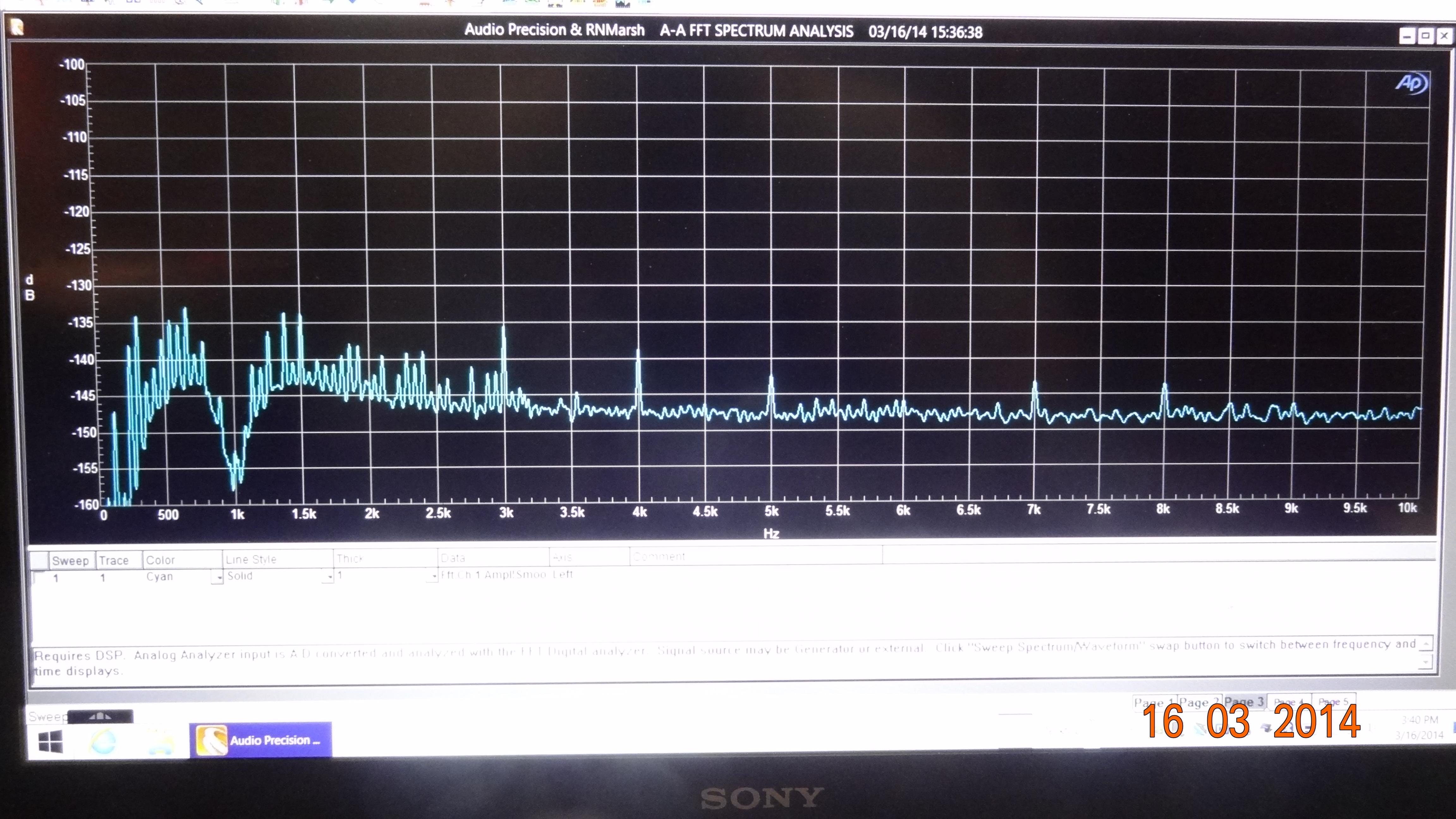

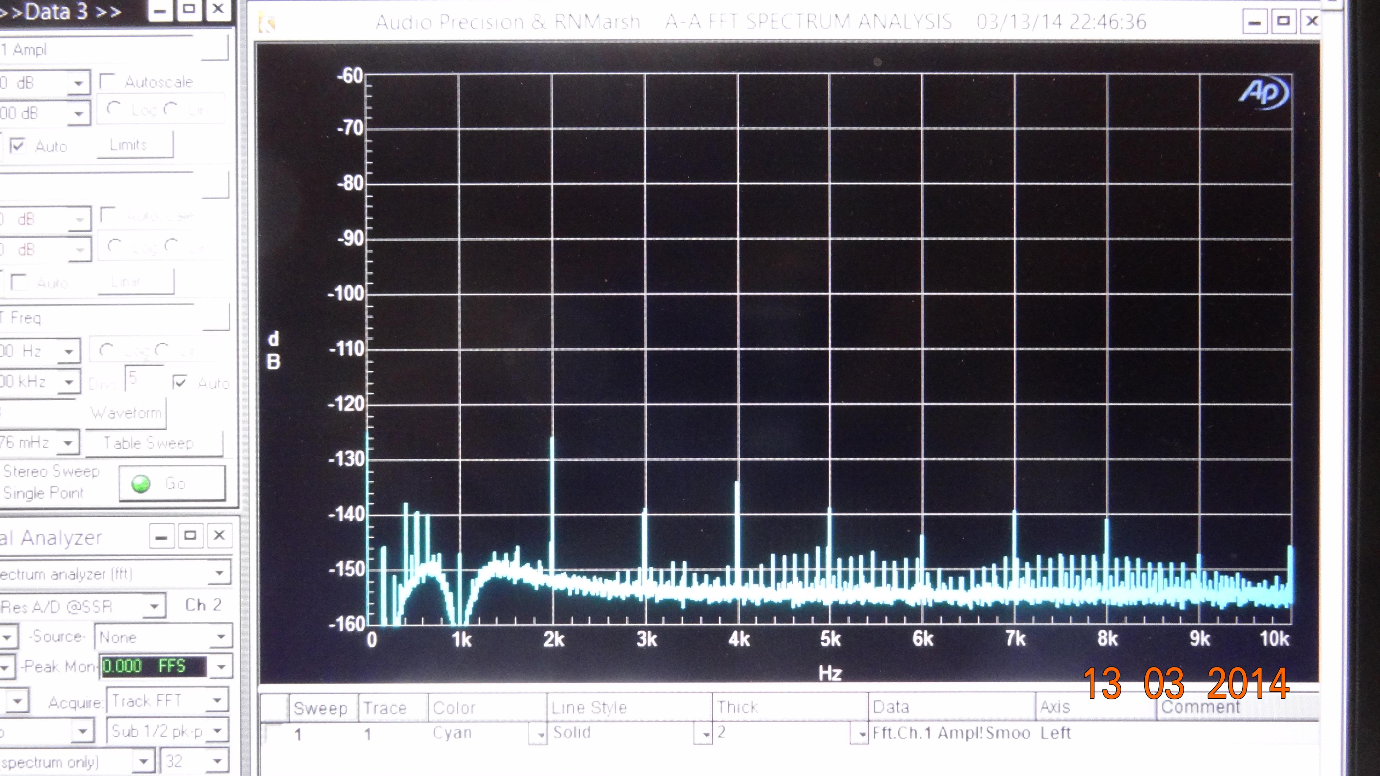

I have tried the amp/buffer following the oscillator. It seems like a natural to do also. I have not seen consistent improvement.... but it wont hurt either. I have several 339a here and on the first one I changed every opamp and other IC's. I could get very low distortion but not at all ranges and not over the widest freq range.
The changes recommended from all this is a good compromise. Here is what you can expect from 100Hz - 10KHz -- Slightly more at lower/higher freqs but always below .001% -->
[Click and zoom in]
PS - the 2H trim pot is to replace a fixed resistor between the drain and gate of the jFET. Your schematic does not show such resistor. Mine does.
THx-RNMarsh

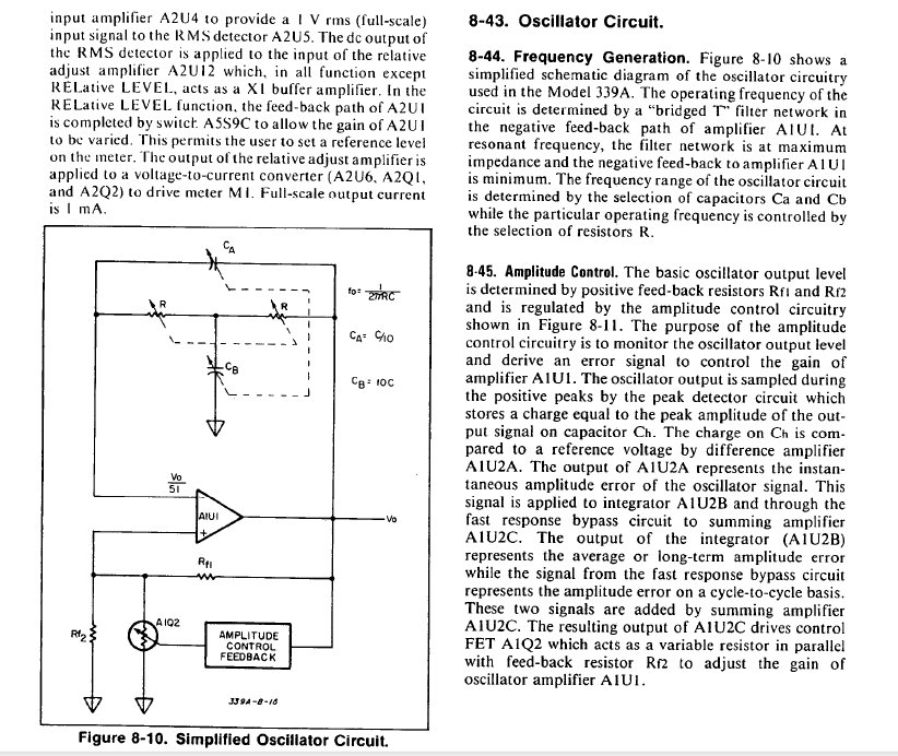

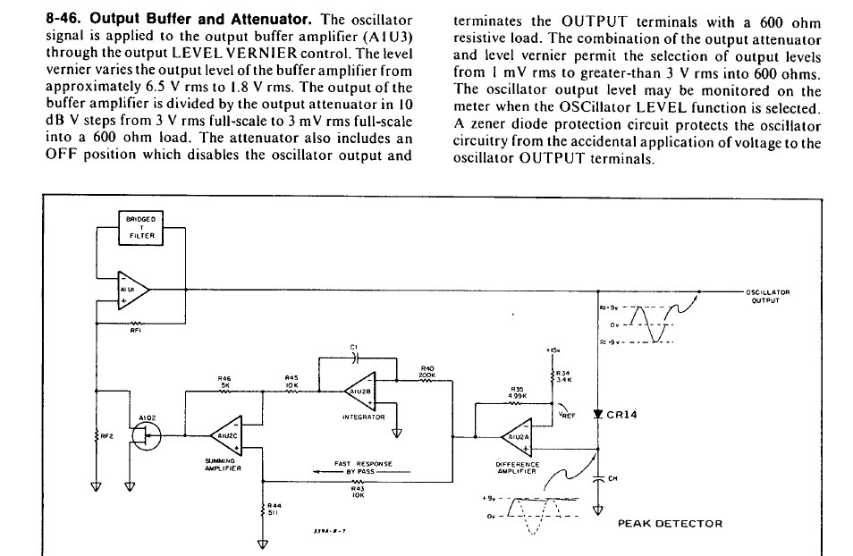

First start with a 339A schematic.... bought off the Internet to do most any type of changes.
The jFET feedback R51/2K. Replace with 28 turn pot/trimmer. It is in series with a 60mfd cap (C30)..... together they go from jFET gate to its' drain. Replace with 100mfd 105c bipolar.
The Oscillator Amplitude Adjust pot (R30/2K) might replace it as this old has contact issues and makes the adjustment difficult and 'touchy'. Replace.
The output pot is R3 (10K). Replace.
These and the osc IC - U1 (LT1468) is all you need to do to have the level of THD shown above.
If you want to reduce that 2H further, replace the oscillator output buffer (U3... with pin 8 removed) with another LT1468. Then you get this residual level:
[all that 'grass' is 120Hz power supply ripple... guess this one could use some new/larger filter cap replacements]
Now, Harmonics are between -135dB and -145dB.
THx-RNMarsh
I feel like such an Aggie.
David, Richard,
Thank you for straightening me out. Yes, I got the schematic from
Agilent online shame on me. I'll have to buy a "new" clean scanned
schematic. I'm waiting for a 339A before moving forward.
But when I get one, at least I won't be changing the wrong parts.
Thanks again.

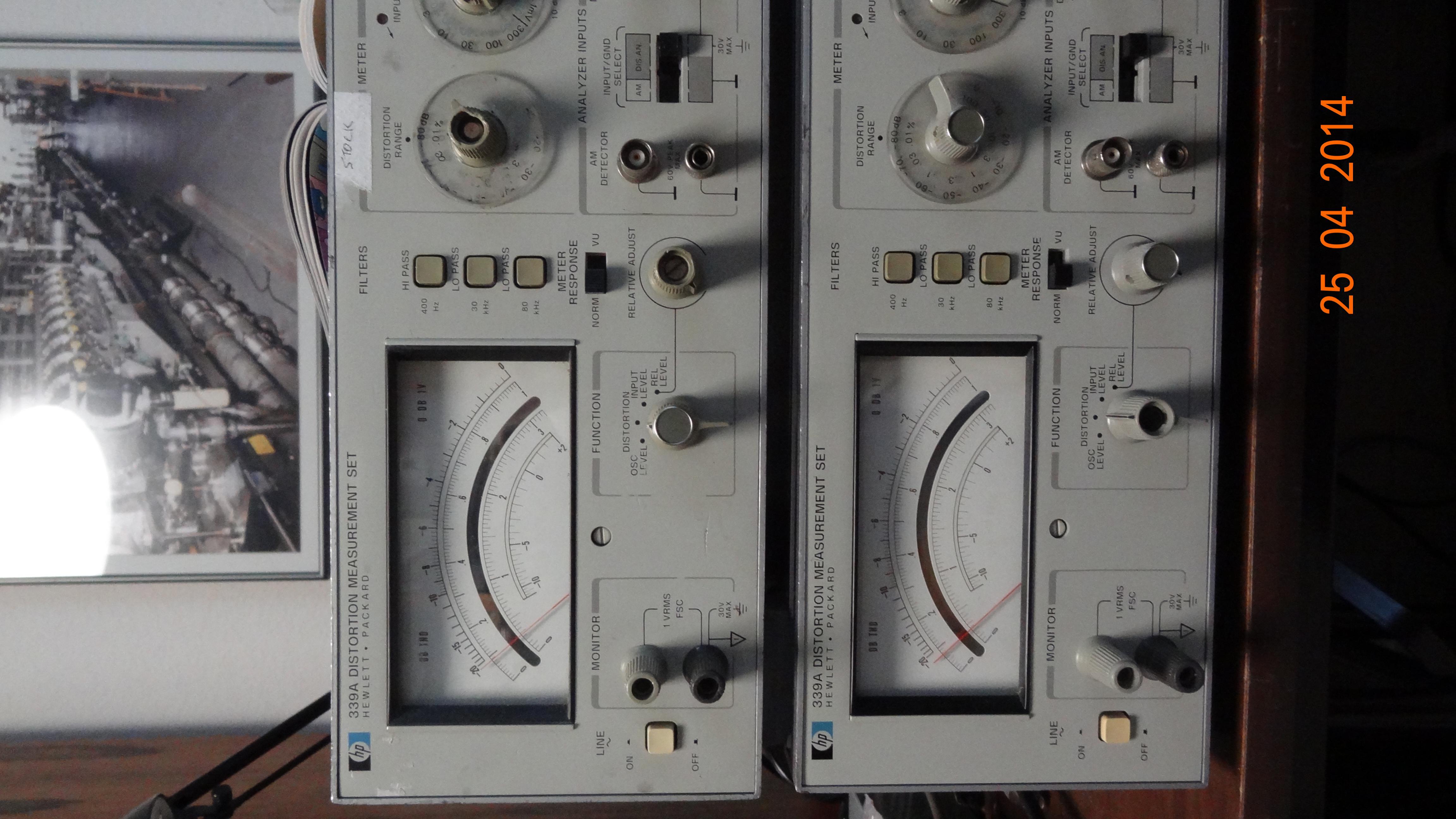

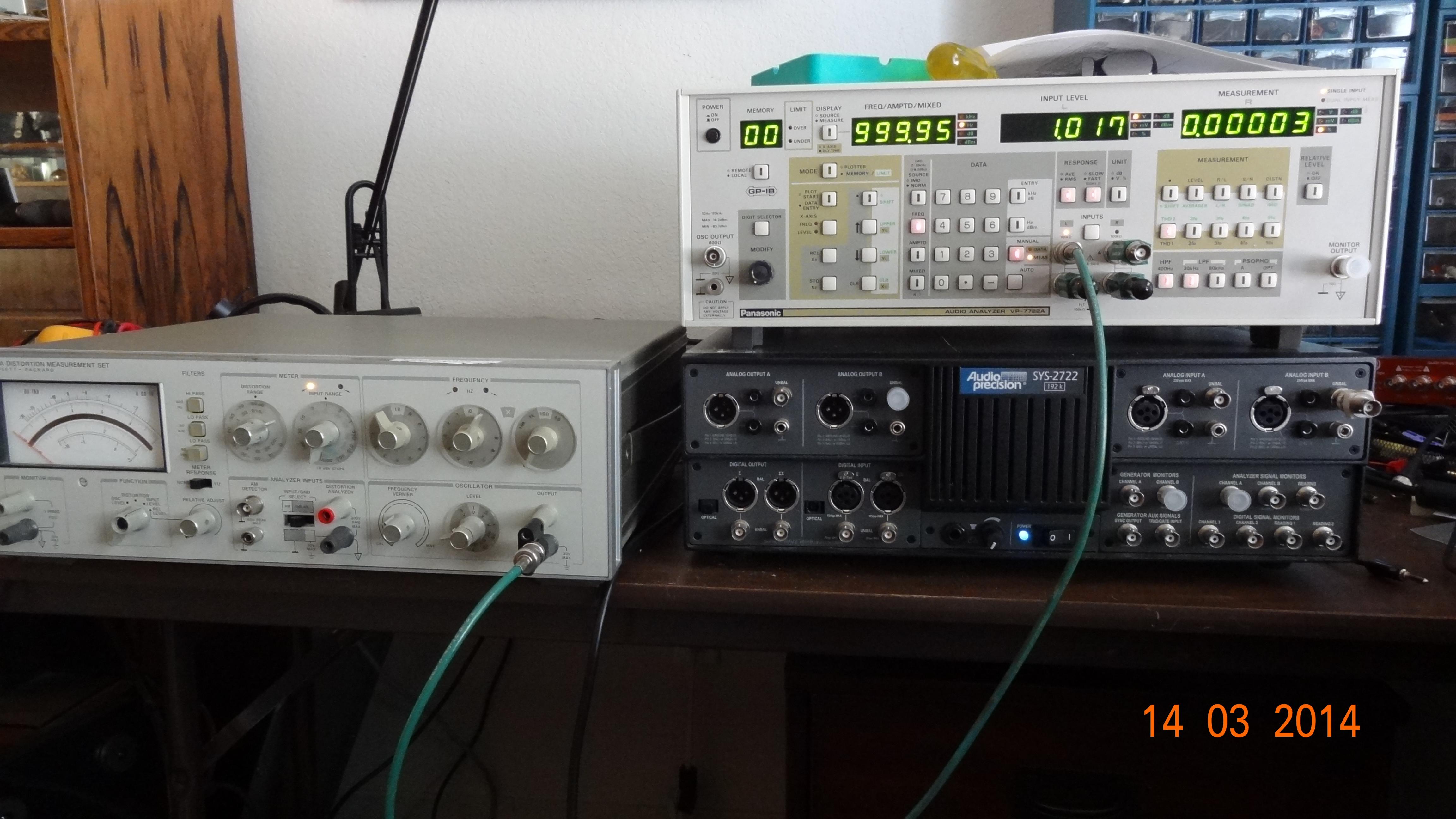

This what you can expect from a little work.... osc is well below -100dB but noise limits the analyzer to -100dB. Here are two units i did last year --- you can click on them and then zoom in for detailed view. It's a loop-thru test of itself. It's 1 volt monitor output signal could go to an ADC/ FFT unit (such as the QA400):
THx-RNMarsh
THx-RNMarsh
What's the photo in the background?
