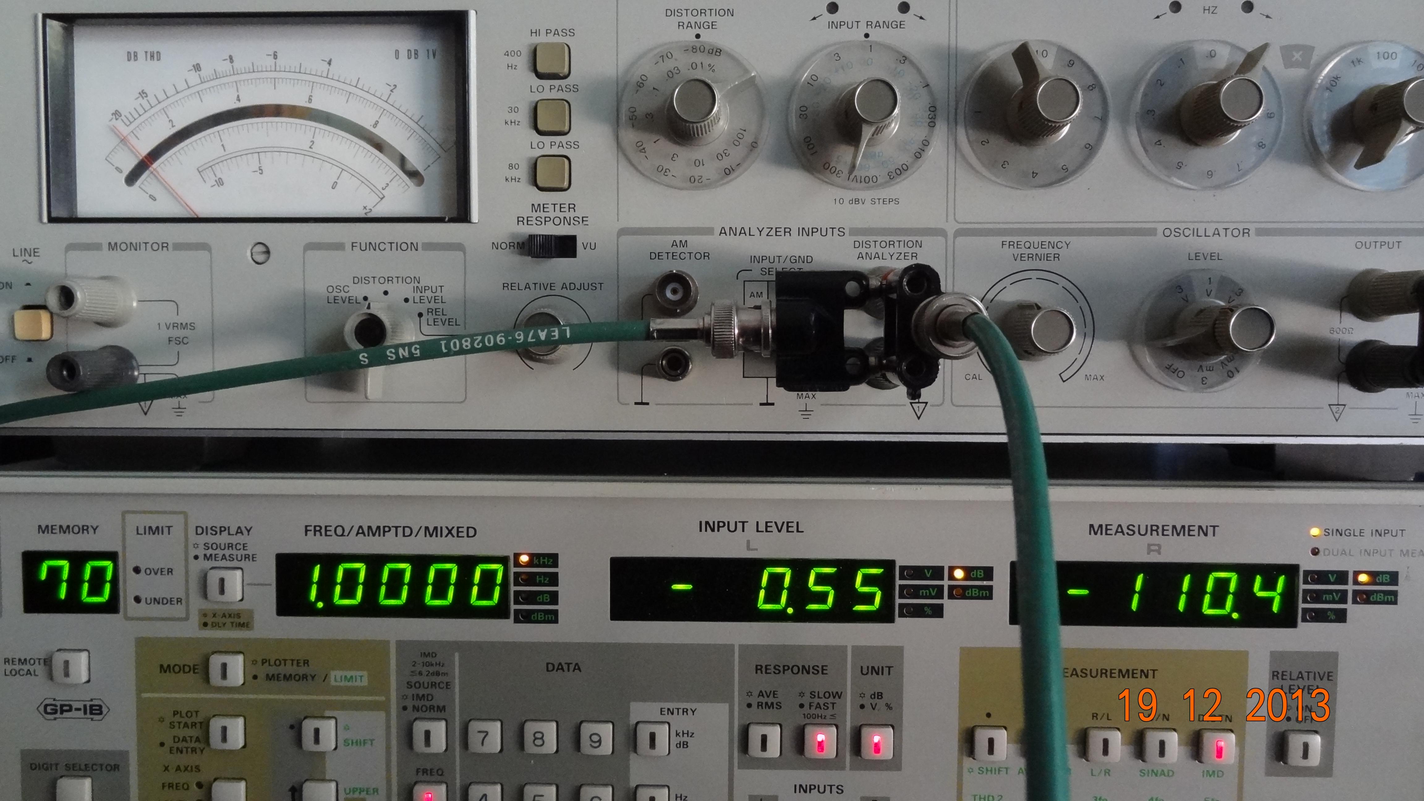

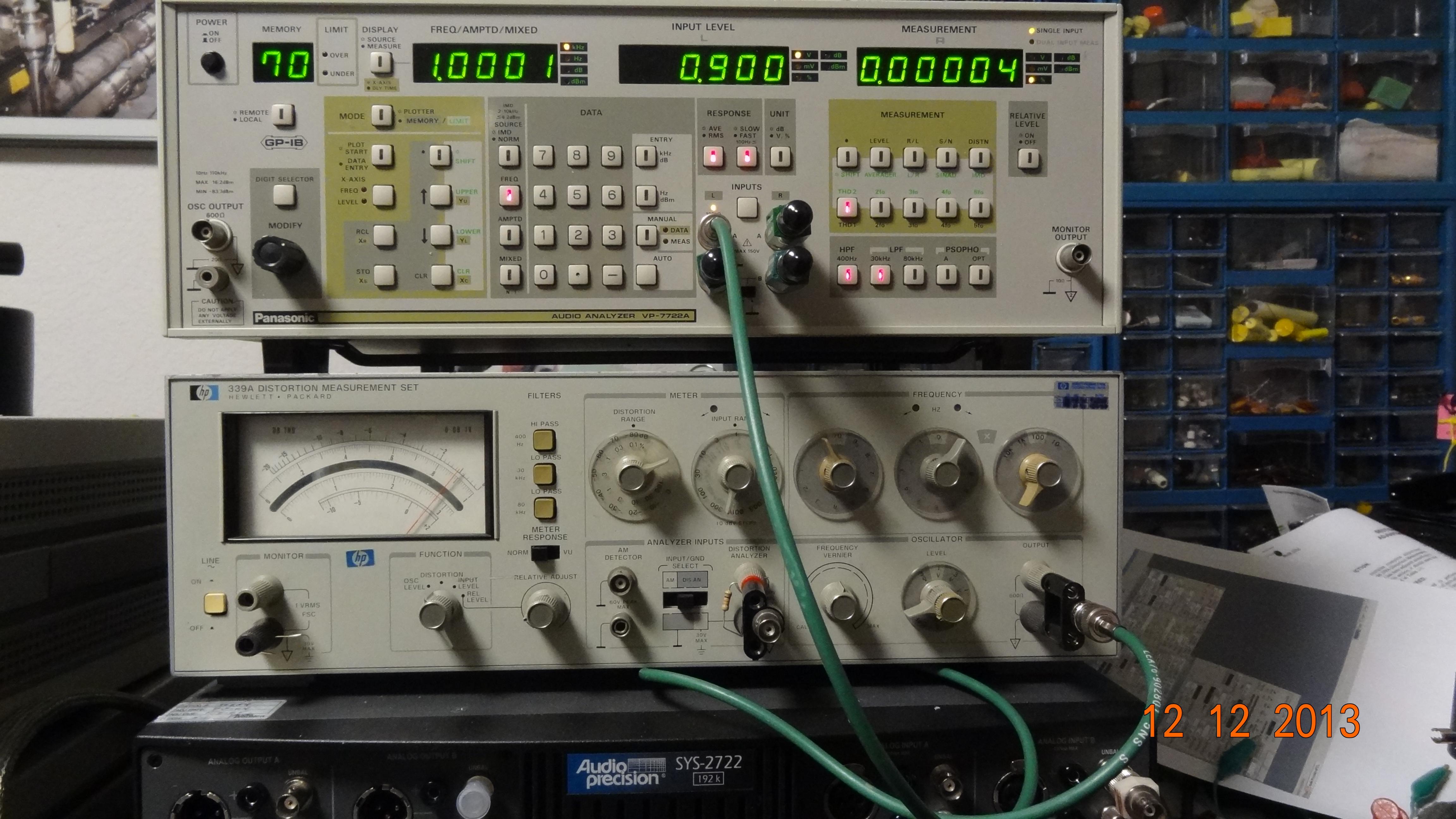

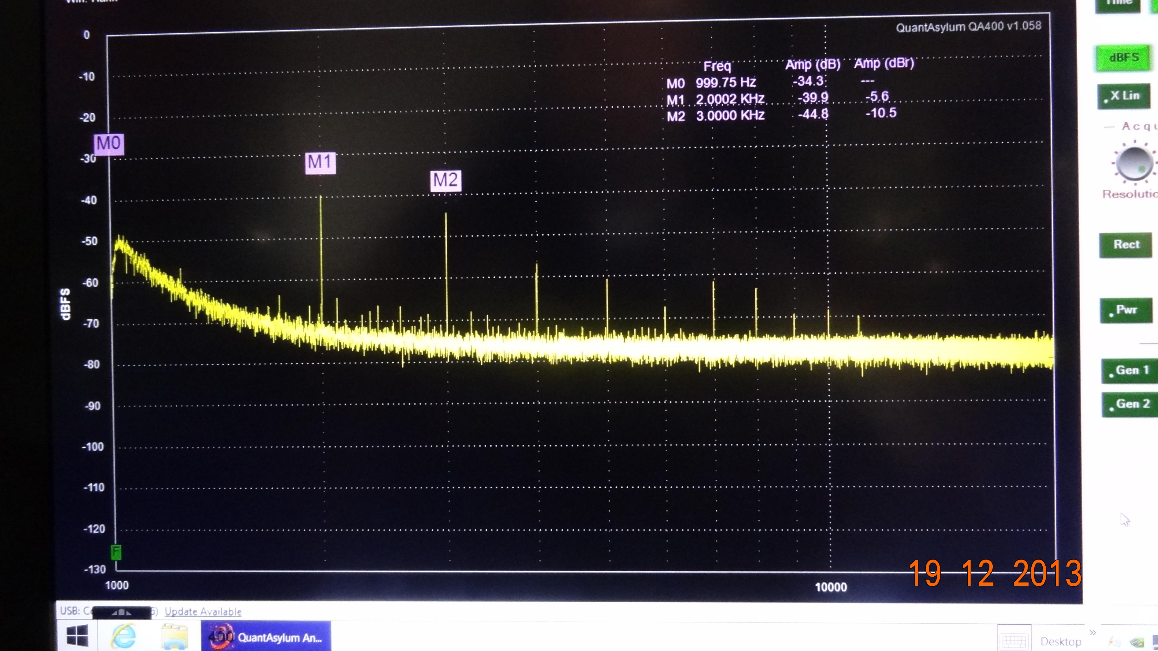

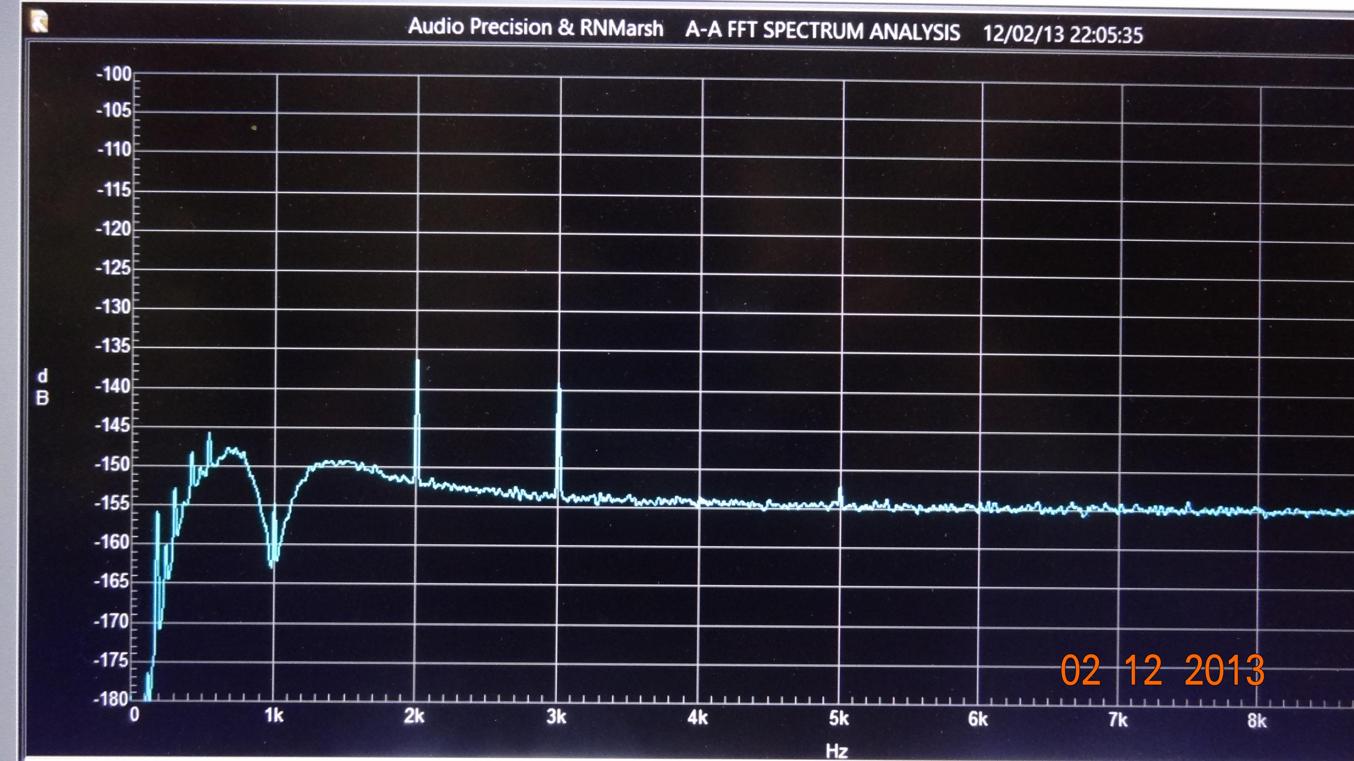

The analyzer section of the 339A isn't as easy to improve. Here is what you might get -- to within 3dB of accurate level in THD+N to -100dB. But below -100dB it isn't accurate and you wont know what the true level is without going to the monitor output and looking there - using a modest FFT ADC system, like the QA400, it can be reasonably accurate as the residual levels are low enough (well under 1v). The 339A can handle up to 300vac input (if using the correct scale) and doesn't get blown up by it. So, it makes power amp testing a little safer to do.
[zero is what ever setting the distortion range switch is set... in this case -80dB = 0 on the FFT]
Thx-RNMarsh
Thx-RNMarsh
