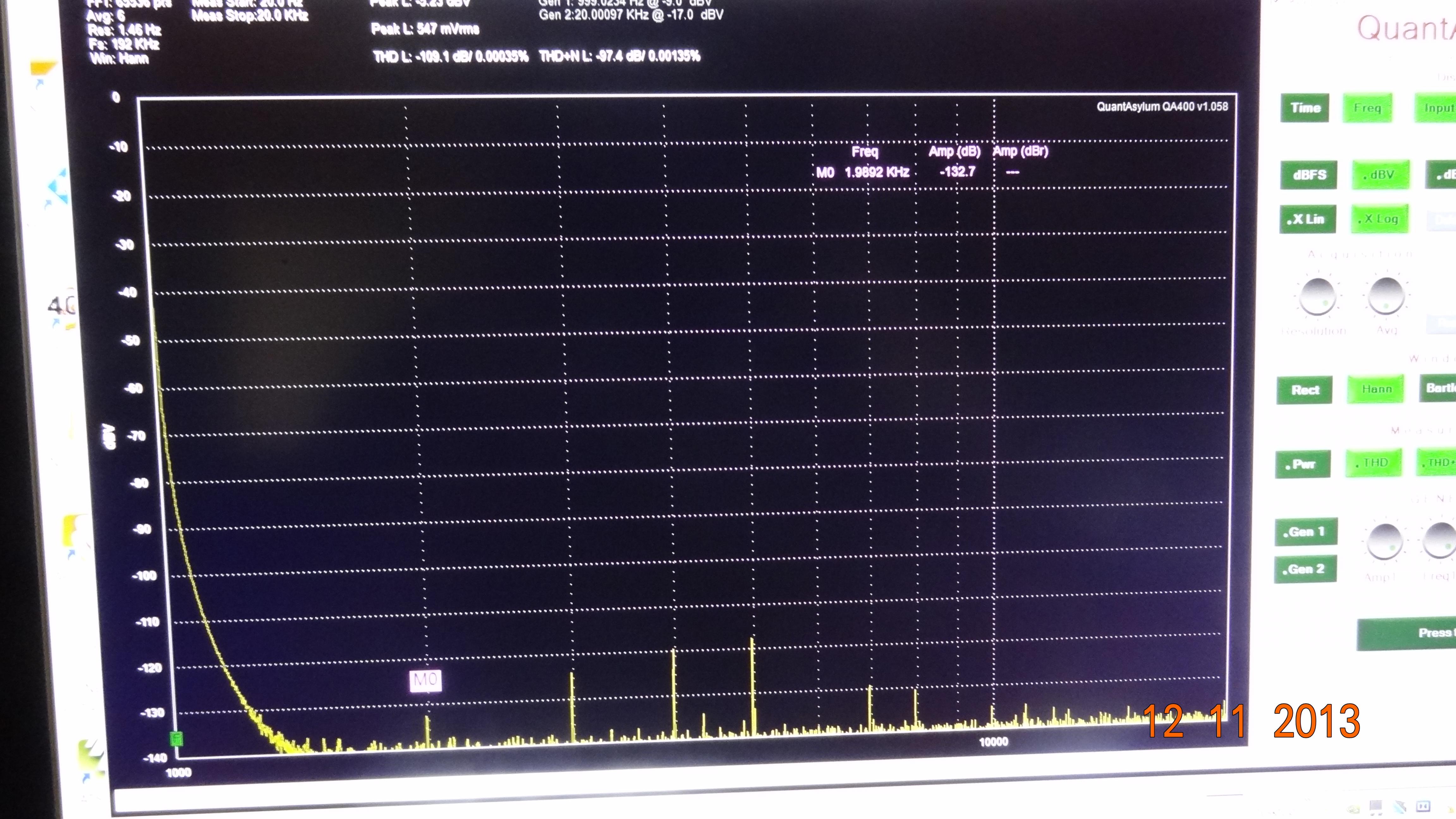

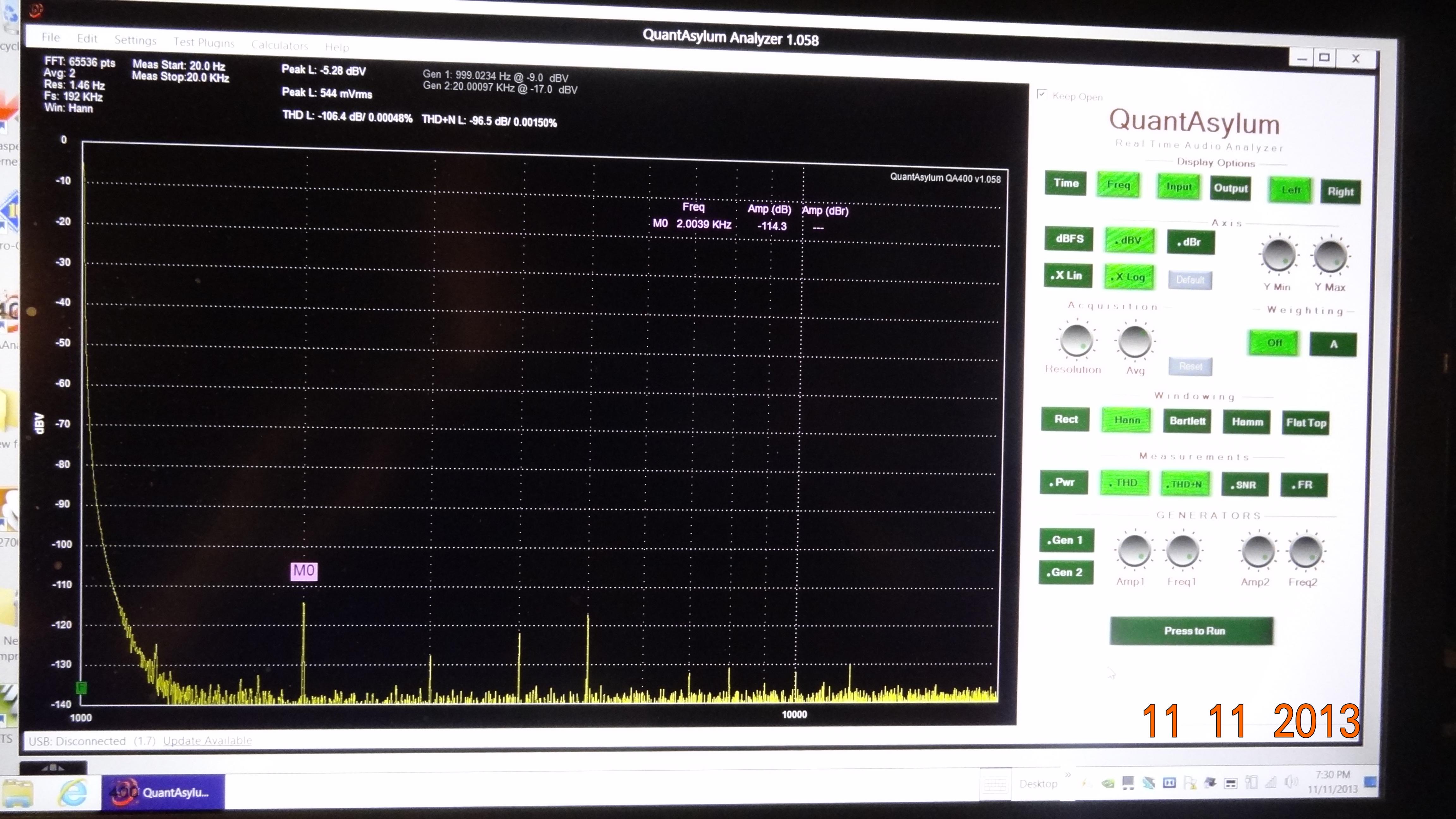

If someone just needed a wide range source generator, you can find -- cheap - on eBay a 339A being sold for 'parts only' and use the gen section only. This is cheaper than the K-H generators and with very little effort you will have a gen with well under .001% THD.
Here are a couple examples I put thru a QA400.
Thx-RNMarsh

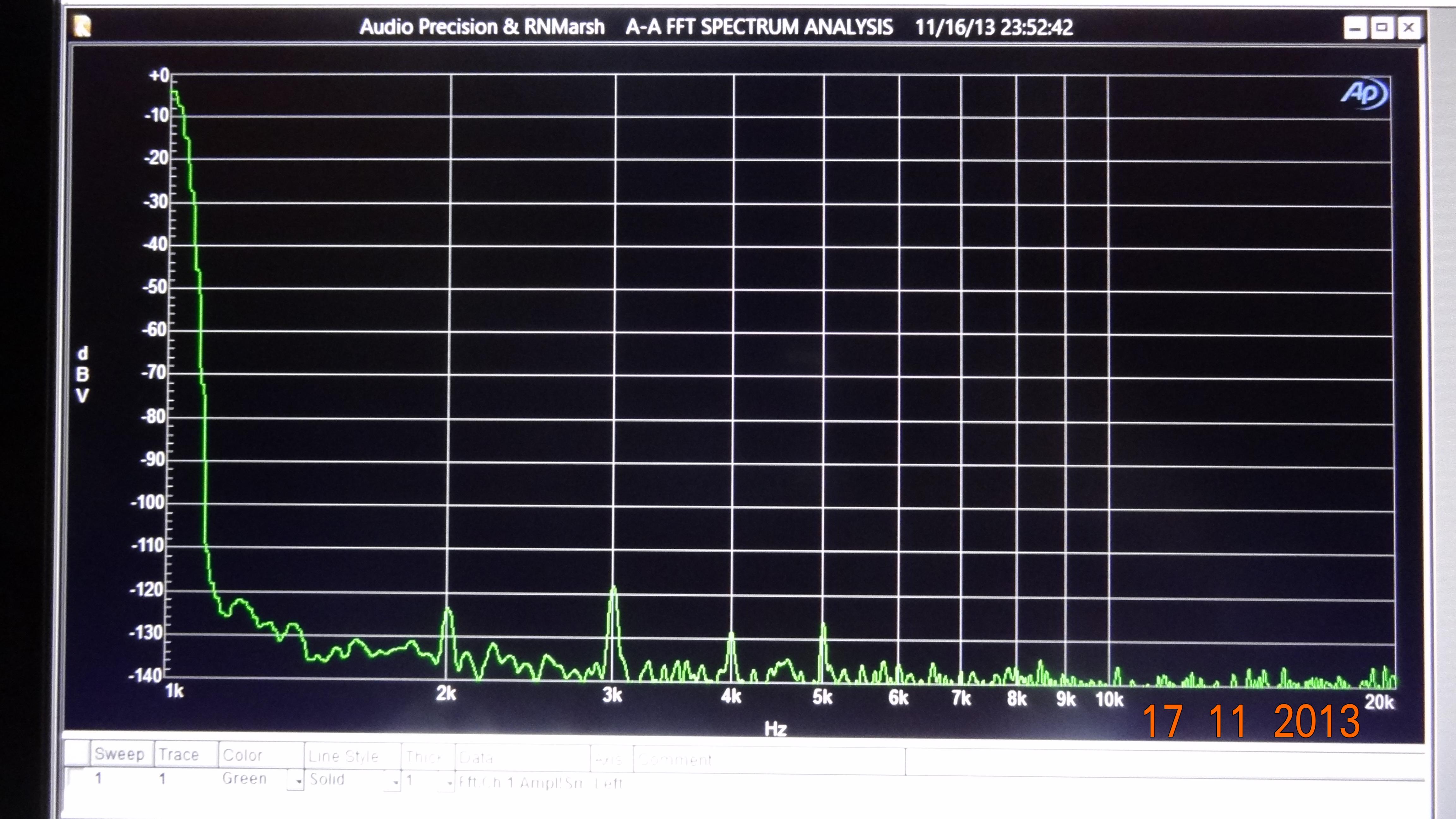

Here is example of what you can get from your 339A generator/source in THD -- This 339A has the AD797 in place -->
- I have tuned the 2H to be minimum. Only minimum mods done. Except 3H may be from that output level pot - haven't replaced it on this 339A yet - like I did the others. [on order].

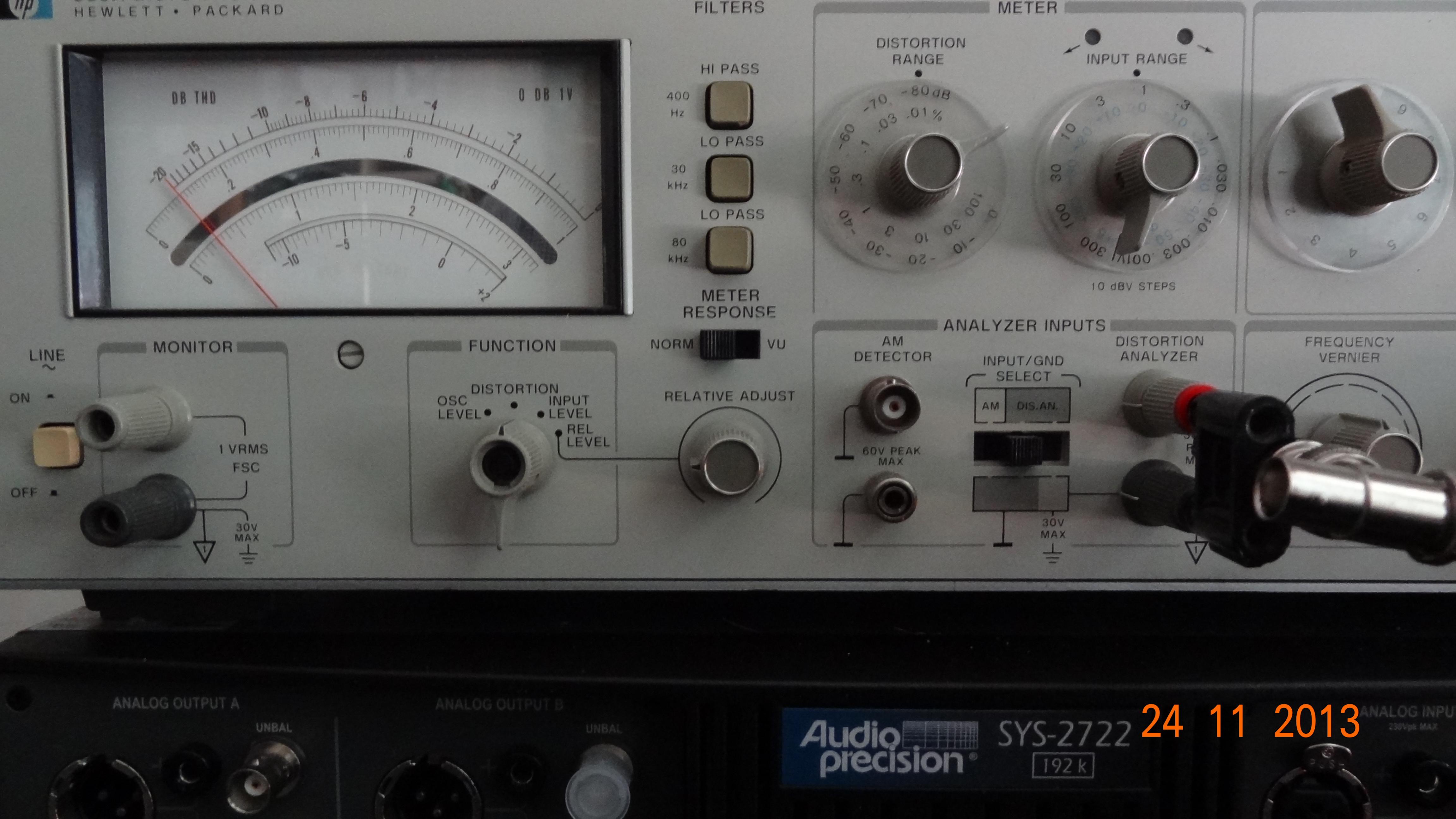

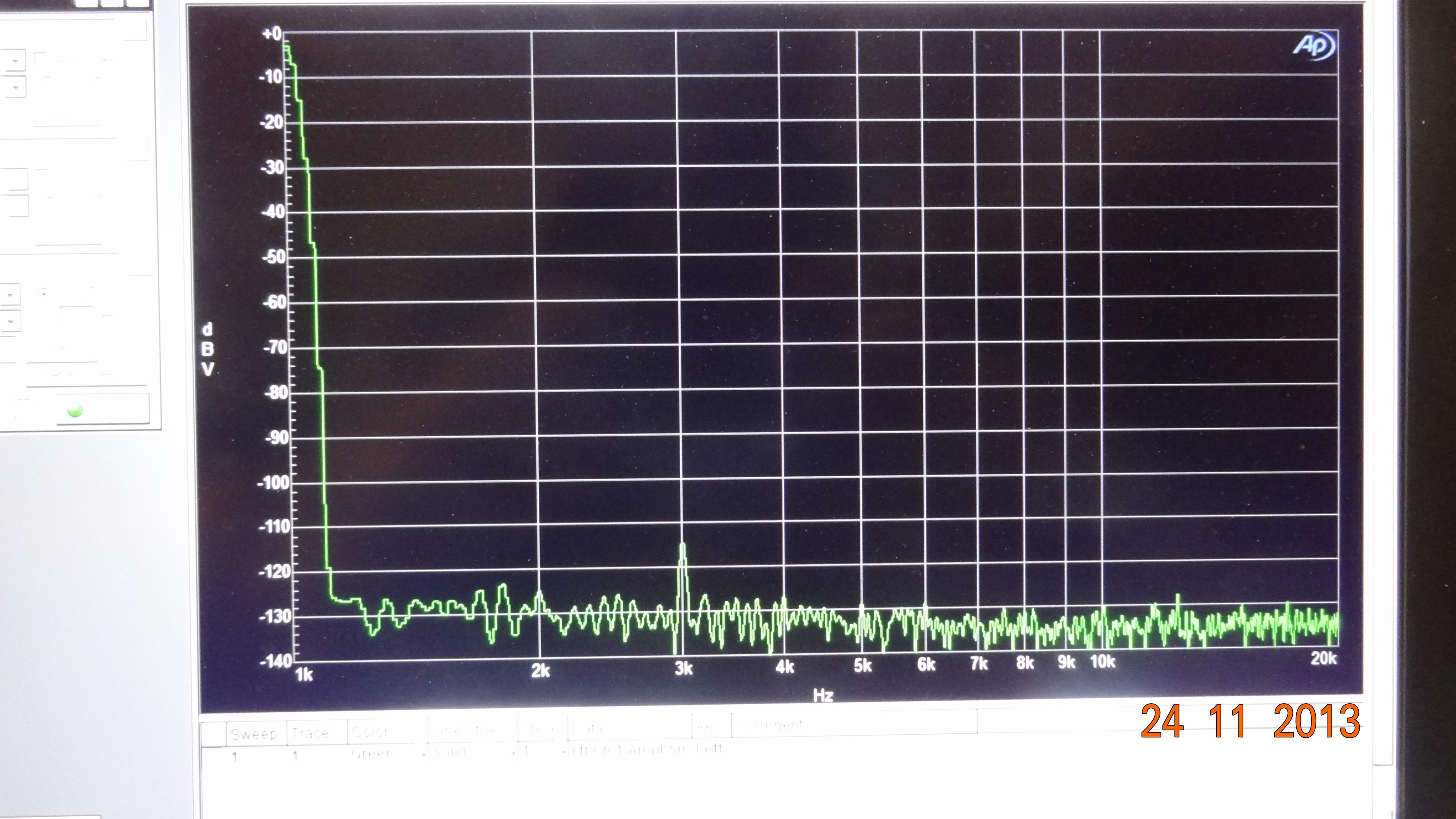

This is what you can expect from a stock 339A with just the osc opamp changed (AD797, in this case) and the output C at the front panel coupling cap changed to a bipolar. And, only the jFET control RC network (gate to drain) changed to bipolar and a multi-turn trimmer... to tune for lowest 2H: The THD is -105dB (re .7v/1Khz) or approx. .0005%. But the 339A shows .001% or -100dB... because of the 339A's over-all inherent noise level limits the resolution.
In other 339 models, I removed/reduced the background noise level by replacing all the opamps with modern, low distortion, low noise devices and I could then go lower in the oscillator thd+n and the analyzer output/display. Plus changing gain at strategic place as per davada's instructions etc. But, all of it together is a Lot of work.
With minimal work and an FFT on monitor output you can see below -100dB (if you need to see that low) and have a very useful instrument for minimal cost that is also accurate.

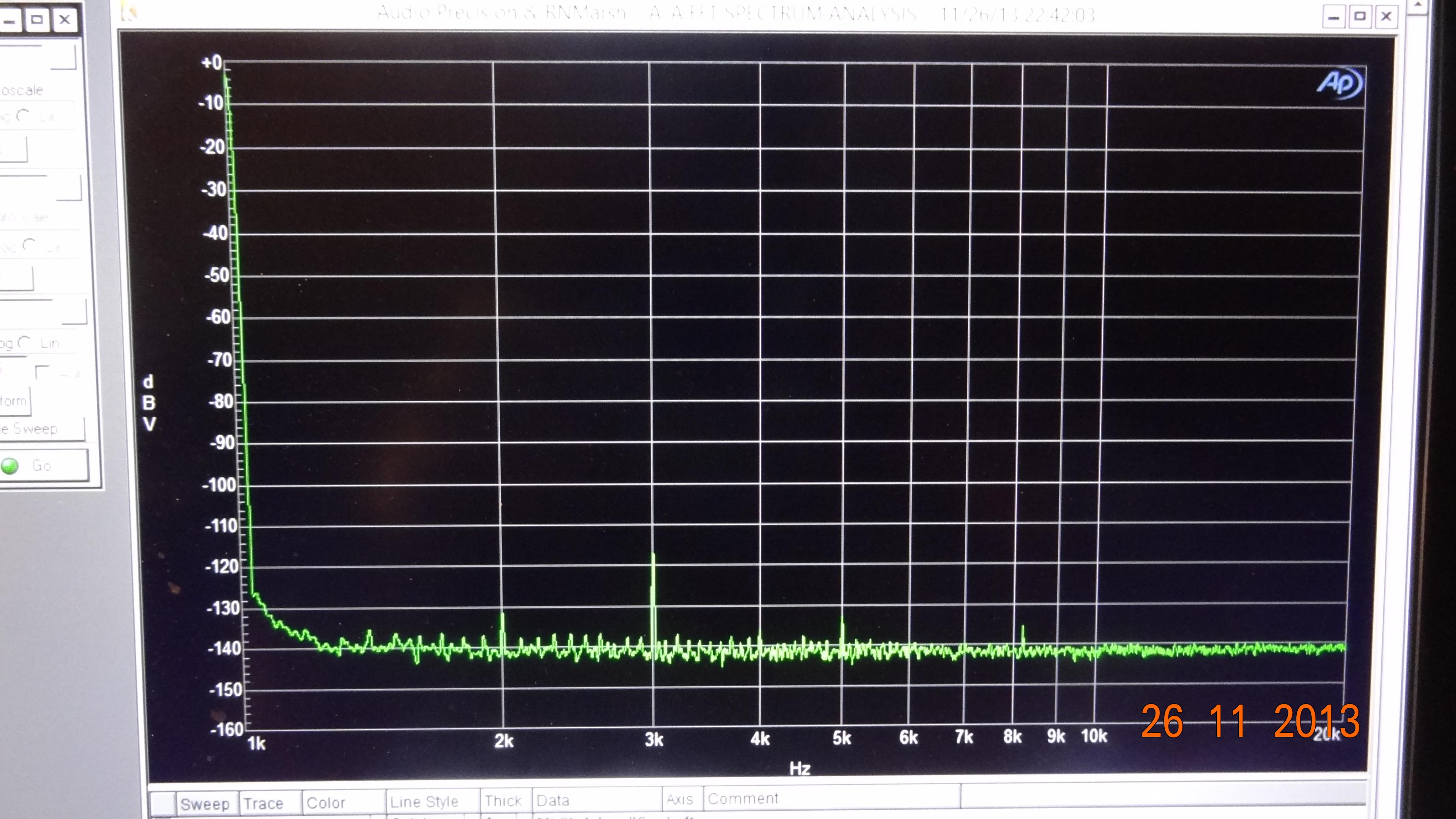

THD with 1468 -
and with another 339A and using the 1468 opamp for the osc and using 49710 for output drivers plus a smattering of 1468 elsewhere.... I could get a more complete null of the 2H. I am beginning to think that 3H must be in a passive part somewhere -- maybe the osc freq control dual ganged pot ... its always there no matter what opamp or 339A unit I use and same level. Hmmmm. Boy, if I could get rid of that 3H we would be in heaven at last.
[the output level adjust pot has now been replaced]
