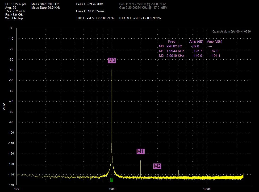

No it does not work that way. No notch filter. The audio from the dummy load is sent directly to the audio interface. The software computes an FFT using thousands of data points. The harmonics are summed. The process is sensitive enough for measure THD in the best amplifiers
Have you placed your system side by side with (parallel test paths) more expensive commercial analyzers to see if they agree in individual harmonic levels measured below -100dB?
Only when I added in a notch filter did the measured individual harmonic levels come close to one another.
Demian (1Audio) has got to within 5dB with his CPU based system. Which is amazing for the cost involved.
I picked up the 339A for 200-250 dollars each. Some like the wide range of selectable source freqs which are -120dB THD levels. I like to tune a circuit for lowest THD with an analog meter better than a digital system which you have to wait for refresh/update cycles. And, the 339A is harder to blow up with over voltage.
-RNM

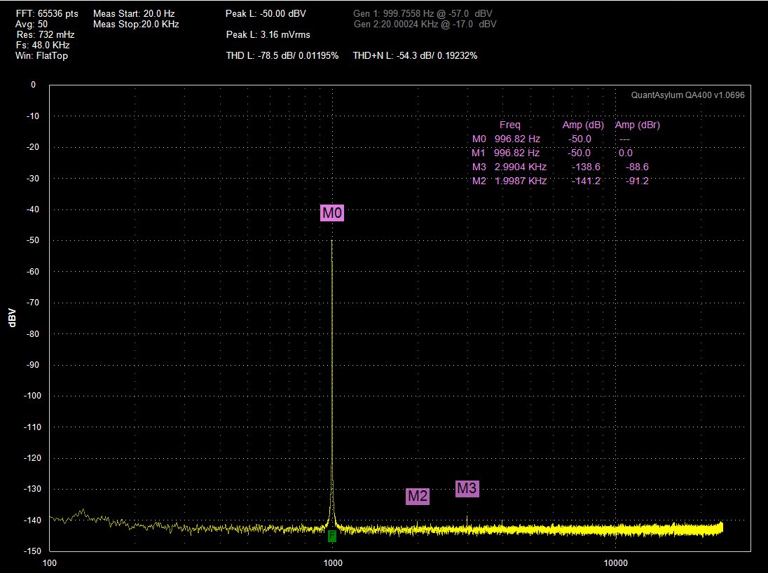

This is what you can expect from a stock 339A with just the osc opamp changed (AD797, in this case) and the output C at the front panel coupling cap changed to a bipolar. And, only the jFET control RC network (gate to drain) changed to bipolar and a multi-turn trimmer... to tune for lowest 2H: The THD is -105dB (re .7v/1Khz) or approx. .0005%. But the 339A shows .001% or -100dB... because of the 339A's over-all inherent noise level limits the resolution.
In other 339 models, I removed/reduced the background noise level by replacing all the opamps with modern, low distortion, low noise devices and I could then go lower in the oscillator thd+n and the analyzer output/display. Plus changing gain at strategic place as per davada's instructions etc. But, all of it together is a Lot of work.
With minimal work and an FFT on monitor output you can see below -100dB (if you need to see that low) and have a very useful instrument for minimal cost that is also accurate.
Thx-RNMarsh

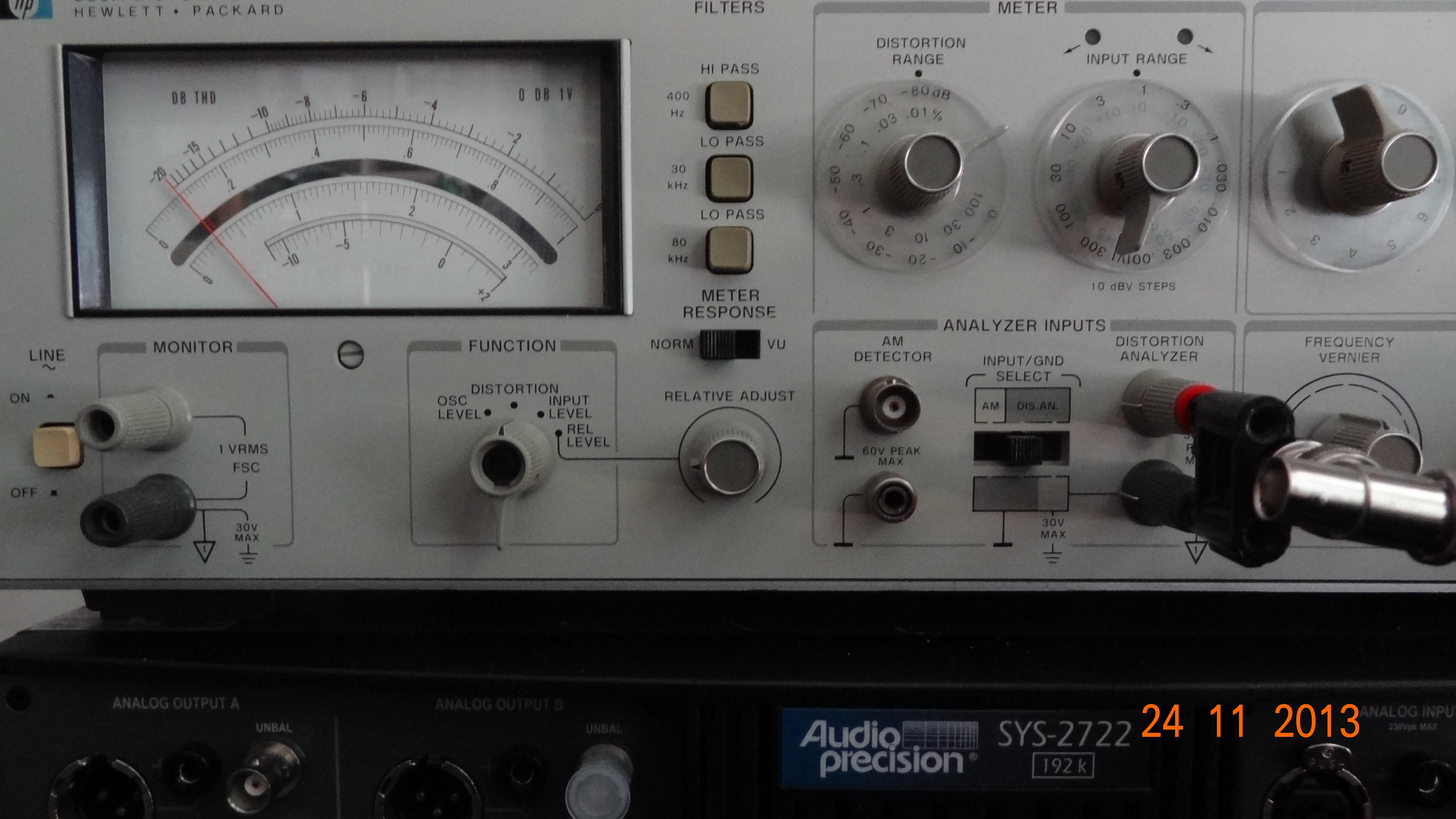

HP 339A Process
Well I started, yeah.
Replaced Power Supply Caps with some Panasonic NHG...4700 microfarad
35V x 4.
Replaced the Level Pot...simple 20 minute job turned into hours.
Me thinks the original extension was hand made and someone
just stripped out one of the set screws for the pot.
Measured and cut the pot shaft and beveled it.
Tightening the set screw kept pushing the shaft out.
Set screws then kept falling out with one set screw disappearing
all together. Can't find it anywhere, in nor outside the
analyzer...which worries me it got lodged into something inside.
I ended up tapping it to 6-32 and used a brass set screw.
Replaced the 741 Quad opamp with socket & LME49740.
More to come as I can get to it.

These are the result of three changes:
1. The LME49740
2. Level Pot
3. Electrolytics in the power supply.
I haven't even gone through and adjusted any pots yet
for low distortion, or H2, H3, etc. It sure did clean up
nicely though. More to come, no LT1468s yet.
I'm looking for some of the LME49710 metal cans
ya'll spoke of too.

Monitor Output...
@RichEEM & David, what did you guys do to tame the monitor output?
Compared to what I posted above, the monitor output is like a distorted wave in the
middle of the FFT screen. Sorry I didn't capture it.
Also, at higher output levels towards -80dB etc, 3V output do your meters
start a slow type oscillation? Mine will usually be slow, but
sometimes it acts like a short and will start bouncing around.
I didn't know if that was the HP339a sputtering to try and maintain
output or if the auto-null was just trying to get a handle of the signal
at the upper end of its scale but cannot.
I'll go poke around in the manual and elsewhere and try and search for it.
