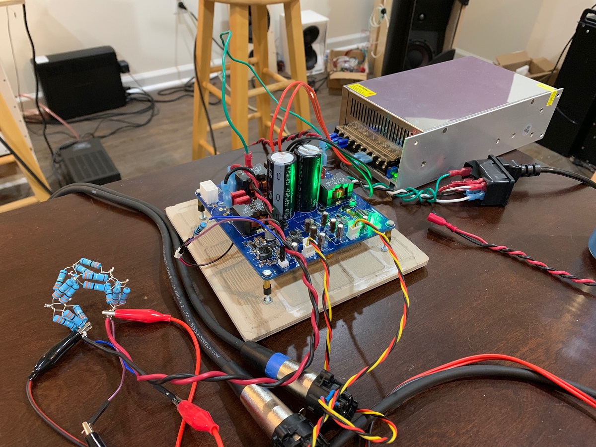

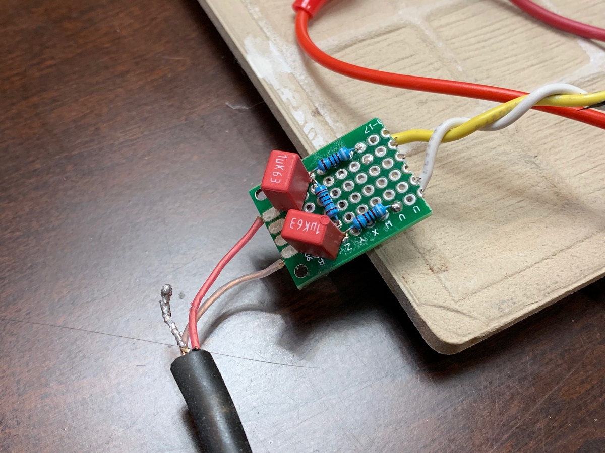

I just found out how to measure distortion on a Class D bridge tied load (BTL) amp where both wires are antiphase and live. You need to use a symmetric divider, say 9k1-2k-9k1 across the dummy load and put the Focusrite balanced XLR input across the middle 2k but bypassed with a film cap on each wire.
More here:
TPA3255 Reference Design Class D Amp GB
Setup:
783590d1569433198-tpa3255-reference-design-class-amp-gb-tpa3255-btl-test-setup-symm-atten-gnd-hs-jpg
Here’s the divider:
783591d1569433198-tpa3255-reference-design-class-amp-gb-tpa3255-btl-test-setup-symm-atten-closeup-jpg
It’s an abbreviated one (only 20dB) used by Voltwide here:

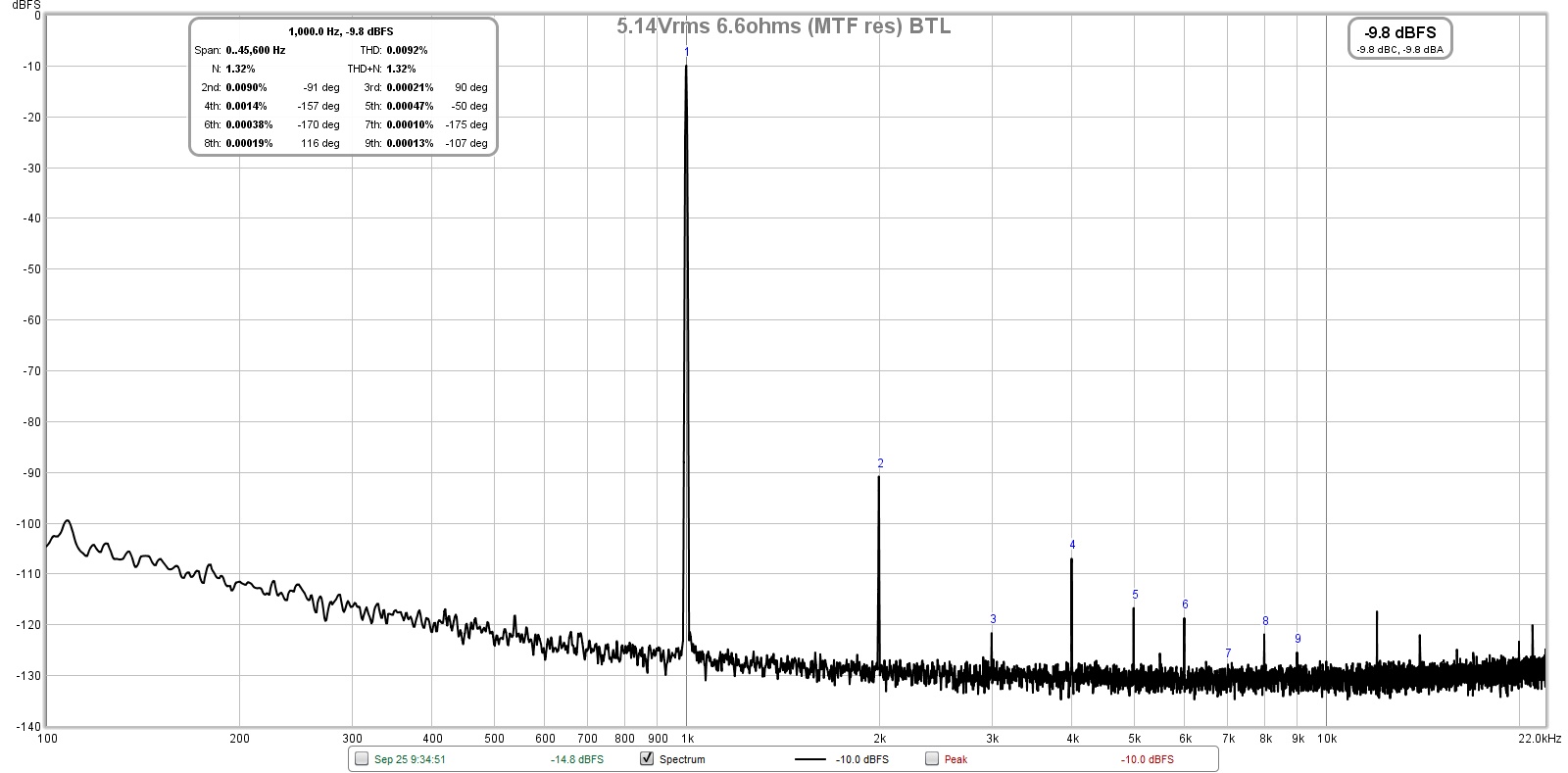

I used an asymmetric divider previously with DC coupled balanced inputs and it got very high (artificial) H2.
Here is the data from asymmetric divider:
783512d1569420084-tpa3255-reference-design-class-amp-gb-tpa3255-rev0b-5-14vrms-6-6ohms-btl-fft-3-jpg

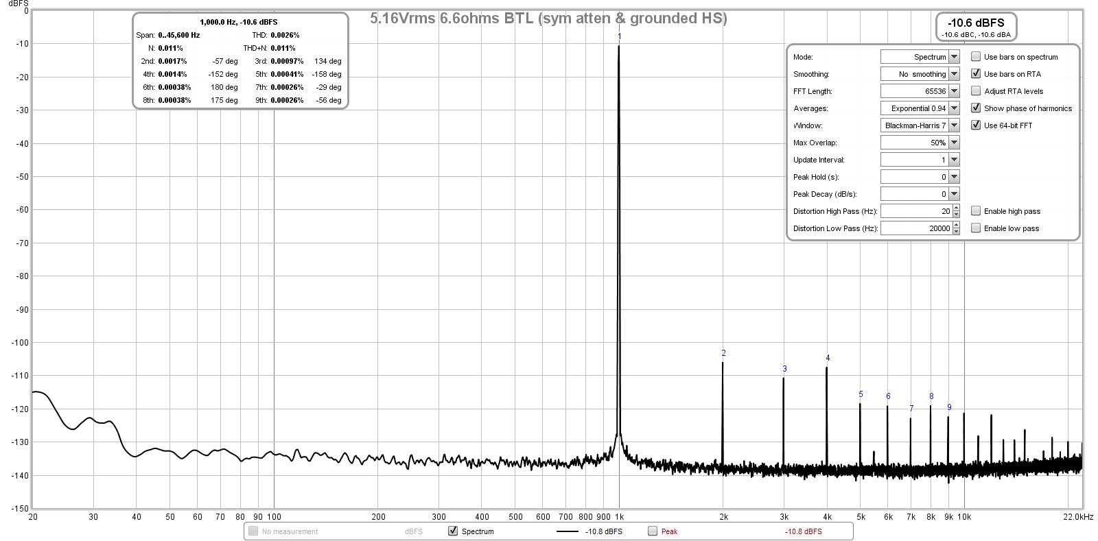

To symmetrical divider:
783592d1569433198-tpa3255-reference-design-class-amp-gb-tpa3255-rev0b-5-14vrms-6-6ohms-btl-fft-hs-grounded-symm-atten-5-jpg

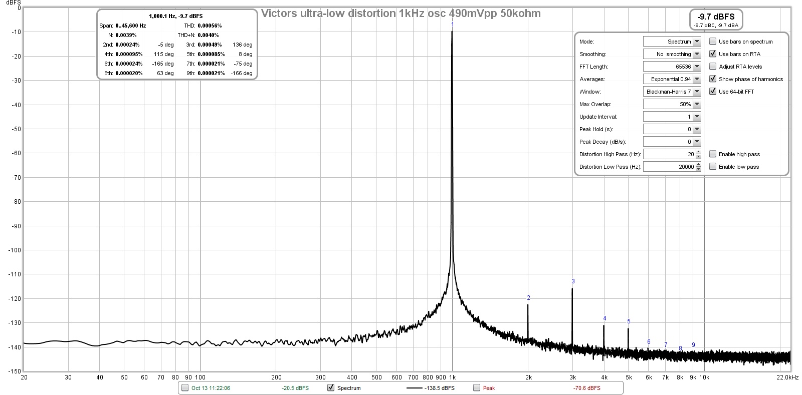

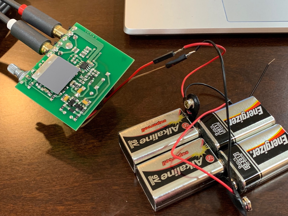

I received one of Victor's ultra low distortion 1 kHz oscillators - it should have levels immeasurable to the Focusrite, so what we will see will basically be the limit of the Focsurite. I used 4x 9v batteries to give it a clean source of 35v. At the lowest output setting of 490mVpp and fed into to internal 50kohm input impedance of the Focusrite 2i4, I am getting the following:
attachment.php
The noise floor is amazing - I have never measured anything this quiet, and it is not even inside a case yet.
There is a 3rd order peak that is rather high and stays constat during the time averaging process, so probably part of the Focusrite fron end.

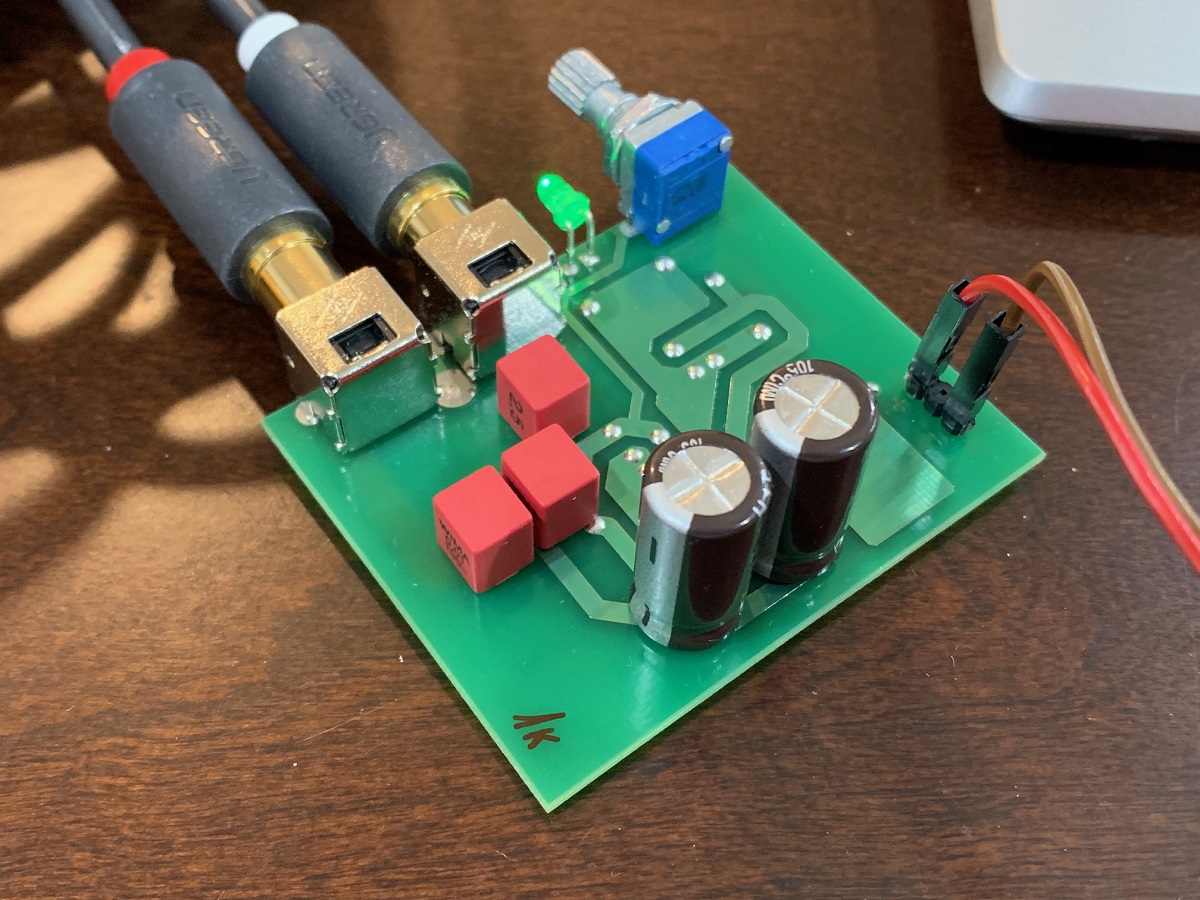

Very nice unit prebuilt for 50 Euro. Highly recommended.

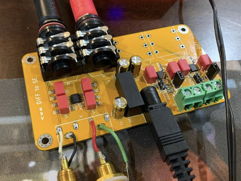

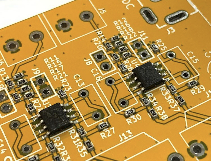

I have forgotten to visit this thread in a long time. Great to see activity and work on attenuators continues. Regarding attenuators, one other possible path is to use an active (but ultra low distortion) SE to balanced opamp such as LME49724 from TI. It has 0.00003% THD so good for many (if not most) DIY amps. Jhofland designed one for use with his Maudio sound interface but I can’t see what it won’t work with a Focsusrite or anything else needing balanced XLR input. Jhofland is installed two stages of attenuators at -14dB and -6dB (selectable on -6dB) for up to -20dB or 10x attenuation of a single ended input signal. The attenuators use high quality Susumu metal thin film SMT resistors. Here is a photo of the board. I am using it as a SE to Bal buffer so I actually bypassed the attenuators.
Data-sheet for LME49724:
http://www.ti.com/lit/ds/symlink/lme49724.pdf
attachment.php
attachment.php

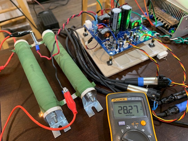

A more recent discovery that I made when doing higher power distortion tests is that the type of dummy resistor has a huge influence on the measured distortion level and harmonic distribution. You can forget about any wirewound dummy load. Forgot about metal oxide thick film, gold anodized metal shell wirewound are bad too. Any white cement filled one is bad. Even audio grade crossover resistors that claim to be low inductance. I broke one apart and they are still wirewound.
Don’t use these huge wirewounds unless you want to measure resistor generated high THD and extra high third harmonic:

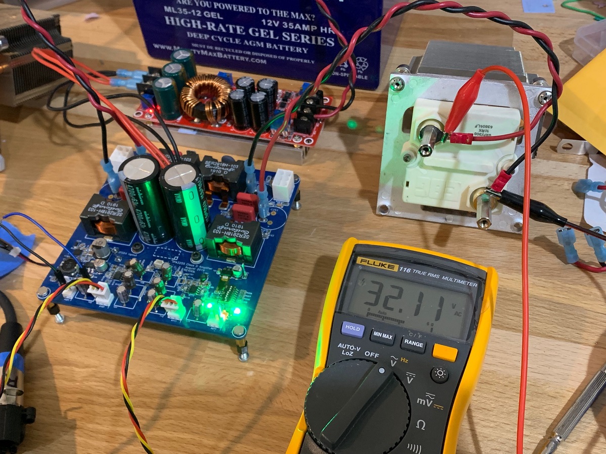

Here is a photo of an EBG mounted you a CPU cooler in use while testing my TPA3255 amp to clipping at 32Vrms into 10ohms.
817123d1581696470-tpa3255-diy-discussion-design-etc-tpa3255-91vpp-10-ohms-dvm-closeup-jpg

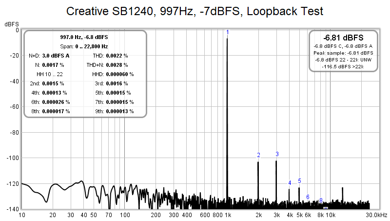

I found my old Creative SB1240 Sound Blaster X-Fi HD USB Audio and put it in loopback mode. I even got ASIO4ALL to run for it (Windows 10).
My loopback test was at 997Hz and -7dBFS.
It's not great, but looked better than I expected based on the feedback I see about Creative these days.
Looks really bad if I up the level to 0dBFS, though.
Anybody else have one of these? How is yours?
