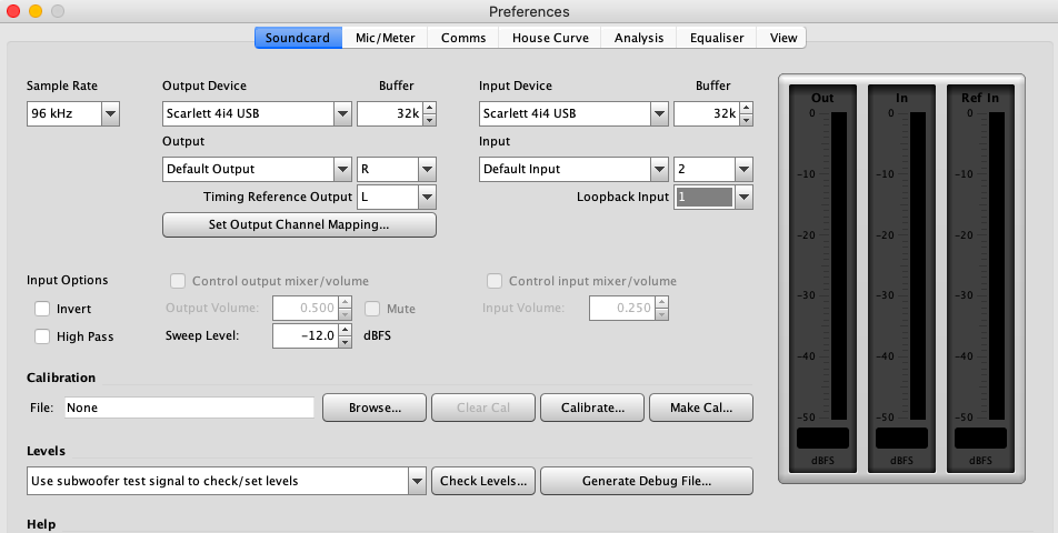

4) Found the main preferences menu - here and hit a roadblock.
"Then choose your input device as your sound card and your output device as your sound card."
Got it. See pic.
"Choose input and output amplitude to be “Master” and set to amplitude of 1.0 - this lets the full signal be generated by the sine wave generator and the full signal be captured by the ADC."
Cannot find this anywhere. Am I in the wrong menu?
"On the input settings choose the channel where you will connect your amp’s load resistor. Channel 1 is typically the “Left” channel and channel 2 is “Right”."
I can't determine where this setting might be found either. For the Input - it will not me select anything other than default device or microphone. Since the amp's load resistor sees the input of the Focusrite, is that in the Focusrite control? If so, I didn't see that.

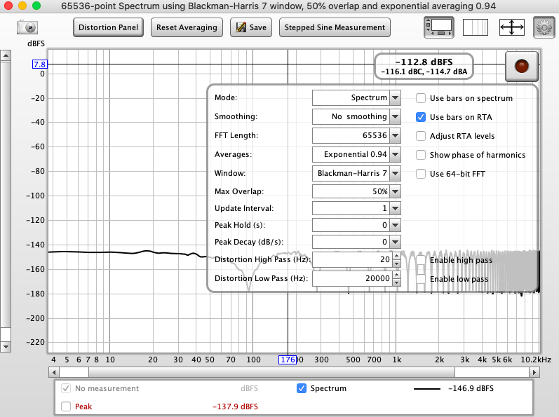

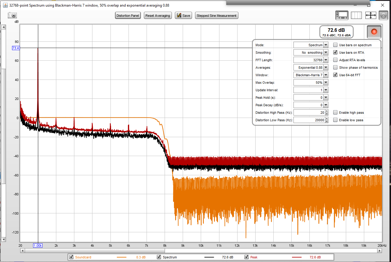

I went ahead to setting the RTA parameters per post #1. That seems successful.
"At this point you can see what the inherent self noise of your sound interface is without anything connected. Click on the “RTA” button along the top. In this dialog, click on the gear to adjust the settings. I use something like this:"
Even though I haven't set the master volume yet, I wanted to try the measurement. Below is a screenshot of the RTA with only the 4i4 connected to USB and nothing else. - Note Macbook Air - Battery power

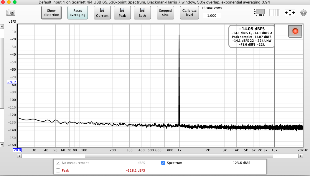

I think I have a portion of it figured out, but not 100%, clearly. I can't even get a simple loopback measurement to work as intended. I found proper cabling in my parts bin. Fortunately, I had a TRS to XLR.
Verified wiring is -
Corrections to above.
I learned a bit about the Focusrite Control software and its input / output routing - related to my blue / red posts above. I think that clearly was intended to be within the Focusrite software vs. within REW.
I still have not found the way to set something to "Master", and that could be part of my issue, but clearly I can send a "full range" digital signal that the Scarlett processes. BTW - not a bad little USB DAC/Amp! 😀
Whether that signal is coming back fully in digital form to REW or not, I have no idea.
I am still stumped - but I read more ... and more.
In essence, I think what we're trying to accomplish (but please chime in if I'm off in outer space) is to determine through a loopback with a test tone what noise the Focusrite / Computer chain adds, so we don't mistake that for our amplifier distortion when the signals are combined.
1) Send the test tone from the computer (REW) to the Focusrite (DAC) over USB.
- Audio output on computer and within REW to Scarlett
- Play tone
- Verified functioning properly by listening to the tone through HPs on Scarlett and viewing meters in Control

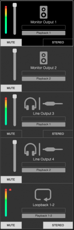

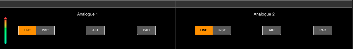

2) Loop the signal (Loopback) - Send the analog output of the test tone to an analog input on the Focusrite - loop it

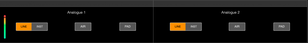

- Within Control Input settings (front) left at Line vs. Instrument - No PAD, No AIR
- In REW set output of generator to 1 (Left)

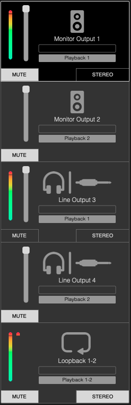

- In Output Routing - Changed Monitor Output 1 to Playback 1 (DAW) - Set to Mono
- Verified tone output goes through Monitor Output 1. Control showing signal

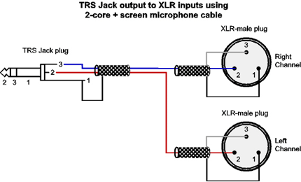

- Connected Line Out 1 (back of unit) to Analogue Input 1 (front of unit) with TRS to XLR
- Verified working with both physical monitor "volume" for output 1 and gain. They both function for Input 1 and indicate proper levels both within Control and showing relative signal level on front display (Red / Yellow / Green) as levels are adjusted.
- Also verified by using Output 3 (non-monitor / non-attenuated line output) looped to Input 1.
3) Send resulting signal from the Scarlett input back to the computer (REW) for analysis over USB after ADC processing from Scarlett and capture in REW RTA.
- Stumped!

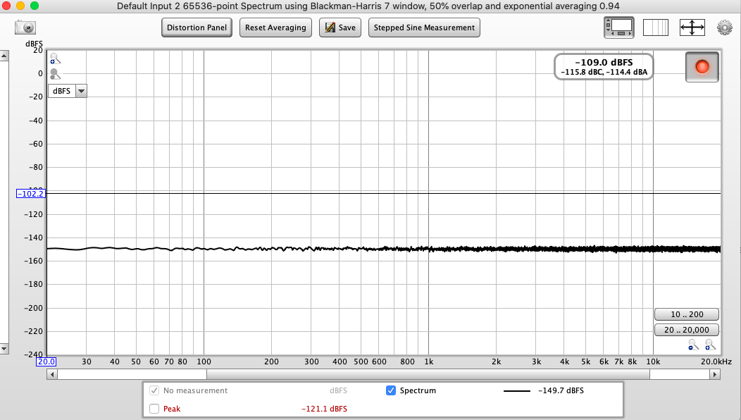

- I see a lovely 1kHz signal being captured.

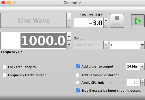

- When I set the test tone to -3dB, no matter how much gain or "monitor volume" using input 1 - I can't get the signal to rise above ~(-)110dBFS. I thought it should be right at -3dBFS if things were working as intended.

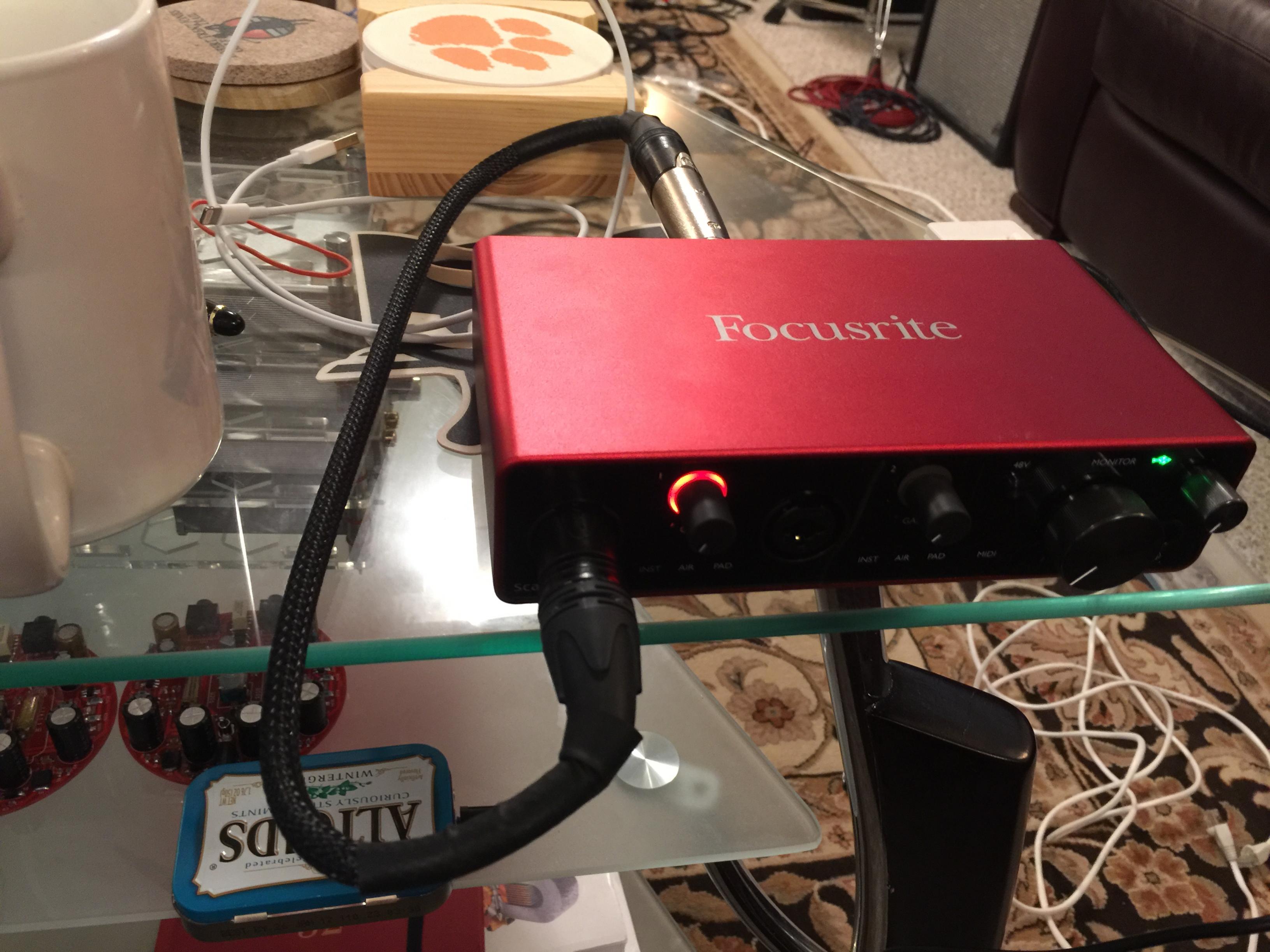

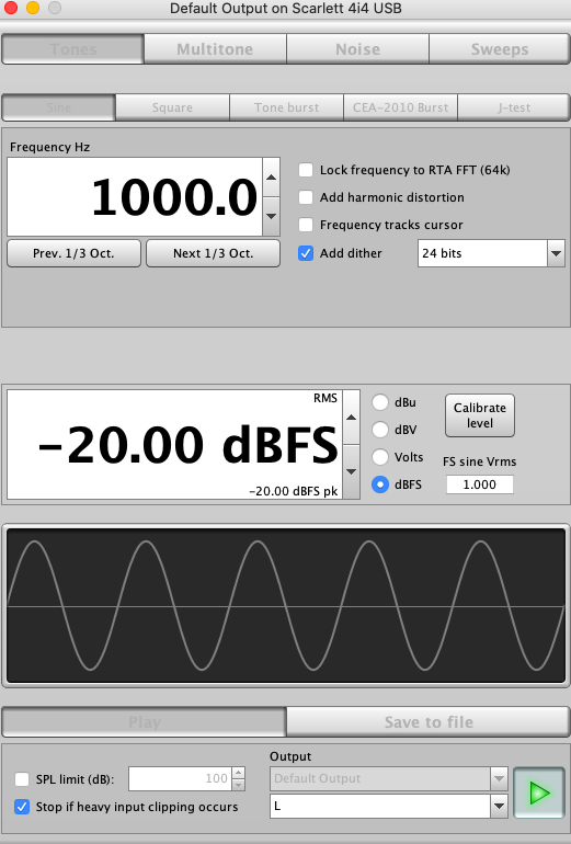

Some screenshots and a pic of setup. Running from output 3 non-attenuated to input 1.
Clearly, I am missing something fundamental. I've read and read. Any help in understanding how I'm either misinterpreting what's supposed to happen and/or how I may have set this up incorrectly would be be greatly appreciated.
With thanks in advance 😀

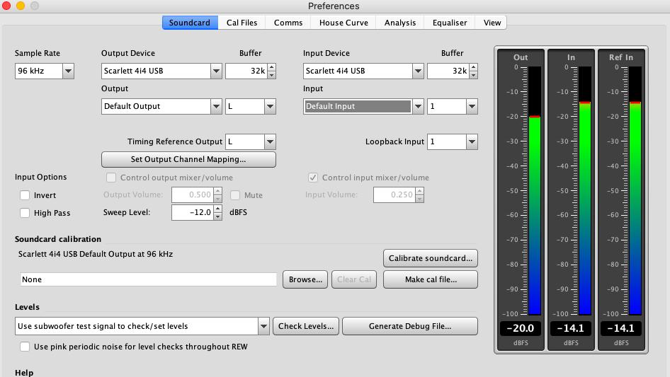

Don't leave the input and output set to default, select the actual input and output. When you have done that you will have the option to allow the OS input and output volume controls to be adjusted from the REW soundcard preferences. They should usually be set to 1.0.
Your REW soundcard preferences screenshot showed input channel set to 2, have you changed that to channel 1? Make sure your connections match the channels you have told REW to use.
Use a more current version of REW.
Thank you so much! I think I have it sorted, mostly. 😀
Done, I didn't know if it was advisable to use Beta versions. Updated to latest.
Where I get confused is that there is no option other than Default Output and Speaker, and Default Input and Microphone. However, it seems default works.
How do I set the input and output volume controls to 1.0? I just can't find that anywhere, or is there supposed to be another dropdown? I did notice that the physical monitor (output) volume knob on the Focusrite seems to now be disabled, but not the input gain.
See below for options.

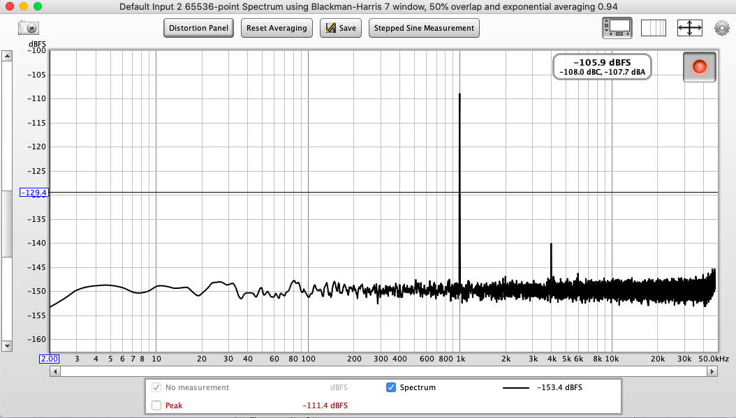

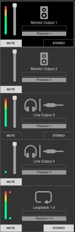

AHA!!!!!! Sheesh, I am a goof. If I had just run it to the "right input" I'd have been golden. Fixed. Now for some reason every time I open the software the input moves to Microphone. I'll just have to remember to switch it. It makes sense since the software is used for room correction.
More importantly - It seems to be working! 😀 Below are screenshots while running the test tone per the screenshot.
Once again, thank you! I knew it had to be something foolish.
For anyone else with this model Focusrite that is struggling - there ya go! Don't be a dolt like me
Now to calibrate REW with the Focusrite and play a bit. 😀
Speaker and Microphone are the names given to the physical output and input connections. Select those. On the Mac you need to use the mac's audio or Audio/Midi setup to adjust levels.
@JohnPM - Apologies. I had to step away last night.
Now I admit that I am even more confused. If the output is the speaker and the input is the microphone on the laptop... how does the computer get the signal from the Focusrite? I tried it anyway.... no joy. No signal either into (and thus out from) the Focusrite.
When I had input and output devices set to Focusrite and input and output set to default (two separate dropdowns) it seemed to work properly. I was adjusting the level within the Focusrite Control software and it seemed to work properly. Am I mistaken re: how it is supposed to work? 😕
I hate to ask ridiculous questions, but something absolutely is not clicking.
I read most of the REW manual this morning... I thought I had it right. Are the plots and screenshots in the previous post not correct? It calibrated properly (I think) this morning.
Perhaps I should try it on my PC - I'd prefer to use the laptop for battery power etc, but maybe the PC software is easier to use. I donated for two copies, so I don't think that would be uncool.
"Speaker" and "Microphone" are just generic labels for the device I/O, they have nothing at all to do with the laptop audio connections. Leave the Input Device and Output device as the Focusrite. If the Input and Output selections only work if left as Default then perhaps the Focusrite software is doing something strange with the I/O. It isn't a big problem to leave them as default for stereo connections, but it would be a problem for multichannel interfaces.If the output is the speaker and the input is the microphone on the laptop... how does the computer get the signal from the Focusrite? I tried it anyway.... no joy. No signal either into (and thus out from) the Focusrite.
