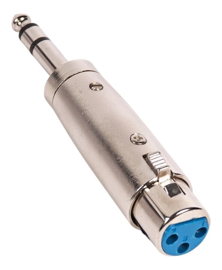

When I use my Behringer UM2 with a balanced line stage for an input, I tried the V+ to tip. V- to ring and ground to the sleeve. I ended up with massive amounts of harmonics, once I removed the ground from the sleeve, it worked perfectly. So now it is wired with the XLR to TRS with no ground, just V+ and V-.
I remove gnd from the sleeve. Still horrible results here
I was thinking to use this
and then my xlr to rca adaptor.
but that would be the same as using one of these
Or do I just use one of these
I have a feeling all will have the same result.
Use google to find "akitika voltage attenuator"
Document is a pdf. Build the switcable attenuator into a box
And add necessary connectors and labeling for straightforward use.
This is a cheap way to protect sound card input.
Do you have a voltage divider on your input? Just make sure the maximum voltage does not exceed the max allowable input signal. That distortion is result of clipping at the input stage. What divider are you using at present ?
Yes. I use a 20k/2k divider. This produces 1.2v at the input to the TRS. This is quite adequate as it can allow for 7.5v max when using the trs input.
