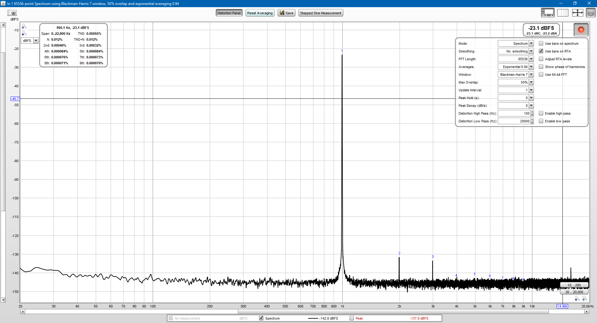

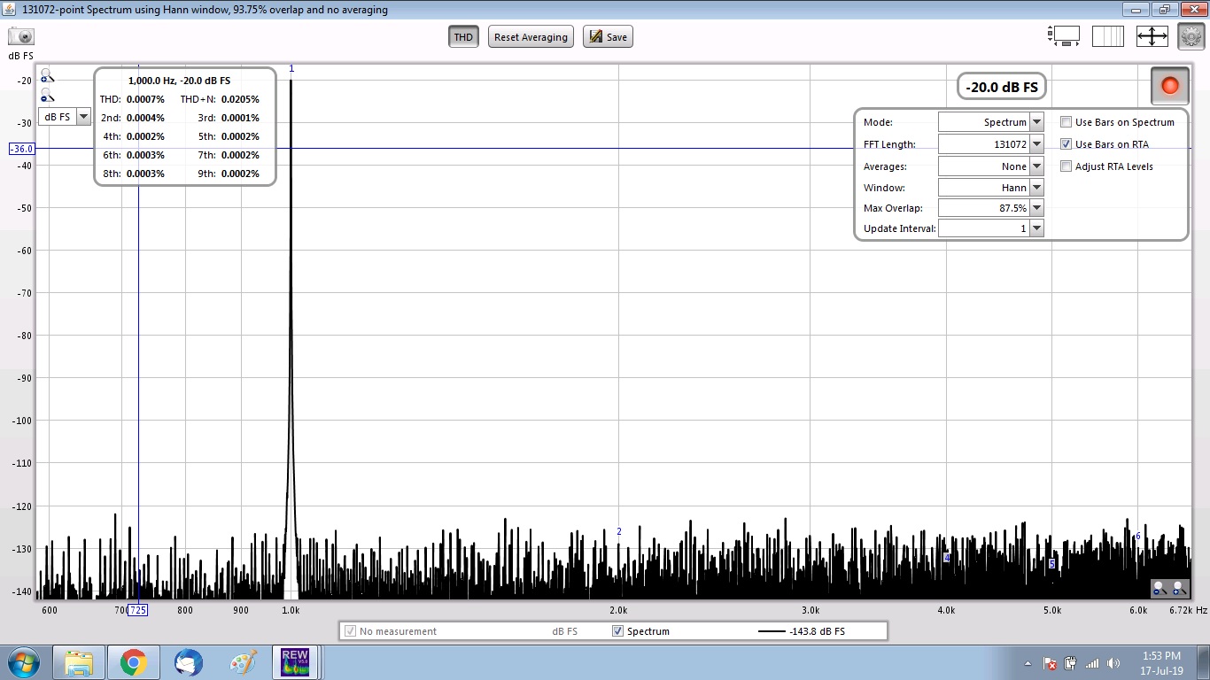

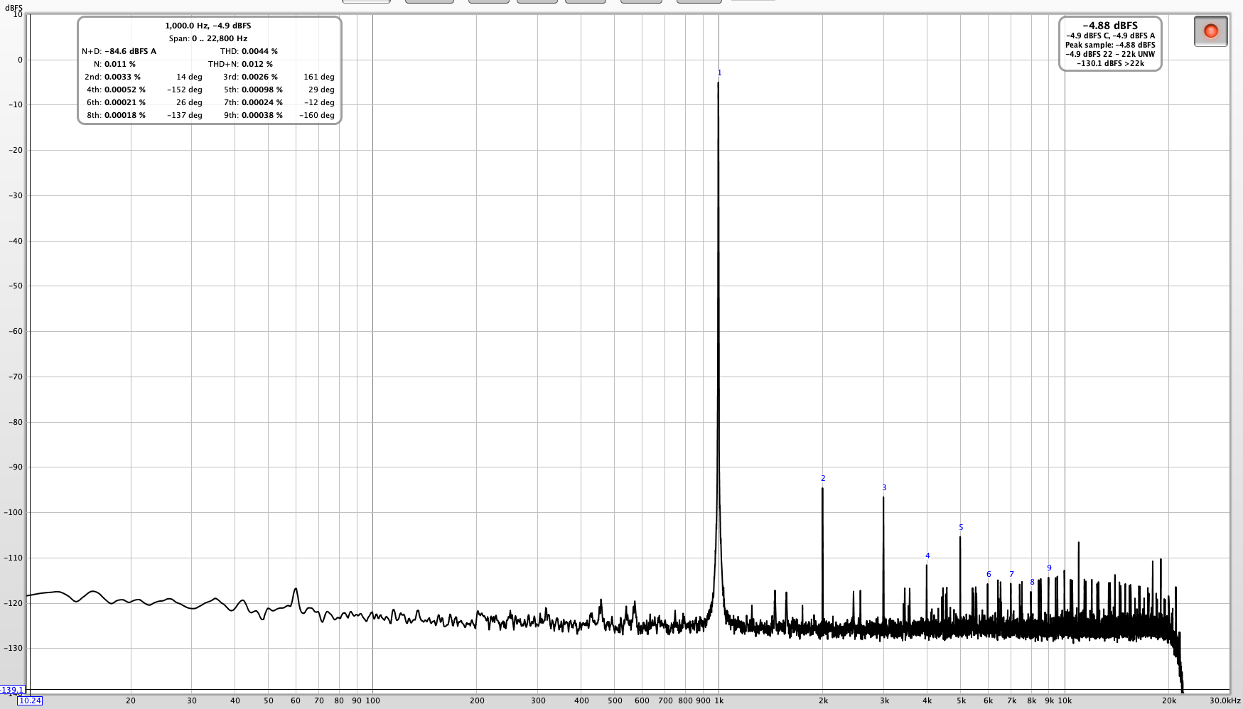

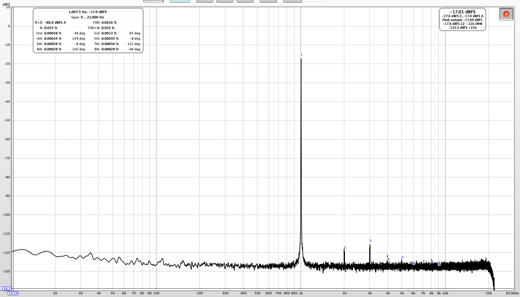

Anyhow, loopbacks of the UM2. It's a noisy environment, so that shows (or there is a lot of noise associated w/ the device). Both voltages were calibrated to 400mV RMS. First is using the internal generator, and the second is using the Akitika. No idea why the dBFS scale is showing up different on both of them. The voltage was measured and I calibrated that in REW. I assume that is why it's showing a higher relative noise on the Akitika graph (since the fundamental is lower). Clearly the Akitika is an improvement.
Also to note is that I cleared my calibration file before running these so they are legit. Using that feature really makes even this lowly UM2 a decent instrument to measure distortion as it cancels out the device pretty well.
Internal Generator:
Akitika:
Don’t know why but when I link an image hosted elsewhere, it shows up just the same resolution. You might try uploading images to DIYA server as attachment. That way, image link can never be broken for perpetuity.
Thanks for the reply! Weird that yours show up fine. As for the attachments, I didn't even see that option before! I thought all I could do is insert an image. Let's try that:
