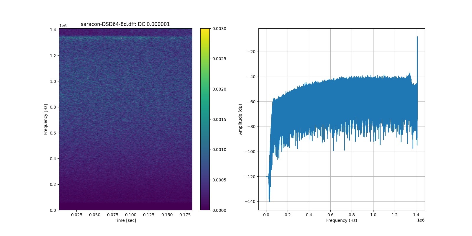

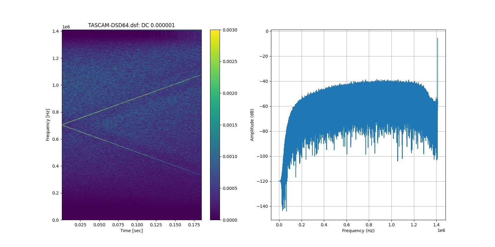

There is something strange about these plots. Assuming that the normal input range is -1 to 1, with -1 corresponding to 25 % ones and 75 % zeros, 0 with 50 % ones and 50 % zeros, and 1 with 75 % ones and 25 % zeros, and that the SOX modulator is a plain single-bit sigma-delta, I would expect to see a tone or narrow bump at half the sigma-delta sample rate, 1.4112 MHz, when the input signal is 0. Offsets should shift it by 705.6 kHz per unit offset, so you get an audible mixing product with a 1.4112 MHz ripple at the reference or clock when the offset is between 0.000028 and 0.028 or between -0.000028 and -0.028. At +1 or -1, it should end up at a quarter of the sigma-delta sample rate, so 705.6 kHz.Here are the spectrograms for a range of DC offsets. Structured noise is definitely there, with a FM tone in the middle. It looks quite neat when flipping through the pictures. So it is a big failure for this encoder.
https://peufeu.fr/audio/dsd_6_spectrogram_dc.zip
Marcel, here is the python source code. It is quite simple, just loading the raw DSD file and using the spectrogram function. You could use it on your modulator, just by adapting the IO. I'm curious to see if your multibit approach gets rid of these tones.
https://peufeu.fr/audio/dsd_6_spectrogram_dc.py

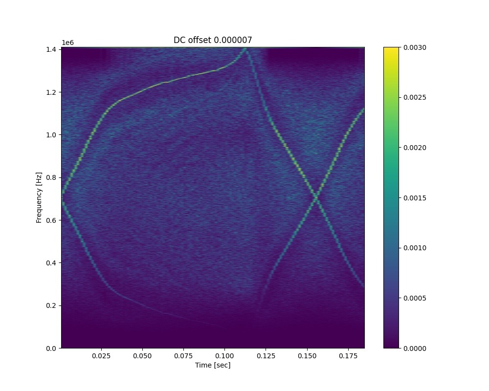

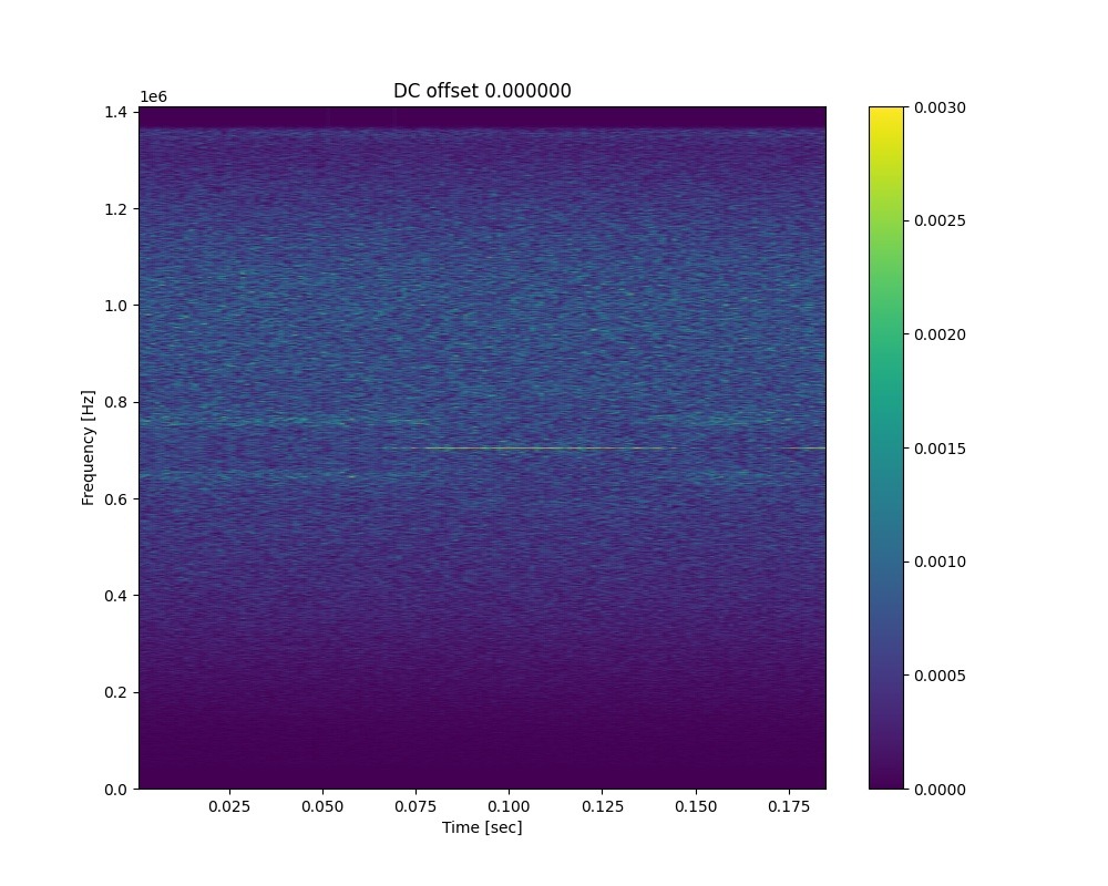

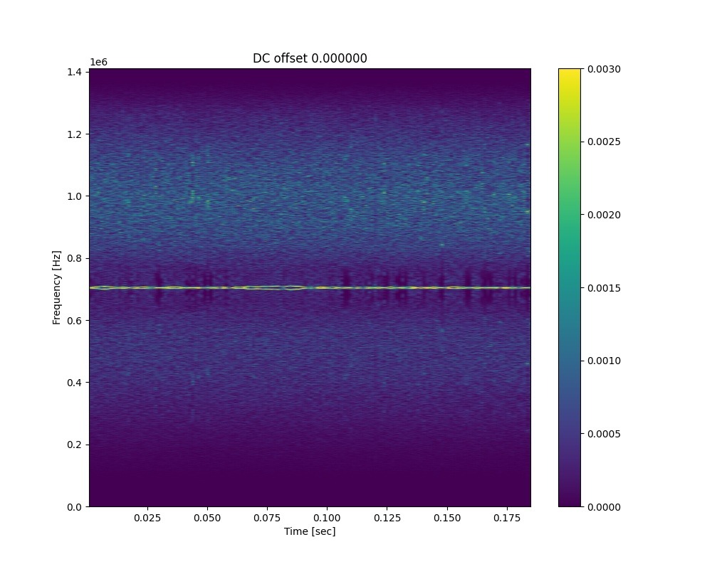

Instead, you get a tone at 705.6 kHz for an input of 0 instead of +/- 1. Some mix-up between signed and unsigned maybe?

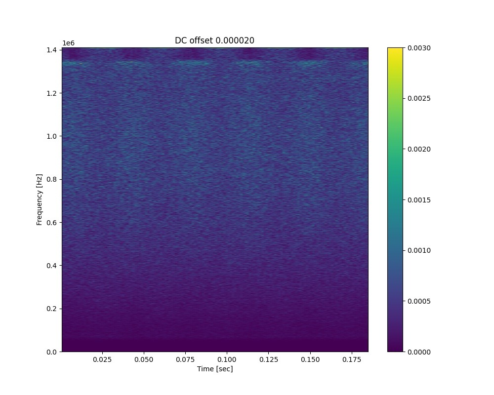

A small offset should just shift the tone a bit, not modulate it all the way from 0 to Nyquist, but still you get this at an offset of -0.000007:

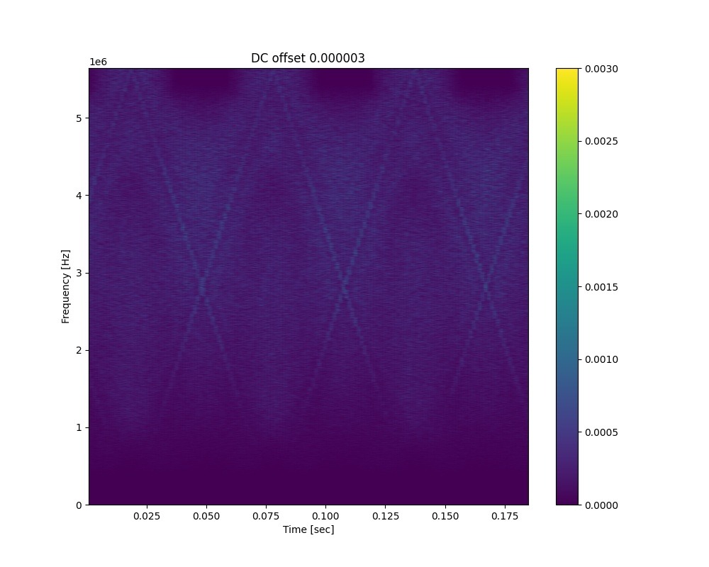

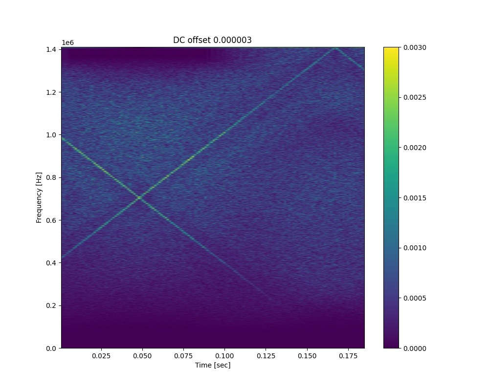

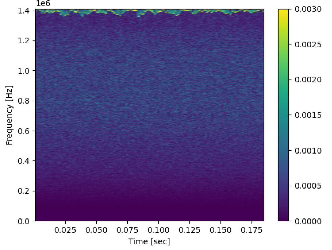

No offset, here it is playing music. But look at the top of the spectrum! It looks like the music is encoded in the noise or something. Modulating this with half the sampling frequency, as you suggest, should be interesting. It's just like having 32*Fs noise frequency on VREF.
Here is the result. It is still aligned, so you can play it along with the original file.
Basically I just multiplied the DSD signal by (1,-1,1,-1...). So if you want to know what a 0.01% ripple on VREF sounds like, scale this to 0.01% and listen to it or add it to the original song. (spoiler: it's atrocious)
https://peufeu.fr/audio/05 Grandmother.flac-derivative.flac <--- WARNING: this one is full scale, so lower the volume a lot!
This plot looks exactly as I would expect when the music is soft, about -20 dB or so. The momentary value of the music modulates the momentary frequency of the idle tone around half the sigma-delta sample rate. The idle tone has an alias at fs,sigma-delta - ftone, so you always get a tone below fs,sigma-delta/2 that depends on the absolute value of the momentary value of the music.

No mix-up, it's all in float32, I checked the DSD sample values and they are correct. The tone at 1.4M is there, but low amplitude, so it didn't show on the spectrogram due to the limited color scale.and that the SOX modulator is a plain single-bit sigma-delta, I would expect to see a tone or narrow bump at half the sigma-delta sample rate, 1.4112 MHz, when the input signal is 0. Offsets should shift it by 705.6 kHz per unit offset, so you get an audible mixing product with a 1.4112 MHz ripple at the reference or clock when the offset is between 0.000028 and 0.028 or between -0.000028 and -0.028. At +1 or -1, it should end up at a quarter of the sigma-delta sample rate, so 705.6 kHz.

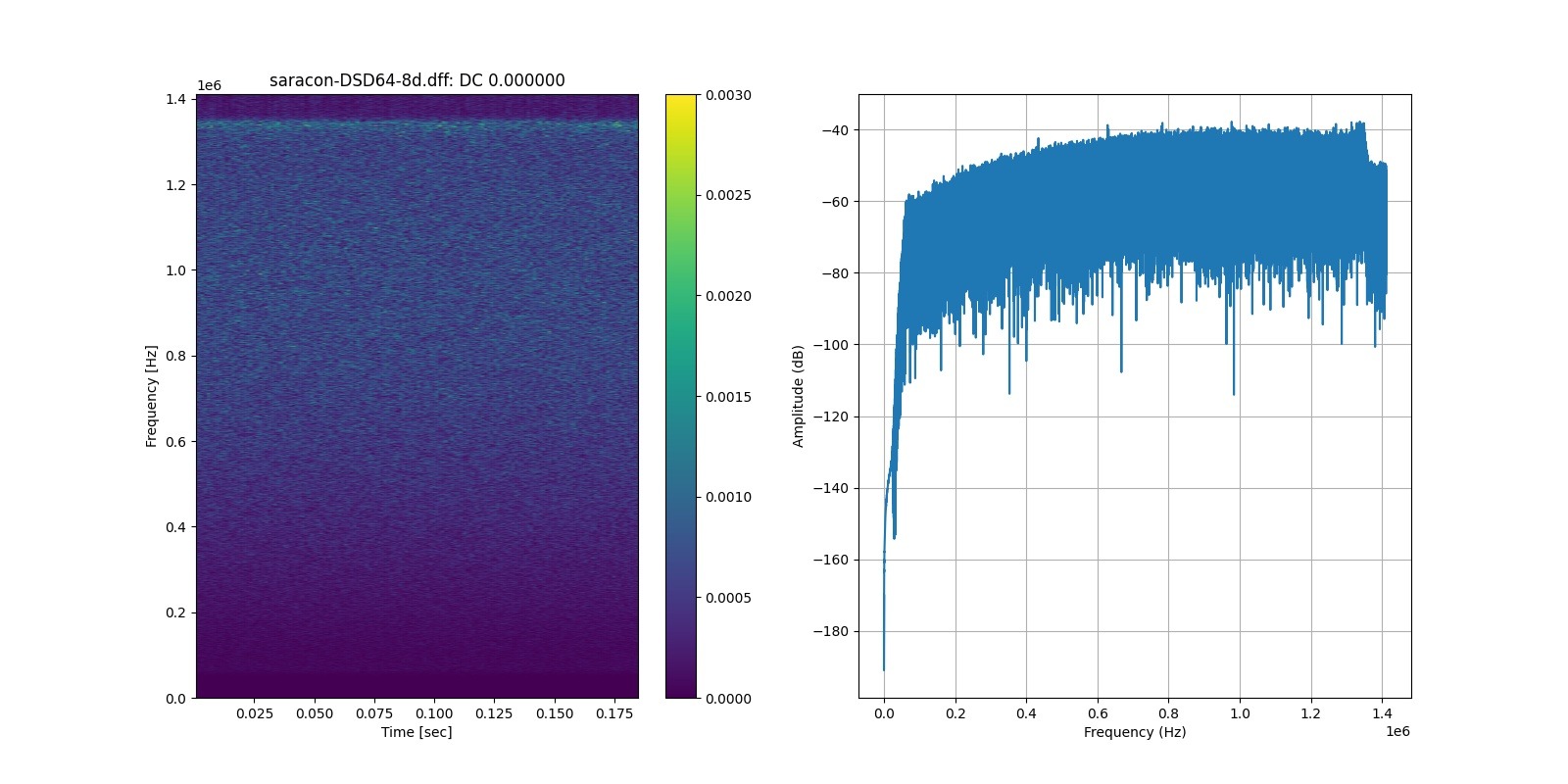

Well I guess this modulator has problems! Mark's Japanese software and SARACON are much cleaner.A small offset should just shift the tone a bit, not modulate it all the way from 0 to Nyquist, but still you get this at an offset of -0.000007:

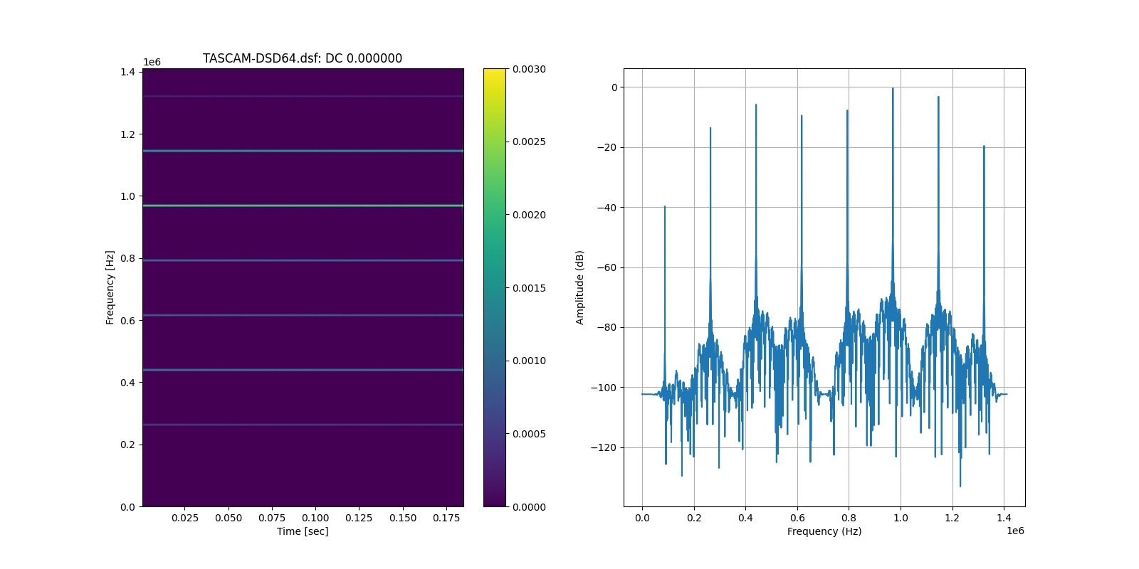

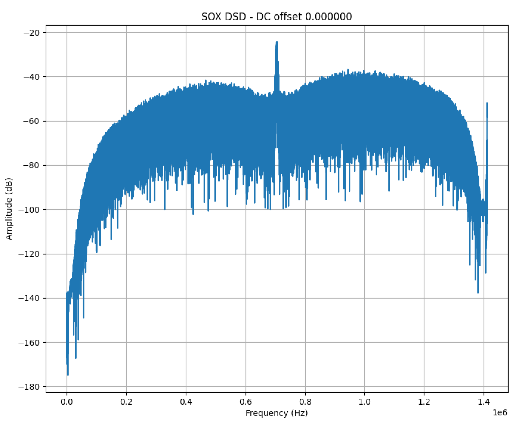

That spectrum plot (post #268) looks like the whole modulator is running at half the intended clock frequency, DSD32 instead of DSD64. I thought the spectrogram with music from post #253 looks perfectly normal, but actually I don't see the music at audio frequencies (the bottom part is all dark).
Multibit sigma-deltas need not have tones around fs,sigma-delta/2. Whether they really don't have them depends on the design.
It's running at DSD64, it just has a pretty bad idle tone.That spectrum plot (post #268) looks like the whole modulator is running at half the intended clock frequency, DSD32 instead of DSD64.
Yeah I noticed too. It's in pixel #0 which is hidden under the X axis. Matplotlib oddity 😀I thought the spectrogram with music from post #253 looks perfectly normal, but actually I don't see the music at audio frequencies (the bottom part is all dark).
If I drag the plot, it's there.
The plot of post #268 has a notch around 1.4112 MHz. Normally you only get notches around multiples of the sample rate, as those are aliases of the band around 0 Hz. Then again, the spectrum just below 1.4112 MHz doesn't look like the mirror image of the part just above 0 MHz.
