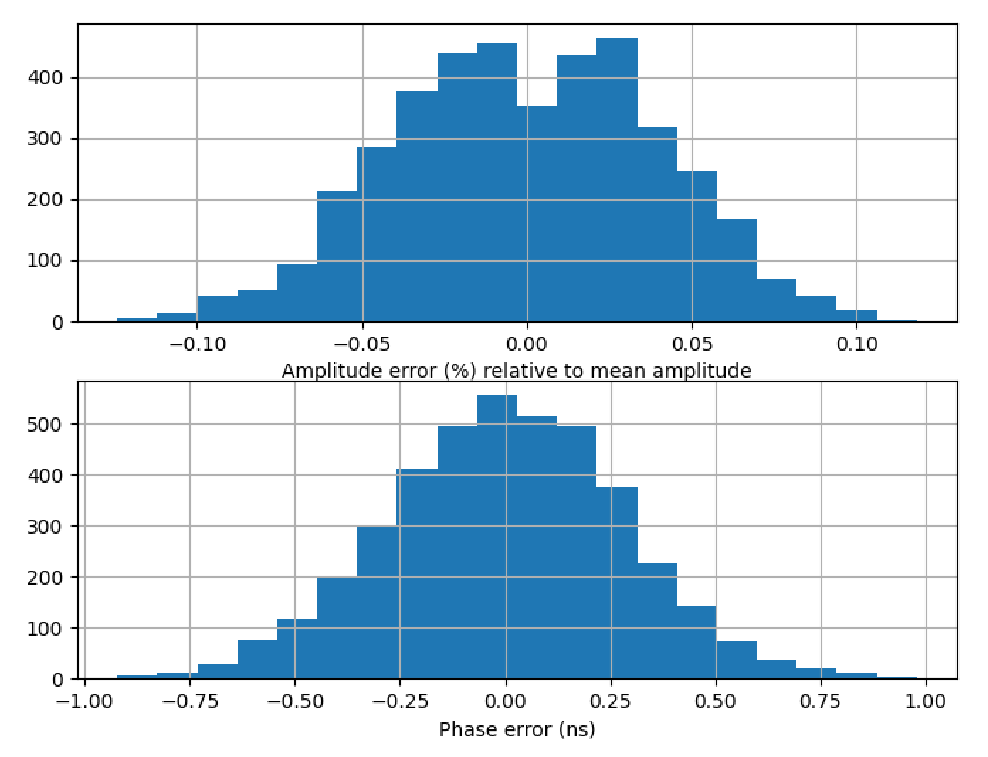

Another test is to encode a sinewave at 11025 Hz into DSD, then on each period, detect the magnitude and phase.
RMS amplitude error 0.039762%
...and I discover the sox DSD encoder adds a 1 DSD sample delay, which is corrected here.

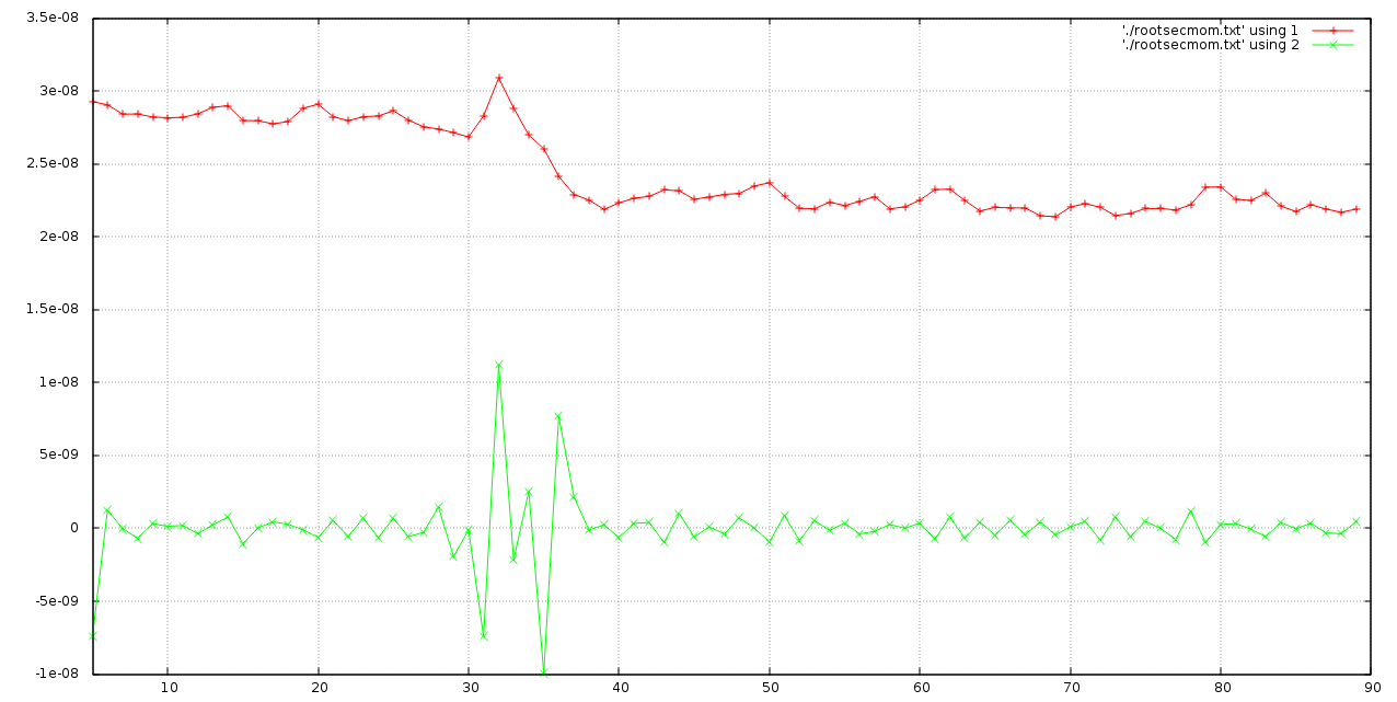

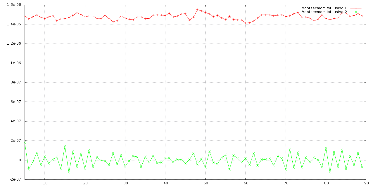

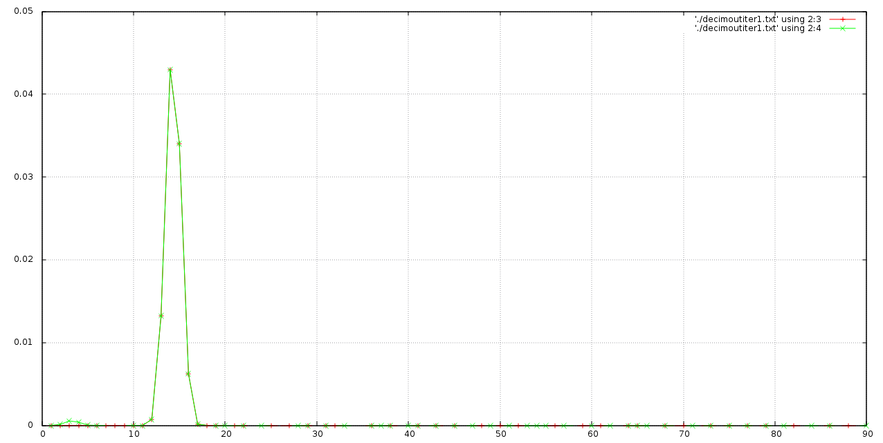

Response to an input sample of 0.1 at time point 10, red: only filtered, green: decimated sigma-delta modulate (first of the iterations).

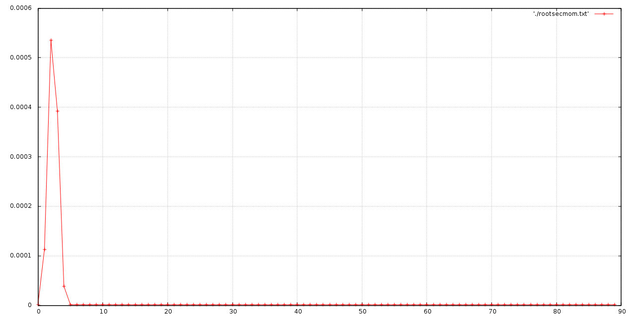

Root of the second moment of the difference between the decimated sigma-delta modulate and signal that has only been filtered, calculated over 1000 iterations. I could simply call it the standard deviation if I had used the second central moment, but I took the root of the average of the squared errors, so errors that occur in each iteration also count.
Settling part cut off:
The signal doesn't seem to have much impact on the noise, not for this specific algorithm and signal and without any DAC imperfections anyway.
Average over the 1000 iterations in the same plot, so you can see it isn't an offset or a gain error. Red: root of the second moment, green: average of the error.
Example of weird behaviour of my chaotic sigma-delta modulator, the one with the non-stationary noise issue. I've now put the pulse at 30 rather than 10. The noise is weaker after the pulse than before it. The level is astronomically low, but I have heard effects like that with a much higher level with this modulator and a non-ideal DAC.

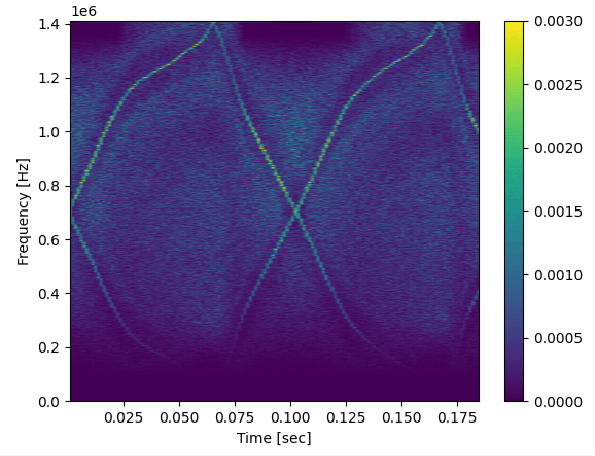

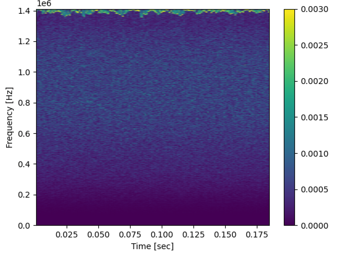

How about a constant offset of 0.002 as the signal and 1.4112 MHz reference ripple? That should convert the main idle tone to the audio band, if they didn't do anything to prevent that.
I did a spectrogram instead, over the whole bandwidth (0-1.44MHz). This corresponds to the beginning of the Rebecca Pidgeon track, which contains only very low amplitude noise. The scale should be in V^2/Hz.
The audio band is at the bottom, and it is suitably dark. However, the higher frequencies contain structured noise, with what looks like a frequency modulated tone. So, any noise frequency modulating the analog reference (or clock jitter) will fold back a portion of this into the audio band, which results in the modulated noise that is audible on the difference file I posted earlier.
I am going to try various DC offsets now.
Here are the spectrograms for a range of DC offsets. Structured noise is definitely there, with a FM tone in the middle. It looks quite neat when flipping through the pictures. So it is a big failure for this encoder.
No offset, here it is playing music. But look at the top of the spectrum! It looks like the music is encoded in the noise or something. Modulating this with half the sampling frequency, as you suggest, should be interesting. It's just like having 32*Fs noise frequency on VREF.
Here is the result. It is still aligned, so you can play it along with the original file.
Basically I just multiplied the DSD signal by (1,-1,1,-1...). So if you want to know what a 0.01% ripple on VREF sounds like, scale this to 0.01% and listen to it or add it to the original song. (spoiler: it's atrocious)
https://peufeu.fr/audio/05 Grandmother.flac-derivative.flac <--- WARNING: this one is full scale, so lower the volume a lot!
Conclusion (and back to OP's topic which we kinda hijacked):
1) If the sigma delta DAC's output noise is modulated, its performance and associated distortions will be heavily dependent on analog implementation, as any HF noise or jitter will fold the modulated noise back into the audio band (but everyone knew that already). So it is not possible to simulate it with code and call it a day.

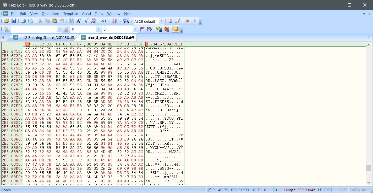

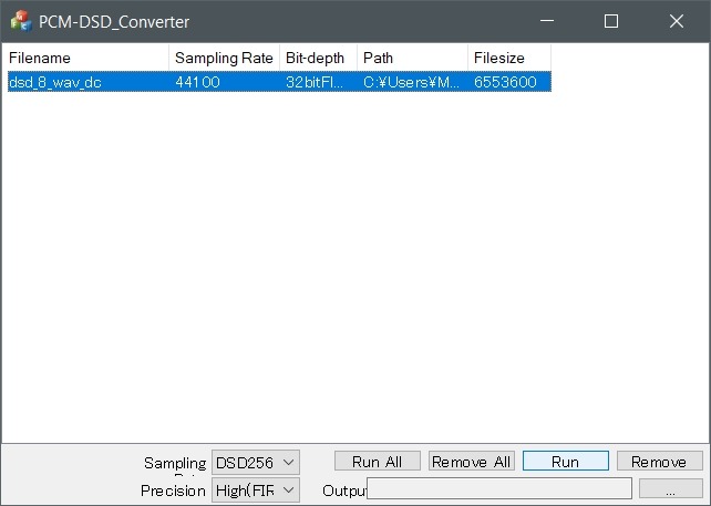

Hmmm... Tried converting a couple of files to DSD256, a real music file and the DC file. Hexedit doesn't look to be showing all zeros. Haven't tried to play either one on a dac yet.
Converted DC file is in my Dropbox: https://www.dropbox.com/s/p1pbgpzj5pzm0y2/dsd_8_wav_dc_DSD256.dff?dl=0
EDIT: Don't know if it makes any difference, but I highlighted the file I wanted to convert and hit 'Run." Settings shown in attached pic. Its the 64-bit version.
Thanks!
The noise spectrograms look a lot more civilized with this encoder, but this is DSD256, not comparable to the previous one which was DSD64. Here are the plots:

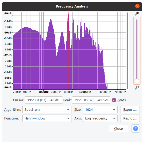

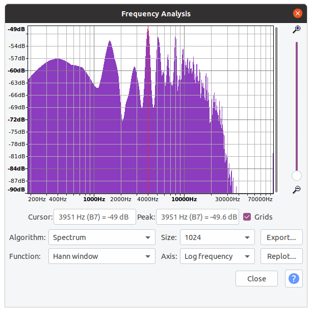

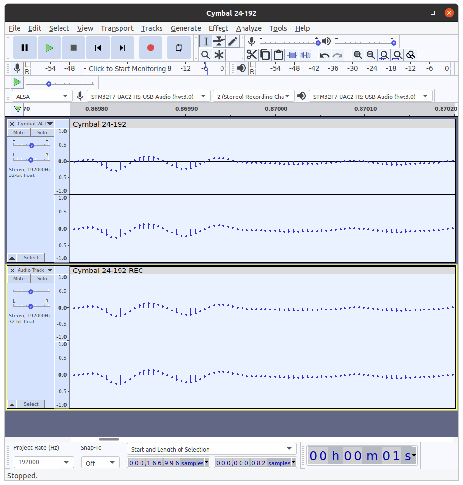

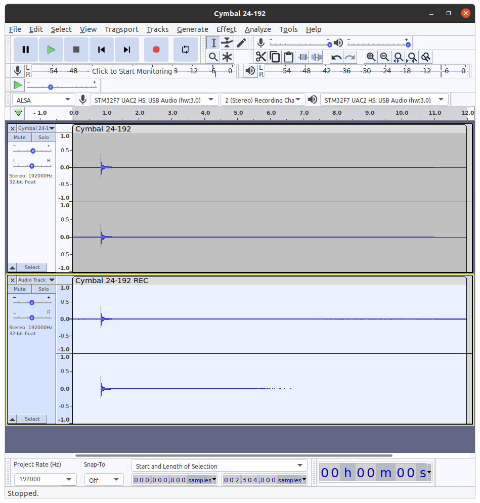

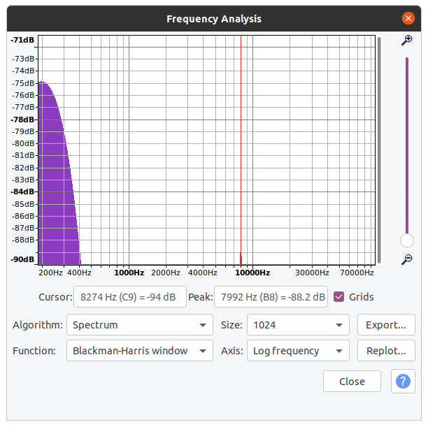

Out of curiosity I made some real-life measurements using Markw4's cymbal recording. I used a loopback of AK4490 and ES9822PRO so I played the file with AK4490 and re-recorded the result with ES9822PRO.Aside: Regarding the study of transients, from an audio reproduction perspective the waveform of a cymbal can be considered an extended transient response event starting with an impulsive attack. It is too complex too understand very well in the frequency domain (and something most dacs aren't very good at reproducing). A sample cymbal hit I recorded for forum use: https://www.dropbox.com/s/6j0di4eo3tqgind/Cymbal 24-192.wav?dl=0 Please note the file contains some ultrasonic content. ...Also, perhaps the sound could be played backwards for use as a settling time measurement impulse? Some DAW programs can perform time reversal of a wave file (an effect sometimes used in pop music).
Here is a waveform of original recording and the re-recording. The original was resampled to 32-bit float as my USBI2S board uses 16/32-bit depth.
There is some strange low-level noise (or DC offset) in the original recording after the transient.
Here is close-up showing samples at the beginning of transient.
So actually the transient is not very steep.
Here is a spectrum of original recording.
I assume that the stuff below 400Hz is not from cymbal.
And the spectrum of the re-recording.
Finally I inverted the re-recording and mixed it with the original to produce a difference.
Highest peak between 400Hz-30kHz is at -88.2dB. I assume the stuff below 400Hz is some noise in original recording.
