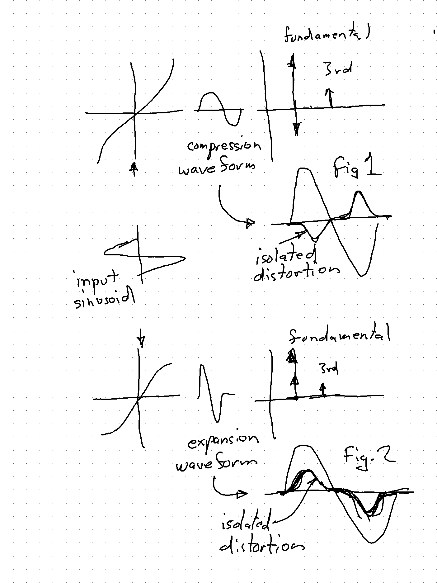

Compression and expansion often are not always results of HD. Sometimes compression and expansion can produce HD transiently depending on attack and decay times. Signal correlated power supply sag on LF transients might produce effects that fall into that category.
Total Harmonic Distortion or "THD" measurements using a fixed input sinusoid cannot necessarily resolve the non-harmonic spectral component distortions, in particular the fundamental frequency distortion caused by gain error.
IMO THD is only a special case of Total Spectral Distortion or "TSD". From the figure, when using either a compression or expansion transfer function, the extracted distortion component itself is made up of a fundamental frequency distortion component in conjunction with a 3rd harmonic. The difference between an expansion or compression waveform relates the phase of the fundamental frequency distortion component that either increases or decreases the projected amplitude of the fundamental frequency in the output spectrum. The projected undistorted fundamental frequency is referenced to that projected from a straight line gain slope passing through the origin .
If we consider that the input amplitude is changed from one amplitude to another the transition (or transient) between these two states cannot hold the fundamental spectral line as pure. The amplitude, and lack of purity of this fundamental frequency component (in conjunction with harmonics) seem a likely contributor to psycho-acoustic phenomenon being detected, particularly if modified by frequency response conditions subsequent to the point of the non-linearity.
Although the conversion from the time domain to the frequency domain can be concluded lossless there seems a general faulty error in the interpretation of the spectral components, in that the fundamental frequency is distortion free. This as opposed to being made up of more than one fundamental frequency component that ought not to be concluded as singular and a non-contributor to psycho-acoustic phenomenon.
