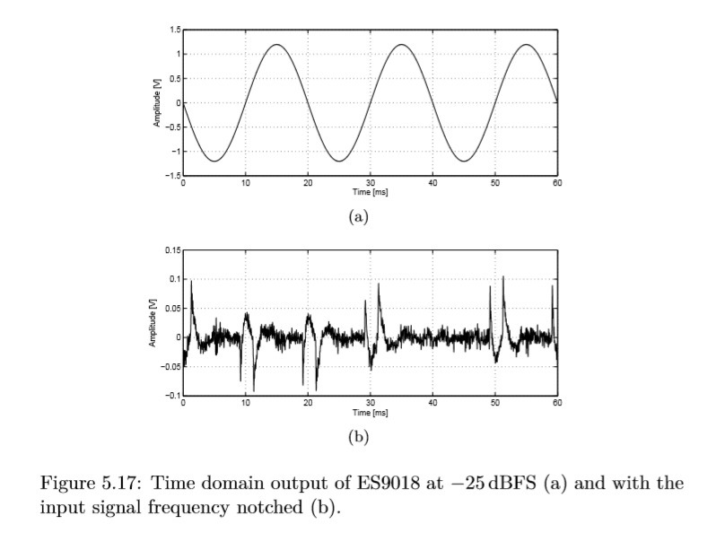

Also, the distortion residual you found has some similarity to the ES9018 I/V opamp output residual posted by Scott Wurcer. Scott said it was hump distortion. Attached below for reference.

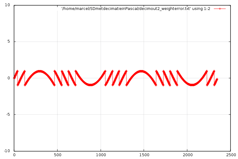

I would beg to differ. Looking at the time-domain residual is bascially looking at the sample value transfer function error directly, with only little deformation (at the top and bottom section of the exciting sine).
Only the observation of the development of the residual error vs level finally gave me the right clue what's really going on with the infamous "ESS hump"... a periodic ripple on top of the sample value transfer function. The total number of periods of that ripple correlated to the number levels of the final output DAC, bingo.
Staring at spectra doesn't give much insight, I would agree, though.
The -20 dB error waveforms look quite familiar to me. I think I've seen waveforms like that when simulating low-order undithered sigma-delta modulators and subtracting a low-pass filtered version of the output signal from the input signal. Those were probably single bit modulators driven close to full scale, though.
I was mixing up things, of course. It looks like folding distortion, or (equivalently) like the quantization error of an undithered multibit quantizer. No idea why you get a much attenuated quantization error of a rather coarse quantizer on top of the desired signal, though.
If the multibit sigma-delta modulator mainly switches between adjacent levels, maybe the transition density depends on the fractional part of the input signal?

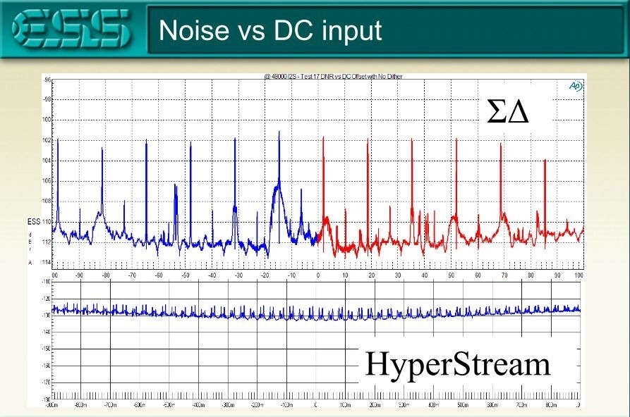

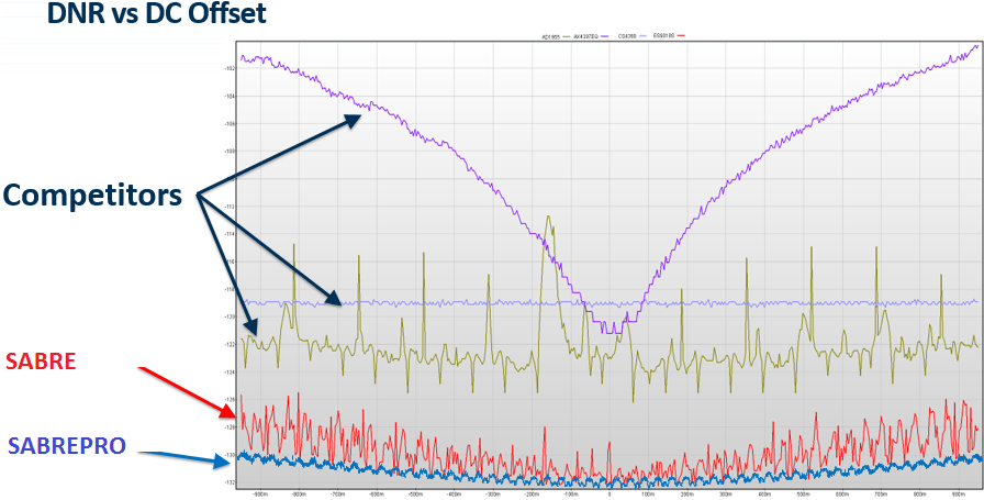

Marcel, ESS has touted their Hyperstream modulator as suppressing signal correlated noise in a unique way. There was a graphic showing a comparison between hyperstream verses competitor dac modulator noise as a function of DC offset level. Can't find that one right now, but do find one attached below. Might that make any sense with respect to your hypothesis?
EDIT: Just found the other one 🙂
I don't know. Those noise plots show a periodicity of the noise with the input DC input level that ideally shouldn't be there, but the time average of the error would have to be periodic with the DC input level to get the distortion waveforms KSTR measured.

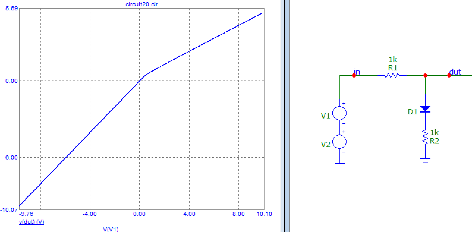

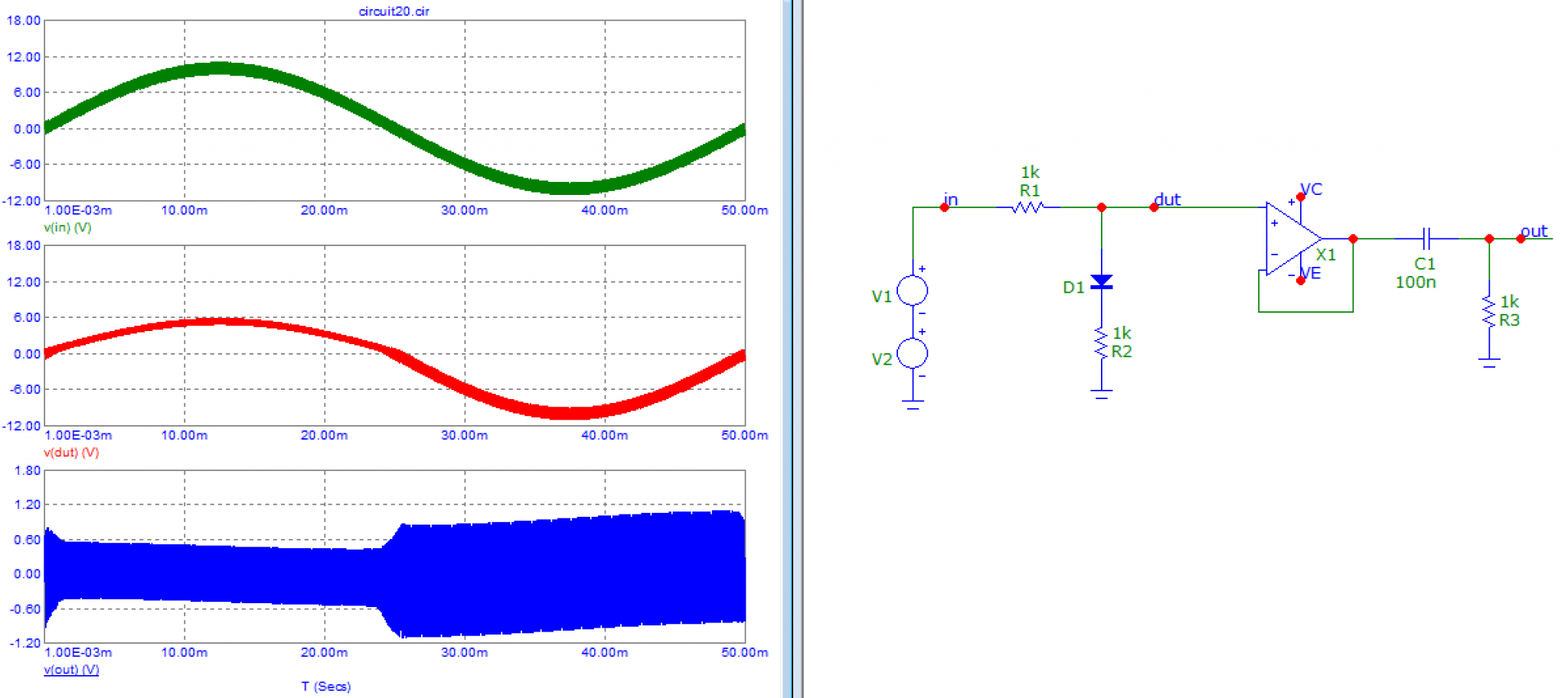

Here's an example:
The circuit R1 D1 R2 has a gain of 1 if v(in)<0V and a gain of 0.5 if v(in)>0.6V, with a transition as the diode turns on. Its transfer function is on the left.
Nice explanation, thank you, much appreciated (I was "lost" anyway in using two amps for the measures).
From the last graph shown (in blue) we then obtain the derivative of the transfer function and from this the function itself. Very effective. Considering that with the same level of signal y (red curve) the derivative does not assume the same value, we obtain two transfer curves: one for the increasing signal and one for the descending one. The reason is given by thermal effects, as you have already described, which introduces memory effects, not contemplated by the "static model".
Not just that. It could simply be phase, that has to be corrected first, otherwise with enough phase shift your transfer function will look like a circle. Once this is done, there are indeed many differences between the "going up" and "going down" transfer functions. For example in a class AB amplifier, the two halves of the output stage use complimentary transistors, and these devices don't turn on and off at the same speed. So the crossover will look different depending on the polarity of the slew rate. If the circuit has problems, some part may be close enough to running out of current when slewing in one direction but not the other (a form of TIM). And... due to charge storage and other effects, the transfer function also depends on slew rate. Then there are thermal effects.

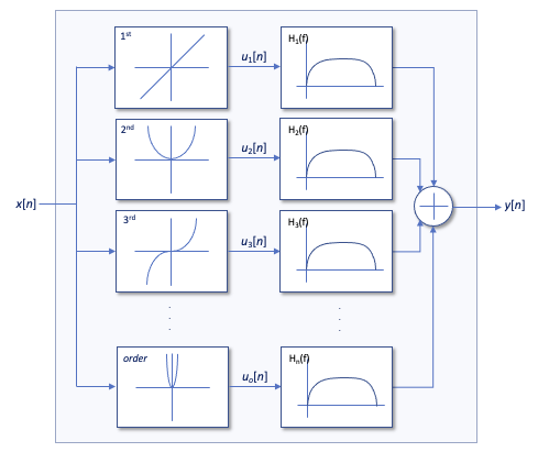

On this point I have developed both simulation models, static and dynamic.
For the static model I have done a lot of insights with the posts that I have already published (I have other in progress, such as the concatenation of systems and feedback). In summary, by injecting 2nd and 3rd harmonic distortions into musical signals, the listening effect (with blind tests) is what is commonly found: warm or dynamic expansion/compression. The least "fitting" aspect is that the distortion levels that I have to inject into the musical signals to hear changes are much higher than those resulting from measurements of real amplifiers: at least 1%, with 75-80dB SPL. A sign that the model is an “ideal” starting point, not taking into account the inevitable memory effects.
The dynamic model, much more complex, is based on Volterra's Diagonal Kernels. Simplifying as much as possible, here I measure the frequency trend of the distortion of each harmonic, in module and phase. Then, each Hi(f) curve is inserted into the model, according to the following classic scheme:
The first part of each branch "isolates" the harmonic component of order n with a suitable polynomial; the second part takes into account the memory effects, with phase rotations and amplitude modulation of each distortion depending on the frequency. Linear distortions are also modeled with H1(f). I still have to carry out in-depth experiments to understand the scope of applicability: how faithfully can you reproduce the amplifier behavior "black box"? Are there any categories/limits to consider? Where applicable, it allows us both to study aspects that are difficult or impossible to obtain from direct measurements, and to predict the sound of specific distortion trends.
