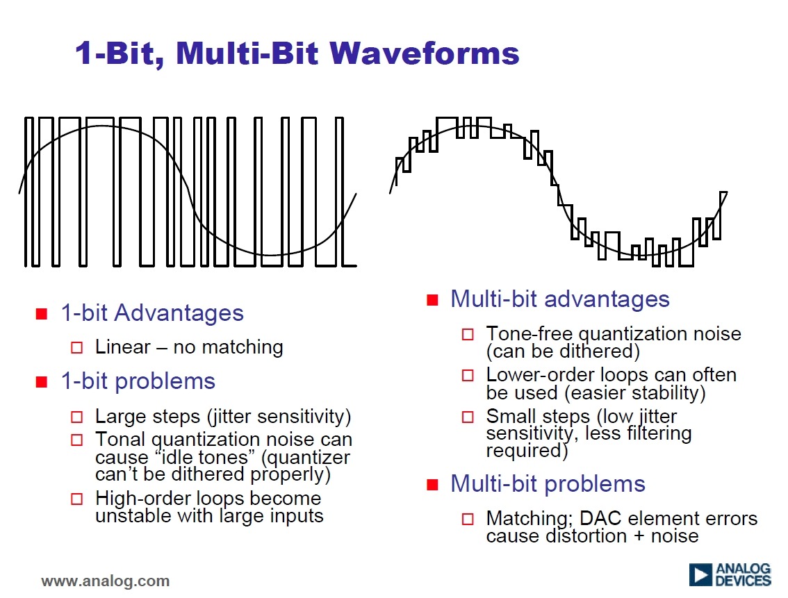

Which leaves us where, would you say? Eventually it will come to the question of why people often prefer the sound of high quality DSD instead of PCM. Maybe because of the component matching problem in physical multibit dacs? Maybe preference also depends on clock jitter/phase_noise levels (since DSD is said to be more sensitive to that factor)?
Yet, almost every single DSD release has a previous life as PCM.
One of the reasons for converting CD rips to DSD appears to be because DSD is inherently more linear for conversion back to analog. In other words, dacs that can operate in either PCM mode or DSD mode to play back CD audio may sound better when operated in DSD mode. What it suggests to me is that there is a problem is in the D/A conversion stage, not necessarily earlier in the reproduction chain.
AKM dacs such as AK4499 have a volume control bypass option for DSD mode that avoids remodulation. Even with ESS dacs, back a few years ago when I was experimenting with ES9038Q2M it sounded better to me and others in DSD mode during A/B listening comparisons. Anyone can try HQ Player for free in demo mode with an ESS dac to see what they think about PCM verses DSD. Roon also has a fairly good DSD modulator, although not quite as good as the best of HQ Player.

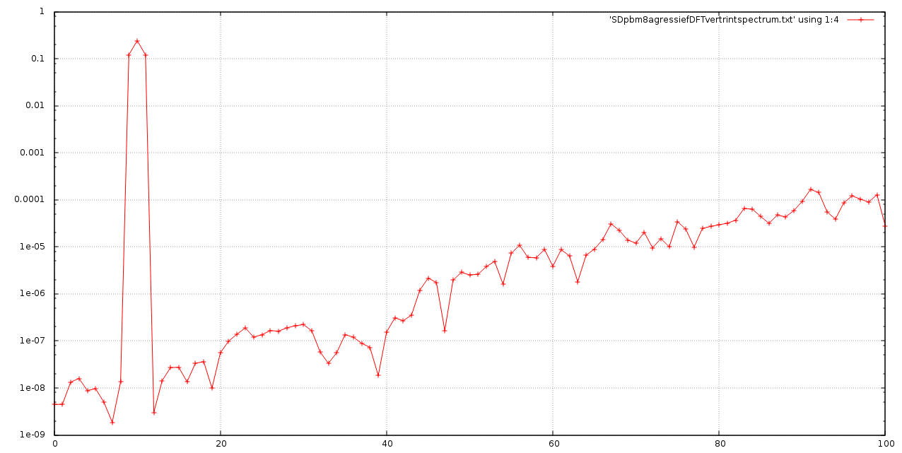

Oh I meant measuring THD on the digital output, like putting sin(wt) as signal source in the code and FFT'ing the result (at 27Msps)...
I probably did, but didn't store any pictures of it, so I just generated two:
10 kHz, amplitude = 0.5 (maximum intended level), DFT bin size 1 kHz, Hann window:
The peak only goes to 0.25, presumably because of the way I implemented the Hann window.

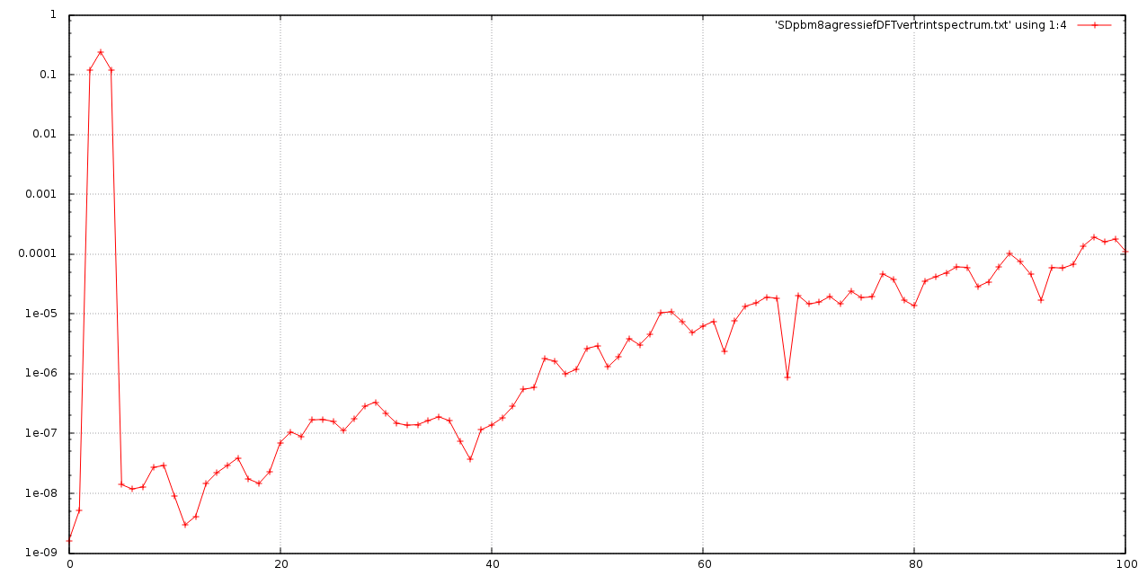

Now with 3 kHz, amplitude = 0.5:
