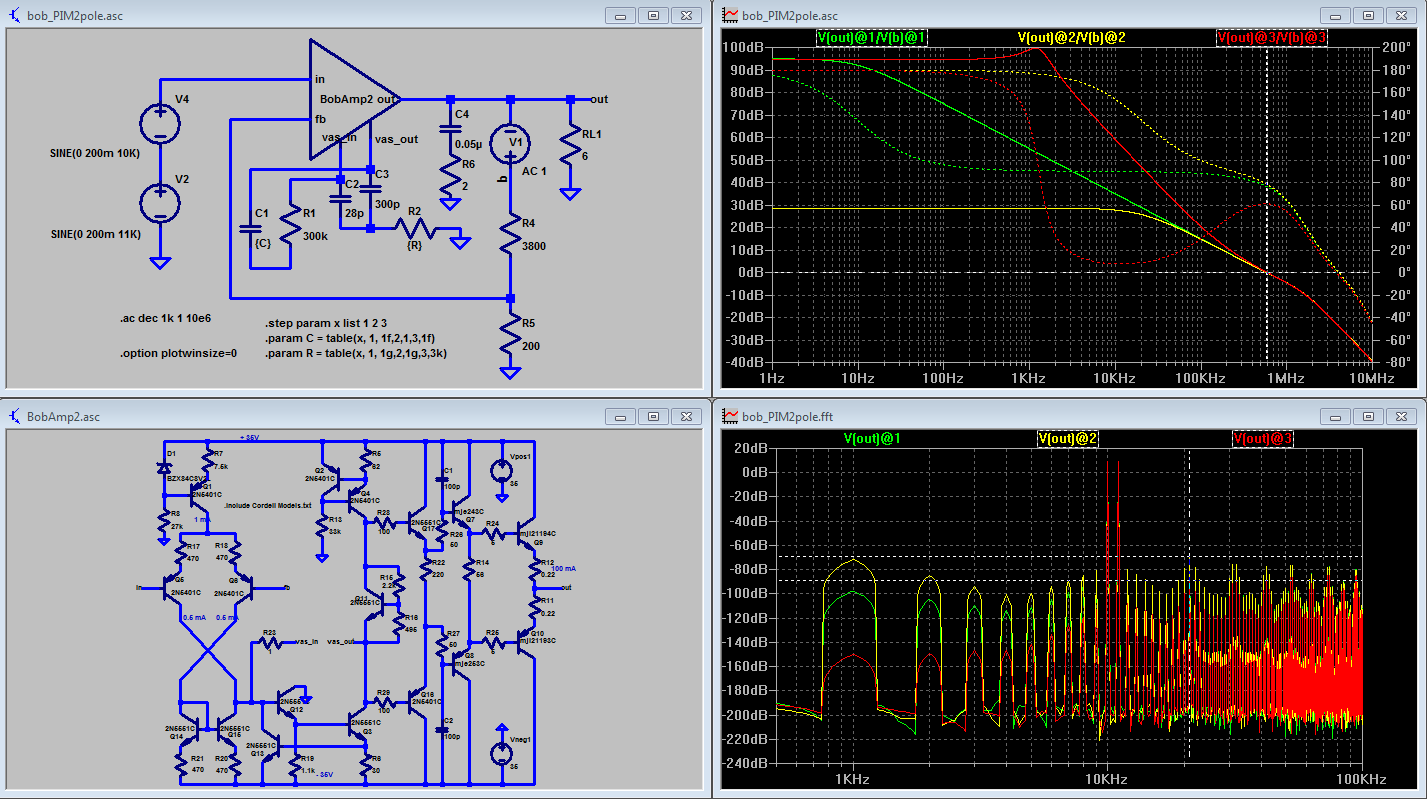

maybe you didn't read all of it - Leach joined Jung in repudiating their 1st opinions on Otala's "flat loop gain" over audio prescription
both recognized, wrote later, that low "TIM/SID/PIM" could be obtained in high loop gain amps with high, sloping gain over audio
a high loop gain capable amp can easily use that gain with 2-pole compensation to reduce all IMD products, regardless of phase
http://www.diyaudio.com/forums/loun...ch-preamplifier-part-ii-9215.html#post5066347
amp from Bob's book - 3 compensations:
green trace - nominal dominant pole
yellow trace - added 300k R, R||Cdom to flatten gain, get "wide open loop gain" (couldn't load the beta enhanced VAS out heavily enough with shunt R to gnd)
red trace - 2-pole
i read the debate between Leach and Cordell at the Audio magazine many many years ago..i have made super leach amps in the 80's and people who heard this amp liked what they heard...
i also remember that with tubes, open loop gains were not that high.....
some did not even have global negative feedback networks...
but still some had lots of local negative feedback...
yes, maybe i need to change my thinking.....
and like they say, the acid test of the pudding is in the eating...
