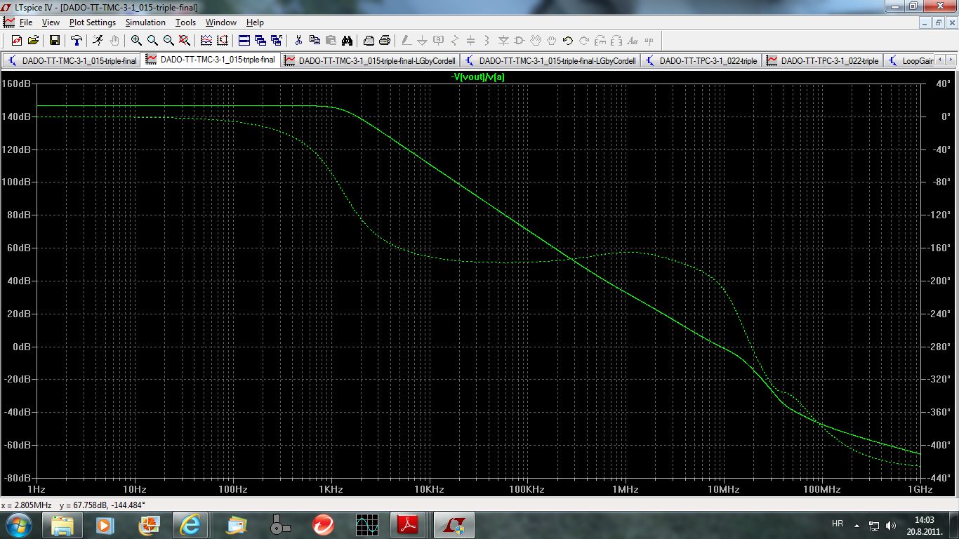

I just put the TMC resistor on the amplifier output side and not the NFB point side. Then I plottet the amp output. My LG plot seems ok that way and it matches what he wrote about the 0 dB point. When I compare his way of inferring OLG and his way of plotting LG, the gain crossover from the OLG plot and the point where the LG reaches 0 dB matches more or less exactly, both being around 500 kHz. This is how it is supposed to be.
In my view that more or less validates the 2 methods on plotting OLG and LG.
Same way how I did firt time, but I am not sure that in this way TMC was put in the picture.
dado
Compare these 2.
OLG and LG.
OLG gain crossover and LG 0 dB point match more or less.
The difference being around 10 kHz, due to measurements inaccuracies and the fact that the plotting methods for both OLG and LG arent 100% accurate, they are just very close approximations.

Changed my 21K5 resistors in my NFB to 1Meg, as per Cordell. See Inferring loop gain, page 415, bottom. It is not accurate below 10 kHz but above it is reasonably accurate.
See picture.
See picture.

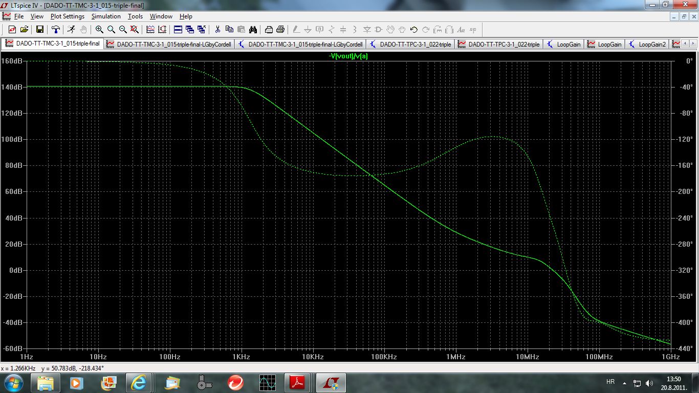

Well, if I simulate OLG with Middlebrook probe, the OLG gain crossover and LG 0 dB point dont match. However, if I use the OLG method as Cordell described it, the OLG gain crossover and LG 0 dB point more or less match.
Also, look at the weird phase swings, that cant be right either.
This leads me to believe that there is something wrong with the Middlebrook probe method, most likely that it doesnt work correctly with TMC.
I'm by no means an expert in this, but it seems to be the logical conlusion.
Another thing, if you use Middlebrook probe with regular miller compensation you get some rather interesting results as well, you not only get phase without weird phase dips, but you also get a gain plot that looks very close to a LG plot and not an OLG plot.

Hmm, take a look at this.
1. LG, Cordell method.
2. Middlebrook method, but with the TMC outside of the feedback, connected to the right side of the AC source inserted in the feedback path. Looks like LG to me.
Look at the 0 dB point, identical, the only difference is Phase, but that is not unusual when you use different methods.
Still sure Middlebrook probe shows OLG? Looks like LG to me.

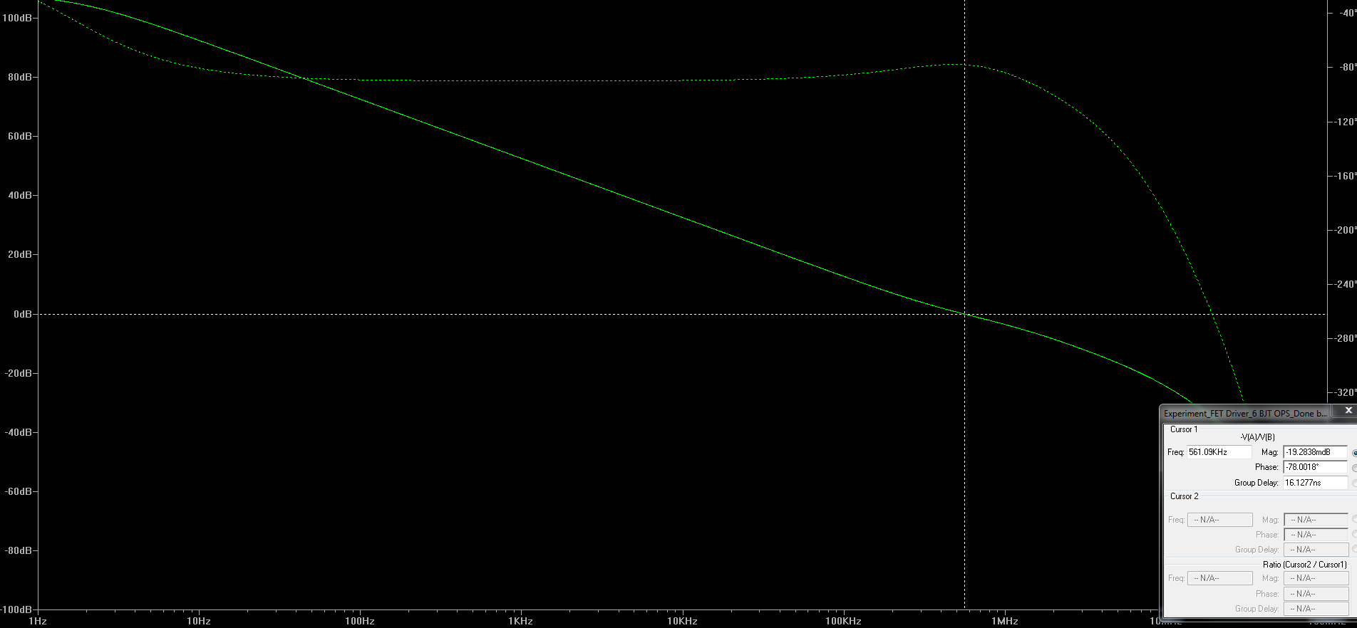

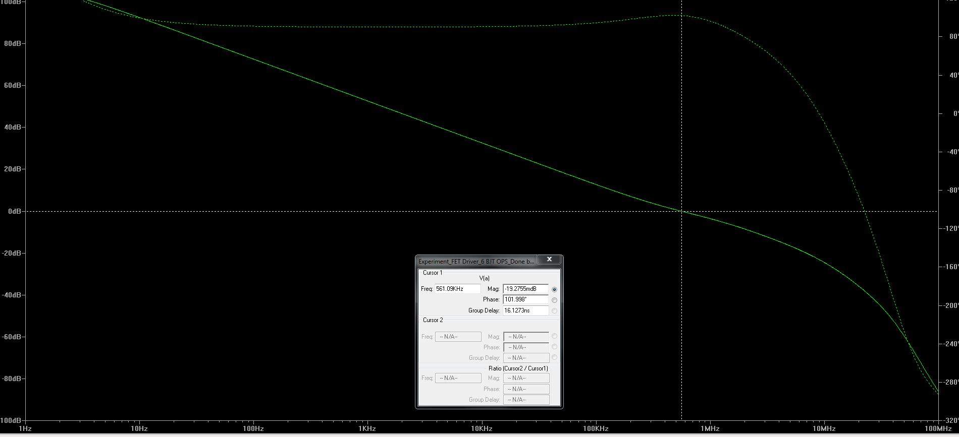

Tried simulating both.
Middlebrook probe, with TMC resistor connected to amplifier output, 0 dB point around 1.675 MHz.
Cordell LG method, with once again TMC resistor connected to amplifier output, 0 dB point around 1.675 MHz.
Looks like they match, although they show a little variation in phase at the 0 dB point, just like my own 2 previous examples.
I guees that for LG the Middlebrook probe might be the best to use, since it will give you a little less phase margin, so when you trim your amp for phase margin you would be more on the safe side with the Middlebrook probe.

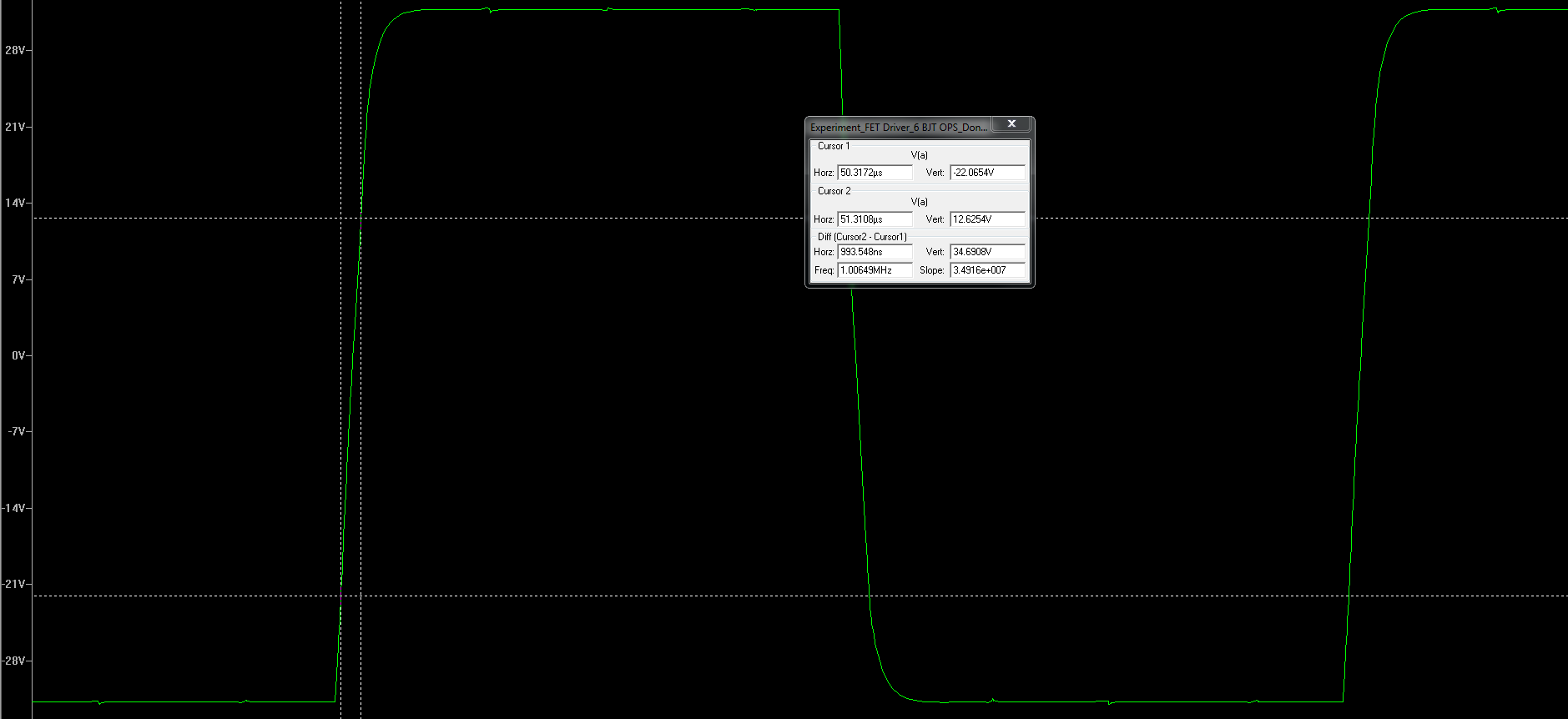

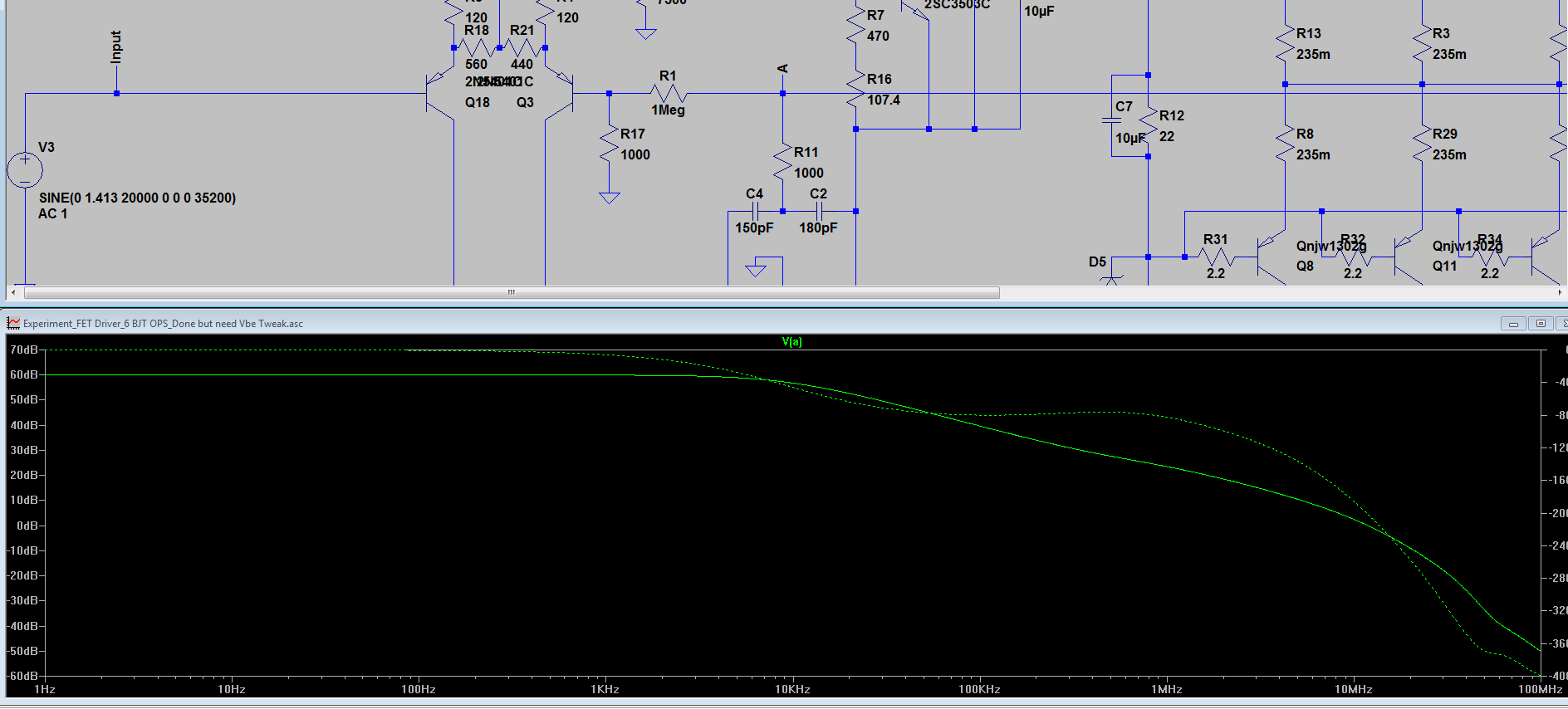

However 20 kHZ square wave test shows it oscillating a little, ringing and overshooting. So it seems that it is relatively easy to get good LG phase and gain margins but the limits to how low you can go should be determined by square wave testing.
20 kHz square wave testing into a 8 Ohm//2uF capacitor load with TMC of 150pF+180pF and a 1000 resistor shows slight rounding of the edges and no oscillations, overshoot or ringing. Slewrate is at a decent 35V/us.
However at the tops and bottoms of the square wave you can see something that breaks the straight lines a little, what is that, signs of a little instability? Mind you, it is not there without any capacative load parallel to the 8 Ohm load.
THD-1 numbes are insane, 60 Watt, 8 Ohm, 0.0000XX% and it stays there even down to 2 Ohm, that is 240 Watt 2 Ohm, 0.0000xx% THD-1. THD-20 numbers are good as well, 60 Watt, 8 Ohm, 0.000XXX% the same goes for 4 Ohm, 0.000XXX%, rising to 0.00XXXX% THD-20 at 2 Ohm, 240 Watt. I'm impressed and quite satisfied.
Possibly a result of the output inductor resonating with the load capacitor, causing large current spikes in the OPS.
