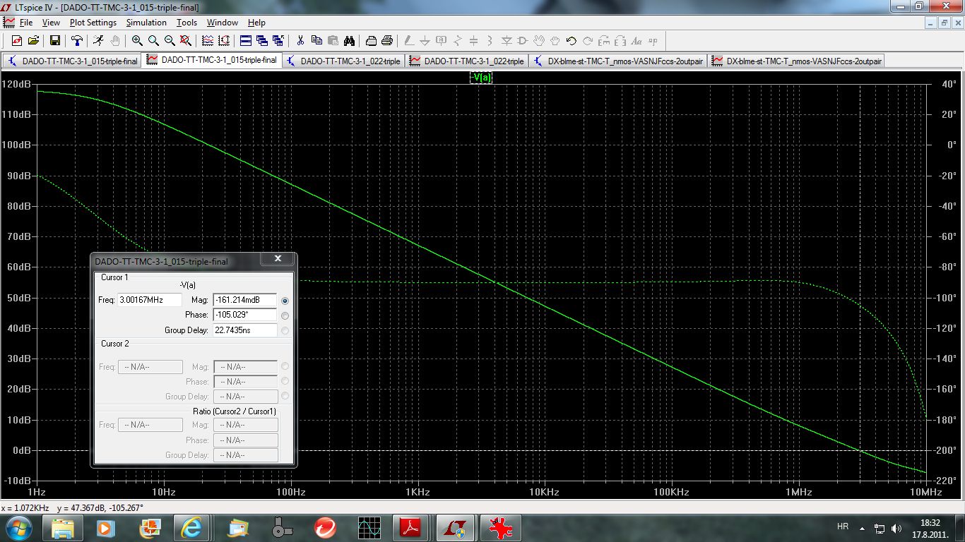

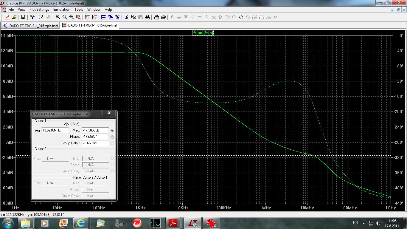

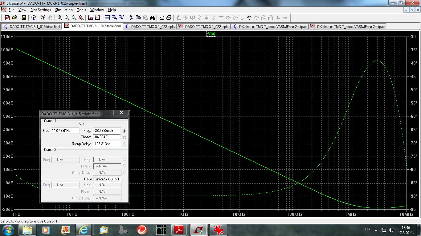

First plot below is phase margin 180-130=50degree
Second plot below is gain margin 17dB
dado
No, phase margin at 0dB you see from OLG diagram not CLG.

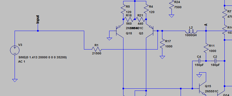

As to your question ''where should the TMC resistor be - before or after the Vi probe' my view is it should be AFTER the Vi probe. Why? because to characterize the loop gain, you need to need to excite the loop (that's what the Vi generator does) inside the feedback path. Only this way can you see what the TMC comp network, or any other comp network is doing.

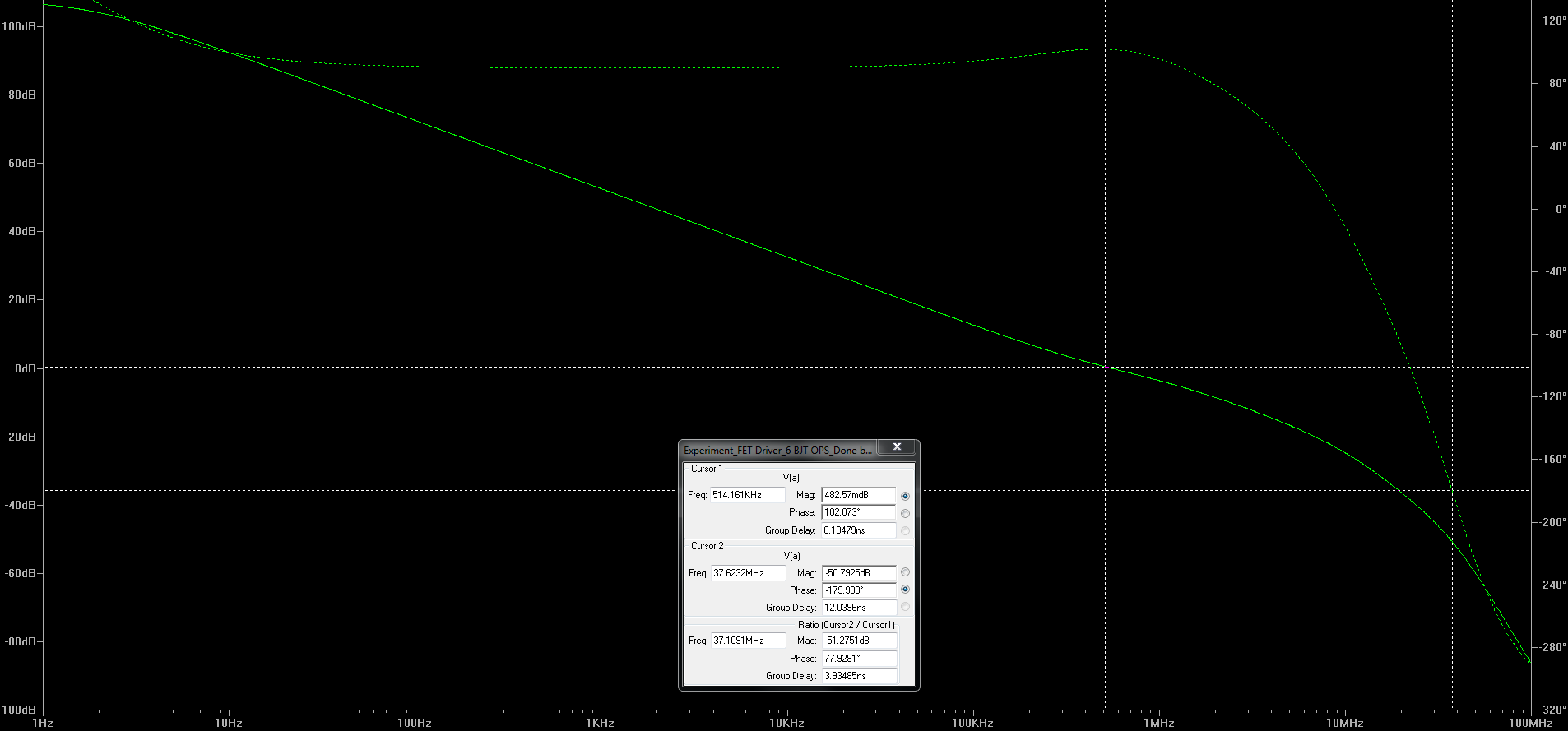

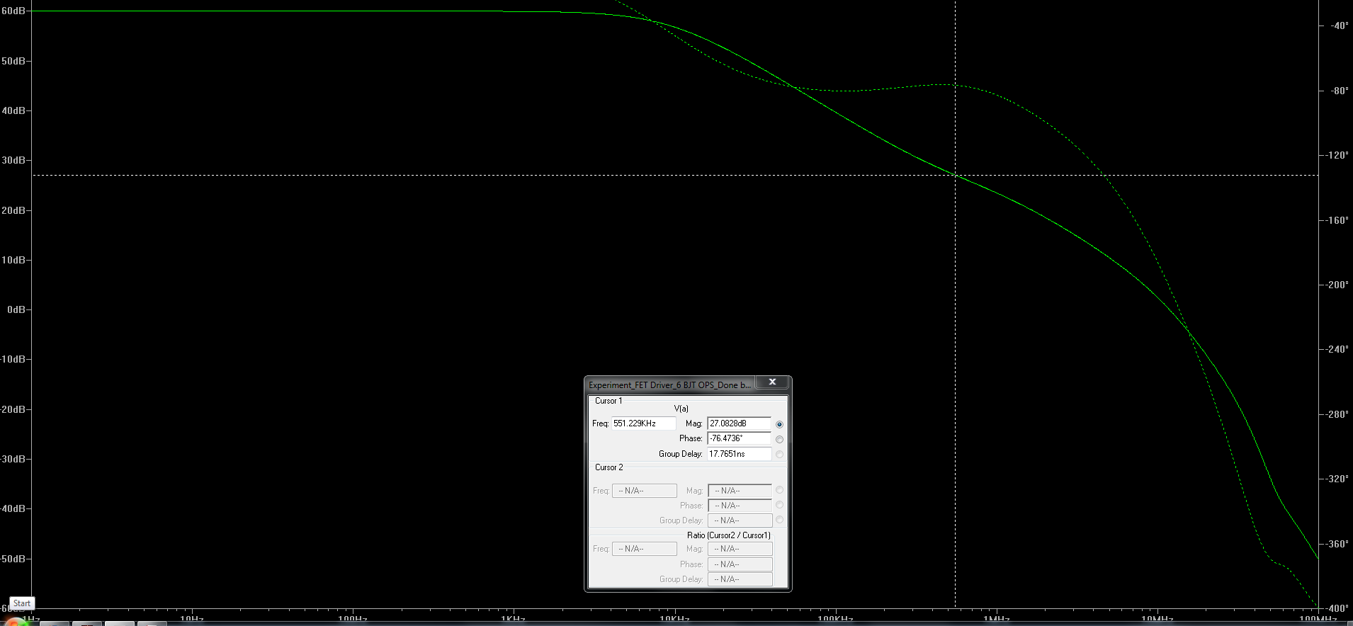

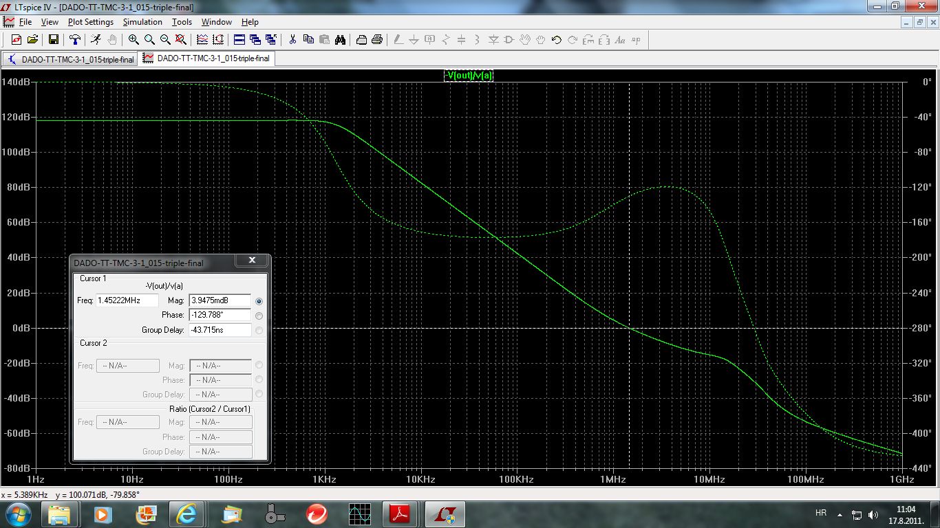

1. Loop gain plotting method as per Cordell.
2. LG from my own amplifier.
LG shows 78 degrees phase margin and a whopping 50 db gain margin.
This should be correct, yes?

Neutrality, you have plotted the open loop gain and not the loop gain. You cannot adequately gauge amplifier stability from OLG plots like this. To understand or predict amplifier stability (phase margin, gain margin, impulse response etc) you need to look at the loop gain.
OLG = break the feedback loop and plot the gain without feedback. Useful for assessing the total forward gain of the amplifier. This is what you have done above.
CLG = closed loop gain. Input to output gain with feedback applied to the amplifier
Loop Gain = the open loop gain minus the closed loop gain. Because of the gain and phase redo SE over frequency, you generally should not assume you can just subtract the CLG from the OLG. And this is particularly so if you employ advanced comp techniques like TMC or ETMC.
Neutrality, you have plotted the open loop gain and not the loop gain. You cannot adequately ***** amplifier stability from OLG plots like this.
Well, the method shown is what Cordell described in his book on how to plot Loop gain directly.
Besides, look at the method for LG plotting and the plot itself again, you reach 0 dB gain at around 500 kHz, that does not look like the plot is showing OLG and on top of that, you have only around 27.28 dB gain at 20 kHz, if this was OLG my amp would have very high THD-20. However, THD-20, 60 Watt, 8 Ohm load shows THD of 0.000674%. If the plot I posted really was OLG you would not se such low THD-20 figures.

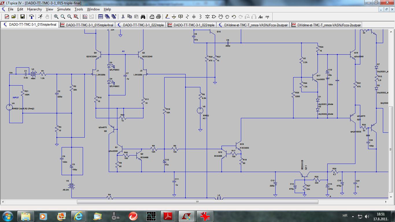

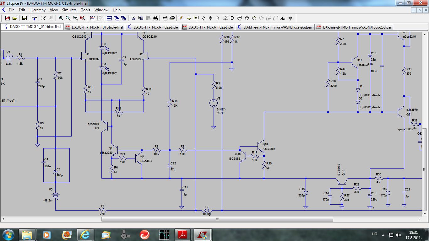

I followed instruction how to measure Loop Gain(negative feedback loop gai) from Cordell's book(page 416) and here is result.
I thing that this method is good for CMC but not TMC. I tried to move inductor to include TMC resistor in to measuring but result is strange.
dado
dado

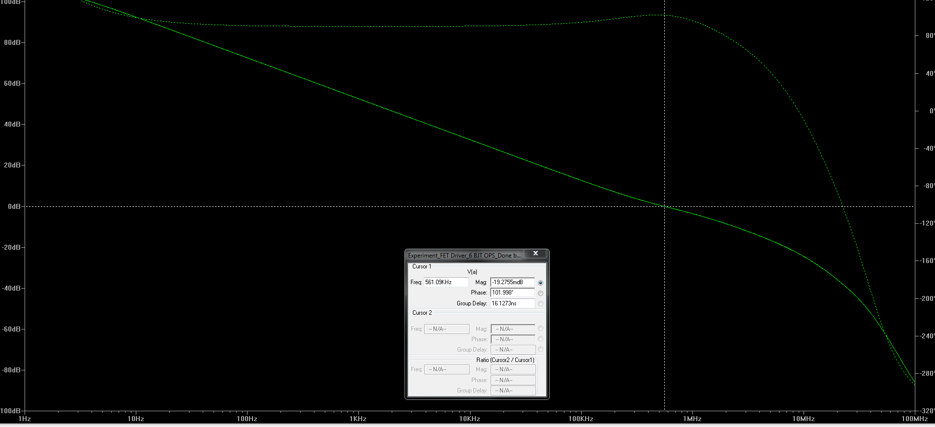

I just put the TMC resistor on the amplifier output side and not the NFB point side. Then I plottet the amp output. My LG plot seems ok that way and it matches what he wrote about the 0 dB point. When I compare his way of inferring OLG and his way of plotting LG, the gain crossover from the OLG plot and the point where the LG reaches 0 dB matches more or less exactly, both being around 500 kHz. This is how it is supposed to be.
In my view that more or less validates the 2 methods on plotting OLG and LG.
Compare these 2.
OLG and LG.
OLG gain crossover and LG 0 dB point match more or less.
The difference being around 10 kHz, due to measurements inaccuracies and the fact that the plotting methods for both OLG and LG arent 100% accurate, they are just very close approximations.
OLG and LG.
