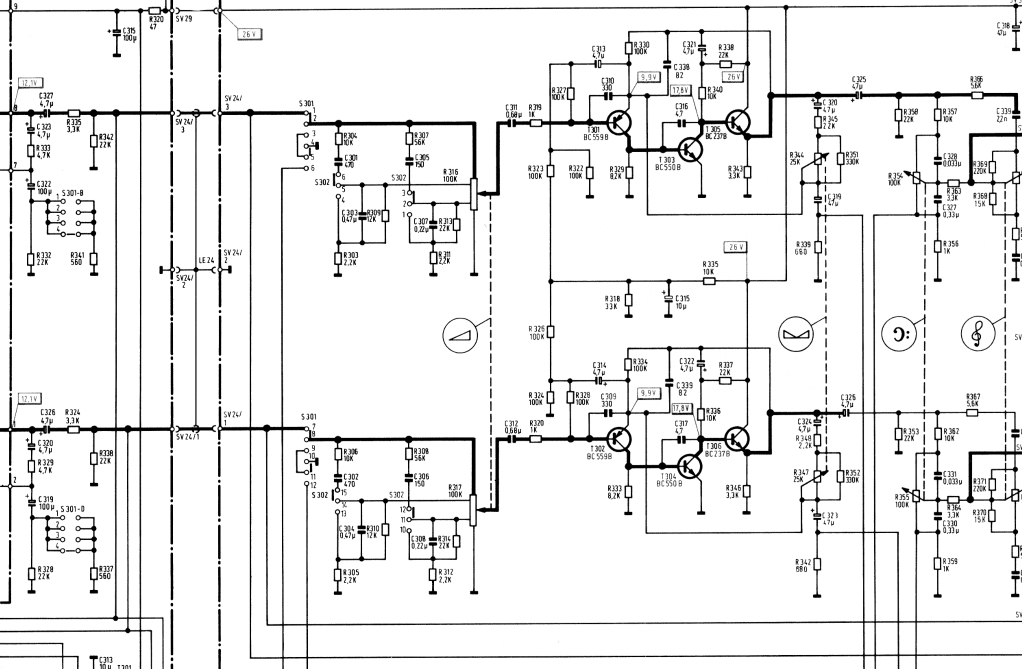

Attached is a fragment of TR-500 schematic. You can clearly see the "loudness" circuit around the volume pot, shown in "on" position.
The curve in Post #1 shows the "loudness on" FR with very high probability.

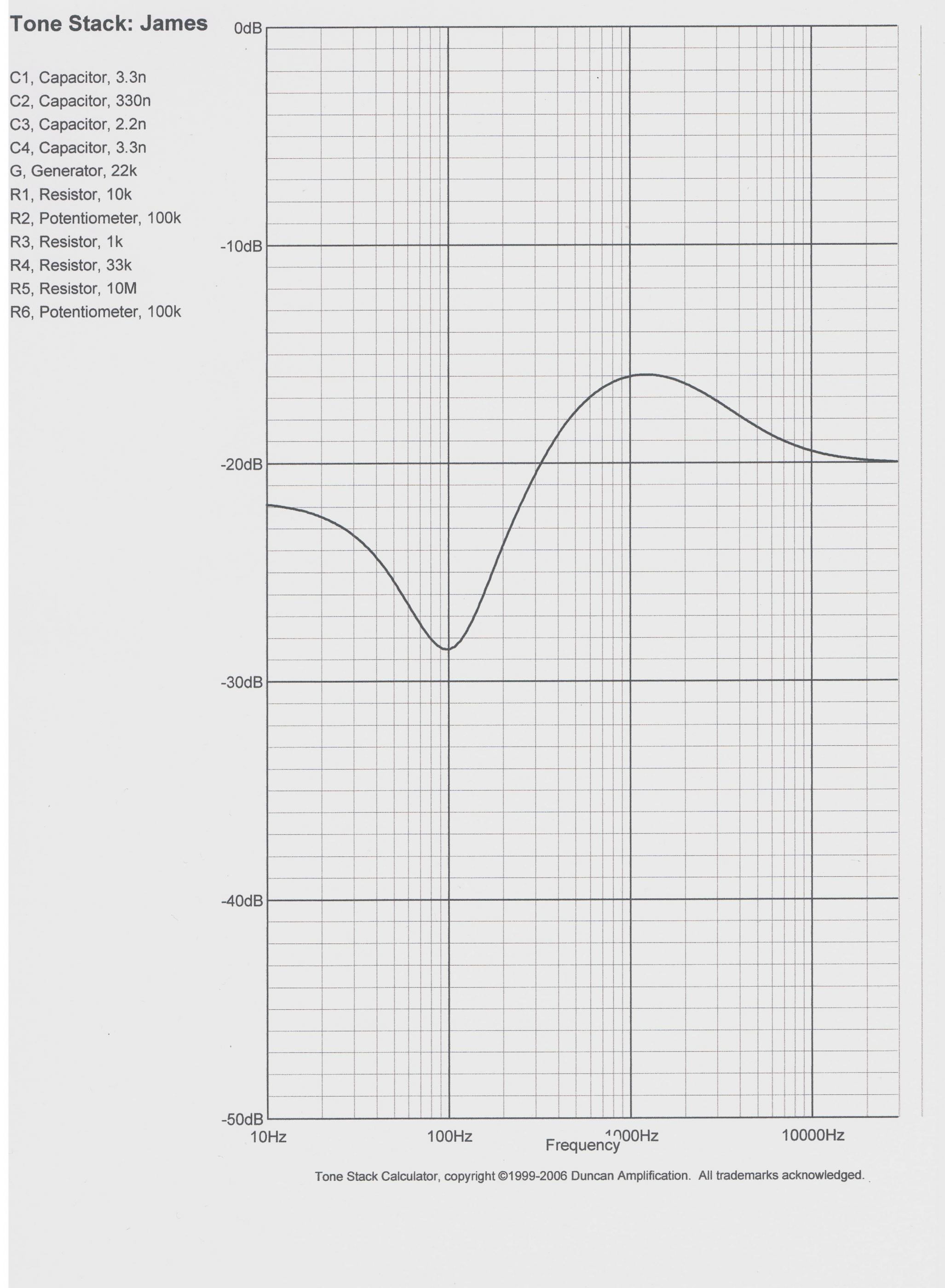

Has anyone even looked at the schematics of the Telefunken TR350? The volume pot has two taps, each with its own separate loudness circuit. The tone control circuit design seem to have a lot to be desired - if a flat response is the goal. A simplified simulation gives a -9/+4 dB response at 100 and 1kHz respectively in pot mid-point setting.

Well, please see the attached sim of the tone control.

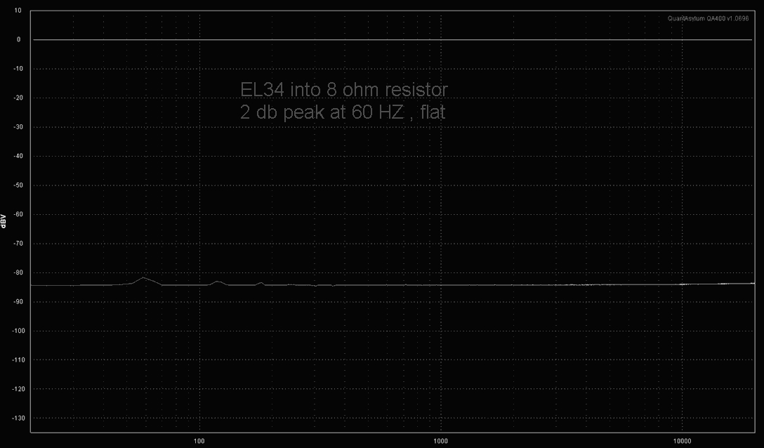

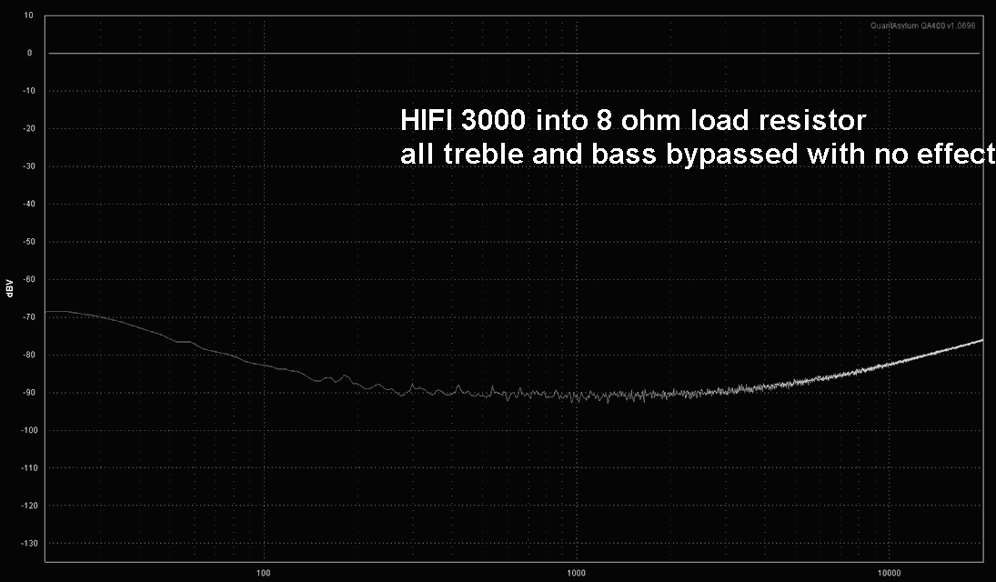

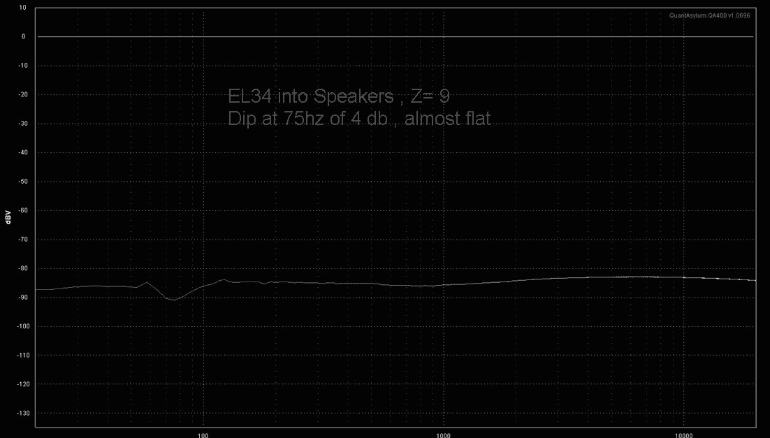

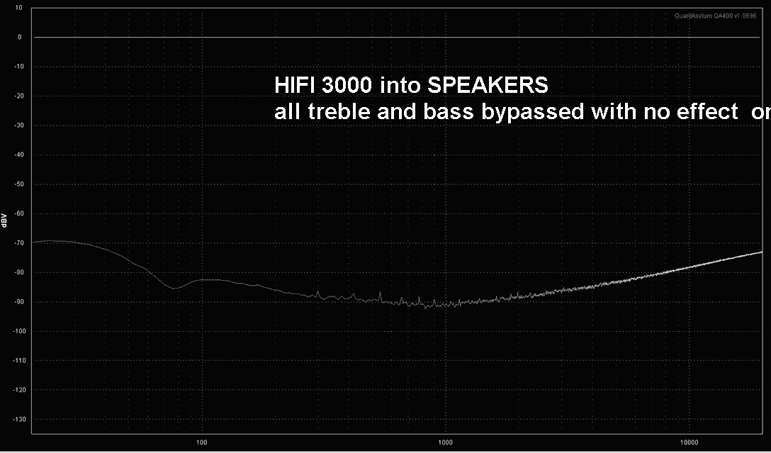

See attachment, tests were done with a 6 DB feedback 5K loading EL34 , surprisingly good for such low feedback, the HIFI3000 got a lot worse off with the tone controls bypassed with no effect at their relative position.

First of all, disabling the tone control made the amp response curve a lot WORSE.
I can't see the feedback in the schematic and it is a capacitor output, very bad for a power amp.
The output have some network of resistors and filters to stop the amp from oscillating, which obviously don't work, since removing a transistor sensing input cap made the amp permanently catch some radio signal, I can fix it but it doesn't had an effect on the sound.

Did you bypass the volume pot?
HR 3000 has got the "loudness" compensation "always on" and your frequency response curves look very much like "corrected" by "loudness" network.

Anyway I think we put the finger on the problems:
1. Permanent loudness filter at the volume pot
2. Treble and Bass filters
SO to answer my claim : yes this company cheated the sound on the whole range of their amplifiers.
