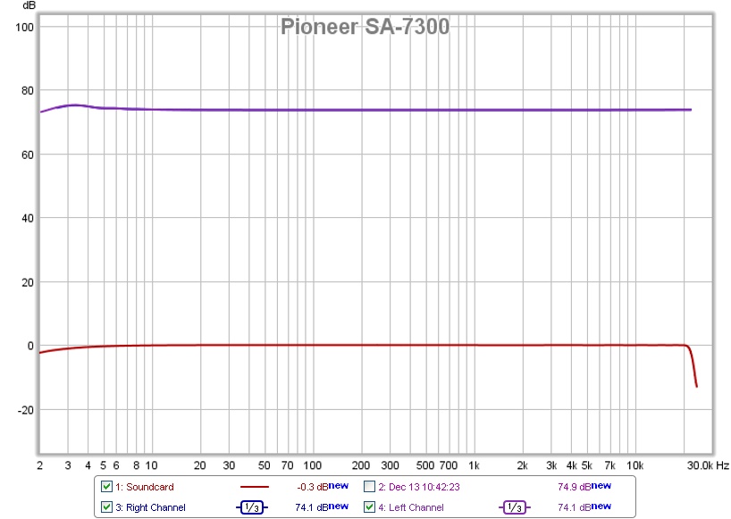

It is true, it is true!!!!!
They are all at it!
See the attached FR of another reputable 1980 hi-fi amplifier. Note the dastardly cunning raise of the bass response under 3Hz - and imagine how bad things could have been if they hadn't conspired with the soundcard maker (30 years later) to cover it up by sneaking in a low frequency roll-off of the card response. Shocking!
Now I know why this amp always tickled my toes - yes, I was quite simply tricked into buying it.
Hang them all out to dry, I say!

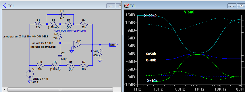

"" due to potentiometer imperfection "" maybe, but I doubt this is an honest mistake
I have mentioned about difficulty in TC design (Remember Baxandall and you know the issue). So I will show you a common TC circuit for bass boost.
Most log pot is not logarithmic and most linear pot is not linear. If you put most pot's wiper in the center, the resistance is not 50% but less. Let's simulate this with LTspice. Assume the pot is 100k and in the center position the resistance distribution is 49k and 51k...
As you can see there is still bass boost.

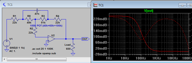

Wait... I'm not sure which end is the minimum...
I Need Sleep
