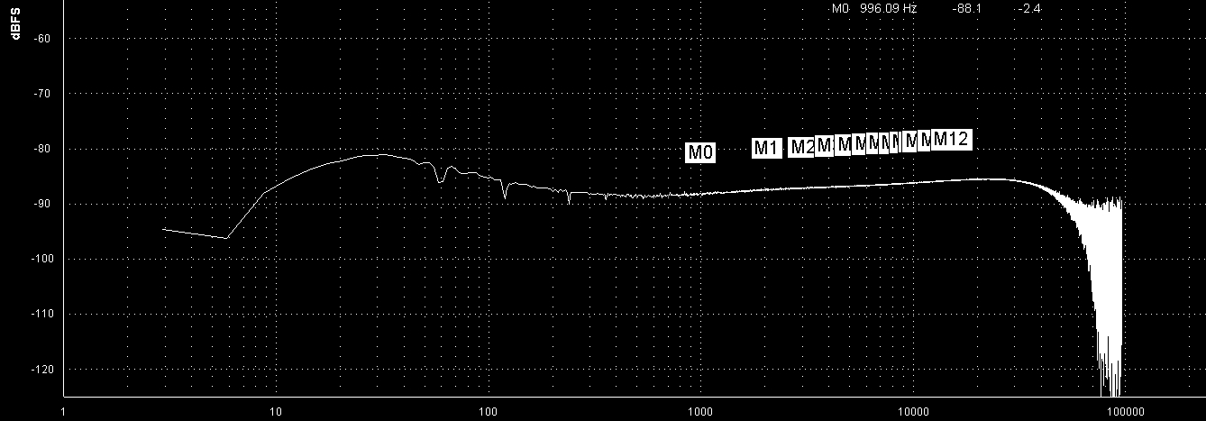

See attachment (measurement starts at 20hz and ends at 20khz), a reputable 70 Watts hifi amplifier with tone controls to center shows this kind of response with clear boost of bass and high frequency.
This is common practice in the audio industry.
This explains your big bass and high treble from your beloved SS amp. It is common in CD players, DAC, phono, you name it

I measured a lot of reputable audio gear back in the day for my employer and I never saw anything like this unless loudness compensation was enabled.I don't know what they do these days, but even with undefeatable tone controls it was usually possible to find the flatest response somewhere near the center of the range. (not always)
Instead of making such a generic allegation all commercial electronics how about some specifics? Also a loop back measurement showing that the measurement system is flat would be a welcome.
Edit: Measurement levels seem to be very low, normally somewhere between -6dBFS and -20dBFS is where I tried to do these sorts of measurements. I question this.
Probably just undefeatable loudness compensation. Turn up the volume pot and see if it flattens. The loudness may not necessarily be undefeatable - but on modern gear be buried so deep in menus that you give up before you find it. My last car stereo head was that way. Don't even try to find it with the engine running. Even at a light.

It is flat, I have other measurements done with it. The sample was at around 10 watts and I use voltage dividers to protect the measuring equipment, this is not a scope, it is a highly precise distortion meter, 192khz 24 bit.
I am not stupid, the volume had no effect on the tests, it is where the amp stands with controls set to 0, it is never flat. I don't mention any company names, but big names are out there. Start testing and you will believe. Use speakers, some tone controls are activated only by a speaker load and not a resistor.
If it really measures flat into a resistor but "smiley faced" with a loudspeaker I'd like to see how they pulled that off in a modern amp. Only way I could see without using some sort of digital trickery would be a single-ended pentode/ NPN/ Mosfet with only cathode/source feedback. Voltage gain would follow the speaker's impedance curve. Bass would be a spike and highs would rise gradually. Old console stereos with large open-back fullranges used to do that, and many sounded better than they had a right to.
It's not totally outside the realm of possibility to use non defeatable EQ as "standard". I've built amps that way back in the day. It saved the expense of pots that would have been turned up all the way anyway.
A lot of people around here have measured a lot of stuff over the years. No one is calling you stupid, but it would help if you could provide a bit more information to substantiate your claims. For example, I might be wrong about this (someone please speak up if I am), but I don't think it would be a violation of any rules here if you were to name the make & model that produced the response you've posted above, and perhaps some others where you've observed this kind of thing.

I hate being in the hot spot like you place me there. I will not mention company names. This post was to illustrate how the flat frequency response is cheated by designers of amps when it comes to drive real speakers.
I doubt NAIM for example would do such a thing or NAD. But you will get surprised to actually test your amp connected in your speakers, this is not the speakers that I measured but the reaction of the output stage to a speaker. If the bass is too good and the high has so much details you are almost sure the amp is not flat as it claims or should be honestly.
The bottom point: it is a simple trick to do to fool customers into buying vs a neutral frequency amp
dB scale suggests this is measured at a very low level, and the curve indicates a normal loudness function is active.
Johan-Kr
huh no, it was made to around 15 watts, and for that particular example it had the same response into a 8 ohm resistor
what do you mean a normal loudness function??? it is dbv and it is a sweep test, the test starts at 20hz and ends at 20khz.
