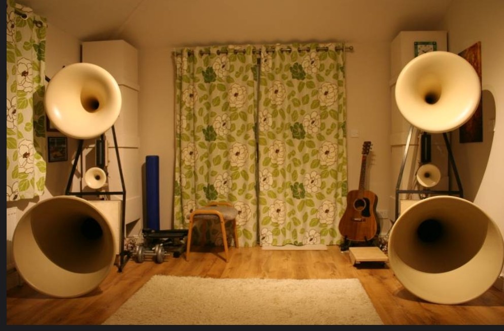

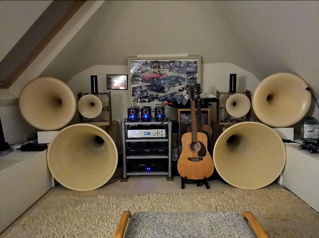

Pic of system incarnations, measure / listen to.

WoW!....That was a horn-build 😀
Have a calibrated mic, and makes the measurements in the actual room.

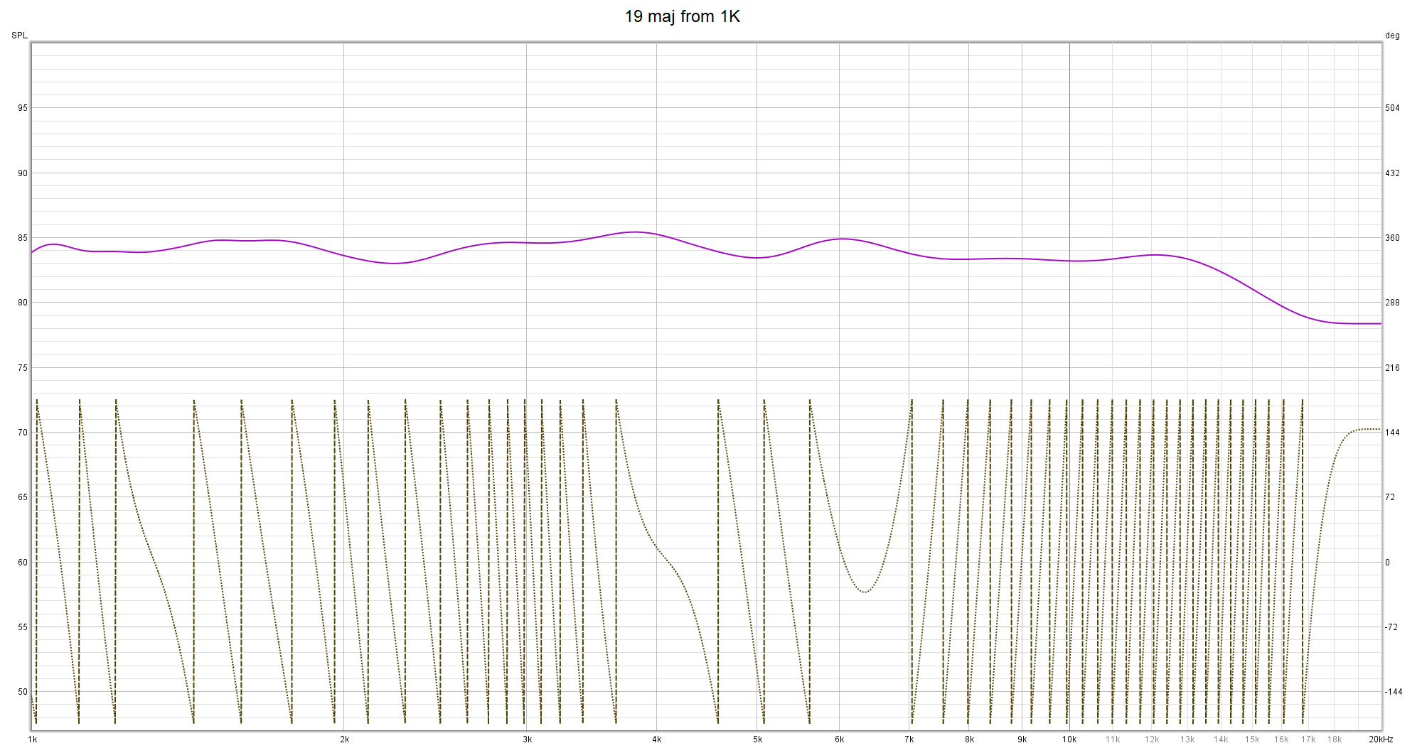

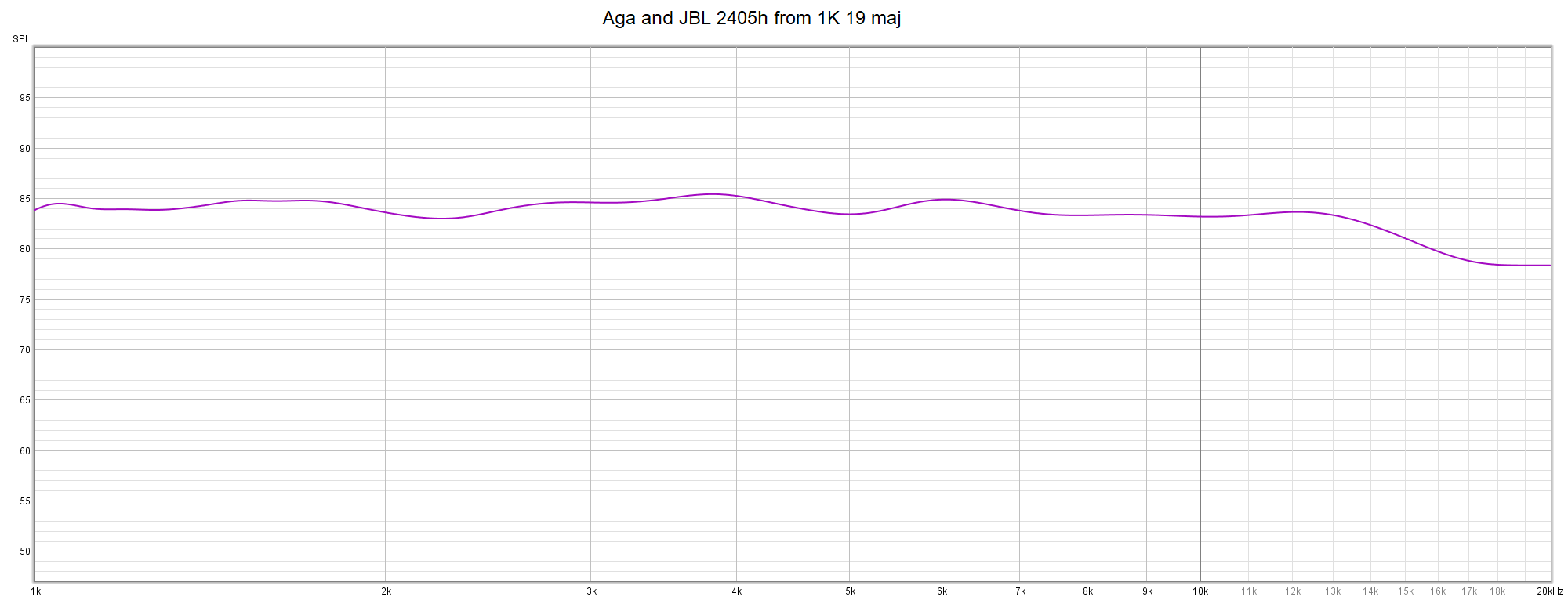

This is the Aga and jbl 2405h from 1K.
And seems as i could make with splcurve i want with these drivers!.
