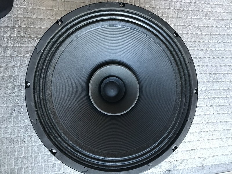

Luckily for my one way fullrange driver projects I can measure in the near field of 20cm to get everything right.
For a big project with paper cone which goes loud I would choose a Fane Sovereign 15-300tc
https://www.diyaudio.com/community/...w-distortion-with-a-2-way.334757/post-6711040
Please don't judge me a heretic posting this.
I know that in a listening test a classical four way would have no chance in competing with this 38cm fullrange driver. With both boxes eq 'Ed with iir dsp to flat response. Because of phasing issues in the 4 way.
Just give this driver a try but you would have to buy it used.

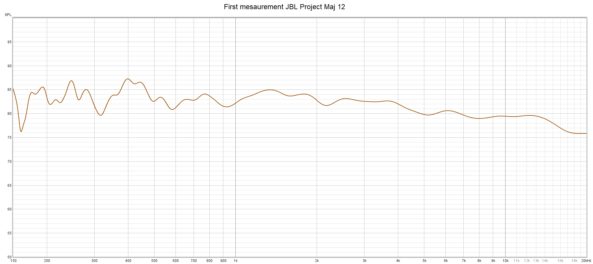

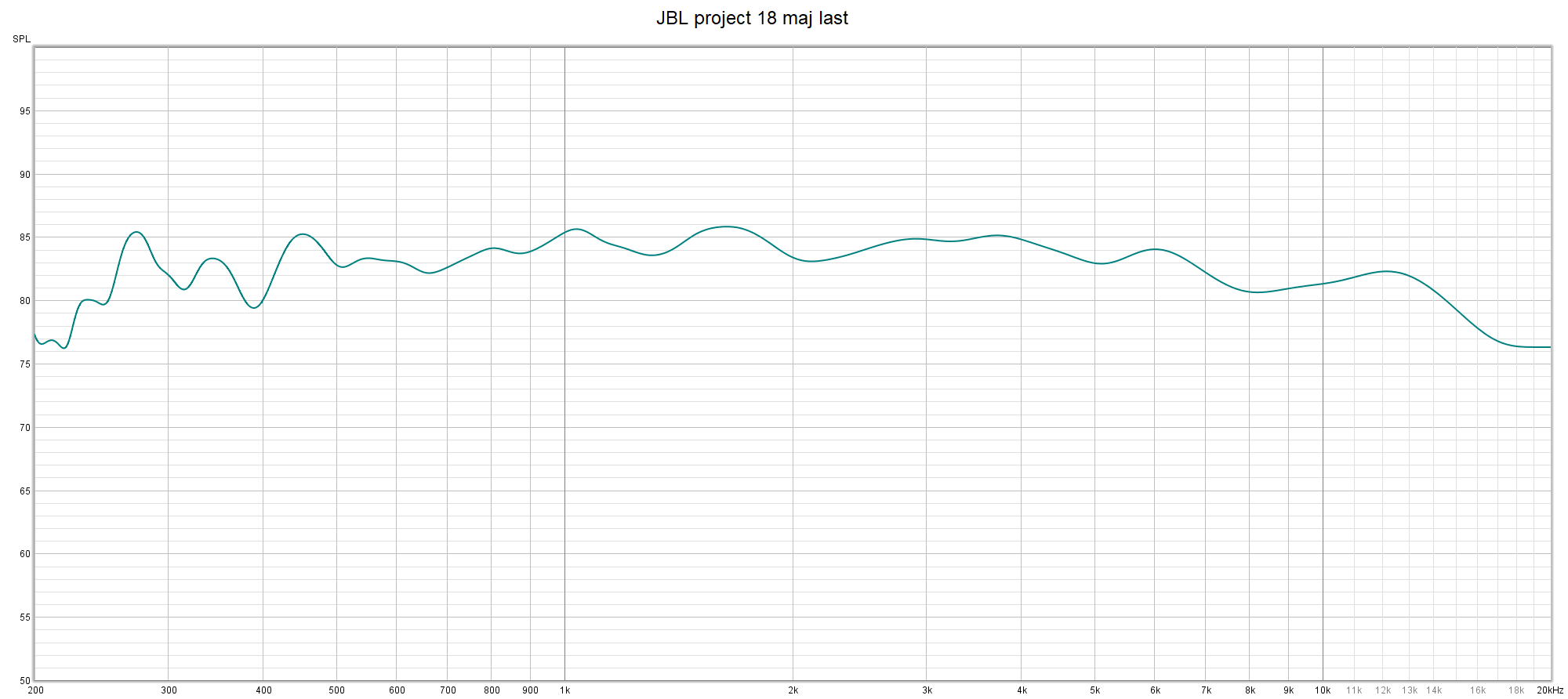

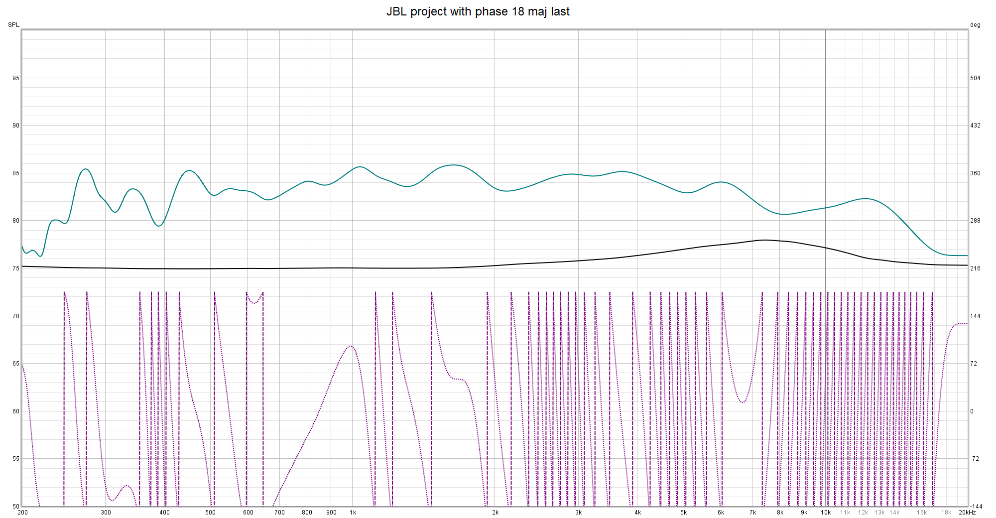

So now have i spend a few days on finetuning the speakers, i managed to improve the JBL E145 curve and also a little "over all"
The 16 ohm JBL 2405h give me the most "problem"...My plan was to use it from around 7K, but it was "impossible" to integrate real good at that point with the Aga driver.
So eventually i ended up at around 9,5 K 18 dB filter, and have notice the Aga driver will run "all way" if i want.
And 20 ohm Aga driver work from ca 750 to 9,5K with a 12 dB filter
The 8 ohm JBL E-145 ended up at about 150 to 750-800 hz 12 dB filter
And the 8 ohm JBL 2235h from bottom up to 150 hz, with 12 dB filter.
The curve from before and new "new" finetunded curve.
Measured from 2,6 meter, mic at 84 cm high on axis
Best regards John

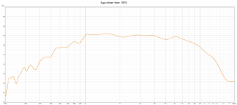

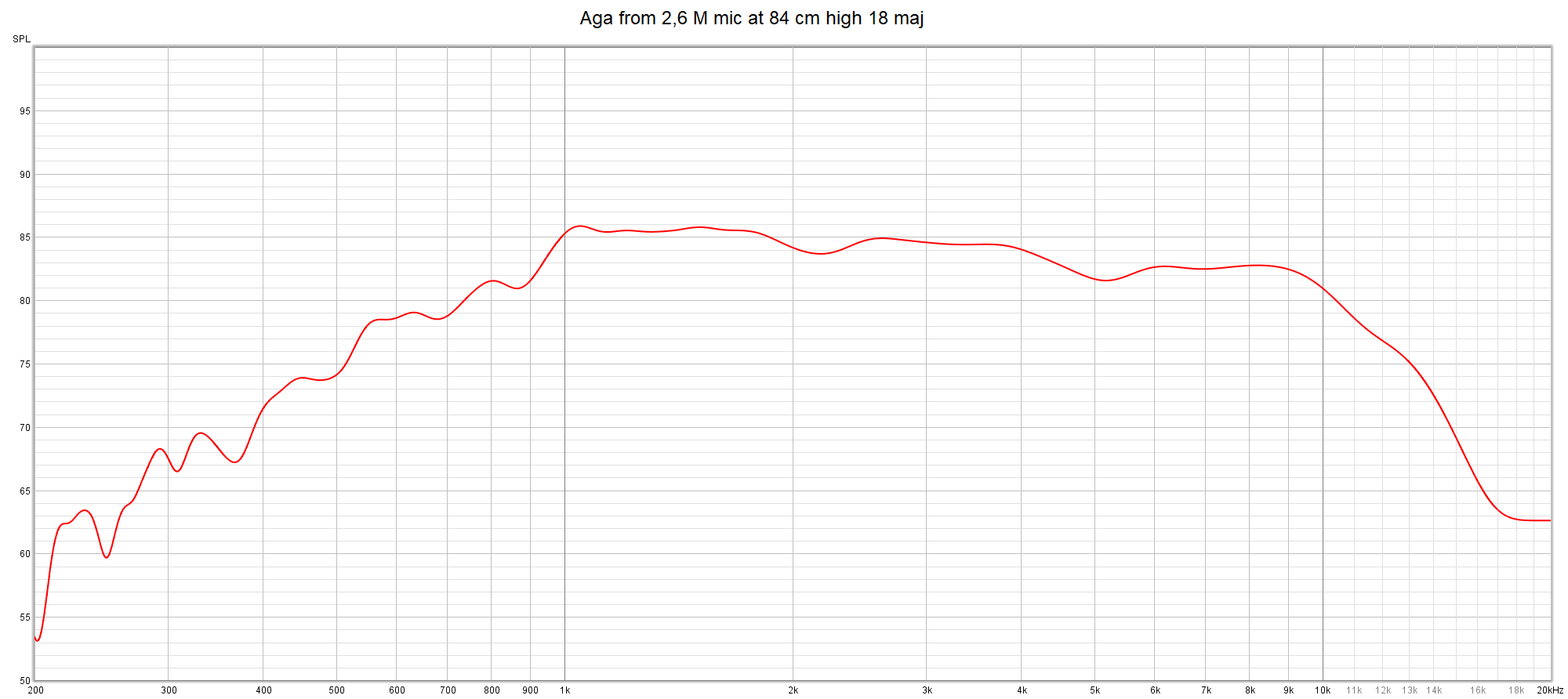

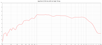

The old Aga driver from around 1975 impress me mutch, it can be used from 5-600 hz and up if you want!.
This is from 2,6 meters mic at 84 cm...with 2 of my 12 dB filter.
Edit, dont know witch "curve/filter" i use, so put both pics in!
Reagrds John

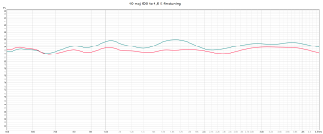

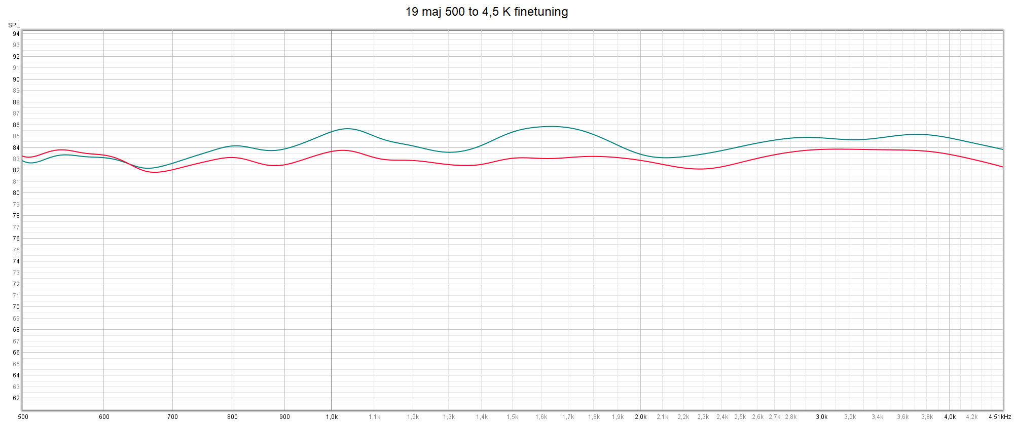

Now i have finetuned the overlap/crossingpoint between Jbl E145 and Aga driver at 7-800 hz.
Blue yesterdays filter and Red todays finetuned filter.
Allen you who are very knowledgeable,.have you any advice to give me about chooseing crossingpoints ?
For ex in my case between the 15 inch jbl e145 and the old Aga cd.
Regards John

We do not have polar responses for the buttcheeks horn. I am not sure of anything, and not sure there is a best place to cross them to this 15". I am guessing the place you have chosen (7-800Hz) is OK, because the horn will go wide by then and might meet the 15". It may also be closer to axisymmetrical by then.
However, this doesn't give you the chance to offload the horn before it goes wide. That would require a choice of horn and woofer that come together at an angle, say 90 degrees. This would mean a higher cross for the 15", like 900-1200... It may even mean a larger horn or a smaller woofer.
Thanks for the information Allen 👍
Maby i try out to cross the E-145 a little higher.....like 950 hz or around.

If you have overlapping ranges, XOs could be optimised in order to:
  • minimise THD (measure!)
  • using less step filters (less, better components)
  • matching directivity (measure) - smooth / equal directivity through the speaker is a good thing.
Reactions: jawen

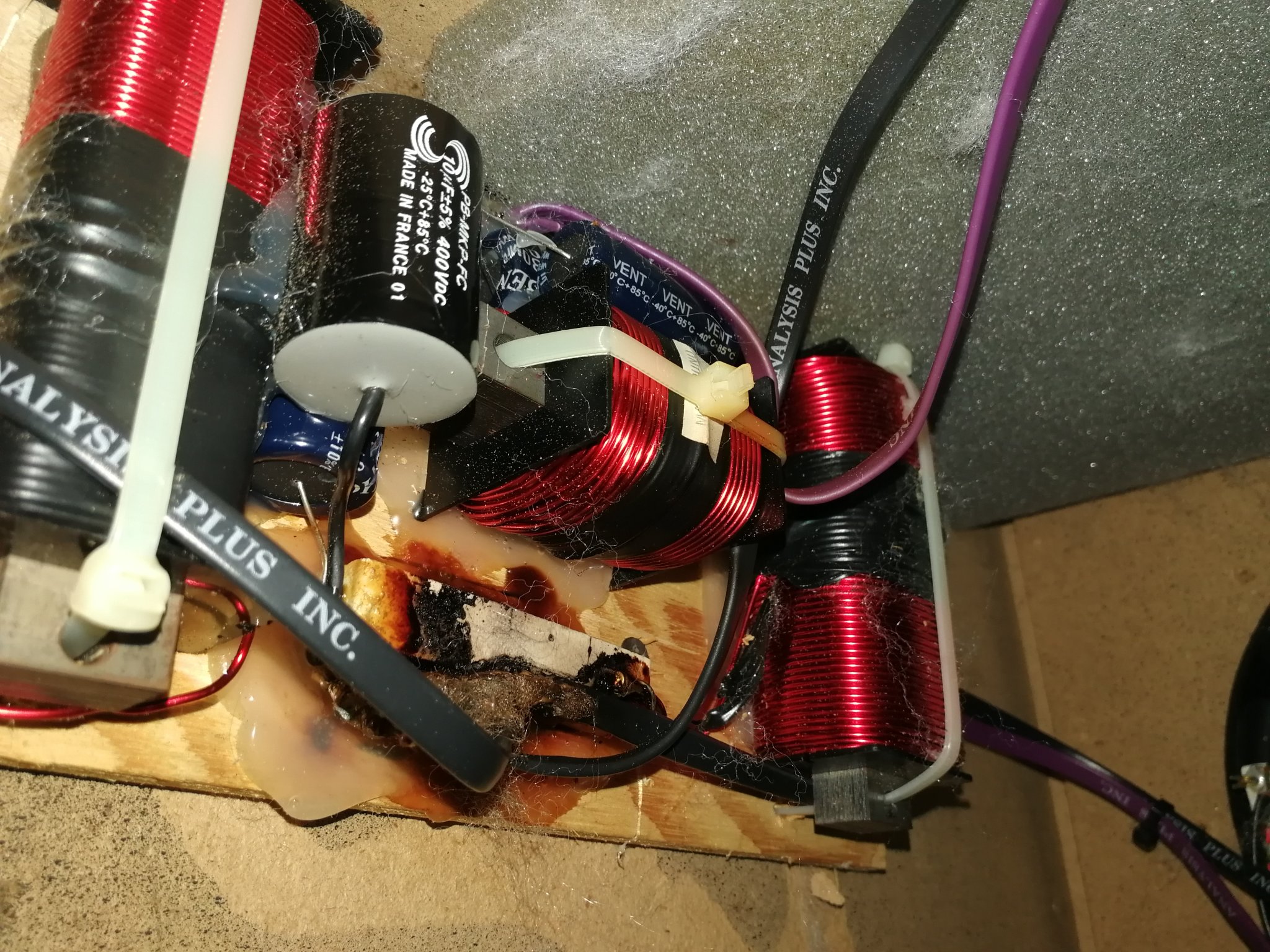

Not really - the only thing I would not do is using coils with iron.
Measure the drivers distortion and see which one is better in the overlapping region - if everything else is equal...
Abrupt change in how wide/narrow the speaker disperse at XO (or elsewhere) is a thing that reveals a speaker... not wanted.
Can you explain why ?
My "hero" Albert Von Schweikert was probably the world's best xover designer, and he did crossover systems for Polk, Klipsch, JBL, ESS Heil, Infinity, Apogee, Cerwin Vega, Jensen, NHT and many others.
He developed the first three-way Heil Air Motion Transformer speaker with linear phase crossovers.
Product of the Year Award,” for his Lucas Film THX design, and was contracted by companies such as Lucas Film THX, Walt Disney, Steinway, A&M Records, Sheffield Sound Labs, Mobile Fidelity, and JVC and others.
Do you mean he was wrong?
He always use coils with iron up to 200 hz, and the photo shows when i fix a broken xover 15 years ago.
The speaker was the awardwinning Von Schweikert VR-4 upgraded to VR5-7
Regards John
He was not wrong - I assume he was under some sort of budget so he made a vise compromise with the inductors. The problem is the worst kind of distortion - hysteresis. Usually "we" dont need to do that compromise if we can stay out of very low frequency XOs.
