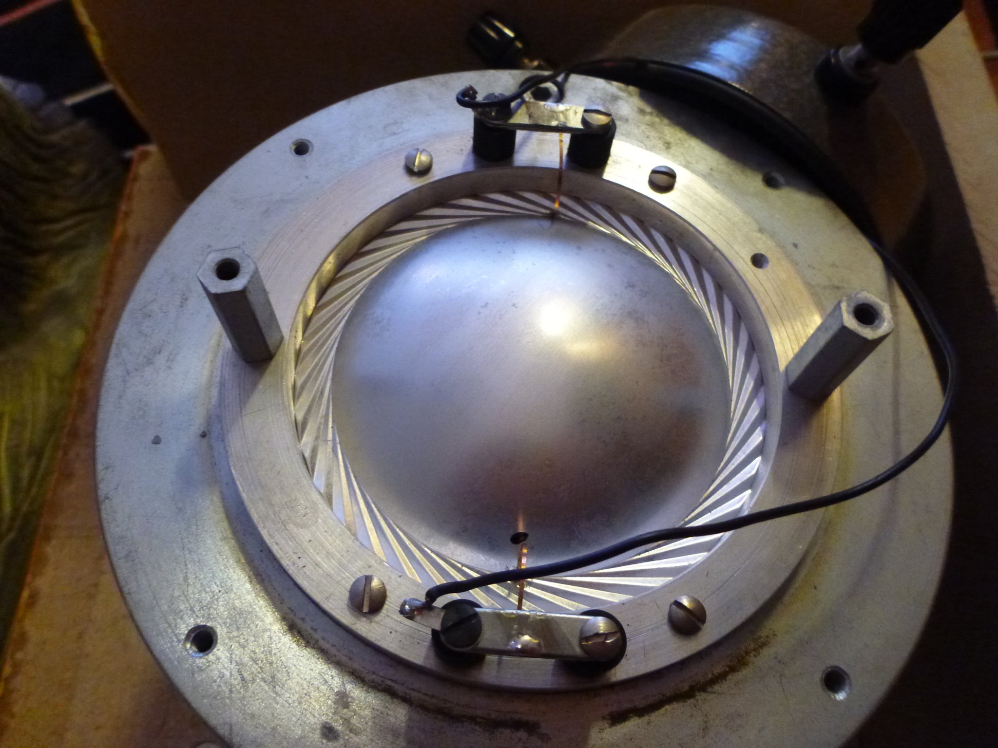

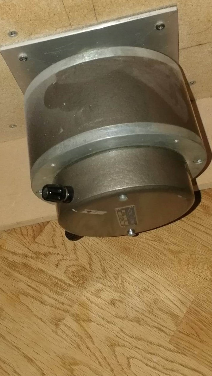

An 20 ohm old Swedish cd from AGA made around 1975 ( with some license from Altec Lansing, and i think its like the 299 series)
Weight 10 kilo and 34 kilo with the JBL clone of 2344a (baby check) massive horn.
Use it from ca 800 hz up to 7000 hz.
! I have no data specs from this driver !
And a 16 ohm JBL 2405h at the topp from 7000 hz.

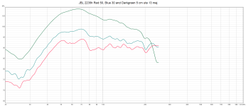

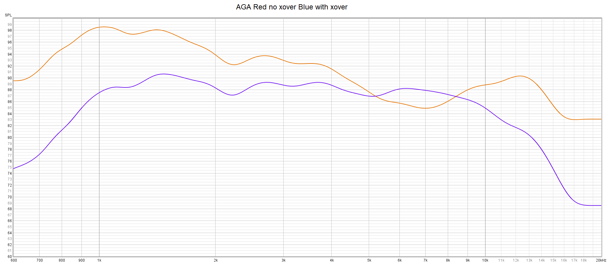

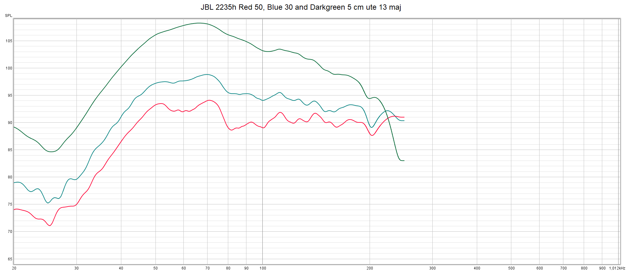

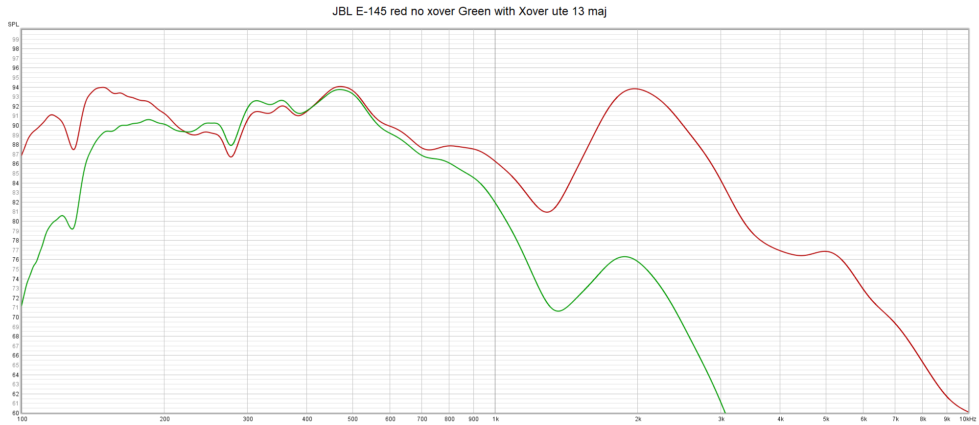

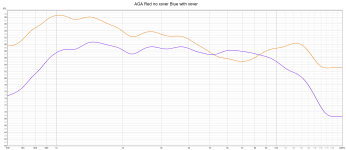

I'd say still... also measure each driver from close distance and observe their individual contribution and post them here. Disconnect other drivers while doing one of them if possible.
Here is all invidual measurements from 1 meter both without and with my diy xover.
Best regards John

Measuring outside will potentially allow you to see certain things in the measurements, but note that unless you are measuring in a semi-anechoic environment (like a highly elevated above ground or perhaps ground plane measurements on flat, featureless terrain), you will be measuring early reflections, too. Typically the excess group delay and spectrogram plots are not paid proper attention to (time or arrivals, etc.), so features in the measurements are mistakenly interpreted.
The real issue with taking measurements outside and perhaps farther away than 2 m is that the measurements no longer inform about the loudspeakers in-room where boundary gain and unavoidable early reflections (like those off the loudspeaker enclosure itself) interact with the direct arrivals from the loudspeaker's drivers, and interference band interactions (i.e., lobing) turn into early reflections in typically sized listening rooms.

Hi Jawen,
If you didn't have all the impedance traces it must have took many hours of trial and error. Brilliant effort on your part.
The overall trace you posted looks good, and as you say starting to sound sweet. So good luck with the final voicing.

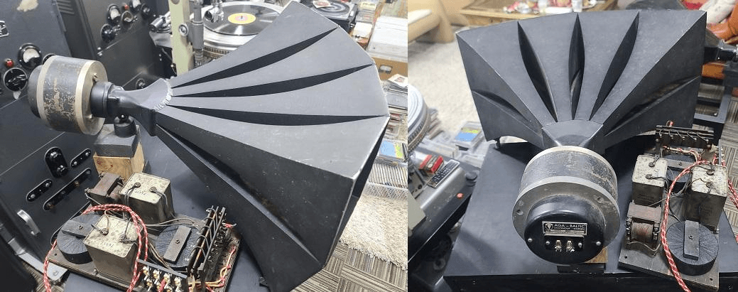

My compression driver is from an old Swedich company called AGA/Baltic, and they where very likely the biggest electronics company in the world & produced almost everything.
And they sold out part of the company to Philips around 1977, and some parts become superbig swedish Ericsson 1983.
But they had 70% of all Swedish cinemas soundsystems the during the 60s & 70s, so they where big.
And the 70s was the absolut best regarding to production and quality.
But just found a museum and a few pictures and treads on old simular drivers, and of course ads from Asia.
https://www.filmsoundsweden.se/backspegel/aga_hogt.html
https://www.hostboard.com/forums/f700/280808-h805-adapter/index2.html
https://www.aga-museum.nl/aga-techniek/
regards John
Are all other drivers disconnected while measuring an individual?
On woofer and tweeter mesaurement ( up to 150 hz and over 7000 hz) i forgot to disconnect, because REW suddenly shut down by itself and I lost all previous readings, so I had to redo everything.
But on lowmid and midrange (from 150-7000 hz) all other drivers was disconnected.

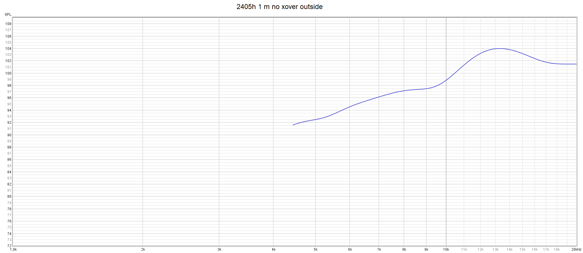

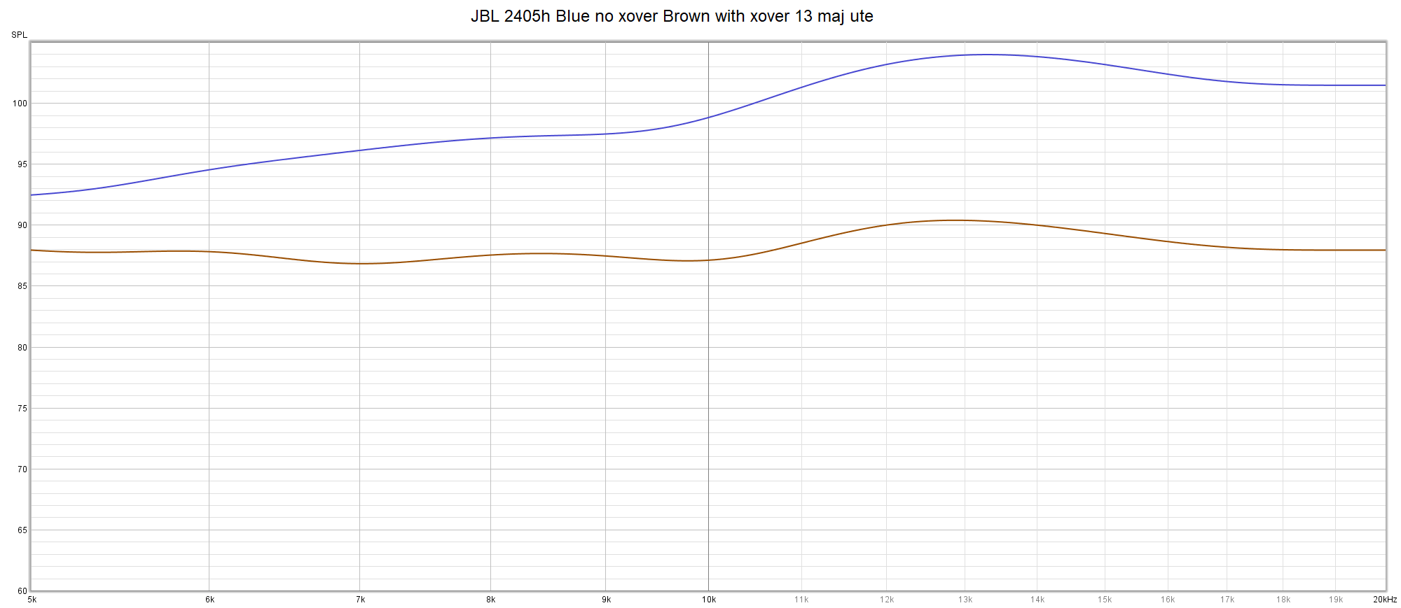

And i find a mesaurement for the tweeter alone also, here it is.
So now all mesaurements except 2235h up to 150 hz is with all other drivers disconnected.
Regards John

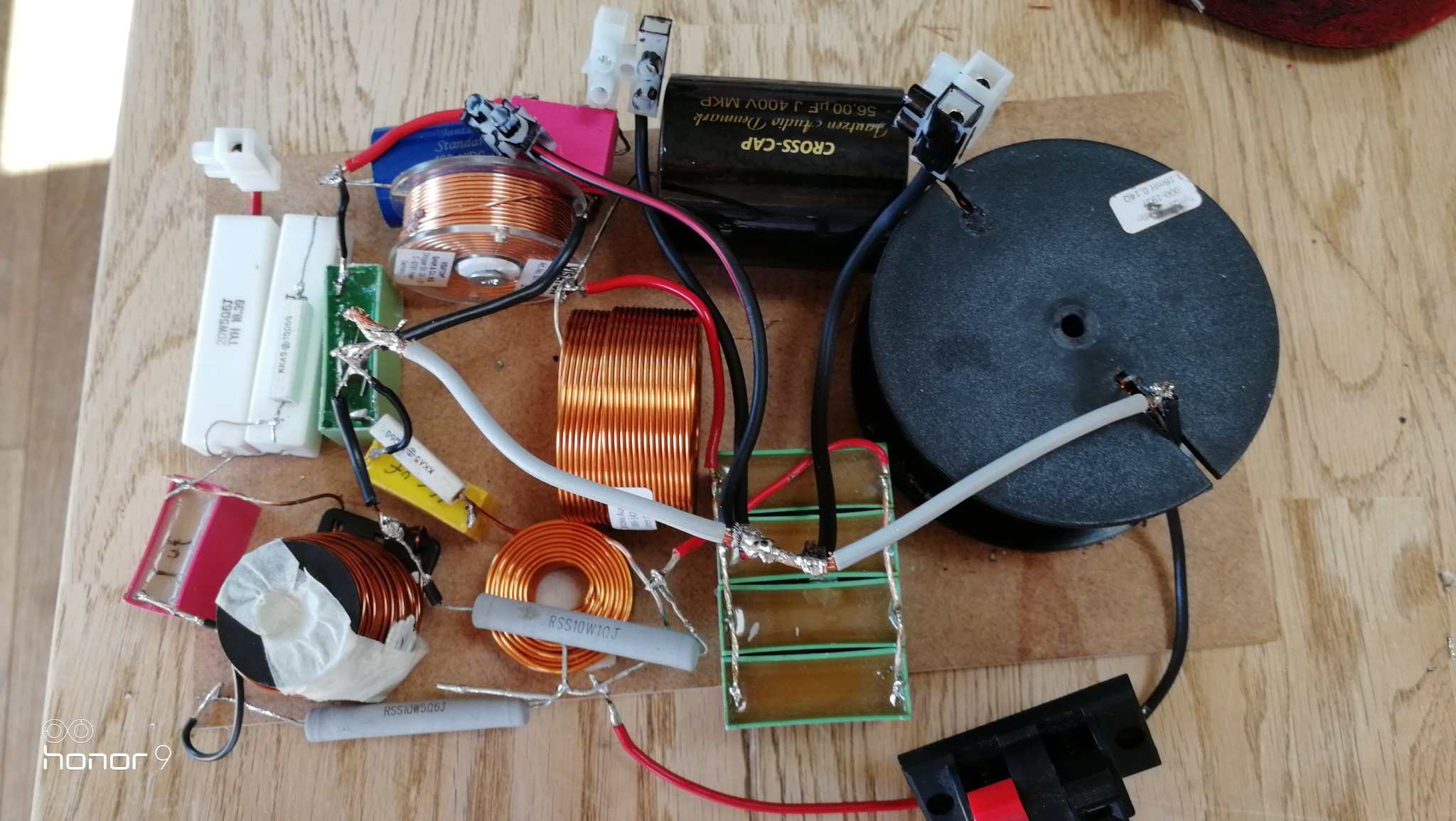

This is the filter without a 10mH coil and 330 uF for the JBL 2235h woofer.
Regards John

most things i have from before and the coils for example i wind and re-wind, and also use small pieces of iron to change the values....and mostly cheap caps.
Good choices and use of resources.
