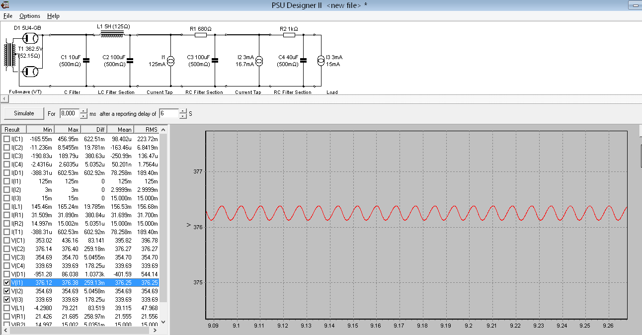

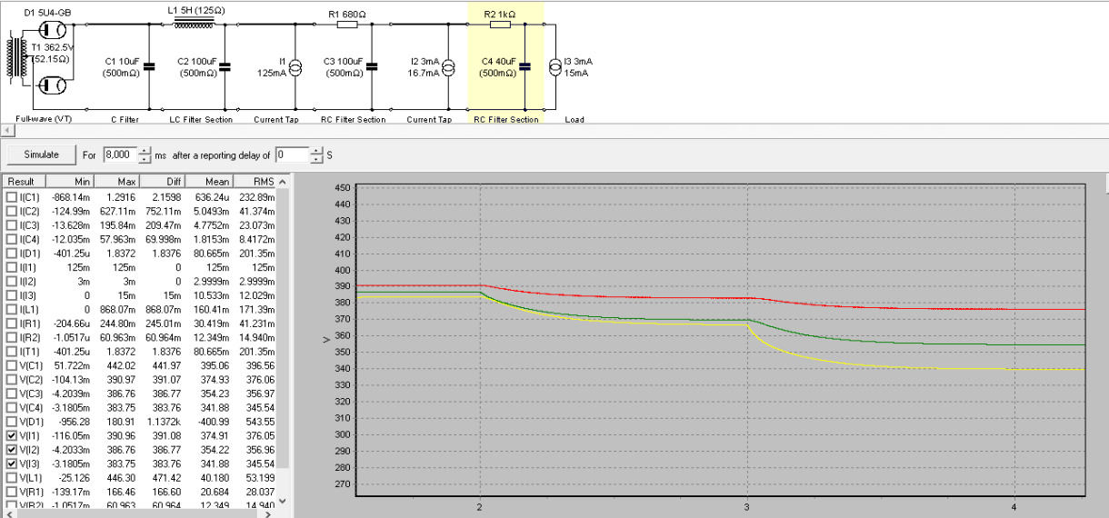

Power supply mods. Please examine the attached screenshots.
I modeled the psu with a 5H choke. If you decrease the value to 2H, it still works, but ripple goes up. Still not bad, with ripple to the output stage at 700mV (millivolts) and to the input stage 450uV (microvolts).
If you increase the choke to 10H, things look really good. Output stage ripple 127mV, input stage ripple 90uV.
It's obvious that the better the choke, the better the psu will perform. 7H 150mA would be good. The Hammond 159Q meets those specs and has a DCR of 100R.
