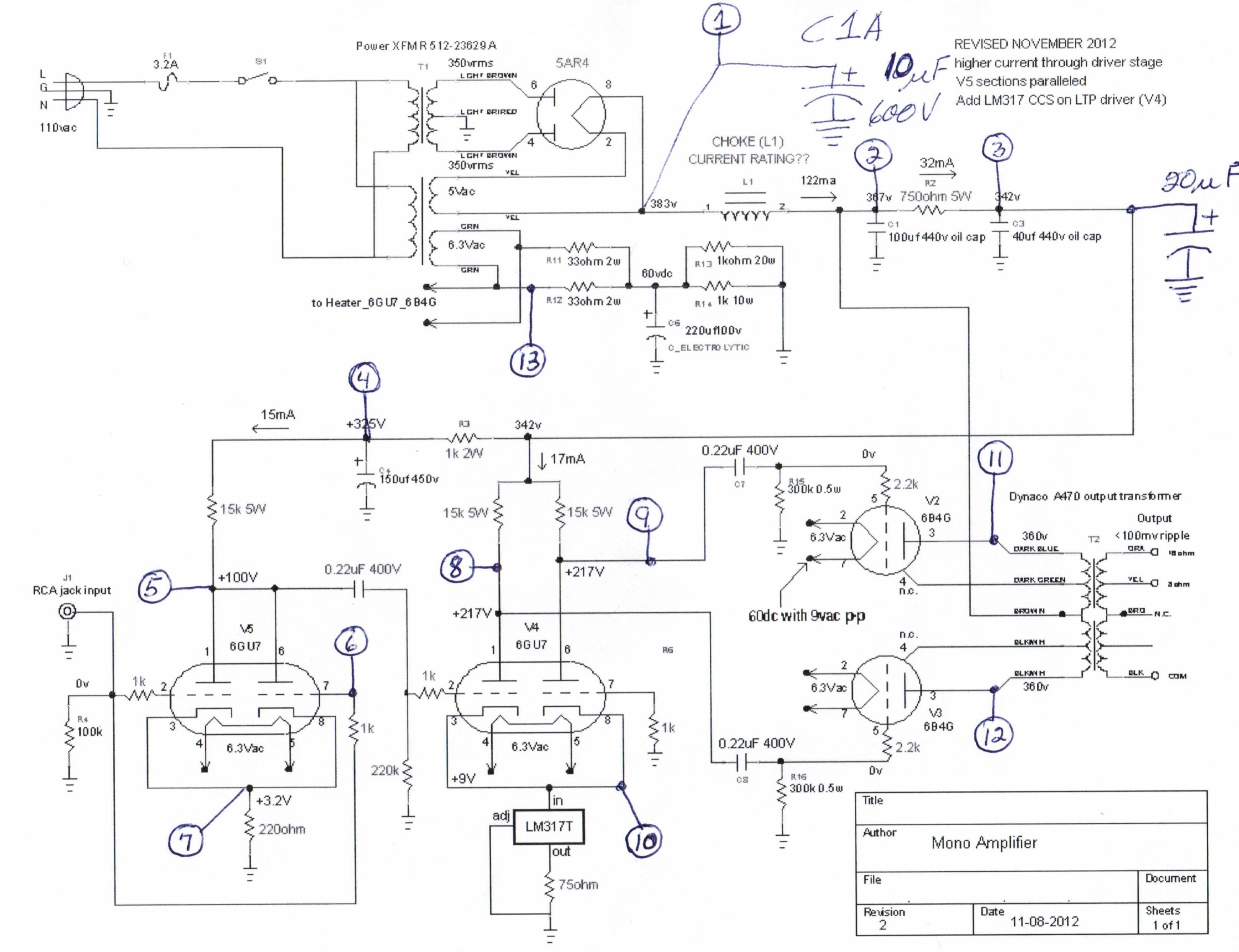

How to improve this 6B4G push-pull circuit

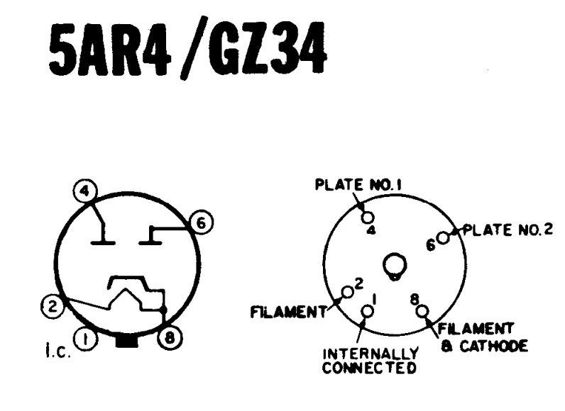

at pin 8 of V1= 5ar4, theres a big 10 uf-600v caps
theres in paralell with c3 40uF-440v.) one of the big gray caps of 20uf-440v
Are you saying that there is a 10uF 600V from 5AR4 pin 8 to ground?
If yes, that means the schematic is wrong, and it's not a choke input supply.

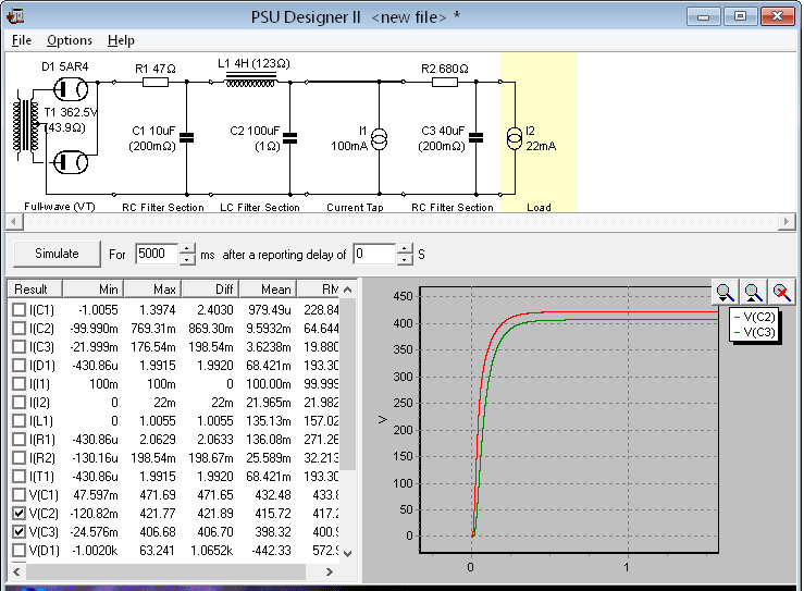

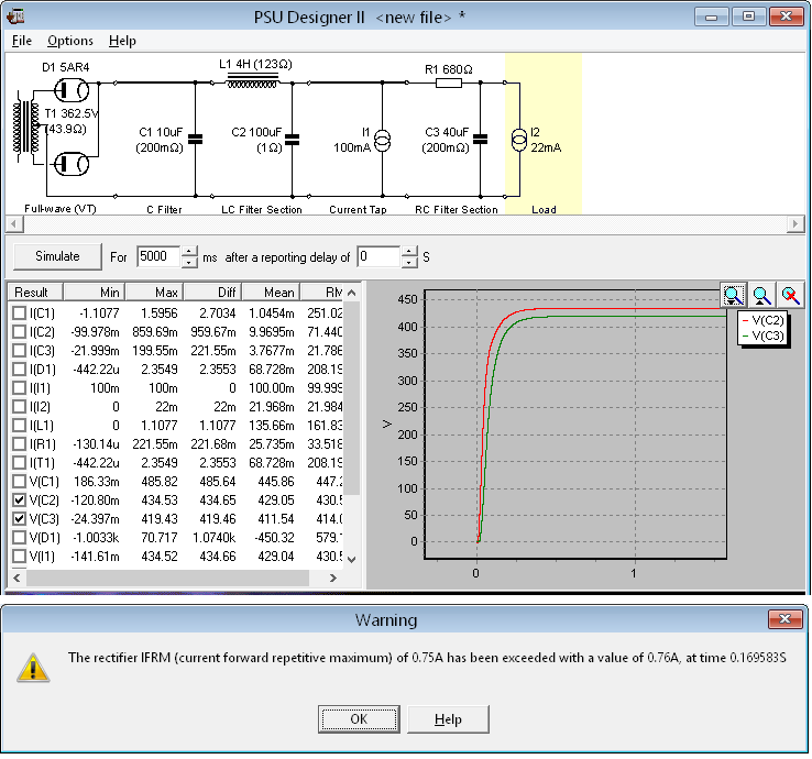

Going on the assumption that yes there is a 10uF cap from 5AR4 pin 8 to ground....
I ran a PSUD2 sim to see what the power supply looks like. If it is what I think it is, then the picture on the left is what I got. Note the warning that pops up that the peak current capability of the 5AR4 has been exceeded. Those tubes are being run right on the edge.
If we add a series 47 ohm 5W wirewound resistor between 5AR4 pin 8 and the 10uF cap, we get the results in the picture on the right. You'll lose about 6V off the B+. The AC ripple at the 100mA current tap is only 13.3 millivolts (after a 3 second delay). Not bad!
If that's correct, then you could probably reduce that series resistor to 22 ohms.
I may be doing something wrong in PSUD2, so if you see any mistakes, please point them out. Learn, learn, learn...
I hope this helps.

I'll bet the voltage measurements on the schematic are wrong too. Can you take voltage measurements and post them here? It would be great to get measurements from:
- 5AR4 pin 8
- 100uF 440V cap
- 40uF 440V cap
- DC volts at pins 2 and 7 of the 6B4G's
- pin 3 of each 6B4G
- pins 1 and 6 of all four 6GU7 sections
- pins 3 and 8 of all four 6GU7 sections

the voltage are all exact and were taken recently.

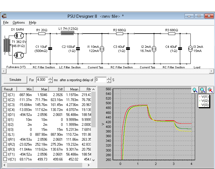

Thanks Scott17 for setting me straight. That helps a lot.
Assuming the two 6B4G's are drawing 122mA, the second stage draws 16.67mA and the first stage draws 15mA, then I get the following voltages:
B+ to the OPT center tap = 413V (that's too high!!)
Ripple on the B+ to the 6B4G's = 192mV
B+ to the second stage = 392V, ripple = 17mV
B+ to the first stage = 382V, ripple = 11mV
(see attached screenshot)
_______________________________________________
If that's correct, then the 6B4G's are seeing about +410V on their plates, with a cathode bias of +60V, so plate-to-cathode voltage of +350V. That's 50V too much, and will cause the vintage 6B4G's to fail prematurely.
Also, the plate dissipation of each 6B4G would be a whopping 21 watts (!!). That's 6W over the 15W max dissipation spec for the tube. They'd be running way too hot.
Are you sure the voltages on the schematic are correct?

The only thing that pops out at me is the operating points of the 6B4G's.
- If the voltage at the 6B4G plates is about +360V, and the voltage at the cathodes is +60V, then the plate-to-cathode voltage is at the 6B4G's limit of +300V.
- 60V across 500R means the plate current of each 6B4G is 60mA.
- 300V * .06A = 18W plate dissipation. That's 3W over the 6B4G's published limit of 15W. If those are Sovtek 6B4G's, then I think they can take it. If they're old USA 6B4G's, then I'm not sure how long they'll last pushed over the limit like that.
Well, that's all I got.

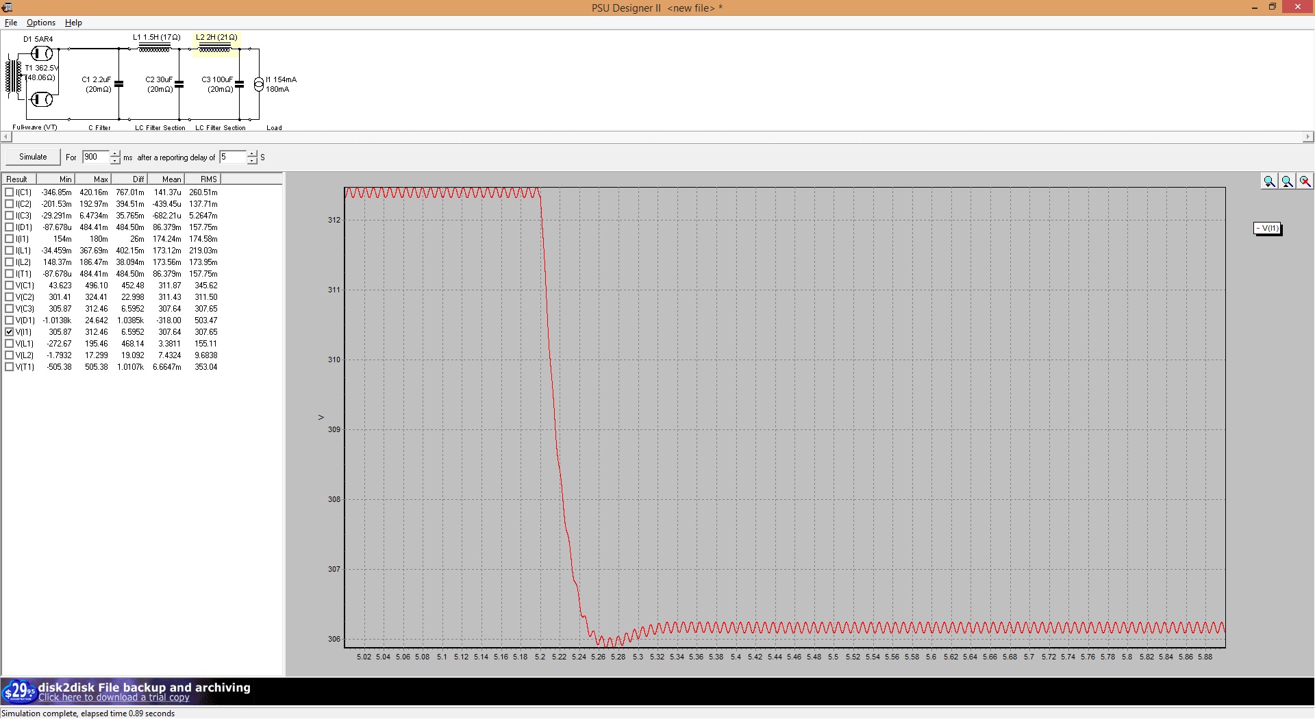

I'm at a loss as well regarding the measured voltages and the PSUD2 modeled voltages.
Could it be the first cap is out of tolerance? I notice that changing the 1st cap to 4.7uF brings the B+ down considerably, to right around 386V. That's using 4H @ 123R, again we are guessing at the inductance.
I saw that the line voltage was 110V so I changed the PT parameters to reflect that.
Where are you located youknowyou?
Changing the config to a CLCLC lowish DCR brings the voltage way down, maybe too low, but the settling time is pretty good.
Leaving everything else as is and just changing the rectifier to a 5R4 brings the voltage down, but the settling time, not so good.
At this point, I'm kind of with you rongon, that's about all I got too.

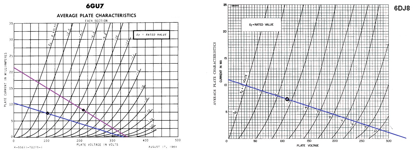

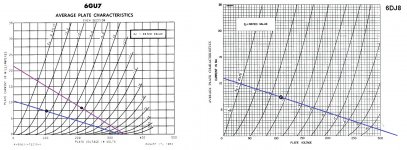

If you wrap negative feedback around the amp, you'll want a triode with higher gain and high transconductance in that first stage.
Looking at the characteristic curves for types 6GU7 and 6DJ8 (attached graphic), you can see that in the first stage of the amp, a 6DJ8 should drop right in and bias up properly.
6DJ8 amplification factor is about 30, compared to about 15 for the 6GU7.
A 6GU7 with 100V on the plate and 8mA of plate current will have transconductance of about 3.5mA/V. A 6DJ8 at those same conditions will have transconductance of about 8.5mA/V.
Don't try to use a 6DJ8 in the second stage, as the plate voltage is too high there (the 6DJ8's limit is 150V).
You can substitute types 6N23P, 6922 or ECC88 instead of 6DJ8.
(In the attached graphic, the purple line represents the loadline for the second stage LTP. The blue line represents the loadline for the first, input stage.)

I just thought of pointing out that even if changing the input valve to ECC88, double the gain only means 3db available for feedback, not nearly enough to help things...
I also dont like the LM317 as a CCS in that application, either have a decent CCS or a plain resistor is OK too

i think not enough open loop gain for feedback.
6gu7 has mu of about 17, the output tubes are triodes...
Thanks for weighing in. Sounds like another vote for switching to EL34 outputs, right? Half the drive requirement means another 3dB of NFB possible, for a total of -6dB. That would be just barely enough, correct? (Still not optimal, I know...)
