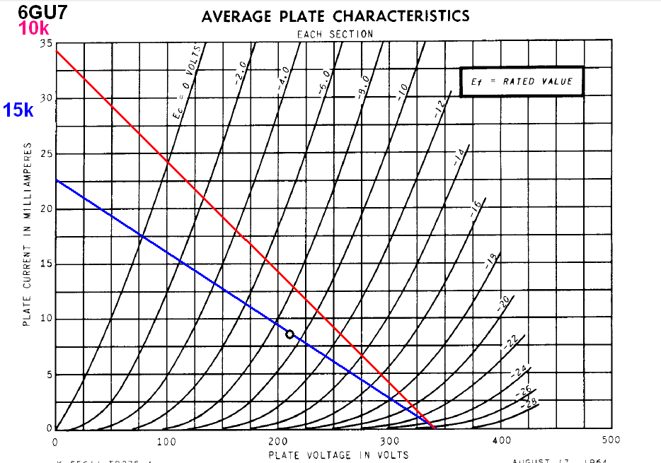

3. replace the 15k/5watt plate load resistors of the ltp to 10k for more swing...
AJT, I'm trying to understand what your suggestion #3 will accomplish. I've plotted loadlines for 6GU7 with 15k plate load resistor in blue, and 10k plate load resistor in red. B+ is 340V in both cases. I don't see much difference in voltage swing, but I could be reading the loadlines incorrectly. I do see that the 10k loadline is more vertical, which increases distortion and plate dissipation quite a bit.
6GU7's plate impedance at Va = 210V and Vi = 8mA is about 6k ohms. A 10k plate resistor would be a load of less than 2(ra). That's on the edge.

[youknowyou: Try changing R15 and R16 from 300k to 100k. That will filter out very low frequencies going into the output stage, which should help with the problematic bass boost.The 220k ohm after the first stage should stay. It can't be made much lower in value without loading down the first 6GU7.
Don't forget to change the 6B4G cathode resistor to 750R (must be rated minimum 15W).]
