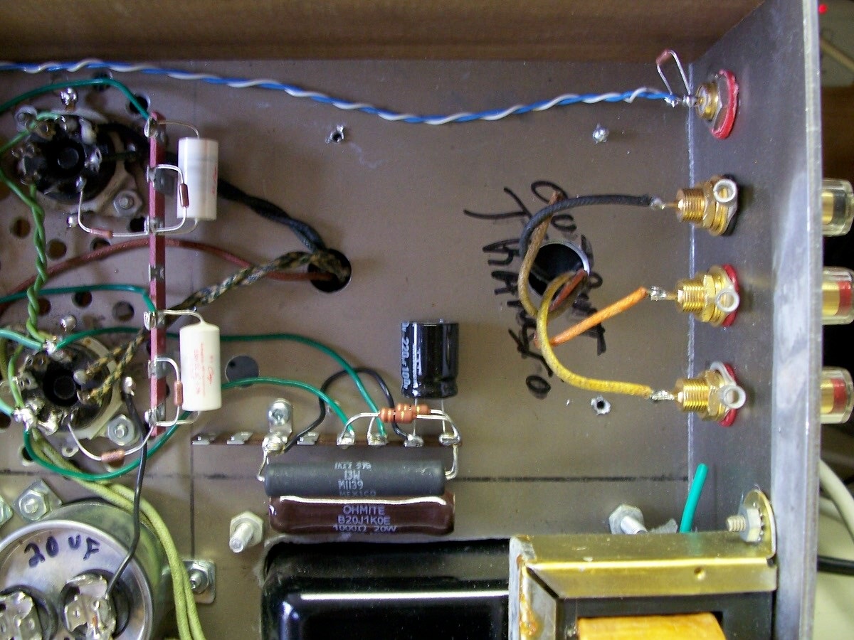

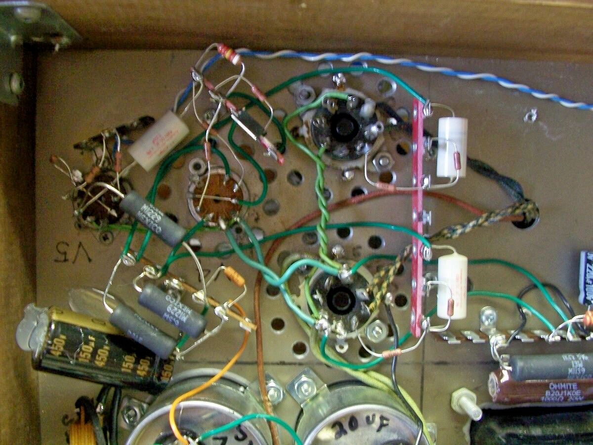

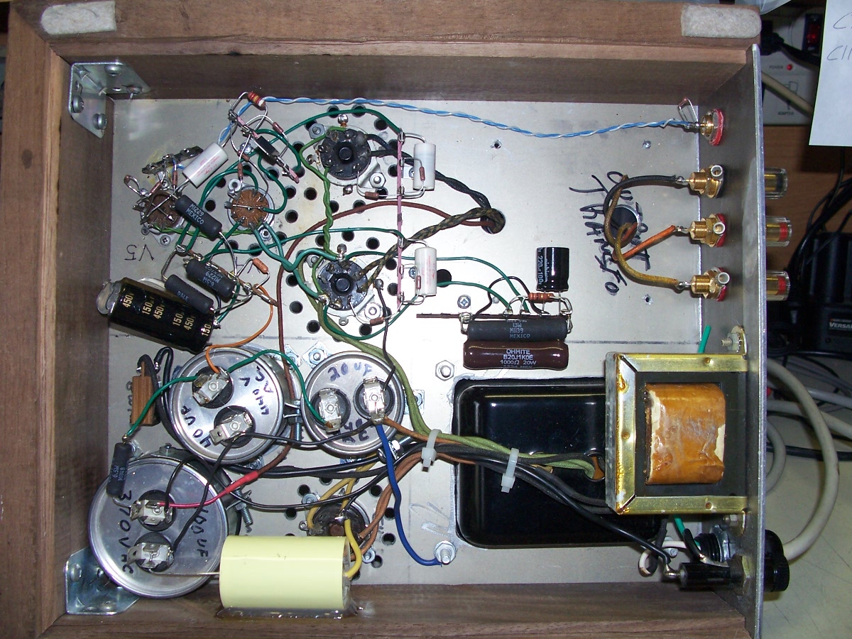

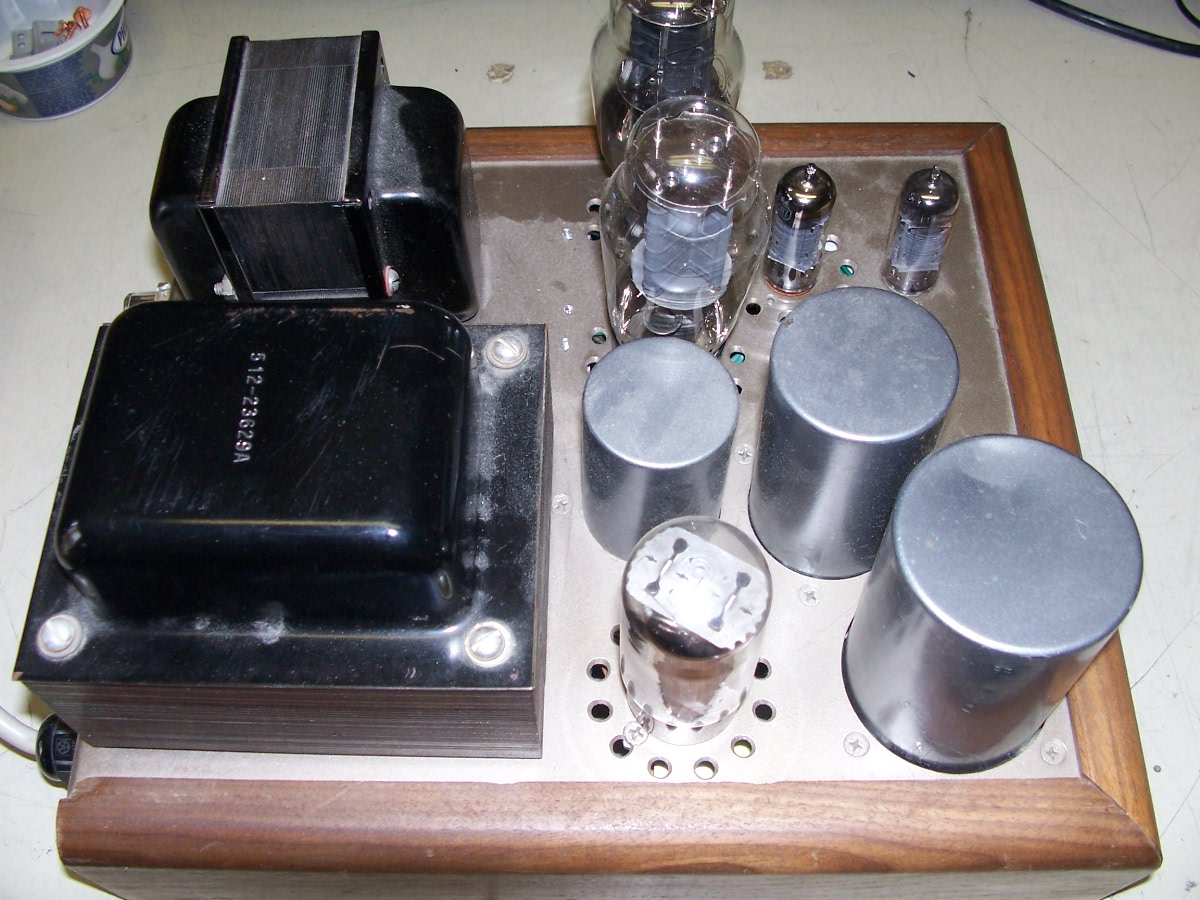

Re: Hum and murky sound -- Are we sure the grounding is done reasonably well? A photo of the layout and wiring would be very helpful. It's even possible that the power transformer and/or choke are coupling hum into the OPT or audio circuits.

At any rate, we need more information for sure. A picture of the wiring and layout would absolutely help matters.

the picture is coming

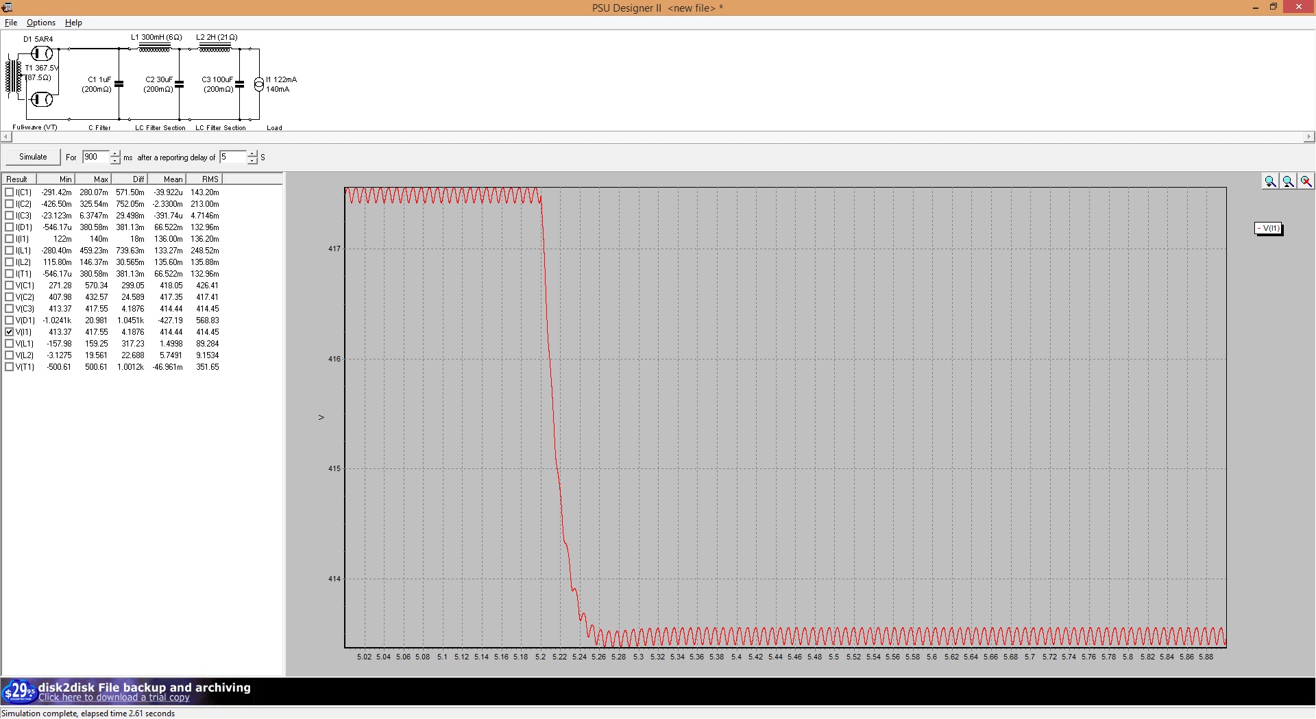

I took a wild guess at a power supply model in PSUD2. I guessed that the pwr transformer would be about 850VCT unloaded (figuring on +380V from a choke input supply with a 5AR4 rectifier).
Using a 5R4GB rectifier to a 1uF reservoir capacitor, 7H choke with DCR = 123R, and a 100uF filter capacitor, I got B+ of +356V with about 1.2V AC ripple.

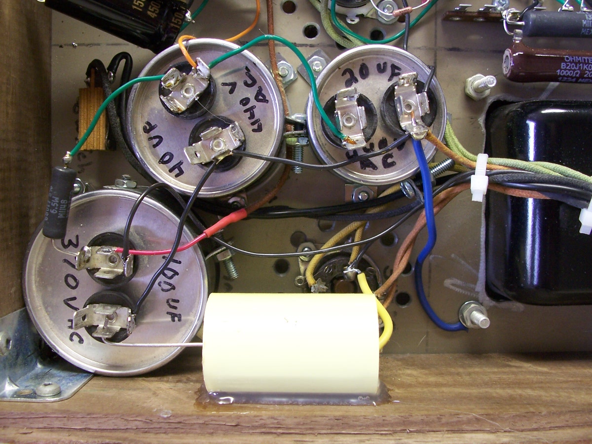

at pin 8 of V1= 5ar4, theres a big 10 uf-600v caps
theres in paralell with c3 (40uF-440v.) one of the big gray caps of 20uf-440v
