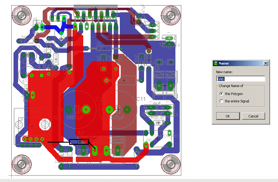

You are applying a solution that is used for balanced circuits. Pin1 is only shield. Your amp uses unbalanced circuits where the shield is part of the signal. Lets trace the signal path. It starts at the source, runs along the centre core of the coaxial cable to the amp board, through R1 and returns to the source along the shield of the coaxial cable.
The solution is to insert a 1 ohm resister in the ground loop where it will reduce the current flow that causes the hum but has the least impact on the input signal.

Your image, good old Eagle, will Autodesk kill it, same as Ecotect? Will get the 1 ohm resistor on Friday, more reason to look forward to the weekend.

Step 4 will insert a Ground Loop Breaker between PSU and Chassis. I will post the layout before Friday so that you can get those parts too.
Check DC at the output after installing the resistors and before connecting the load.

The secret is loop area. Route the return alongside/underneath the supply. There are plenty of good PCB examples to be found on diyAudio.
seems to work with the 2.2 ohm. I just did one board and does now matter, which board gets the shield onto the ground, the one with the resistor is quiet. As in, the RCA cable I interconnected the boards with has the shield just on one pin.
