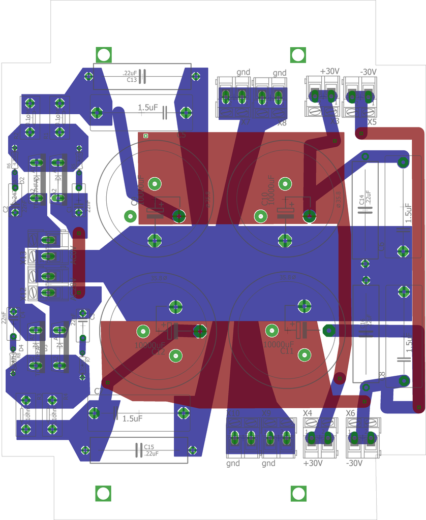

I redid the PSU board so its symmetrical. Will post the layout tonight. Plus some ideas on the amps and crossovers. I guess so, don't really need the small caps as there are 1000uFs on the amp boards as well
I just think that a smaller PSU board will make it possible to improve the positioning of the ground and power connections. If you are looking for inspiration, a good place to start is http://www.diyaudio.com/forums/vendors-bazaar/276145-ringnot-power-supply-chip-amps-bare-pcbs-assembled-tested-units.html#post4366692. The builder's guide is full of good info.
the Eagle has landed already, will post the layout tonight. What I did, put 2 power connections each side, because there will be 2 TDAs each side. Should that be a new thread?
So power in straight from toroid, short lead. Then 2 short power leads right and left to the TDAs.
Extremely wrong. 1000 uFs have self inductance from being wound and do not short out RF well. Impedance of inductance increases proportional to the frequency, which means wound capacitors don't do the job on sharp edges. 0.1 uf ceramics have almost no self inductance and are installed to give any sharp edges of the current waveform a slope, cutting the ability to couple to gain stages. If you can afford 1 uf ceramics of the proper voltage rating, go ahead. But .01 uf has been the traditional value.I guess so, don't really need the small caps as there are 1000uFs on the amp boards as well
Also after the rectifier, the shut off of the diode of about 0.6 v produces another sharp edge that needs another ceramic cap to give it slope.

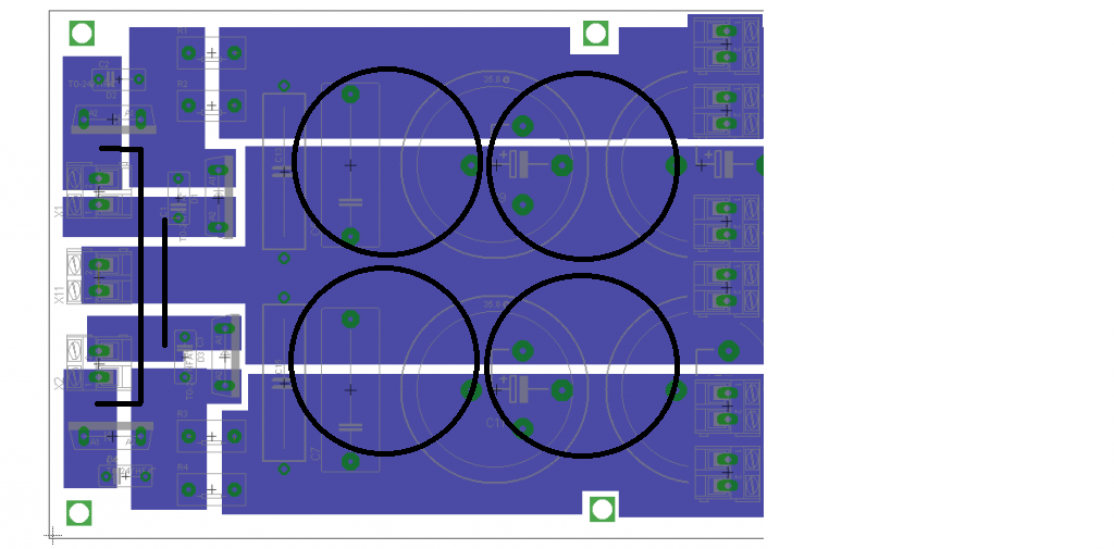

filter board has 3 grounds that eventually meet top left. Ant I tried to make them stars and run pretty much parallel. Amp board got the potis added and just to be sure a small resistor and capacitor for shield ground.PSU board is smaller, got some RC across each diode.
What is the purpose of all those capacitors in the PSU board? How did you determine their values?

Capacitors at the far end of long leads can never meet a fast changing demand for current.
If the load requires a fast changing current capability, then the long leads MUST BE ELIMINATED.
This is achieved by locating the local supply rail decoupling at the load. The ultra short capacitor leads between the cap and the load inherently have low inductance and allow a fast change in current demand. It is another case of small loop areas for the current circuit.

That is before and after a voltage regulator. A regulator needs to be able to pull HF current that can only be supplied by a small cap. Same as the TDA amp that also needs a small cap near the power pins.

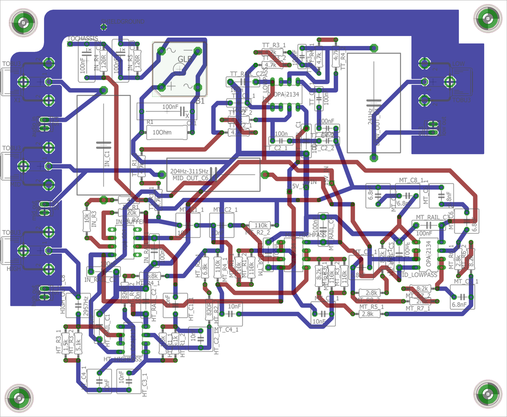

The board in post 152 has the AC rectifier a coupla centimeters from a very fast 20 v/usec op amp. Although the sharp edge transients are suppressed right there with a 0.1 uf ceramic cap, there are long leads coming over from the transformer carrying them and putting the 500 khz to 1 mhz components out in the air.
Successful commercial amps I own don't do that. They put the rectifier next to the transformer over at one end of the box with the filter caps including the ceramic, and the Peavey ones have a steel bulkhead around the transformer. They put the high gain parts at the other end of the box. They connect PS to gain with twisted pair carrying DC with 500 khz to 1 mhz already filtered out.
Meanwhile the Mark Whitney proposed filter board previous had no ceramic filter caps on it, just huge electrolytics.

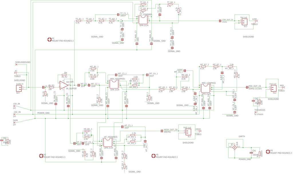

Further more, this board has 20 v/usec slew rate op amps (opa2134) with no 22 pf or 33 pf ceramic cap around the feedback resistor to keep the RF from being amplified. Didn't work when I tried 12 v/usec op amps, they oscillated .

The AC rectifier on the crossover board is part of a ground loop breaker and only passes current in the case of a critical error.
The "Mark Whitney proposed filter board" is a Quick fix. By cutting up the old board we can see what HF content is present and if any extra's are needed. This PSU is only for the four amp boards. The Crossover board has its own transformer and PSU.

the existing PSU is on a 70um copper board with lots of planes, I won't be able to get the elcos out.I can remove the small ones, just cut the legs off. It has 100nF ceramics across the diodes.
Ceramice, because they have higher ESR, so you get a small resistor there too, so it makes a bit of a snubber. New board has 100nF and 100R parallel to each diode.
The diodes are ultra fast soft recovery HFA15
http://www.vishay.com/docs/94054/vs-hfa15tb6.pdf
and then before the capacitor banks there are 2 off 0,1ohm resistors.
New board is next to the toroid, the cable goes in at about a few in long. Then it sends both voltages and gnd to both sides, so the cables to the amps are shorter. I will make a photo tonight with the printout of the PSU board. So its small caps can go, as there are 1000uF and then some 100nF or so at the TDA boards on the power rails. The linked PSU was for a class D amp, might have higher frequencies in power draw
Tapping for the GLB will be next to the 1st capacitor, where the messy currents are the highest. There is a little needle/pin connector
