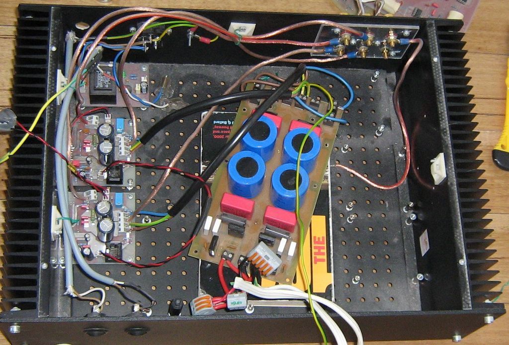

Concerning the hum when the input is open. All the amps will be permanently connected to the crossover so the inputs will never be open. Possibly a problem that does not need to be fixed. The cause could be the layout of the amp board. Like twisting leads, it is important that the input and the return do not form a loop.

its quieter when they are connected to something and noise even happens, when I just connect the input of 2 amp boards.

I guess there needs to be a shielded connector on the amp and xover board. Then ground the shield to one board only. I think I redo the xover board, put one dedicated shield ground on that then goes onto the earth connection. The audio cable I just use a single strand, as the ground comes from the star point. There are some slightly better RCA cables, somewhere around 5 bucks
interestingly, put 100pf and 100 ohm parallel and connect that to shield ground and ground on the amp board is louder than a twisted cable, when the other end is not connected and quieter than a twisted cable when both ends when connected. But the buzz is still annoying.

I would use shielded for all signal wires. If you really want to go to town use twisted pair shielded with screen and one off the pair to signal return at crossover end and shield not connected at amp. If using single screened wire connect screen at both ends

aha, the cheap ones use the shield as ground. Found a somewhat more fancy video one, same thing. Somewhat thinner than an antenna cable, braided shield acting as ground. Ok, I make one up and hang it onto the mobile phone. Got a cheap one head phone to PCA.
Laptop, a bit worried, would have to run of battery and pull out the plug to 240V to be sure.

this statement makes it clear that a loop is being created so reviewing your ground scheme is in order.
the other thing to consider is isolating the signal lines between the amps(as well as the x-over) with either repeat coils (transformers) or opto isolators.

I found set up 3 star points and then connect them via 100ohm and 100pf caps. But first I guess eliminate anything else. First I tried the other way, putting resistors on the outputwhile the noise was there and the noise did not change. But could also have been, the noise was too loud to hear the other influences.

ok, hooked up the phone, and its all quiet. Just with a butchered up 2 buck shop RCA to headphone cable. Leave the cable open, its more a hum. Quite big on the 50 Hz, not many overtones. Have to try again, when I connected two amp inputs, I hope I only connected the signal side. Otherwise its obviously a ground loop.

For now its all star ground though, everything goes onto one gound, then onto the earth prong of the 3 pole socket

I think the inputs should only have the signals connected, otherwise there will be a ground loop. I reckon I will replace one blown up TDA and keep going with this setup, if I switch amps now, too many variables.
The signal input is a two wire connection. You must maintain continuity of that two wire connection otherwise you break the signal.
It comes down to remembering that any current from a source MUST return to it's source.

but when I just interconnect 2 amps, there should not be a signal? Thats why I am abit conderned about a ground loop, as the power crounds meet at the PSU.

Earth is still not connected to the housing and nothing else, still coming direcrly from the socket in the wall.

Take the speaker return back to star ground, not pcb. You've got too many unscreened wires. It looks like you've connected the inputs together? Don't do that. Try connecting signal return to the chassis
this would be the easiest way to eliminate anything else like the crossover. So now its either a groundloop or interference. If I only run the signal cable and disconnect the ground between the inputs, its same as loud, even with a way shorter cable. That only leaves interference. So I guess I have to try shielded.

There should be no voltage/signal difference between the case and the signal return. The only way to do this is to connect them together, ultimately at the rca socket when you have fitted it, but for the time being connect a wire between signal return and chassis anywhere convenient. Do this for all signal returns. The earth connection to chassis is for safety, nothing else.
essentially everything goes onto one star ground at once? Signal and power?
I still should try Marks picture further up, use cheap RCA cable first and then coax.
