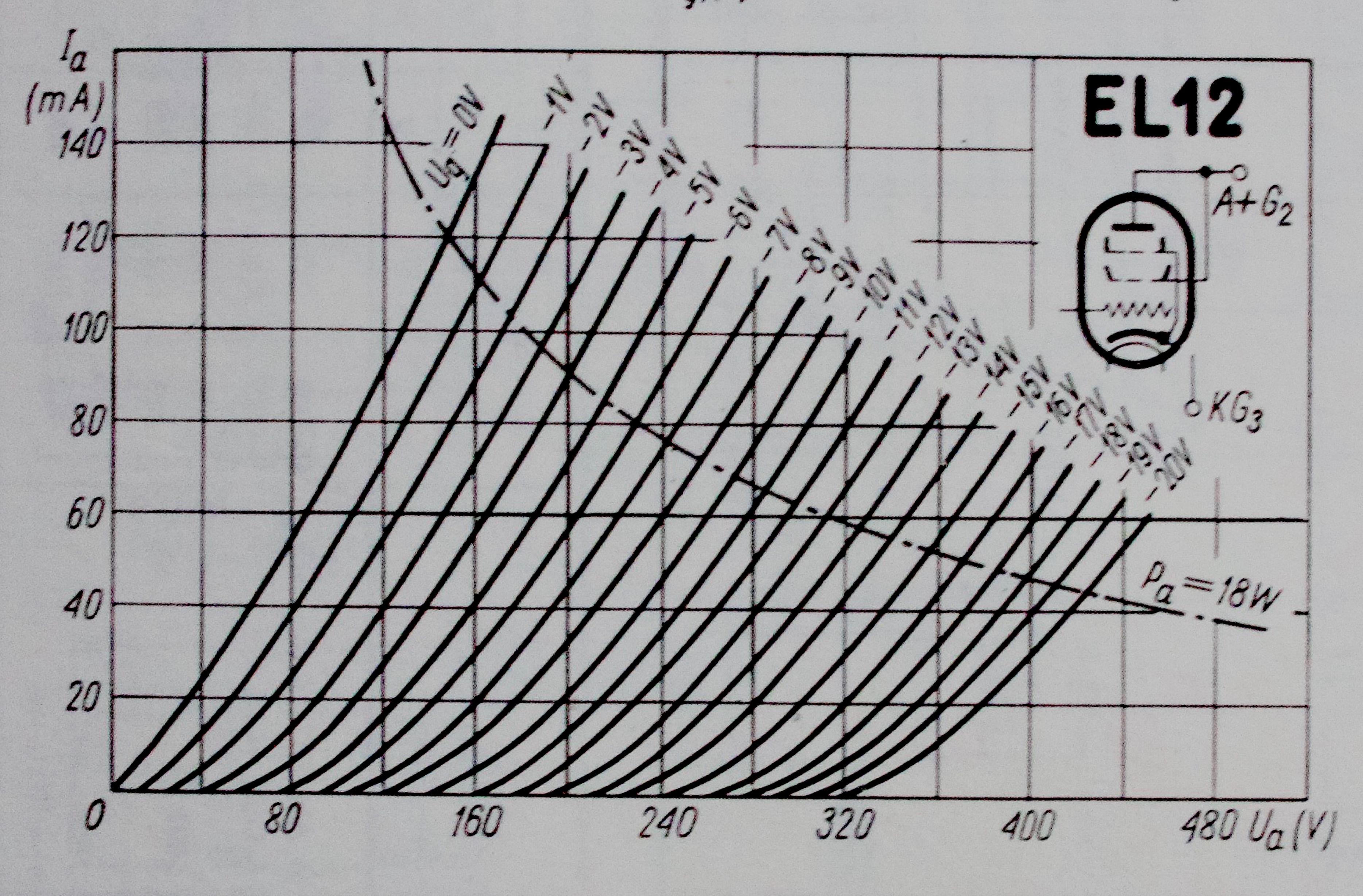

Perhaps someone can comment on the drive requirements of the EL12N?? Don't you need to draw a load line to determine that?
The EL12 typical operating point is 250V, 72mA, -7V, so making 14Vpp grid swing is not difficult.

Operating point is around 264v, 70mA, -9.5v

- did you measure or calculate the miller capacitance of the EL12N?. As discussed above, with its high mu, I assume it wont be easy to drive. I'm unsure how to calculate without Cgk which I can't see on datasheet.
- do you experience same thinness at higher volumes with the 300B? I see youve posted about using that also for output,
- what was your physical implementation between 01A and output tube? Were you driving cables? I'm wondering how much socket and stray capacitance you had at the time.
Many thanks!
Hello! The 01A never worked for me in a 2 stage amp so I abandoned it a while ago. Several people have had success with Ale Moglia's solid state solutions, however, so check them out on his Bartola Valves website.
From Ayumi's spice model:I'm unsure how to calculate without Cgk which I can't see on datasheet.
CGA G1 A 0.6p
CGK G1 K 5.7p
C12 G1 G2 3.8p
CAK A K 5.9p
Many thanks! Now I have to admit I didn't consider how to calculate with the multiple elements! 😳 I was only familiar with the basic triode calculation;From Ayumi's spice model:
CGA G1 A 0.6p
CGK G1 K 5.7p
C12 G1 G2 3.8p
CAK A K 5.9p
Cin = Cgk + Cgp*(A+1)
