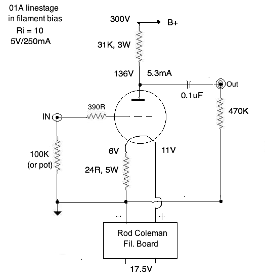

I believe I have a workable solution for a two-stage all-DHT SET with 01A driver. The solution is 4-prong:
1. 01A running at 7-8 mA current. This may sound like abusing the tube, but it is not. There is nothing in data sheet that says 3 mA is the maximum current. The Cunningham data sheet says "... as voltage amplifier, CX-301A should be used according to tabulated data AND GRAPHS. The plate graph extends to currents slightly above 7 mA. Moreover, there is article by G.M. Best, "Vacuum Tube Data" in the vol.6 (July) 1924 Radio magazine, in which plate current for UV-201A and C-301A is listed as 1.2 - 8 mA. For those who don't believe, the issue is available on Google Books.
Higher current doubles the driving capability of 01A in terms of slew rate into capacitive load. It reduces Rp from 10K to less than 7K, which improves conditions for transformer coupling (#3).
2. There are versions of 01A with even lower Rp, about 4K. I call them "Super 01A".
3. 1:2.2 step-up interstage transformer. With 2 Vrms source, 01A can output 16 Vrms, which is about the maximum for this tube that should not be exceeded. 16 Vrms is not enough to drive a power DHT. Stepping-up input signal is not a good idea, as it will exceed low distortion output capability of 01A. Although 16×2.2=35.2 Vrms may be a little short, it is in the right ballpark.
Step-up IT will degrade driver's current capability, but to counter that, there is the third prong:
3. Use power DHT with substantially less Miller capacitance than that of 2A3, 300B, or EL-12.

Interesting concept, and I'm in total agreement about an all-DHT SE amp. As you know, I have a similar 2 stage all-DHT 2a3 amp working as my daily amp, and loving it. I've used the 2P29L as the input stage which makes a lot of things simpler and I use a 1:3 SUT on the input to get the gain. Cheaper to get a smaller input SUT than an interstage. Even a Hammond 124B sounds good as a SUT, and that's what I am using pending the arrival of a more upmarket SUT.
But yours is an interesting and original challenge. Is the 01A the right tube for this job? Set up right it's as good a tube as you can find - no argument there. The datasheets are ancient and don't specify maximum plate dissipation, so as you say it's mostly guesswork. If you can play around with this and make it work it would be very informative!
sser2, I am just trying to understand here: does this follow from the spec sheet's "tabulated data and graphs"?
Andy - 01A plate dissipation is not a problem. The plate is more than adequate size to dissipate 1.2 W at 8 mA. 26 has same plate size and construction as 01A, and it dissipates 1.1 W at its highest tabulated OP -in addition to 1.5 W filament. Actually, 01A at 135 V 3 mA is running too cool (barely warm to touch) for optimal gettering. Good gettering is extremely important for the longevity of its very thin TT filament, that's why it has, unlike most other tubes, getter flash all over the envelope. Thus, running at higher current, you kill two bunnies with one whammy - better OP and longer life.

I wondered about something like this......
