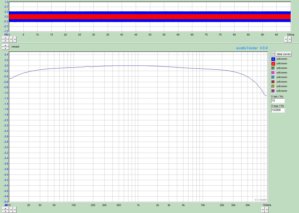

Some years ago I measured CCS loaded 01a (201a) with SIC follower.

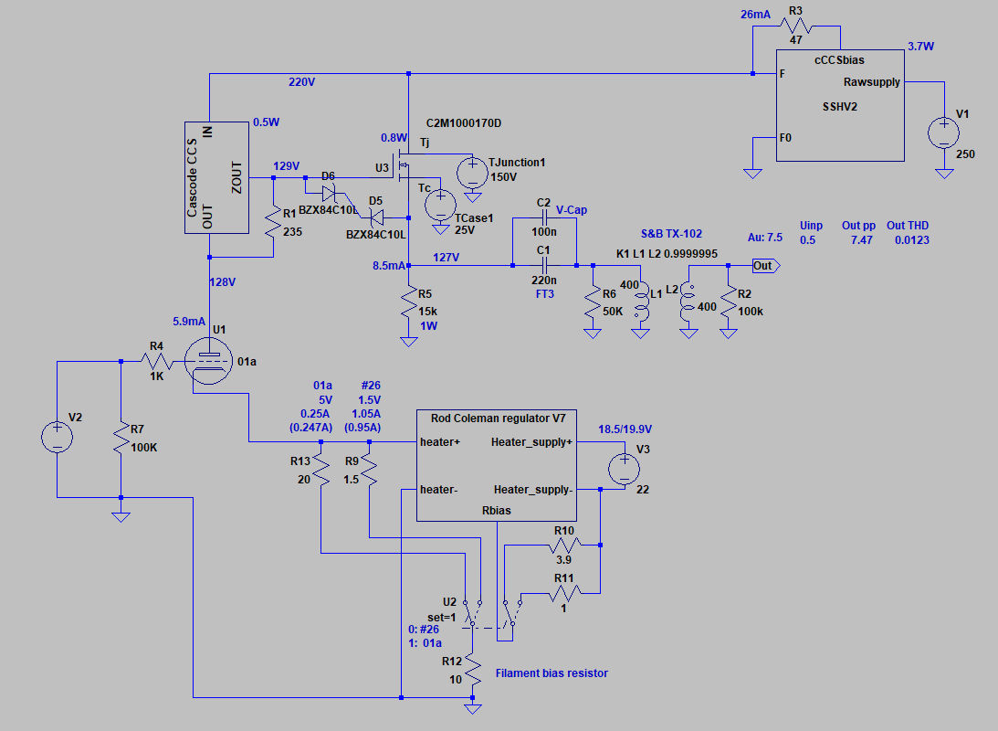

I've been getting on with other things, though still using 01A into EL12n (mostly).
I haven't yet put in a cathode follower - sounds pretty OK at lowish volumes without. But I really should try something out. I was thinking something simple and generic with an ECC99. Does this draft idea look OK? Any useful tweaks I should make? The maximum h-k voltage is 200v. Ideally I ought to raise the heaters. I chose 8mA to give adequate current and keep a 20K resistor to ground. Reading Morgan Jones it seemed important to make this resistor as large as possible.

I read your earlier comments about wanting to get more drive from the 01A. And it seems that more drive = more current. Please forgive my technical ignorance but . . .
I've heard people say that a particular output tube needs a certain amount of voltage from the input tube in order to provide full power output. But I've never heard anyone say that an output tube needs a certain amount of current from the input tube to produce full power.
Since your preferred input tube, the 01A, has a mu of 8 and you're using a 2v source, does that mean it can only supply 16v to the output tube? If not, how much voltage can it provide?
How much input voltage does the EL12N need to produce full power?
If the EL12N needs more voltage than the 01A can deliver, and your priority is to use the 01A, why not try a different, more sensitive, output tube instead of switching to a different input tube?
I might be able to offer a suggestion but I want to make sure I understand the concept of drive requirements first.
Thanks for the post. To be clear - the 01A is working fine at lower voltages into the EL12n, since I don't listen loud. A more sensitive output tube isn't necessary. A mu of 15-20 is enough for my system and I know of no power tubes of minimum 18W dissipation that have a higher mu in triode.
So what I'm doing is researching performance at higher volumes where slew rate may come into it. Now, to be frank I know very little of slew rate. Also it was my understanding that more current was needed to cope with the input capacitance of the output tube.
