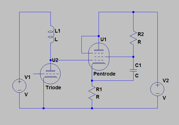

One way to re-formulate the question would therefore be "what thoriated filament DHTs with a mu of at least 8 could be used at higher currents as a driver tube". One answer would be "use a 10Y", which I have already done, but there may be others. I think most of us could name 50 driver tubes that on paper would satisfy the usual requirements for a driver tube, but unless they had the potential to sound as good as an 01A they would be irrelevant to this thread.

andyjevans, will you consider a cathode follower? this solves your issues on drive currents....or mosfet follower even?

Hello Tony. Yes, absolutely I would consider a cathode follower. The condition would be that it doesn't add colourations that would invalidate the choice of the 01A in the first place. The same applies to a solid state follower. If either of these were sonically transparent or near-transparent I would be well pleased. So by all means suggest. As I said before, I've never used cathode followers but I can build one.
Aesthetically, a tube amp with a big transistor heatsink may not be acceptable, but I have to tell you that FET (Sony SIT) follower showed me considerably better measurement results than triode connected Pentodes follower with 6P15P / EL803S. Both resistor loaded with 300-350V PSU.
Can you tell me more perhaps with a schematic? Ive been following this 300b driver thread with interest as I have an amp I want to upgrade. I also have Sony SIT's so your comment interested me.
I don't remember the final schematics since I was just testing them on the bench. I ended up using SIT as a gain stage without follower because I find its impedance and gain is good enough by itself for my purpose. I think you can drive 300B either with EL803S CDDA or with high voltage Sony SIT but may not be enough gain/swing with Sony by itself. I'm not knowledgeable about tubes, and EL803S was actually chosen based on Thöress 300B amp. I think it is one of very linear tube.

i think design starts with the 300b g1 negative bias, say -55v, so then your driver should be able to swing at least 55 volts peak....
you then ask yourself, is my driver able to swing this?
if yes, then the next question to ask is, is your driver able to drive the 300b miller + stray caps to 20khz?...30pf stray is a common design assumption...
so if the answer to this is no....then you look at ways to assist the voltage amp stage....

FWIW, try direct coupling .. if driving Cin (g-a, g-c) is a problem, likely the coupling capacitor is too.
Many people happily drive 2A3/300-B type with 12AX7 Ip <2mA.. direct plate to output tube.
