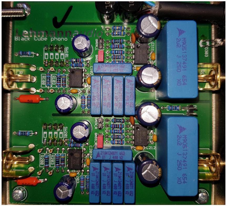

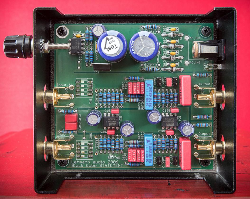

But this friend has a Lehmann Black Cube and surprise !!! EXPLOSION in every way. Incredible dynamic range.
That is what led me to ask the question that has brought so much controversy.

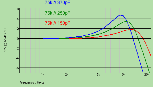

Considering the main areas for difference that might effect perception of dynamics we have
-gain
-RIAA accuracy
-cartridge loading
-overload margin
-subsonic performance
-noise
Of these I personally think that MM loading is the #1 culprit as a lot of phono stages will cause major deviations in response above 10kHz. A 5dB peak at 12kHz WILL be audible, but how it is perceived depends on a number of factors.
Overload margin is also important but I doubt there are many offenders in that area (happy to be wrong).
Gain will be picked up in comparisons if levels are not very carefully checked. Louder will sound 'more dynamic' in certain cases.
High noise floor will IME dampen dynamics, but it has to be very high.
