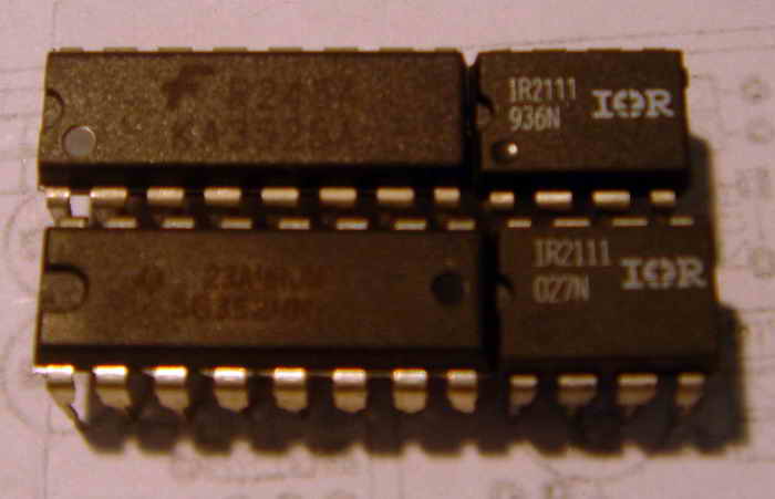

To make it even simpler, maybe we can use IR2111, low cost, and can omit the 4049 IC? I can buy IR2111 here, quite cheap. For others, I should import it, making them will be expensive.

IR2111 can be ok, but it is quite slow (only about 400mA drive) and it doesn't have SD nor dead-time control. You really need shutdown in order to control start-up and add protections such as overcurrent.

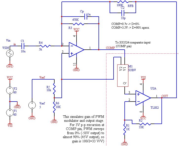

I have also started a simulation in order to understand feedback and biasing better. In the schematics shown below, the first opamp is SG3524 internal error-amp. The other simulates the gain of the modulator and power stage.
Note that SG3524 produces 93% PWM when COMP is at around 3.5V, and 0% when it is below, say, 0.6V. So I have arranged the rest so that I can simulate that behaviour and get positive and negative output. Of course I have used any opamp I have found (TL082 can't be fed at +/-60V !!!) only to get the behavior.
The simulation works nice, you get the expected gain (RFB/R4) but there is always an offset that is only removed if I add a capacitor in series with the feedback resistor, that I don't like (it will produce DC droop, error, etc).
There must be a way to DC couple the feedback signal in unipolar-fed error amplifiers. Any ideas?

About the IR2111 driver, be prepared to have quite high switching losses, due to its small drive capability that will lead to slow rise/fall times unless you use small or low-capacitance mosfets. IRF640N is a good start. The only advantage of that chip is simplicity.
Be prepared also for turn on/off transients due to the lack of SD pin.

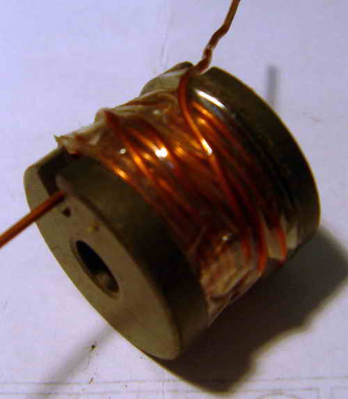

The coil is a drum core, isn't it? I started also with one of them from Wilco, with good results, although a iron-powder toroid core is better.
It only rests to fix the input/feedback coupling to remove the offset. The rest is quite straightforward, at least for a prototype.
