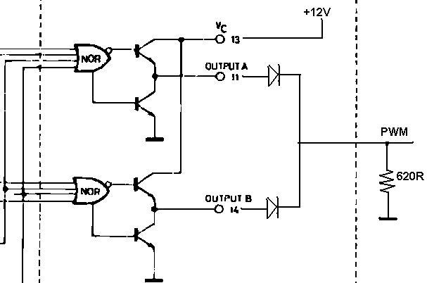

The sch is for a SG3525 that has totem-pole outputs.
IMHO the diodes are ok; this is how I see it: Each totem-pole output stage of the SG3525 will drive 12V when active, and pull to 0V when inactive, so the diodes are there to avoid that any transistor pulls down to 0V, blanking the output at any time (as two outputs are never active simultaneously).
BUT: you are right in that it won't work: a pull-down resistor is needed from base of Q1 to GND.
Is this ok? (I may be wrong, I am writing and drawing as the ideas come to my mind, so plese help debuggin it) 😀
Then it is ok as I have drawn it, right? (with the pull down, of course)
I attach a drawing of the internal output section and how it is wired. This way, PWM is not inverted. So it attacks the level shifter, which inverts and hence must go to the LS driver.
But I am still not sure about how it should be done with a SG3524 for not-inverted PWM output ¿¿¿???

Is the partial schematic shown from a 3524 ? If yes you can ground the middle of both totem poles and tie the collectors of the upper transistors together. Said collectors would then be connected to the base of the voltage-translator transistor and a pull-up resistor to +12V should also be in place. But phase would be inverted in this case which can easily be solved by changeing the inputs of the mosfet driver IC.
Regards
Charles
Edit: didn't notice that the collectors are already connected together !
No, Charles. That's for a SG3525.
SG3524 has "uncommitted" transistors (only one per output as opposed to the totem-pole output of the SG3525).

BTW the 2 diodes in your o/p (pin 14 and 11) is correct followed by a pulldown resistor. My prototype uses 220ohms 2watts on that resistor. the purpose of this 2 diodes is to "source" during logic 1 of either o/p then the 220ohms resistor will handle the "sink" because diodes dont have sink capability🙄

Thanks for the comments. About the pull-down resistors after the diode: that's true, in fact I realized and I think I corrected that in this forum.
