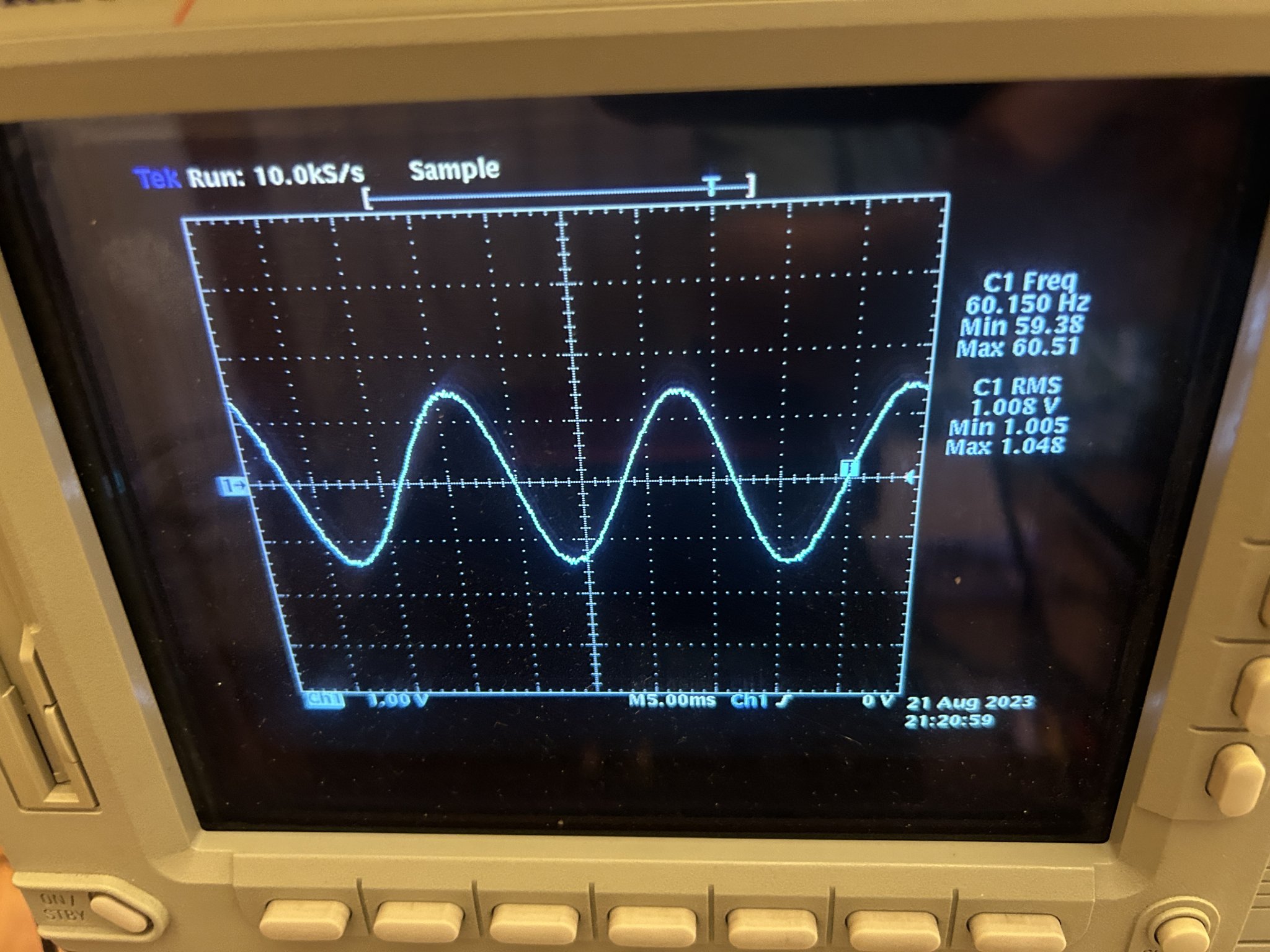

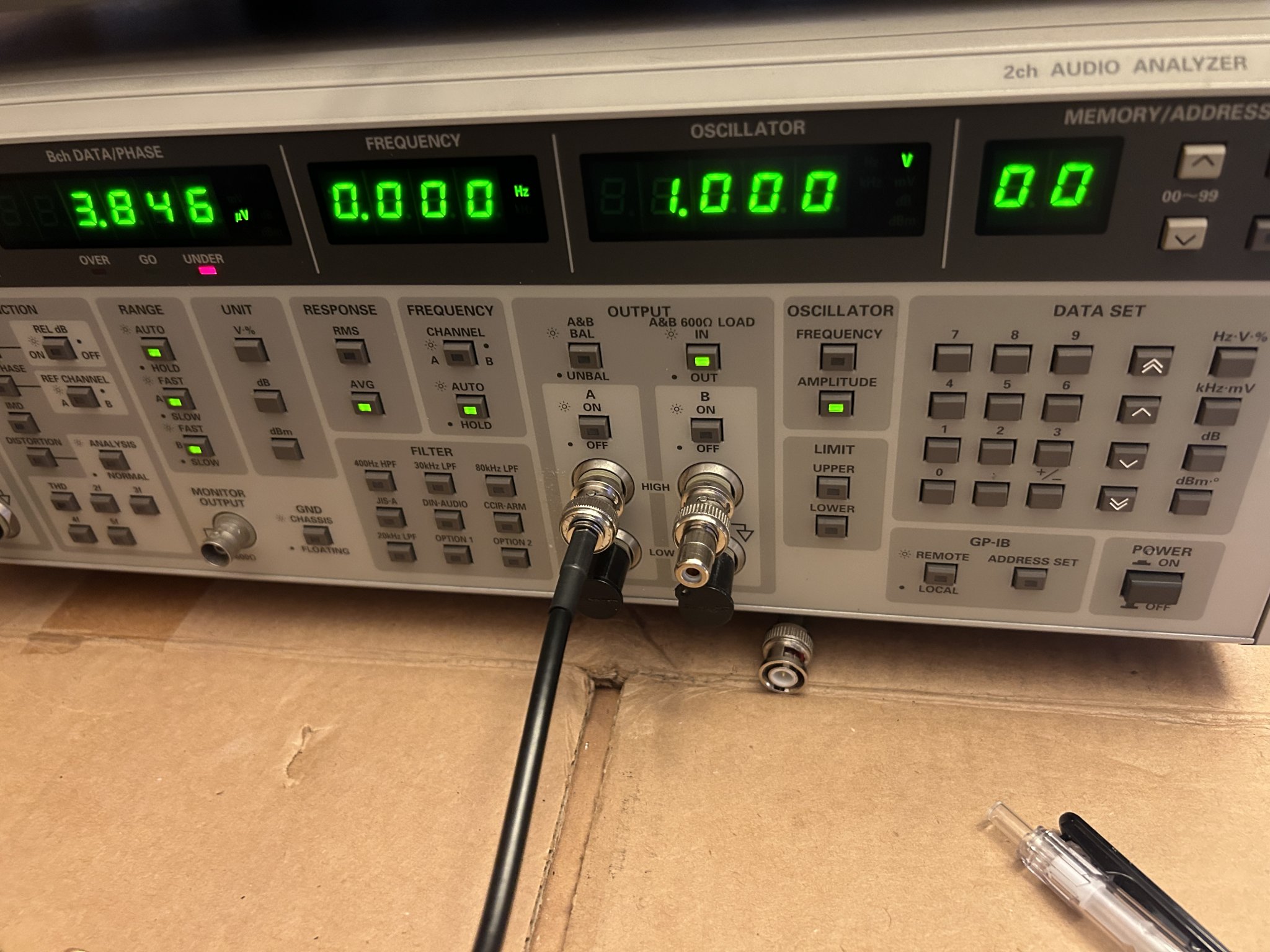

Just so I can perhaps show more clearly what I'm experiencing and either confirm that I'm a complete dolt or help myself out of the 'is this guy serious?' box...
I will try very clearly to both show in pictures and describe a few things...
Here are two pictures of the initial balanced output settings from the ShibaSoku.
The first It shows the settings of 1Vrms output, balanced, with both + and - phase connected to the scope. Of note, the impedance button (light) is set to 600ohm load IN (light on).

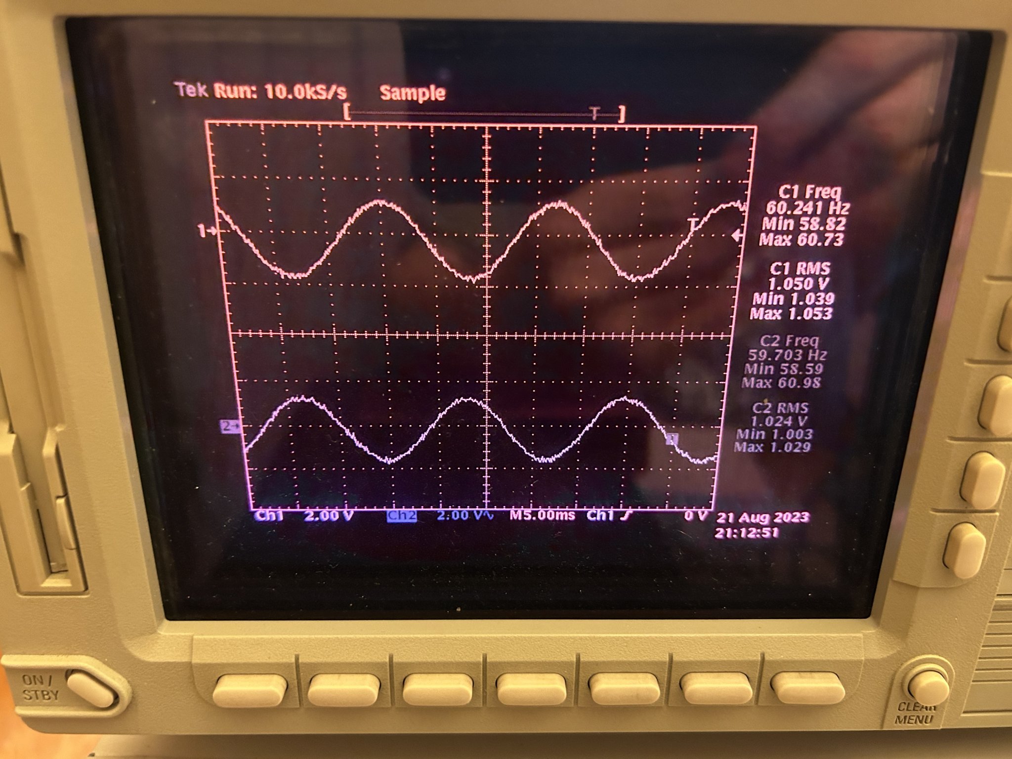

This is a picture of the scope output for channels one (+ phase) and two (-phase). It's what I'd expect to see, and a DMM agrees with the scope and the displayed output voltage of the Shiba.

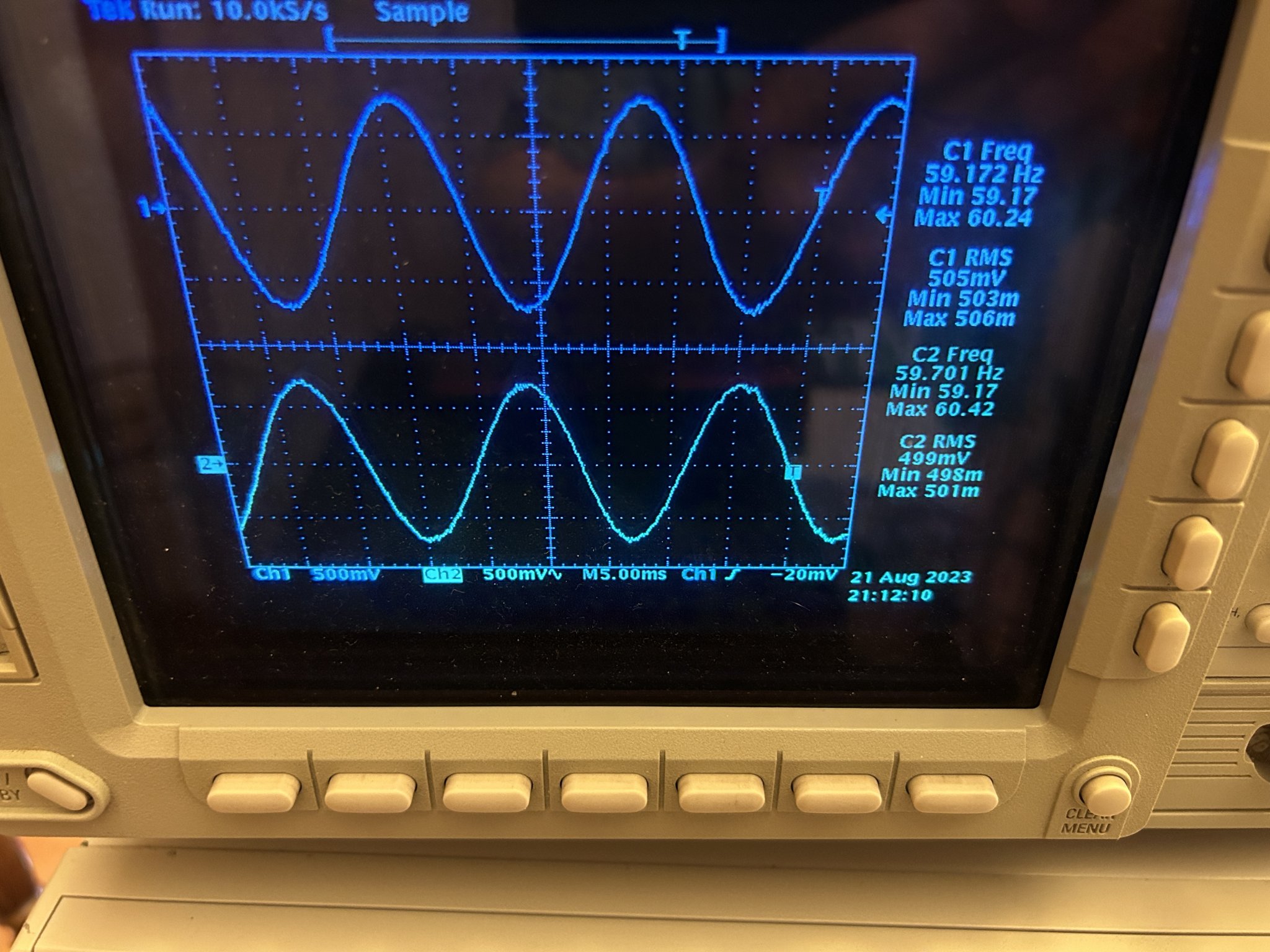

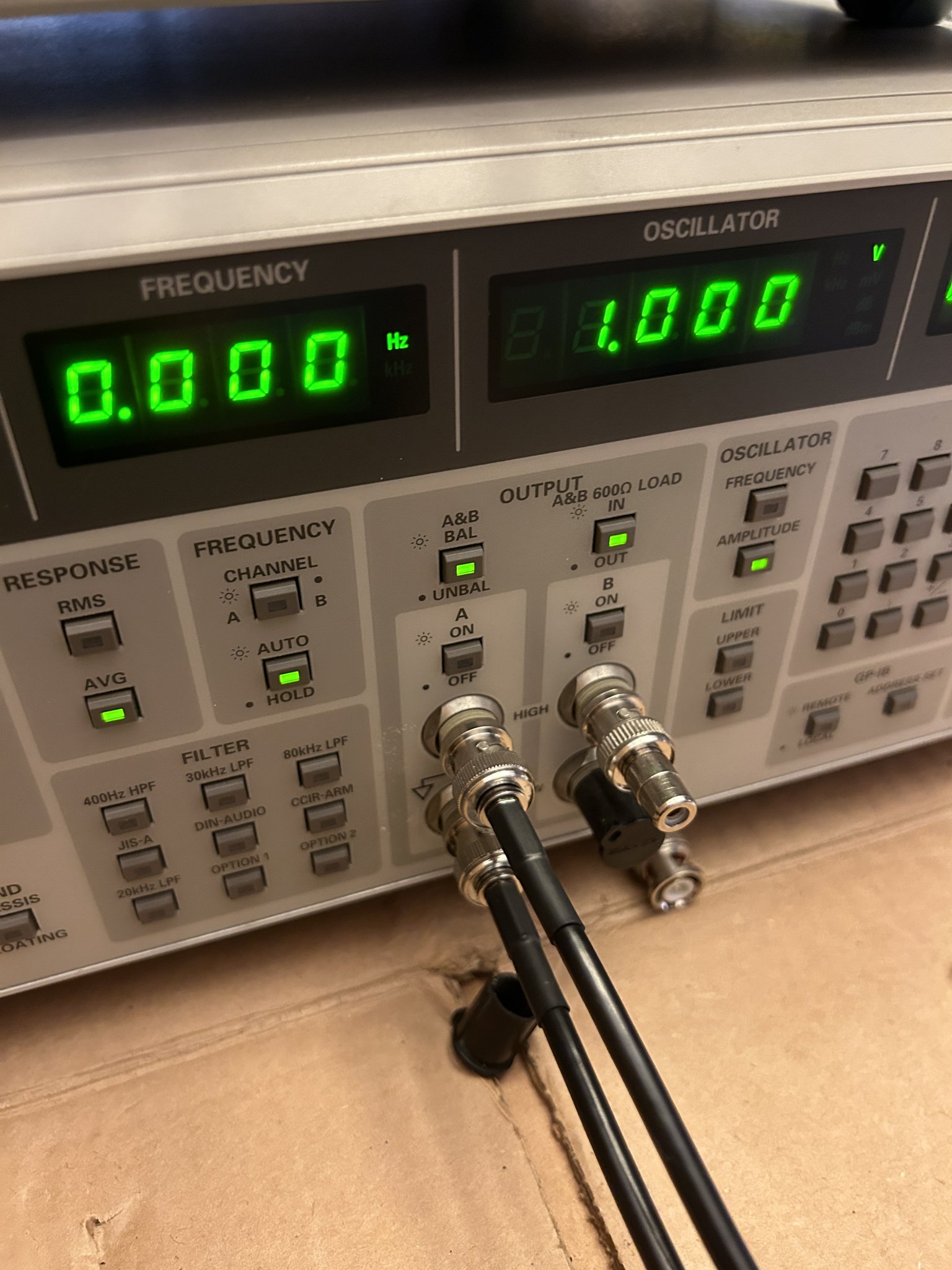

Here is another scenario. The only difference is that the impedance button is set to "out" and the light is off. The measured voltages double on the scope and the DMM. The displayed output voltage remains the same.

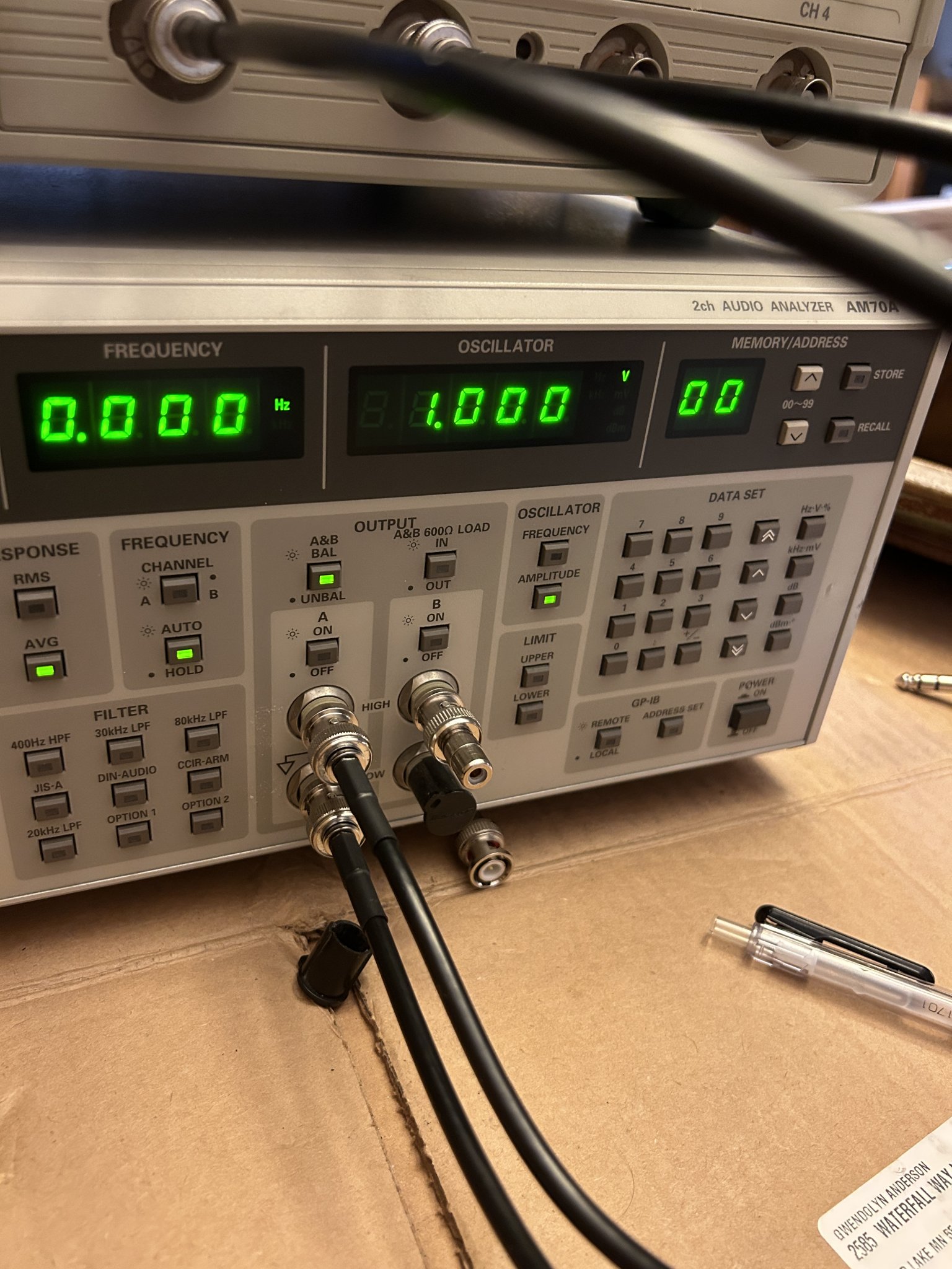

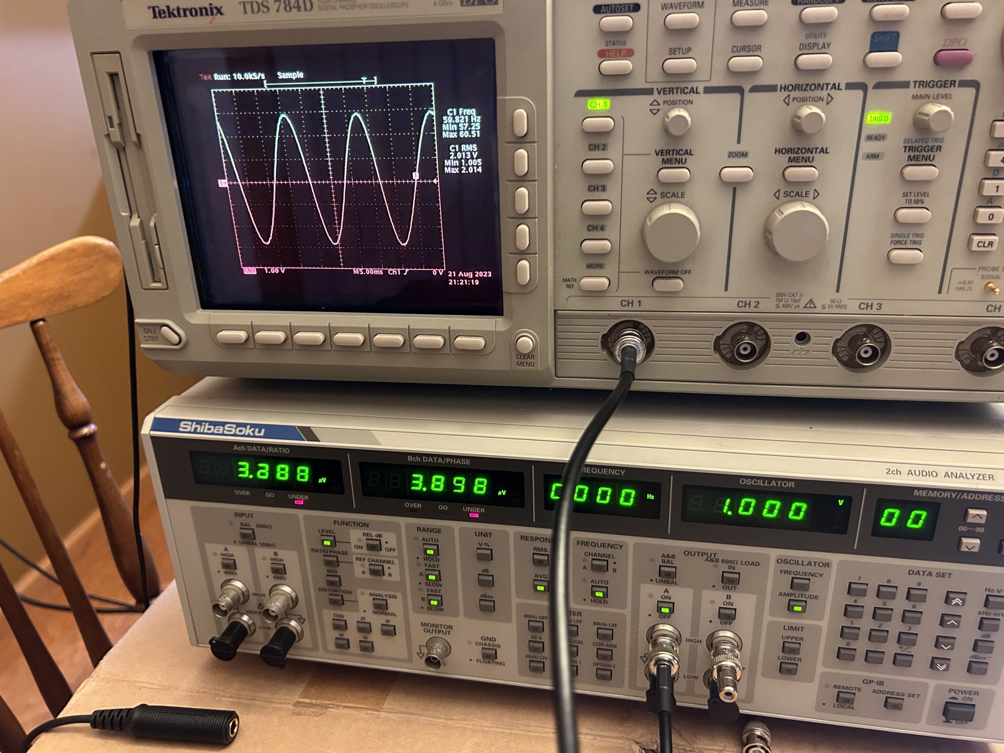

Here is the "SE" output of the Shiba at 1V with the light on.
Here is the "SE" output of the Shiba at 1V with the light off.

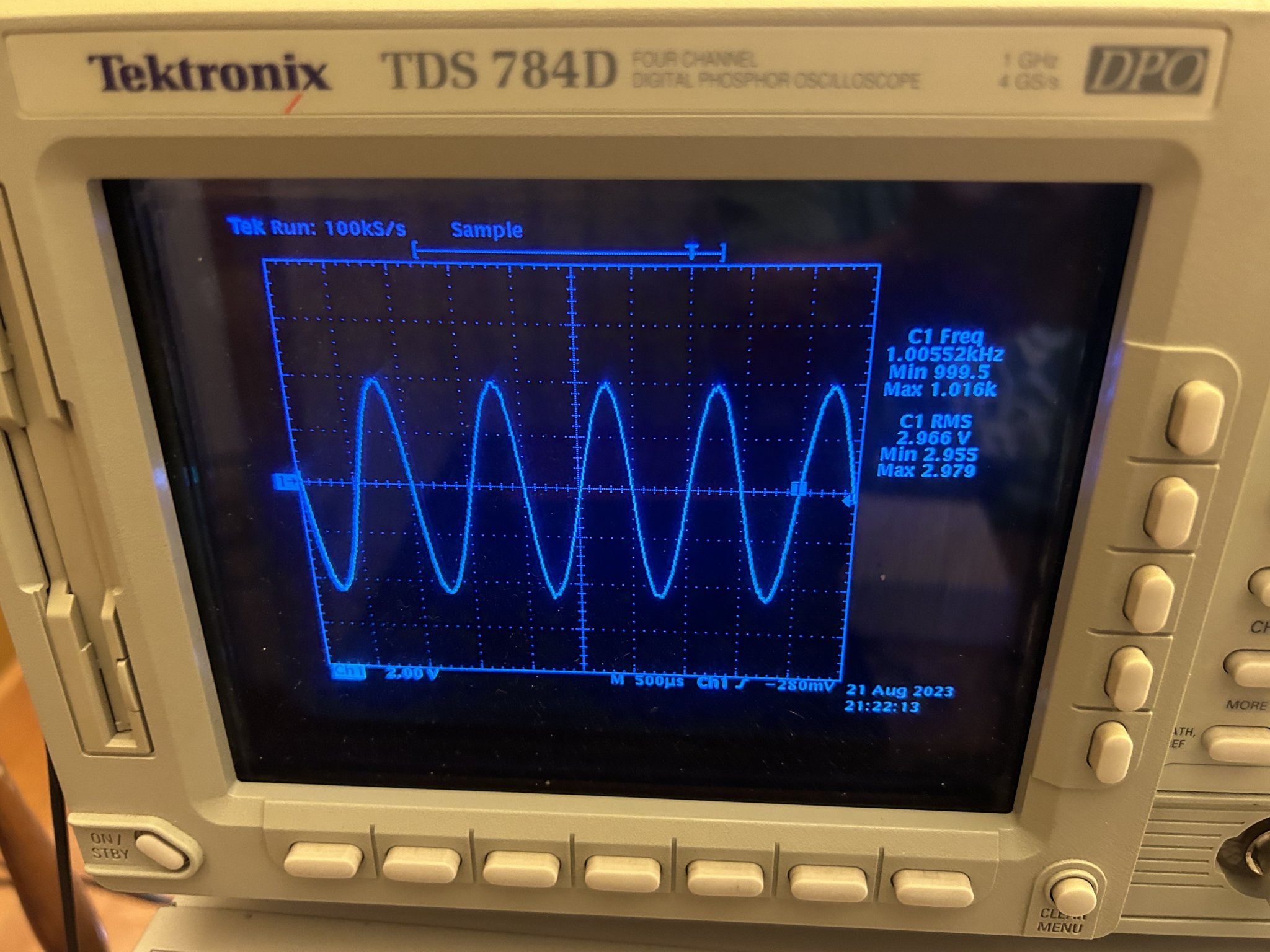

Here is the Akitika output at max output.
All voltages were cross-checked between the scope and a DMM for agreement.
Clearly the impedance of the Shiba has an impact. More to come after a brain rest... Note... another kind person had been trying to explain how the output of the Shiba along with the cabling and the input of the scope could be creating a voltage divider. I still must read more to try and understand that theory.
I'm not imagining the displayed results... I just haven't the foggiest of clues why I'm seeing what I'm seeing. That doesn't even get to the Focusrite interaction yet.

Fairly obvious that the output impedance of the Shiba is high relative to the low ipedance of the mic input. There is no magic going on and cabling etc is not relevant.
If you'd never tried the mic input you'd never have been diverted by this simple fact.
Put a resistor of 3k across the DMM input and see what happens......
You can easily calcuate the Shiba output impedance using Ohm's law.
Let's say the voltage drops to 0.75v into the 3k inut impedance, meaning a current of 250Ua is flowing. This is causing the drop of ,25v so the impedance is 0.25/.00025 = 1k ohms. Or in this example, the ratio of voltage drop is 3:1 so the impedance ratio is the same i.e 3:1 = 3k to 1k.
In dbv terms the drop is -2.5db ref 0dbv = 1v rms.

So, I had some fun. I may have even learned something. My measurements were crude, but I think effective. In hindsight, I should have measured the resistance of each resistor. However, I used the same resistors for each measurement, and they were advertised as 1% resistors.
Attached are a few files if anyone wants data.
Summarized...
My Akitika oscillator output impedance measures between 104 (Average) and 2301 (Average) ohms. It varies based on output just like the specs say. No surprise to its designer or to any of you. What was interesting (to me) is that at max output, the output impedance drops back down. I'm sure the reason behind that is obvious to many of you, but I'm still scratching my head. I used 1k, 3k, 10k, 30k, 60k and 1M resistors for the measurements and calculations. I tossed the 1M results b/c .... they looked funny. :clown: It's likely my measurement error / rounding errors, my Excel skills, my math skills, or some other thing that I don't quite understand at the moment. The voltages below were not exactly as posted. I rounded. The sheet attached has the actual data. I also don't understand why my Akitika has a maximum output voltage of nearly twice the posted specification. Perhaps it's a build error. If anyone else has seen similar, I'd love to know.
Output Voltage with DMMCalculated Zout
Avg 25mV117
Avg 100mV368
Avg 500mV1,454
Avg 1000mV2,275
Avg 2000mV2,301
Avg 2940mV104

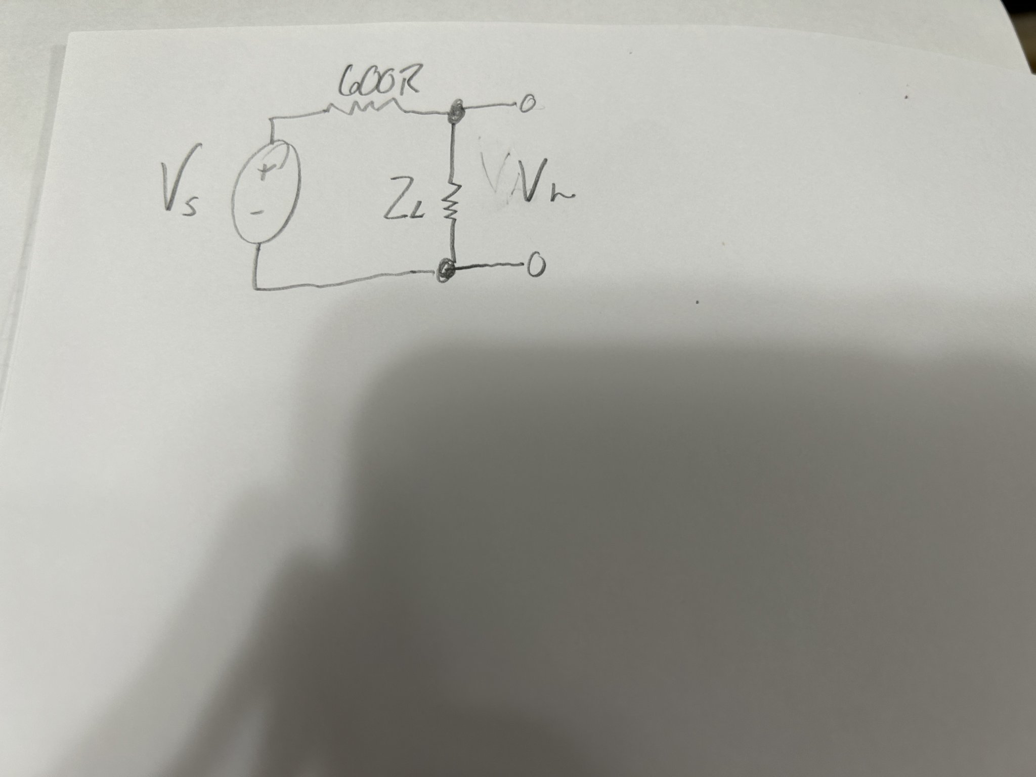

I seriously don't want anyone to go out of their way, but I do understand the schematics of a voltage divider. Could you sketch what you're thinking?
Does anyone happen to know in what use case someone would press or not press the button? I'm sure it's there for a very good reason. I'll admit my total ignorance even after reading 100's of pages. It's an oscillator. Why would you load the input vs. output. There's only an output...
Something is just not clicking... except the relays on the Shiba. :joker: Gotta joke when I'm frustrated.
Joined 2010
A voltage divider is two resistors in series as load and the output is the common connection of the series resistors... A potentiometer is often used as a voltage divider.
In the image attached, R1 would be the output impedance and R2 would be the load that is switched in or out.

I had sketched below when trying to interpret the manual...
I interpreted as the 600 ohms was the output impedance (600R). The display on the oscillator would always display Vs. When the light is on indicating "to terminate the output with a 600 ohm resistor", I assumed ZL was "added" as 600 ohm. When the light was off, there was no Zl.
Is what you're (and at least one other person) thinking that from the standard diagram of the voltage divider you posted, that I am pretty sure I understand ... that a resistor is added in series to create a divider? If so, I completely and totally misinterpreted the manual (among many, many things).

From #1674 - Agreed. Totally cool with that. If the input impedance on the DUT (or the input of the ADC) is high enough. No worries. It was (and still is) related to yet another mystery that I cannot solve. I'll hold on that with one piece at a time.
The DUT's input impedance would be in parallel with the 600 ohm load so the effective voltage divider will have changed. If the DUT's input impedance varies with frequency, then the input voltage will vary with frequency. However, for high input impedance, when paralleled with the low impedance load (600 ohms), the 600 ohms won't change much.
Joined 2012
What pinholer said. When the switch is off the output impedance is 600R. When the switch is on, a 600R is added across the output.
So the output voltage displayed is only correct when the switch is on, with 600R across the output. When the switch is off, the output voltage is twice the displayed voltage. That is a good reason to measure the output voltage rather than trust the voltage displayed on the generator's meter.
The output impedance is low enough that the input impedance of the Focusrite is not an issue.
The Akitika's output impedance being much higher would affect the output voltage of the Focusrite, and that is shown in the difference between the TRS and XLR FFTs.
