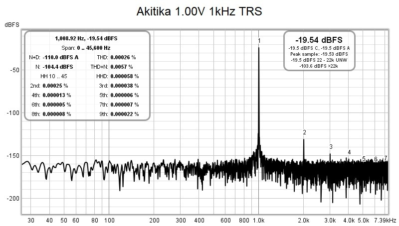

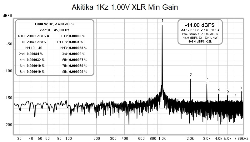

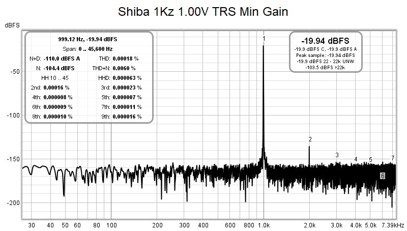

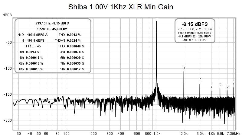

I thought to myself... SELF! REW has an oscilloscope function built in... and dBFS can be calibrated against a known voltage. BUT... what voltage?! I paused there before my brain melted.
The goal was to check a few measurements using the line input vs. the mic input. It would be great to not need to use so much attenuation. I haven't built the autoranger yet, and my version of the Akitika attenuator, (not yet properly boxed) seems to add error (in my hands). It's likely a user error.
So, I wanted to test line input against Mic input... because... why not, right?
I used the Akitika and the ShibaSoku generators and got similar results. I double verified the output voltages of each generator with a DMM and the oscilloscope, which agree very well even at 1kHz.
I'm still digesting those results, but here they are for public scrutiny. At first glance... the line input for a 1Vrms input seems... better... but which is more "accurate" ... I dunno? In every other piece of laboratory work I've done, I've always had a reference test method that was known / verified / good along with reference standards for calibration. So, I'm flying a bit blind. It's fun as hell, but I'm probably going to fly into a mountain at some point.
Where I am completely and totally lost is why the dBFS is roughly 6 (-14 vs -8) different between the Shiba and the Akitika when using the 'exact' same voltage output, and the exact same cabling using the XLR (mic input) with one exception. The Shiba output is BNC to RCA, but that is true also for the TRS input.
1/2 the voltage is 'seen' by the Focusrite when connecting the Akitika vs. the Shiba when using the XLR connection. I assume the difference in XLR vs. TRS is the gain change when the Focusrite detects the different connector and switches from mic to line.
I am baffled... I repeated this a few times, but that doesn't mean I did it properly.

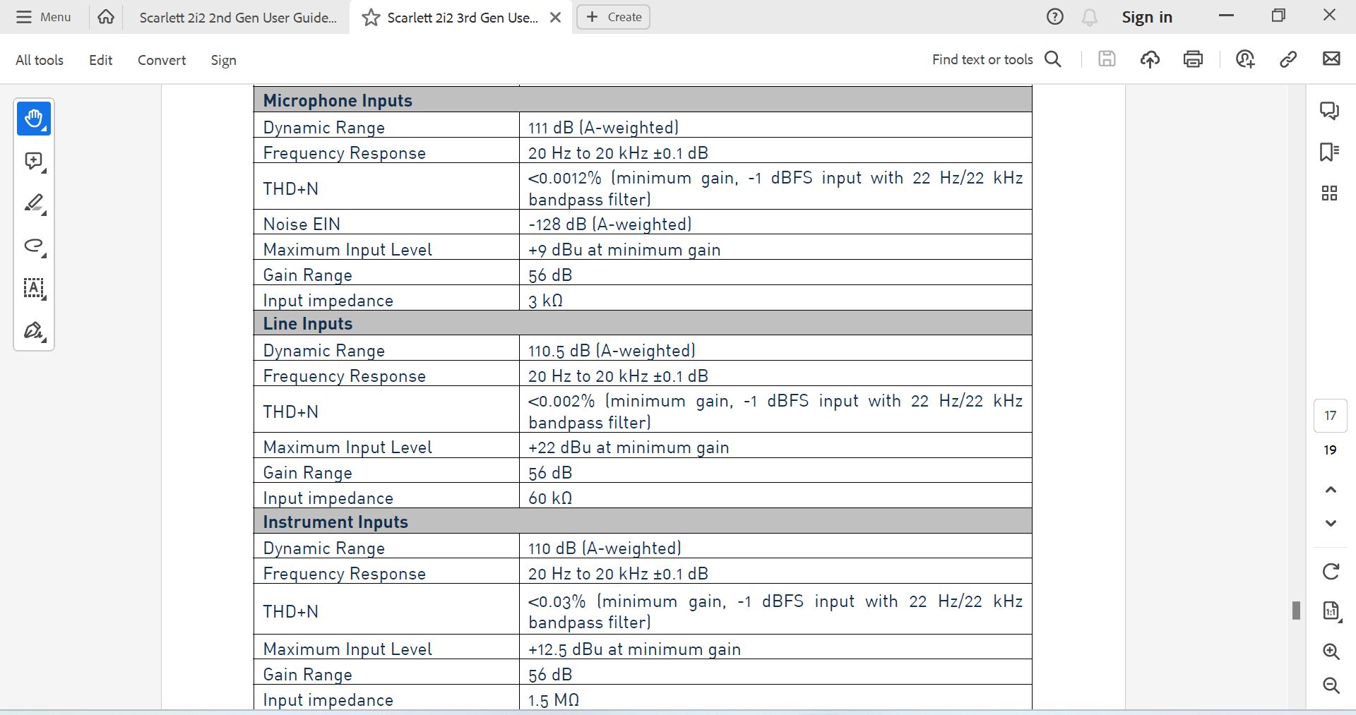

The Focusrite manual states that the input impedance for the mic input (XLR) is 3kohms. While the input impedance for the line input is 60kohms.

Patrick,
The Focusrite microphone input and line input gain levels at minimum adjusted input level are probably different, so the output level would be different. That would explain the different measured levels.
The 2i2 Gen 3 specifications also show a much lower input impedance for the microphone input - 3kOhm for microphone and 60kOhm for line. Perhaps the Shibasoku generator is more susceptible to feeding an input that is low impedance.
Looking at your FFT plots, I will try the line input in the future as it may have lower distortion in actual use when measuring distortion.

Signal A - measures 1.00Vrms
Signal B - measures 1.00Vrms
Signal A when fed into the microphone input of the Focusrite set to minimum gain shows as -8dBFS in REW.
Signal B when fed into the microphone input of the Focusrite set to minimum gain shows as -14dBFS in REW.
Signal A comes from a ShibaSoku signal generator. Signal B comes from an Akitika oscillator.
Any offerings to help me understand that and that alone (for now) would be absolutely amazing.

6db difference is typical result in case a symmetrical source is injected into an asymmetrical input (or vice versa).
^ Thank you so much. I need to use some vernacular / likely incorrect terms, but if you'll bear with me ... I was using a similar thought to test a few things.
If by symmetrical we can substitute what I'd call differential and some call balanced... awesome. What I mean (even if it's not correct) is two equal and 'opposite' signals. I think it's important to explain what I mean... even if I haven't 100% grasped what I'm trying to hold onto. If I'm understanding it correctly also, there is no 0V reference / GND. The two signals are referenced to each other for the voltage differential => the ultimate signal.
If by asymmetrical, I can use SE or a signal referenced to a 0V vs. another signal... then I am following.
The ShibaSoku does have balanced outputs (by their term). However, the generator was set to the 'nonbalanced'. Also, the output for the 'negative' or 'inverted' signal was covered / not used.
To try and work with what might be your theory ... I actually thought I had verified things properly, but perhaps not.
The cabling from the ShibaSoku to the Mic input was...
BNC to RCA. RCA to XLR cable (pin 2 signal and Pins 1 and 3 tied as GND). XLR input to the Focusrite.
I measured 1.00Vrms between pin 2 and pins 1 and 3 (tied).
The cabling from the Akitika to the Mic input was identical with the exception of removing the unnecessary BNC to RCA.
I feel like I am missing something so boneheaded, but unless somehow 1/2 of the signal is getting 'lost to ground' or something equally mystical (to me) ... I am totally stumped.
